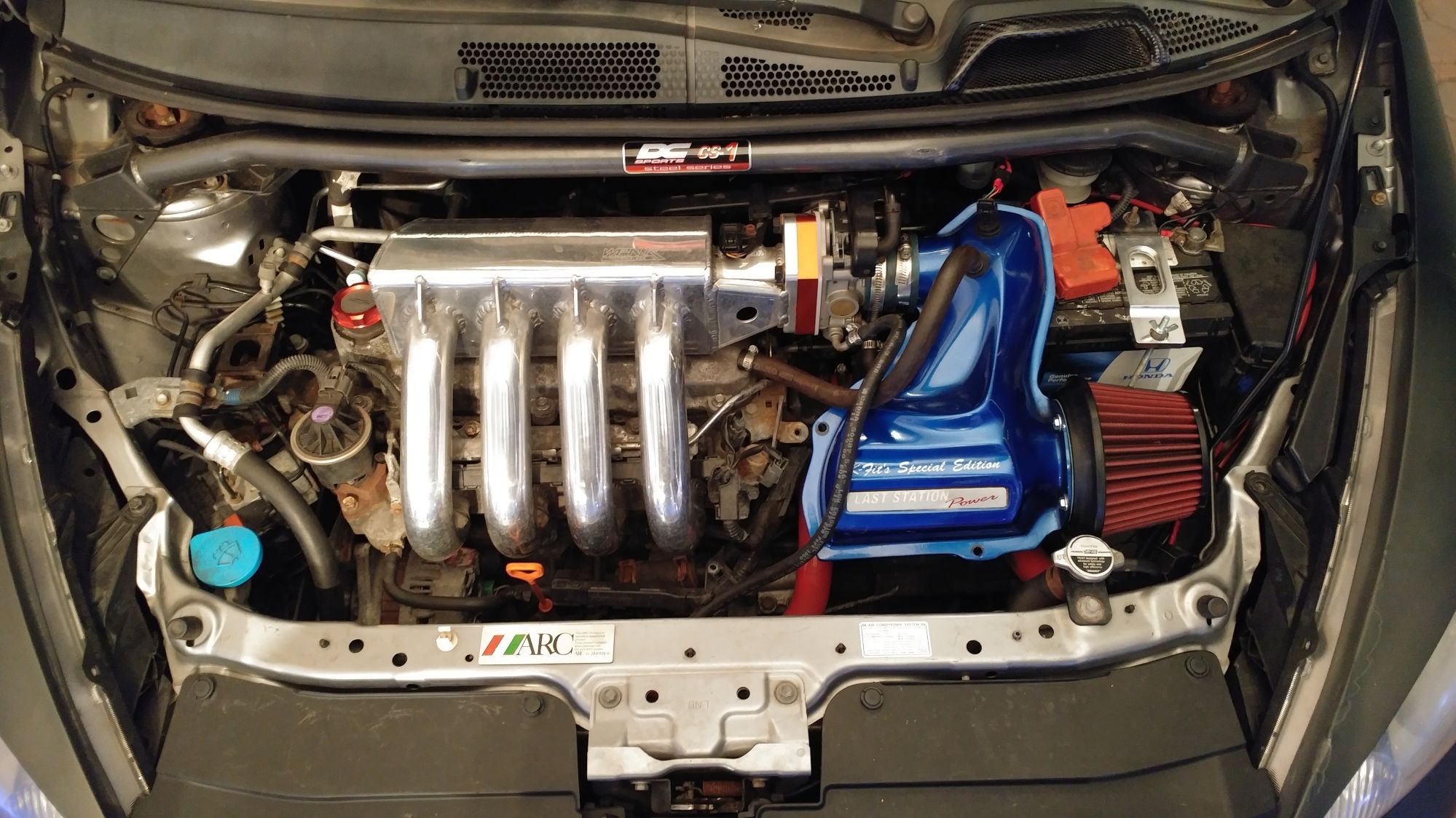

Intake) I've been through several intakes (DC short ram, DC cold air, Apexi power intake, and Last Station Chamber) and I must say the Last Station is my favorite, with the Apexi a close second. I feel equal power through the whole band on both, but the chamber I feel a bit more and better throttle response.
Throttle Body) I swapped out the stock throttle body for the R18 Civic throttle body (increased from 50mm bore to 55mm), the intake is bolt on and the only mods needed was longer hoses. I also added a throttle body spacer, and thermal gasket. Tough to say if it made a difference, but I do feel a difference in throttle response and acceleration.
Intake Manifold) I put in the Weapon R intake manifold and haven't looked back, I can feel the difference with the rest of my mods and it helps the engine bay look pretty
Pulleys) I swapped out the stock pulleys for a set of Ralco light weight pulleys, less weight on the crank = more HP to the wheels so worth the upgrade.
Headers) I've installed the Weapon-R 2 piece race header, and so far it's been awesome. My only issue is that a few things needed to be adjusted to make it fit properly (like removing the heat shield)
Cat) I had to remove the Megan cat-delete to install the Weapon-R header, and I was a bit nervous about what kind of noise I would get with the header and losing the resonator on the cat-delete. Luckily the resonator on the Megan mid-pipe combined with the Apexi SV exhaust has kept the noise/drone level way down.
Exhaust) I started with the DC Sports cat-back system, it's a great exhaust but had too much of a drone on the highway when combined with the rest of my parts (head ache after 5 min). I tried the exhaust with a silencer, but the exhaust never sounds as clean with a silencer. Swapped out the DC axle back with the Tanabe Concept G axle back and it eliminated the drone with out needing a silencer which was awesome. I just recently installed the Apexi SV axle back and it's almost eliminated my exhaust noise (sleeper!!!) and now that the Megan mid-pipe has been combined with the Weapon-R header and Apexi exhaust I'm happy to report that I couldn't be happier with the results. The tone is deep while at idle, but there is no drone on the highway what so ever and it my car doesn't sound like a lawn mower haha.
Clutch/Flywheel) Upgraded both to help my go-fast parts, went with an Exedy stage 1 clutch and Fidanza flywheel. The Exedy has awesome grip and feels pretty close to OEM. The flywheel has made the biggest difference in acceleration, the stock flywheel is about 18 lbs while is the Fidanza is 7!! That's a huge weight loss off the crank putting more of the horse power to the wheels.
Radiator) Upgraded to the Mishimoto aluminum radiator from the mostly plastic OEM one, definitely helps the engine run cooler.

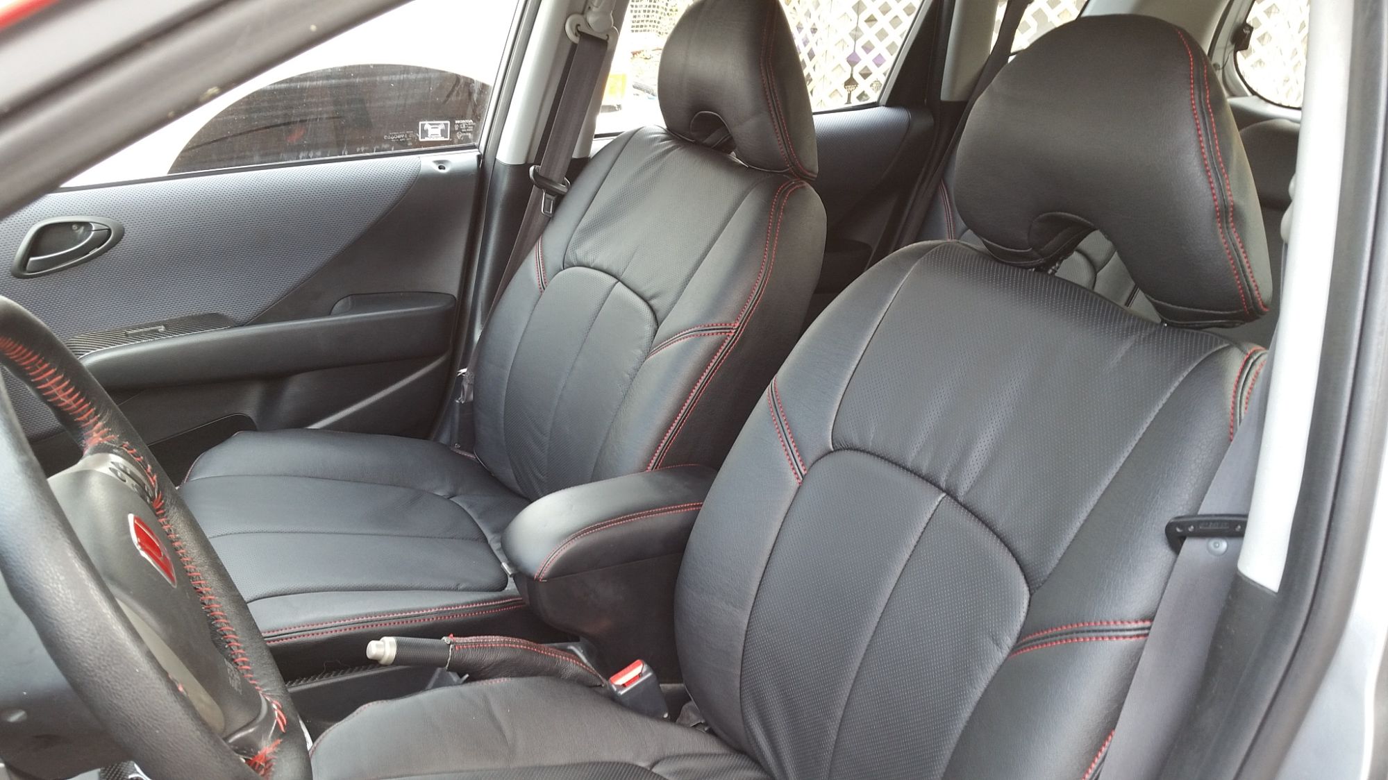

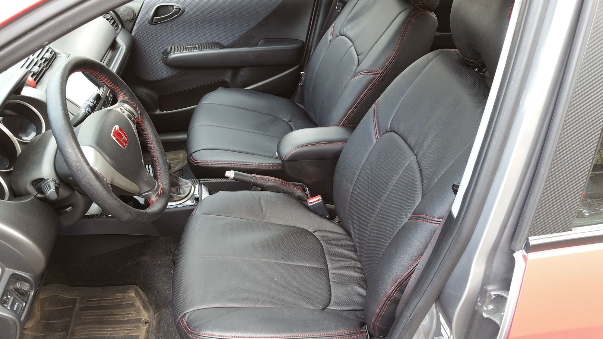

Seat Covers) Clazzio - Awesome seat covers, went with black leather w/red stitch and I couldn't be happier

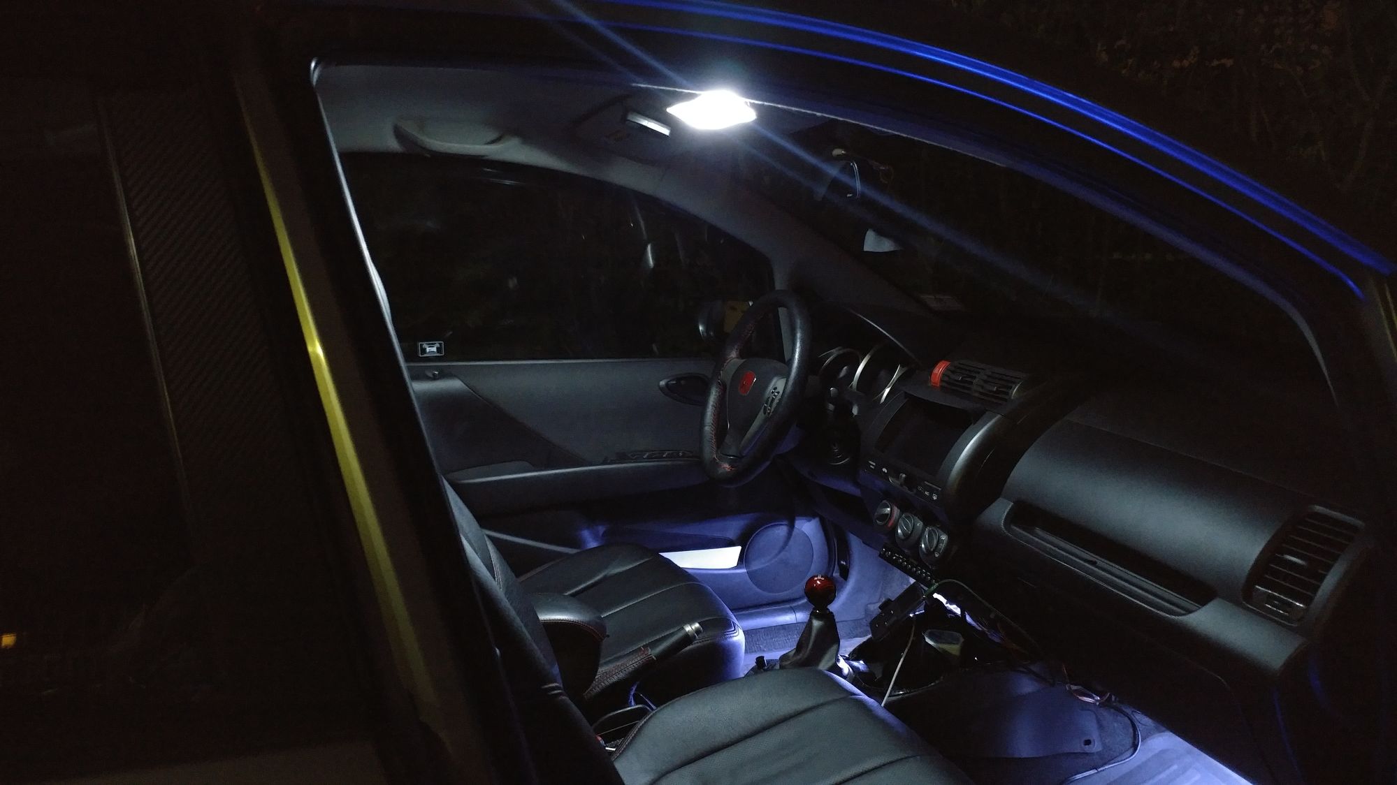

Extras) Map Lights - Snagged the map light setup out of an 01 Accord and
wiring them to the dome light so them come on when the door opens.

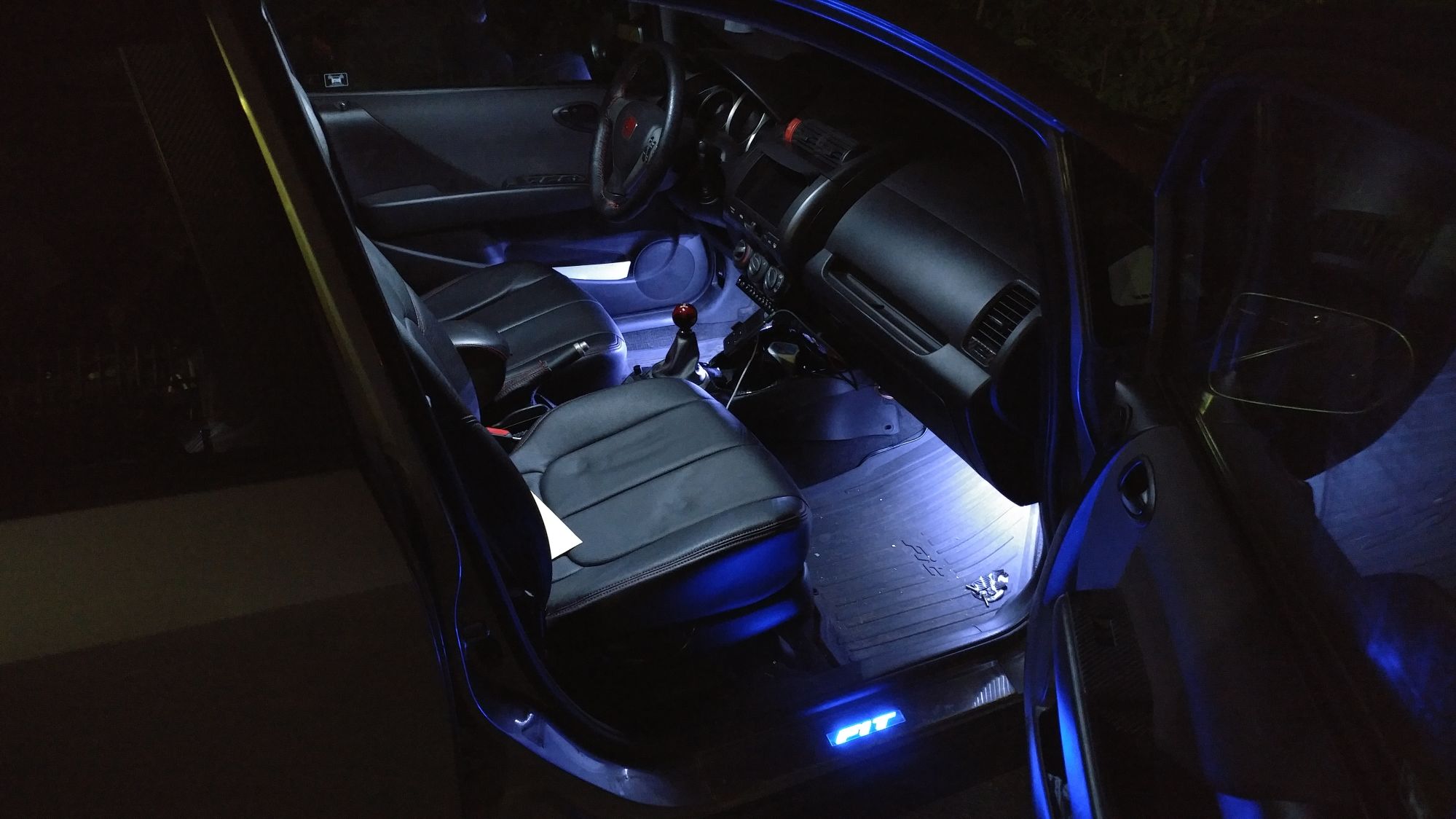

LED foot well lights - As any of you know, with just a dome light our cars are dark as fuck at night, forget trying to find something you dropped on the floor, even with the dome light on.
Door sills - Added the door sills that have LEDs light up and say "Fit", they don't do much but add a little bling
JDM hazard switch - Switch is orange instead of grey.. but JDM!!
LED door sills) Installed door sills with LED "FIT" lights, wired them in to the rest of the interior lights so they come on when the door opens and fade out.

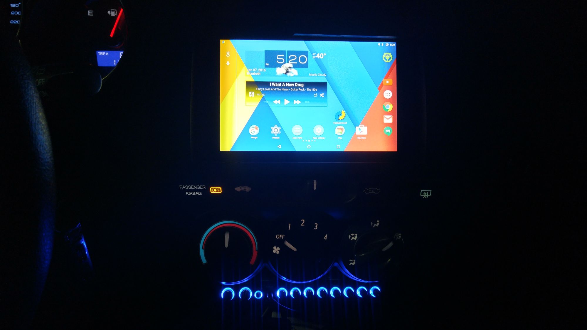

Head unit) Android Nexus 7 tablet - After trying several different head units (Alpine 2, Clarion 2, and Pioneer) I went with a Nexus 7 tablet and I couldn't be happier. Audio runs through a USB to a converter, then to a Clarion EQ, which sends the signal through my amps and speakers. I can play audio through the tablet while using apps (navigation, sports streaming, torque, dashcommand, etc) or I can play music from my phone or Ipod directly through the EQ. Sound is clean and I have plenty of power.

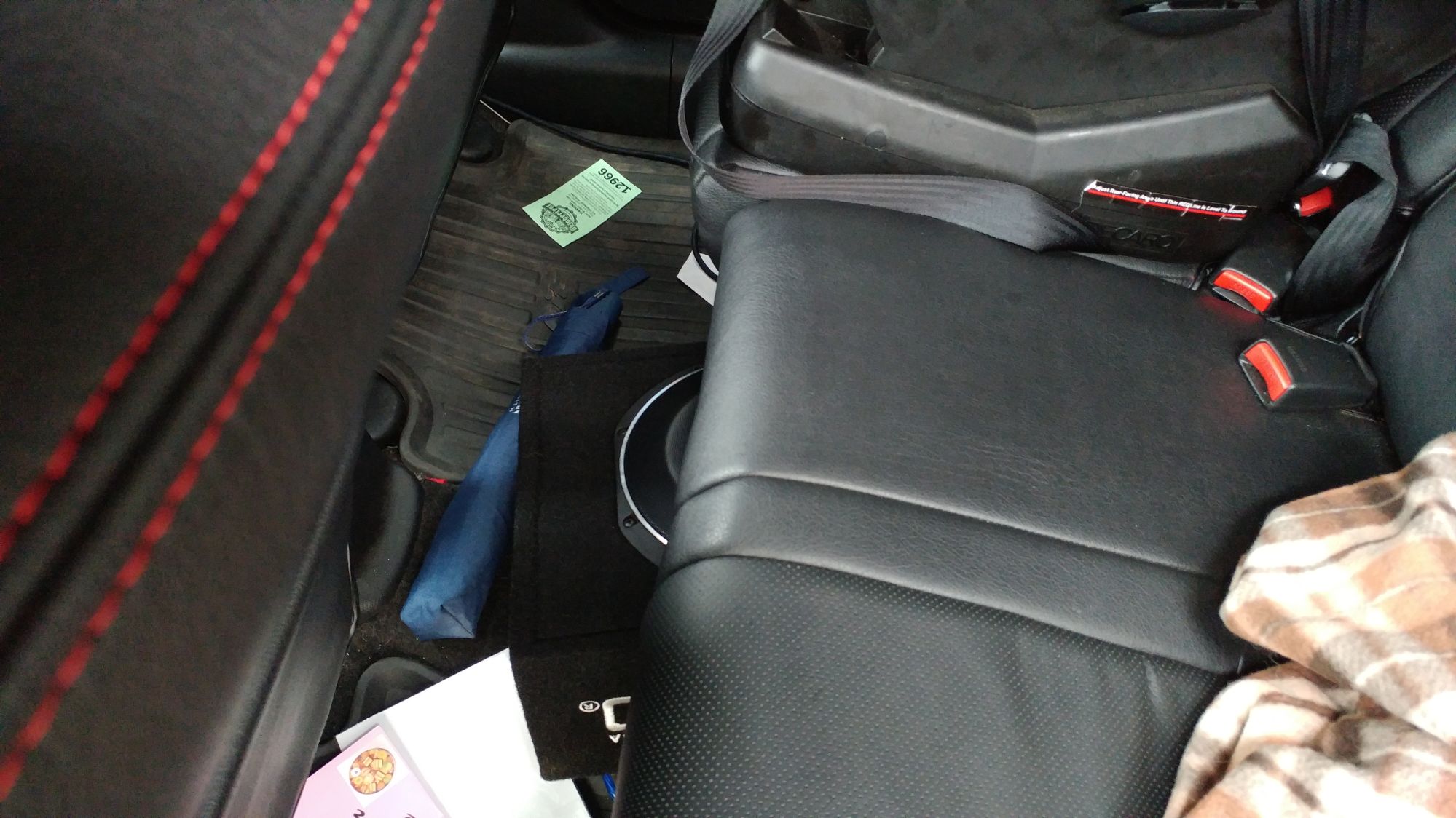

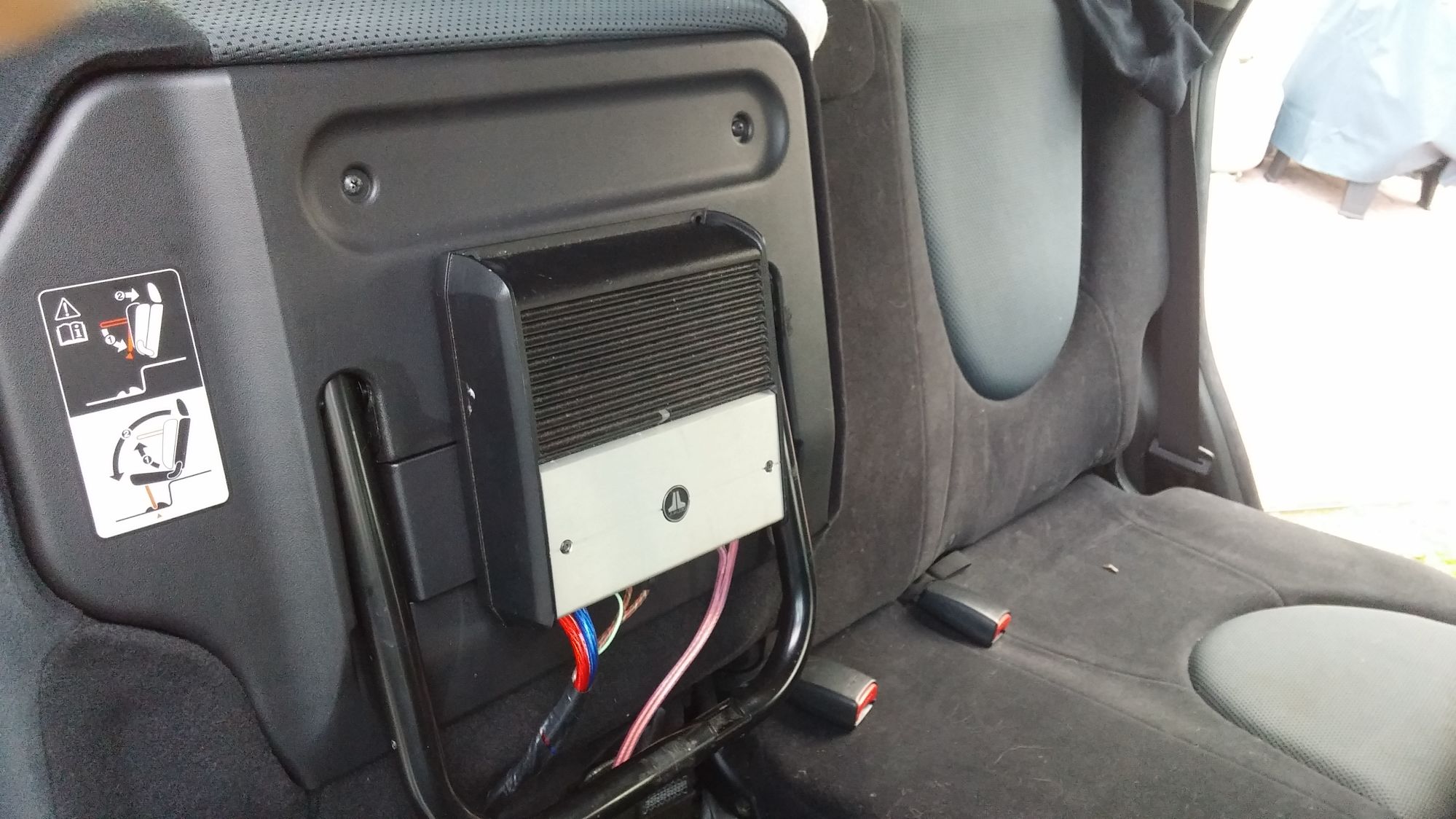

Subwoofer - JL Audio CS110LG-TW1-2 - 10" sub in sealed box, 300 watts at 2ohms which is plenty in our little cars.. plus it fits under the back seat!!
Amps) speakers - JL Audio XD400/4v2 - Delivers 75 watts per channel which is plenty in our cars, It has a small foot print, plus my speakers are 100 RMS so I don't want to worry about blowing them out.
Subwoofer - JL Audio XD300/1v2 - Delivers 300 watts at 2 ohms so it's perfect for my sub, and I'm able to attach a separate control knob for easy adjustment. The benefit of both of these amp is that they aren't huge, so they attach nicely under the rear "magic" seats. No trunk space needed!

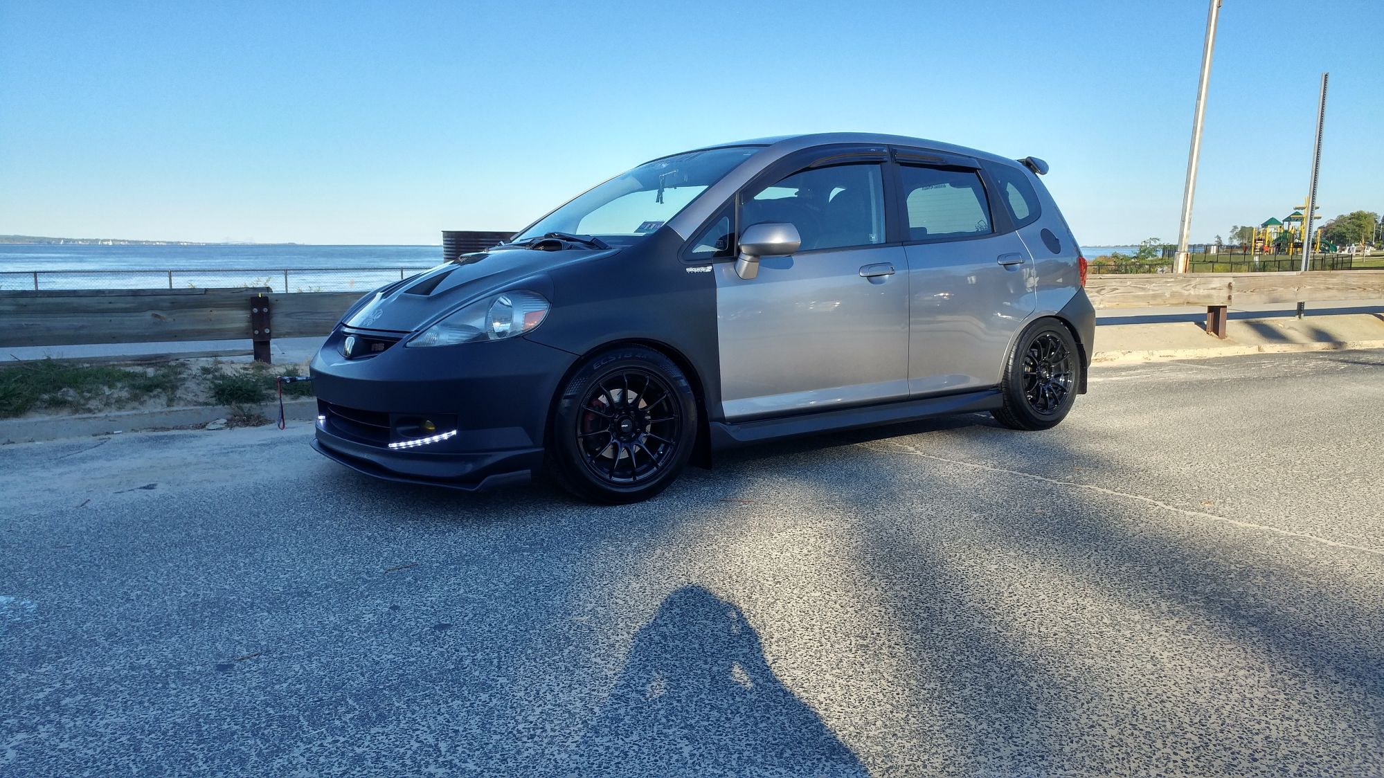

Wing) Carbon Fiber spoiler - Solid piece, and came cheap!
Hood) Seibon carbon fiber vented hood - Nice weight difference over stock, and it's CF so bling!
Cowel scoop) Carbon Fiber vented cowel scoop - It's carbon fiber and gets more cold air in to the engine bay.. win/win!!
Lip - Picked up a lip second hand, it looks pretty nice and does improve the down force.

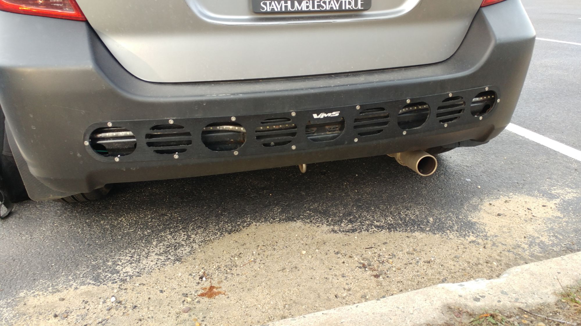

Rear bumper cover vent - So if you didn't know, the rear bumper acts like a huge parachute holding your car back. I installed a vent that goes along almost the entire bumper, and got an extra 5mpg because of it.. score!

Thanks, actually I ordered my arm rest with the red stitching. It's not always available, so you have to keep an eye out. The GD is desperate for more interior lights, at night with just a dome light you can't find shit in that car. Adding the map lights helped, but the foot well leds made the biggest difference.
