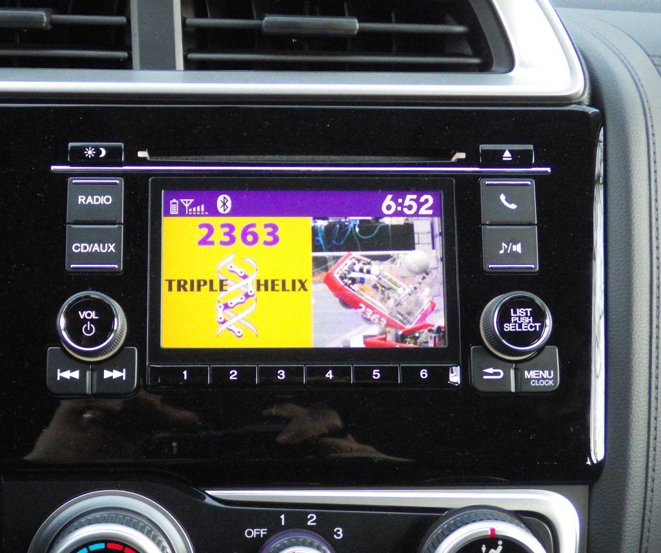

  • I'm a mentor for a FIRST high school robotics team. I decided my mods would make my car themed in our team colors. The first thing I did was make some custom wallpaper for the radio with our team logo and a pic of our robot from this year. The image is 1664x936, with a 160 pixel tall bar at the top.

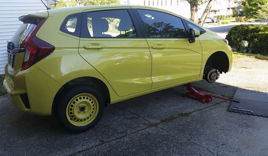

  • The purple wheel covers tend to blend in with the stock black wheels. As an experiment, I sprayed the two wheels on the passengers side with yellow Plasti Dip.
    This shows off the purple wheel covers a bit more.
    I'll see which I like better and either peel off the yellow to return the passenger wheels to black, or spray the drivers side wheels yellow to match. Or, maybe just go with some purple alloy rims.

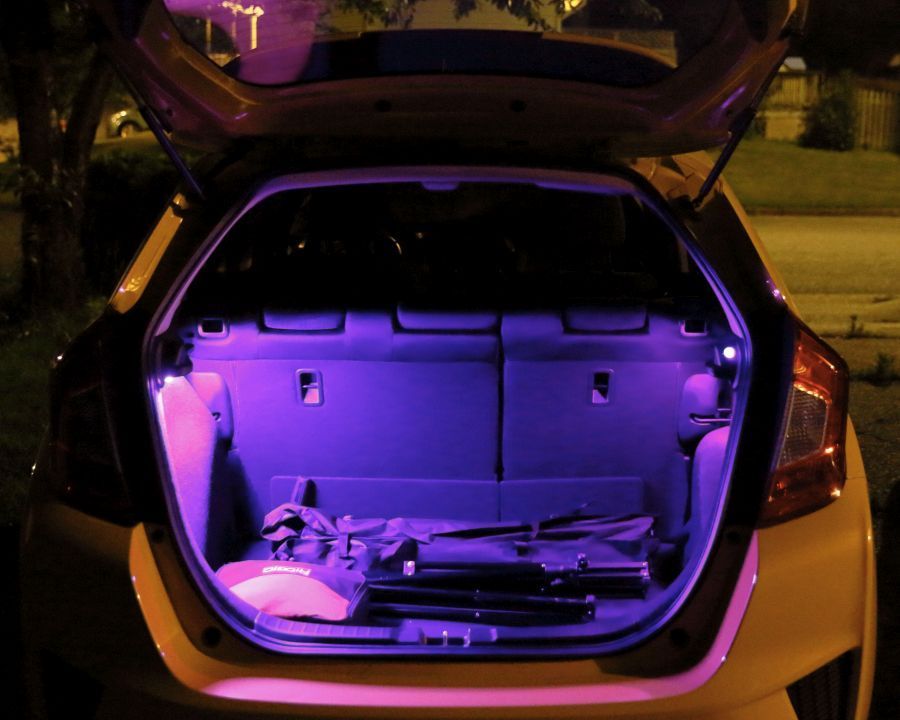

  • trunk lighting
    Lighting for the rear cargo area presented more of a challenge than the front. I wanted purple lighting when the hatch opens, but that lighting wasn't really bright enough when digging around in the back for gear. So I added a push button switch that swaps between purple lighting and white spot lights.
    Purple lights:
    White lights:
    It's not super obvious from the pictures, but the white lights are about 3X brighter than the purple.
    First I replaced the stock rear light bulb with a purple
    LED replacement LED replacement
    . To light up the left side, I used a short piece of purple
    LED strip LED strip
    . These were wired in parallel to each other. For the bright lights, I used a pair of white
    eagle eye style LED lights eagle eye style LED lights
    . These were also wired in parallel. I used a
    purple illuminated push button switch purple illuminated push button switch

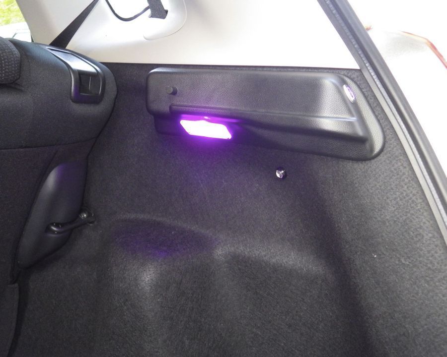

    to switch between the purple and white lights. I tapped into the wires feeding the stock trunk light, used the ground wire as a common ground for all the lights, and used the push button to send 12V from the hot wire to either the purple lights or the white lights. When the button is in the "out" position, the purple lights are on and the white lights are off. When the button is "in" (it's a push on-push off style button), the purple lights are off and the white spotlights are powered. All the lights go out when the hatch is closed, and also go out when the hatch has been up for about 10-15 minutes. I wired the button to stay lit in both positions, to make it obvious. Depending on how you wire it, the button could have been lit with the purple lights or the white lights. One interesting thing is that the switch lights up in both polarities. This makes me suspicious that the light is actually a bulb rather than an LED, which should only light when wired one way.
    push button switch:
    right side lights:
    left side lights:
