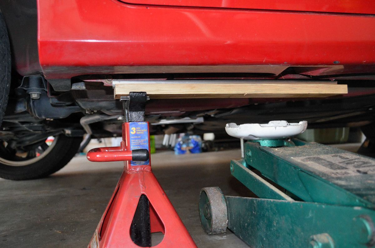

Speaking of jacks, jackstands an wheel chocks, here's a picture from my garage. The Fit is such a small machine that by lifting the front near the jacking point, the rear wheels lift off the ground. I moved that rear wheel chock over to the other side.
It's hard to see, but I built a device that extends along the length of the pinch weld. I lift with the floor jack and then insert the jackstand adjacent to it, then lower the floor jack.

Jack Pad Device 1

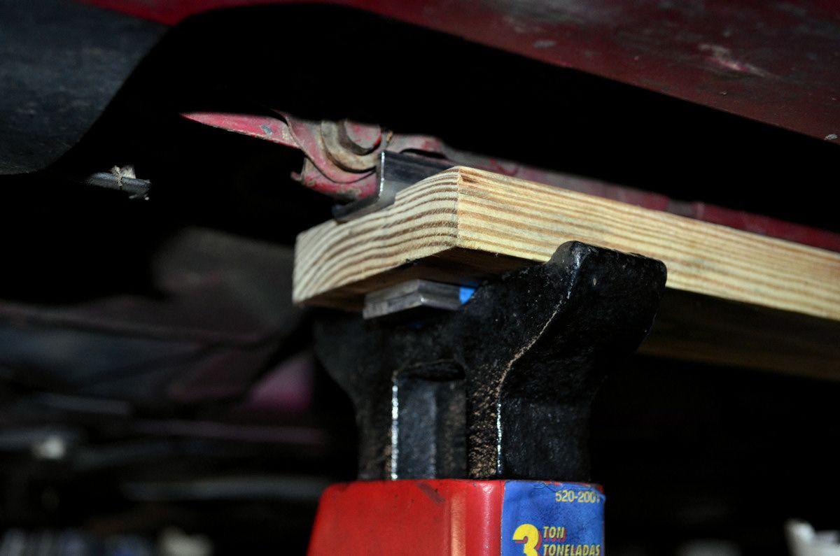

Jack Pad Device 2
Here are two close-ups of the jack pad device I built. I use the floor jack on the right side, then insert the jackstand to the left of it. It works well, but I modified the design a bit to insert a durable soft material on the floor of the channel stock where the pinch weld rests. I rubbed a small bit of paint off the underside of the pinch weld in one place.
The wood is poplar and cut cross grain. It's a tough, durable wood and with the grain running as you see, it won't split. I dadoed a shallow inset along the length of the wood to set the metal channel stock in so that it won't slip out. The small metal pieces under the wood on the saddle of the jackstand are there to be absolutely sure that the wood is fully supported across its width.
