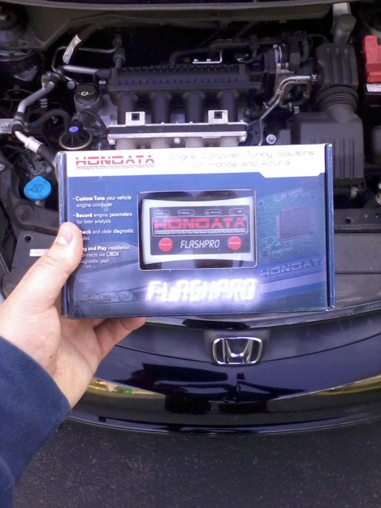

Looks like a major hurdle has been cleared for not just mine.. but all GD Fit builds, behold:
FlashPro Fit
Thanks to:
https://www.fitfreak.net/forums/1st-...w-hondata.html
Not only has this made a giant leap for Fit-kind, but it has just about cut the cost of what I was expecting to pay for EMS by two-thirds!
FlashPro Fit
Thanks to:

Got my FlashPro today!
Rev limiter set to 7900/7750 recovery
Launch limiter set to 5250/4900 recovery
Low load AFR targeting 15.2:1, thinking about going higher under cruise but still playing around with that.. should give me a respectable bump in fuel economy without really having to think about or do anything haha
Added 1-2 degrees advance every where but the VTEC cam changeover, low-mid range feels mildly improved.
Added a few degrees of timing out the top, saw no knock even with the thresholds set lower.
Leaned out to 13.2:1 past peak torque on the WOT Lambda maps and again no knock or stutter.
I completely changed the feel of the car above 5k rpm and pulls pretty solid to 7500. Get more MPH between shifts speeds things up considerably, and gear change drops directly into peak torque making pick up much snappier.
As a bonus this little hamster mill starts to scream after 7000rpm, even through a stock airbox and exhaust.
Can't wait to get the cam and springs in this bitch.
