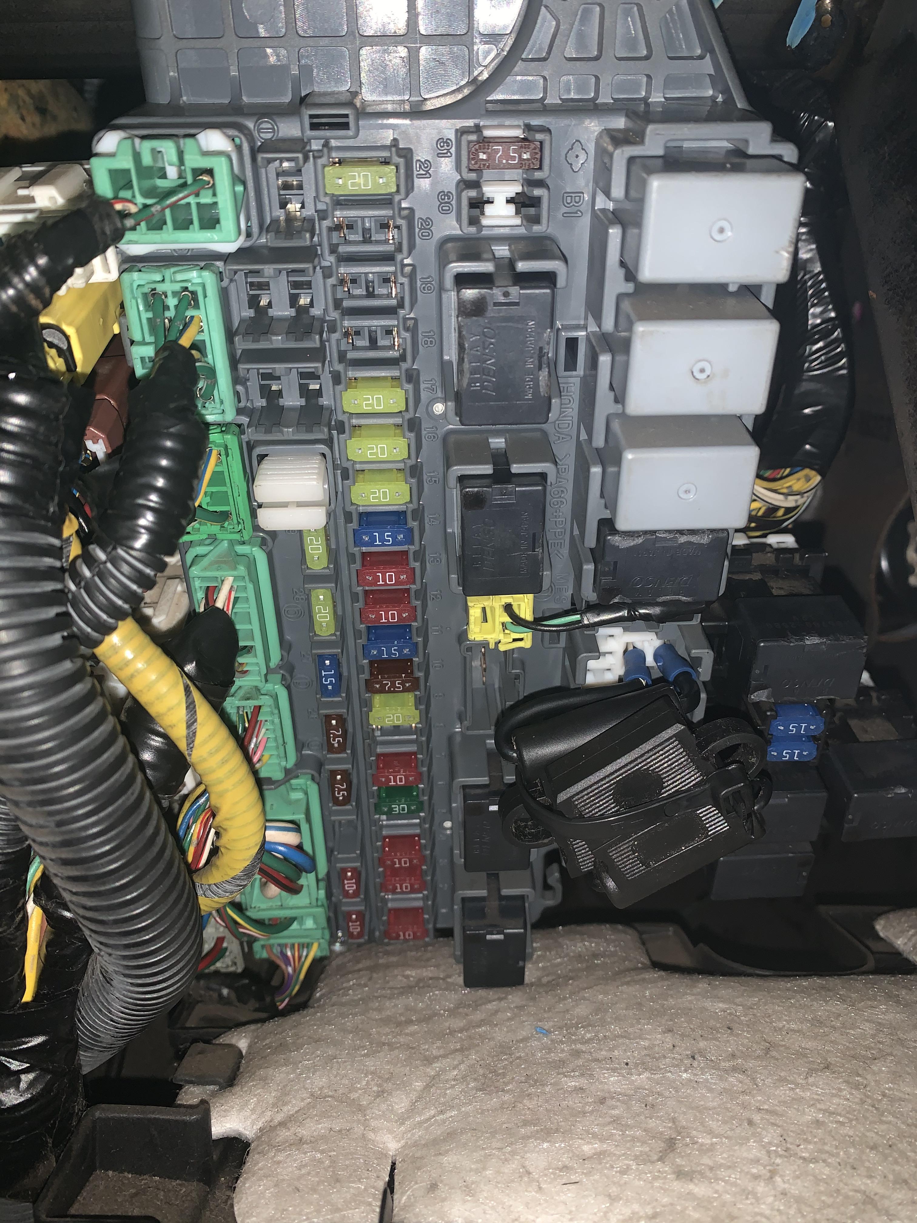

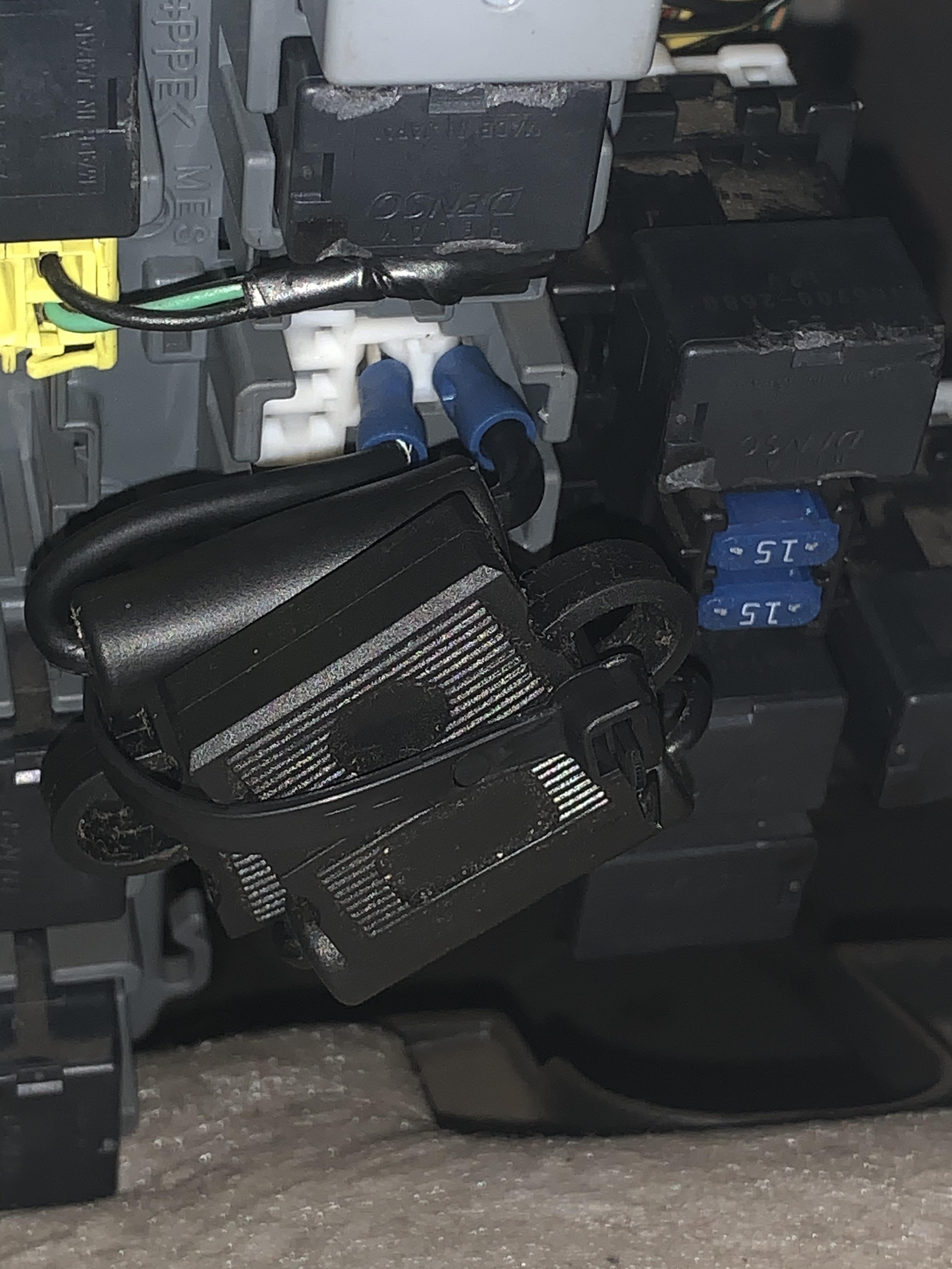

The under-hood fuse box looks normal; it's the under-dash one. The car ran well for about a week (although starting idle seemed higher than before) but then wouldn't start and (newish) battery seemed dead. At first I couldn't get my smart charger to even recognize the battery but after putting a higher current on it for a few minutes, the charger did recognize it and is charging it. I assume there is a drain somewhere. The mechanic is out of work with a bad back but they told me to bring it in Monday and another mechanic will look at it.

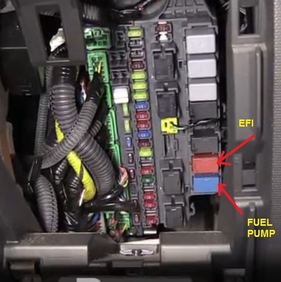

Your mechanic had disabled immobilizer by bypassing EFI and Fuel pump relays.
I had very heated "discussion" with former Honda tech, saying that Honda immobilizer is a joke!
Your mechanic had proven that I was right.
In order to prevent your car from being stolen with master key, you need to add some extra protection as hidden switch somewhere.
Also your gas pump will be on all the time ignition is on

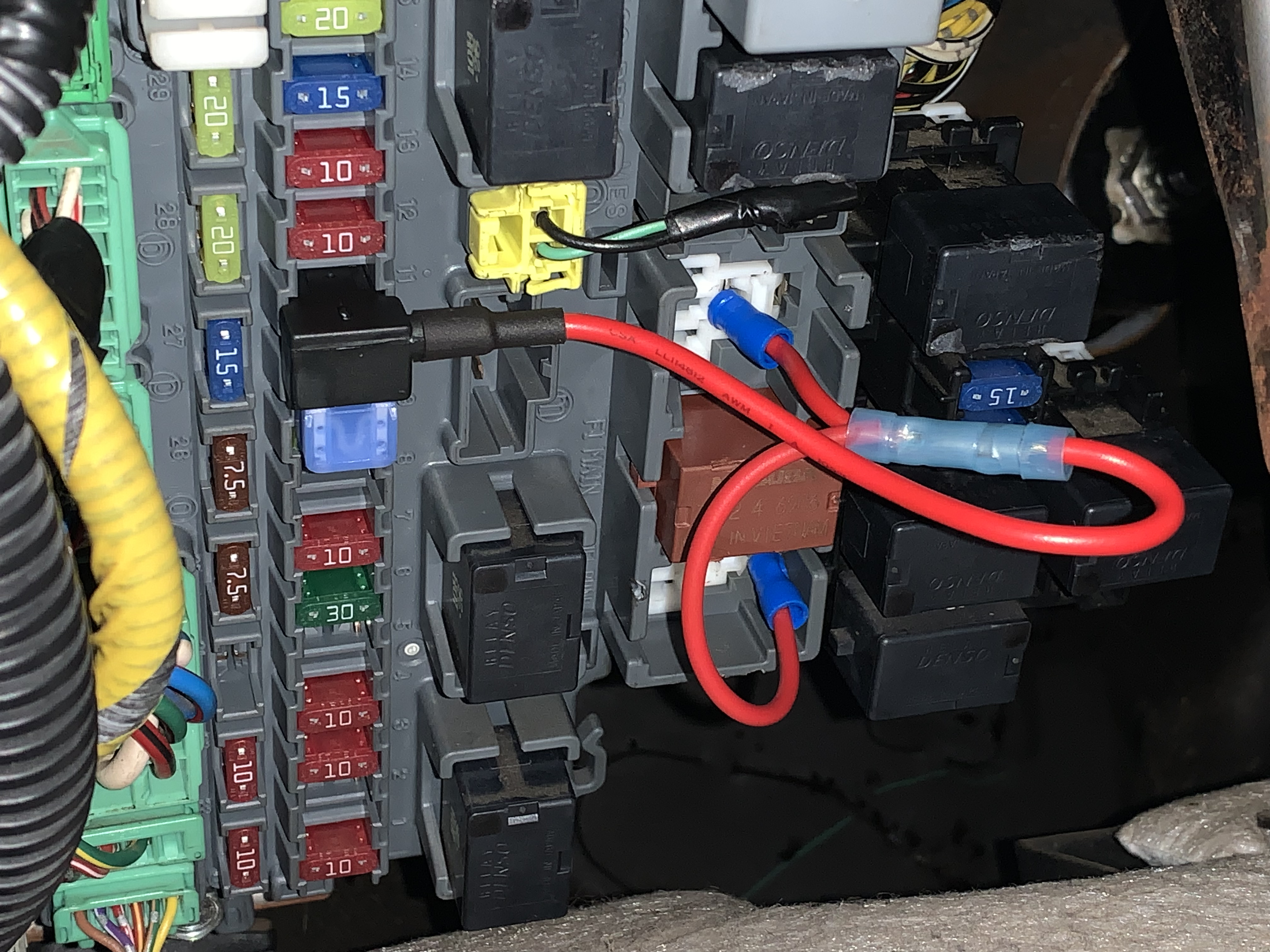

Hi, so my mechanic said there was a significant drain and he changed his wiring job. Now it looks like this. Car has been running well except for some hesitation at idle which I am guessing is more related to ignition coils than this re-wiring issue. I would appreciate any feedback on other effects this may have on car that I am unaware of. I noticed he doesn't have a fusible link in his new wiring any more.

He put T-tap on fuse #11 and connected the power to the output terminals of fuel pump (at the bottom) and ignition coil relay (top)
Fuse #11 (15 amp) is for immobilizer, ECU, Fuel pump
You still have gas pump on all the time ignition is on, so if you are listening to the radio with key in ON, not ACC, you will drain the battery
most likely, there is no communication between immobilizer unit and engine ECU
