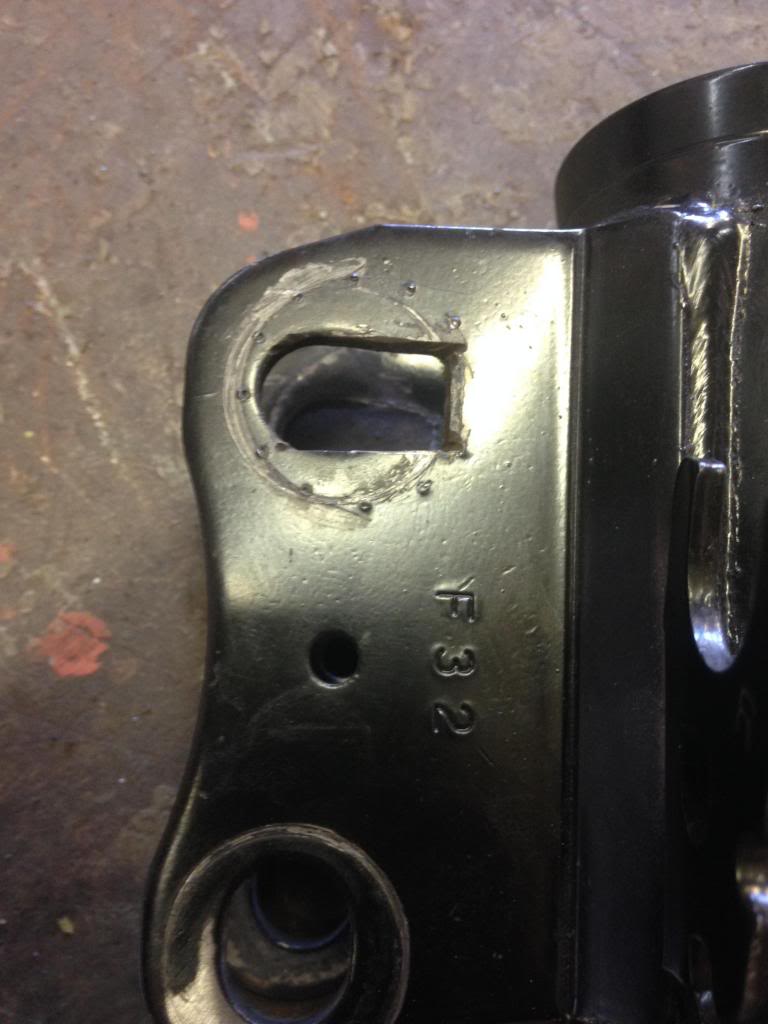

Are you running springs or coil overs?
Here is a tip (Pic below) I got from Previc93 to get more camber on the FIT. After the camber bolts and this trick I was able to get almost -6*. I'm happy with -3* for the front.
Just Tanabe springs for now...my next project is some Spoon dampers or some Coilovers but I'm happy to say that I grabbed the camber bolts at O'Reillys and was able to get negative 2 degrees of camber in the front to fit my new Buddy Club P1s 15x8+32 offset with 195/50/15 tires. Thanks again for the great tip Rollerboot!!!
