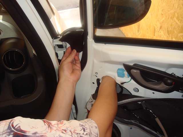

To open the Plastic Cover that Cover the 3 bolt that hold the Door Mirror,
It is best if you unhook the clip from BEHIND,
that mean you got to enter your hand through the Door Metal Sheet Opening and reach behind the Plastic Cover Clips.
Because if you just pry it from the front part, you might risk breaking the
clip, (like I did on the Left Side)...
Here are the pictures, where my Right Arm is going through the Door Metal Sheet to reach behind the BLACK Plastic Cover Clips (that I hold with my left hand after I able to took it out).

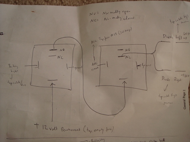

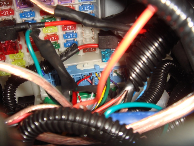

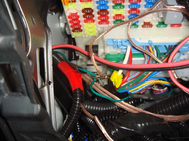

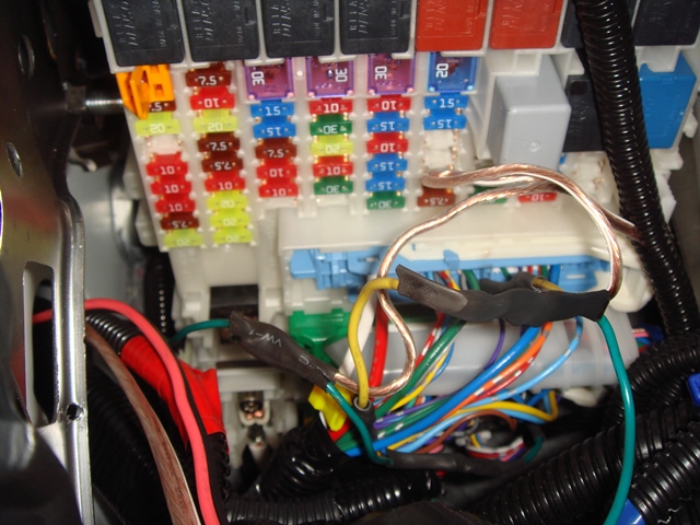

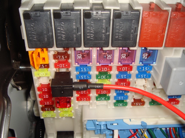

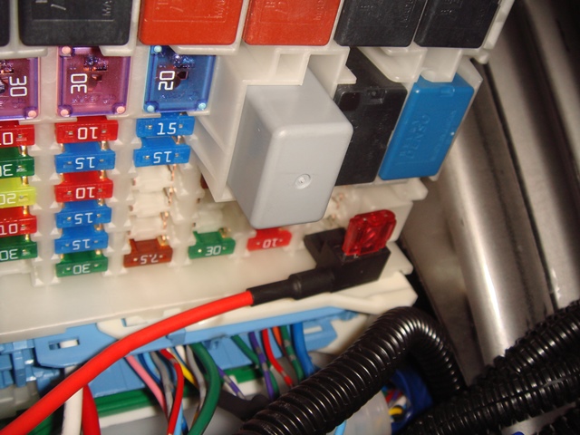

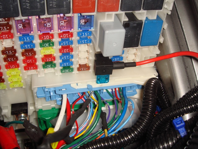

In the next few days, I will begin connecting the Heated Mirror Wire to the fuse box and also assembling that Relay Circuit to make the LED Blinker blink together with the Parking light when we lock/unlock the car with the key remote.
I actually already went to Frys today, but I got there 30 minutes too late,
turn out they close early on Sunday...

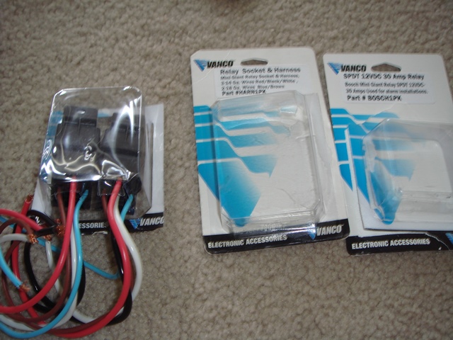

oh well, I had to go back tomorrow to buy the Relay and Diode that I need...

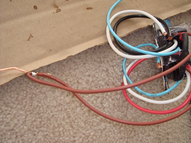

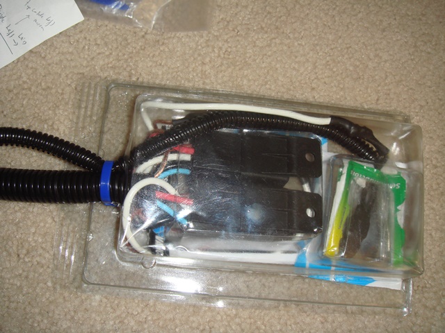

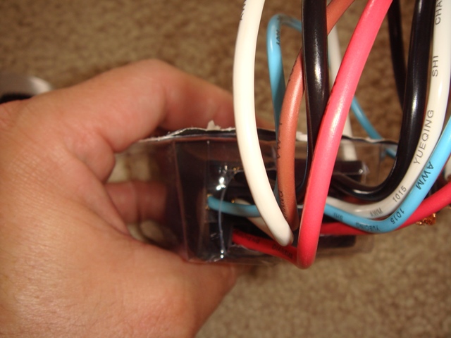

I also going to need DOUBLE Relay for this circuit because I need to make sure the LED Blinker going to work with Parking Light only after the Key is at LOCK/OFF position and not going to connect with Parking Brake Circuit when the key is at ACC or ON,
Also I need another relay so the Current that going to power the LED Blinker will came directly from Fuse Box and not Taxing/Parallel with the Parking Light Circuit because I worry if the LED Blinker (and other Turn Signal Blinker on the Front and Rear of the car) were on together with the Parking Light, it will be too much current for the wiring/fuse...
so this mean I need 2 relay !

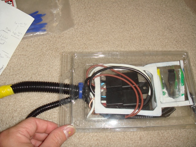

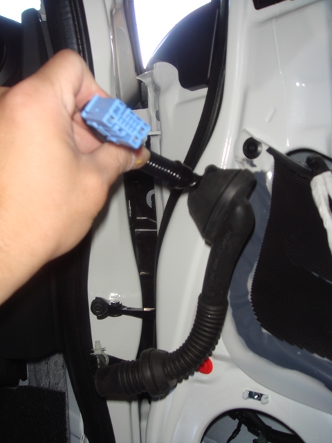

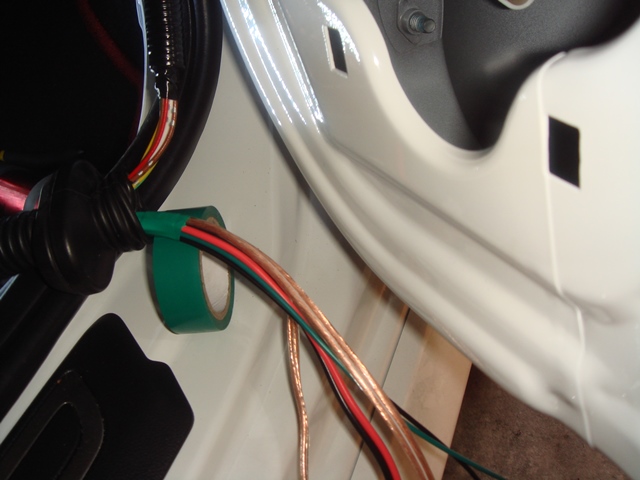

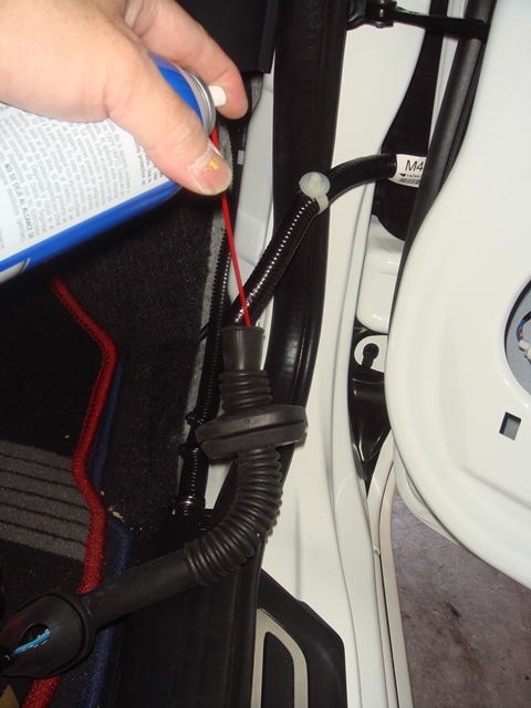

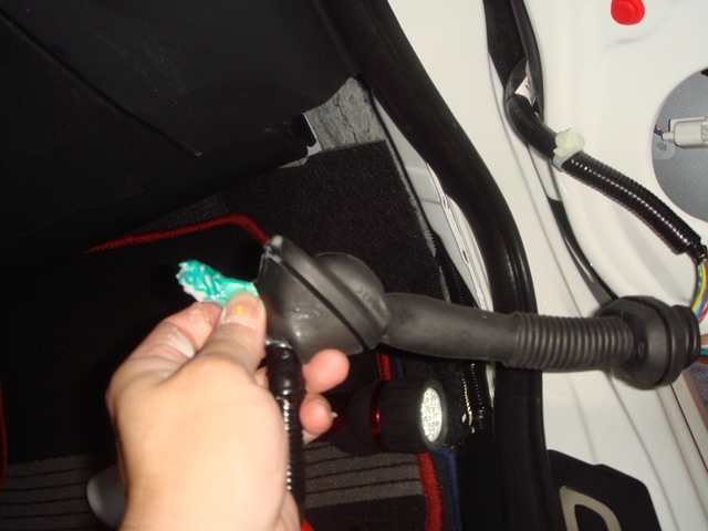

I have another tips for Pushing the Wire through RIGHT (PASSENGER) Door Rubber Boot !
I was able to complete pushing 2 meters, long 8 separate wire through the Right Door Rubber boot in less than 5 minutes !!!
(Last week, The LEFT door rubber boot took me more than 2 hours, I think almost 3 hours, and make some of my finger nail bleeding,...
this RIGHT door rubber boot today, well, I don't even break a sweat !!!, I mean 5 minutes vs. 3 almost hours !!!, experience is very important in life hahaha )
Here is what I did:

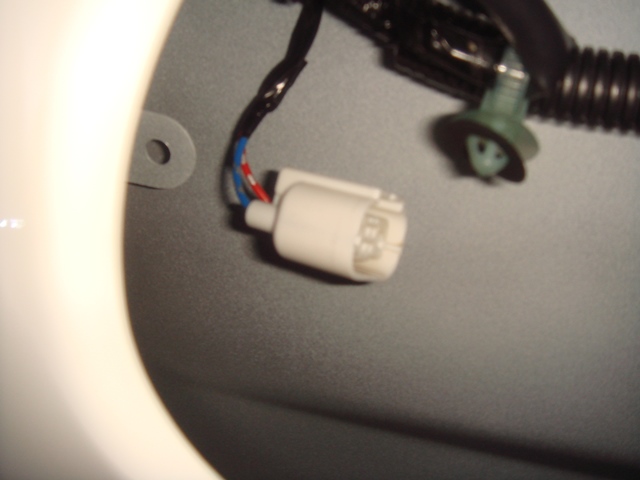

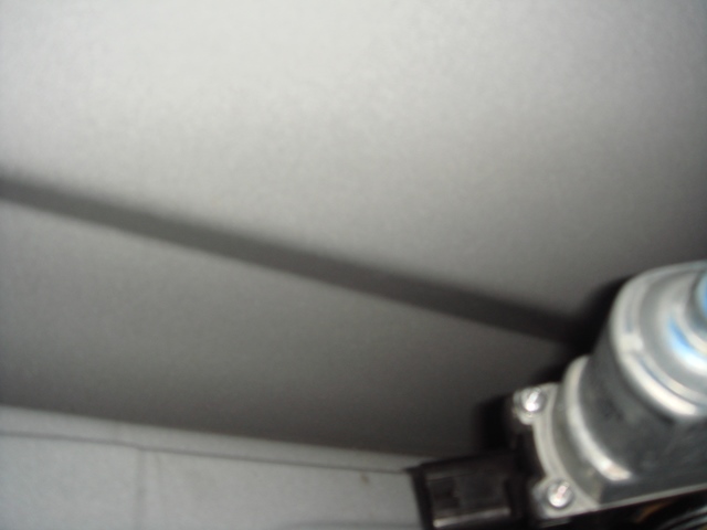

Disconnect the Power Window Motor Wire Connector:
Power Window Motor:
Disconnect all wire clip (that hold the wiring to the door metal panel),
then disconnect the entire door connector inside the right side kick panel,
this connector, (and pull it out with the rubber boot).
The Right door had advantage because we can disconnect the connector above, while the Left door connector were connected to the fuse box (so a bit harder to disconnect).
After you disconnect, we can make a straight path through the rubber boot, and this make it so much easier,
and
as usual the secret ingredient is Silicone Grease, spray a lot of it inside the rubber boot,
Voila, so easy to push the wiring through the rubber boot:

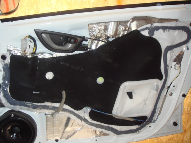

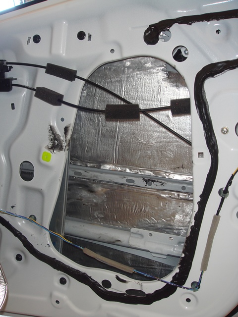

Then I start covering all the wiring with electrical tape and later I cover them with wire hose protector:
with wiring insider RIGHT door done,
and sounddampening inside RIGHT door done,

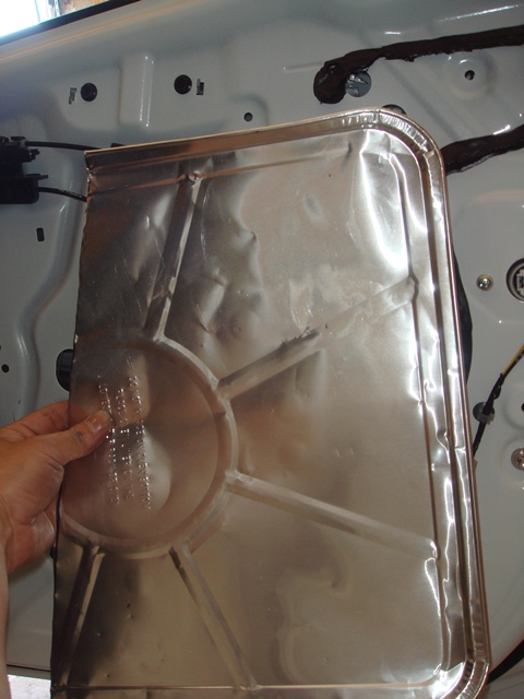

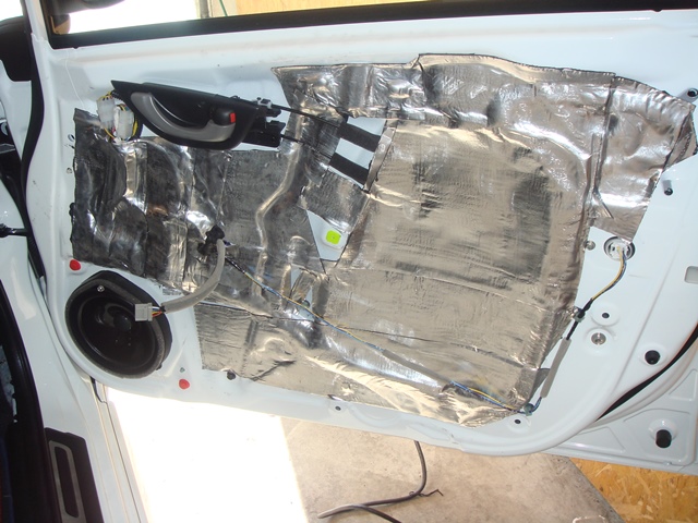

now I am going to cover this hole:
with this aluminum sheet (cut from baking foil bought at Walmart at Cooking equipment section hahaha ):
covered both holes with aluminum sheet:
Covered with more CLD Tiles Sound dampening:
Covered back with Factory original foam:
Here is what I did:
and

Hi Marty,
The Aluminum Foil (from the backing plate) is just for Backing Plate to cover the holes,
and on top of it, I put the actual sound deadening/CLD Tiles.
The CLD Tiles (the actual sound deadening) had sticky surface
that had to be attached to some hard surface, so the aluminum sheet is acting like the Fiber in Carbon Fiber mixture/composite,...
or like ReBar inside a Concrete mix...
The CLD Tiles it self had 2 surface,
one is the sticky one, and the other is the surface cover with aluminum sheet on it's own. but it is a very thin aluminum sheet so it is not strong enough... that is why I need the aluminum backing plate.
I bought my CLD tiles (popularly known as Dynamat) based from recommendation from another member here name "FIT4SPL".
and this is the place where I order them:
Car Auto Audio Sound Dampening Deadener 1 SQ FT GTmat Pro 80 Mil
I bought the 100 Square Feet Rolls like 3 months ago,
because they have very cheap special at that time,
It was only $139.98 already include shipping cost !!!
so it was very cheap !!!
(but now the price back to regular price of $194.99)
I think 50 Square feet rolls is enough to cover the entire car,
but they have it so cheap, I could not resist buying 100 Square feet...
hopefully I can buy another car before this CLD Tiles adhesive when bad in a few years hahaha
Here is what they looks like:

USPS deliver the Relay Socket from FRYS today,
so I decided to start building the relay and diode circuit.
Here it is,
Start by plugging 2 relay on to 2 sockets,
then putting both Relay's into it's own clear plastic packaging.
To route the cable, I cut holes on the clear plastic.
(My nail was still yellow from painting my brake caliper hahaha)...
Ok, here is the schematic:
As you can see on the schematic above,
First Relay is the one connected to the 12 volts permanent power that I am going to get from tapping an empty fuse location on fuse box.
The 12 volts will be triggered on (Normally Open) by the Parking Light Wire.
The Second Relay getting the power from the output of the first relay.
and The Second Relay Output wire is connected to Normally Closed position.The Trigger is going to came from Fuse#13 (Accessory),
so when the Key turn to ACC, the Second Relay will NOT have any output,
but when the Key turn to OFF, then the second Relay will allow current from the first relay to pass through into the Diode and later to the Turn Signal LED.
This mean the Turn Signal will only be turn on when key is at off position,
and alarm is triggering the parking light to blink when lock or unlock !
The only weakness is, if you turn the key to OFF position, but you forgot to turn off your parking light before you turn the key to OFF position. this mean the turn signal light will all light up (not blinking) because the parking light were on.

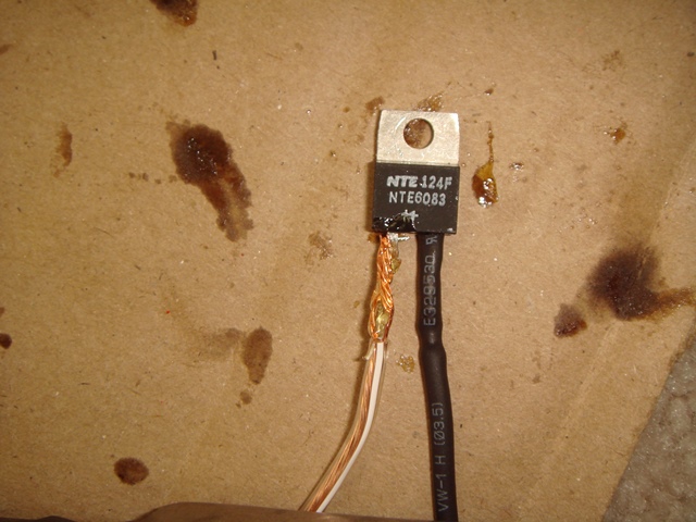

After the second relay, we have Diode for each side (2 diode for left and right), this to prevent the Right Turn Signal from blinking when we just want Left Turn signal turn on (like when we are doing a left turn while driving)
and vice versa. otherwise each time you trigger one side turn signal, both side will be blinking like hazard light mode.

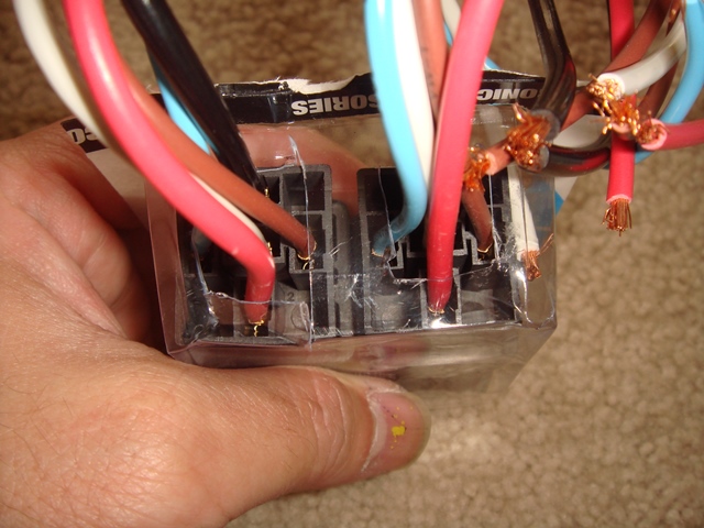

on this picture below, it show I connect output of First Relay to Input of Second Relay:
on this picture below it show I soldered each relay Ground (from the Trigger signal) together into just one single ground cable, that later will be connected to the chassis for ground.
This picture below show how I soldered and then shrink warp the diode.
The Right leg is connected to the Second Relay output, and the Left Leg is going to be connected to the turn signal wire (car wire).
the picture below show how I shrink warp both leg of the diode,
and then cover the heat sink of the diode with shrink wrap too,
cause the heat sink actually connected to the left leg of the diode,
so I don't want the heat sink to ever touch the chassis cause this will
blow the fuse from short circuit. I also think the heat sink will never get warm anyway
since the current that going to pass through is well below the
capability of this diode !

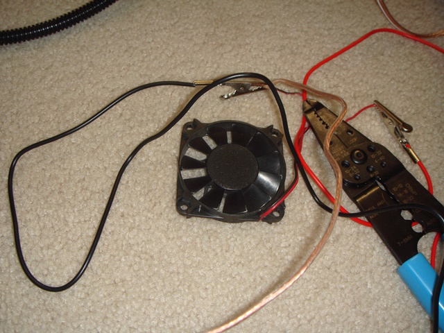

after all wire connected, I do testing with 9 volts battery and small computer fan (to replace the LED since I don't have any LED right now).
everything went well on the test !

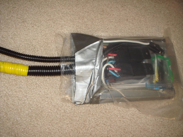

so I start doing the final packaging by putting the diode into it's own clear plastic packaging then combine with the relay packaging into a bigger plastic packaging. This to make them easier to be placed under the dash panel and also safe from any short circuit trouble.
here are the final pictures:
Now they are ready to be installed,

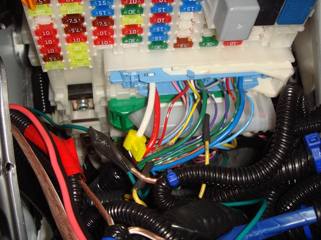

HEATED MIRROR CONNECTION:
I have not connected the Heated Mirror, so today, I am going to do it,

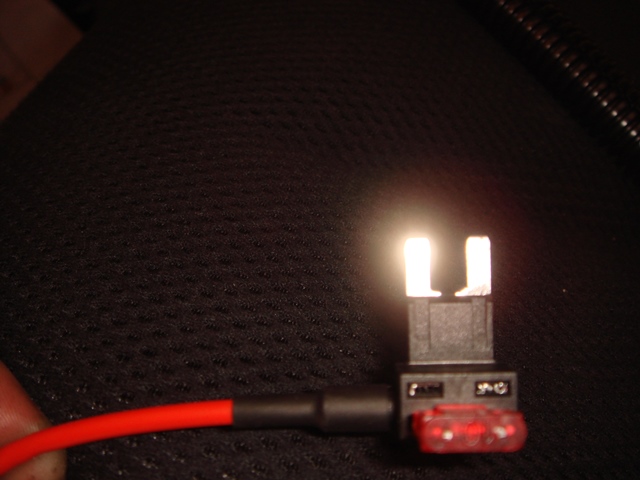

I use TAP A FUSE, and tap Fuse Location #55, shown at the pictures below. Before I connect/soldered the wire, I check and this fuse only have power when I press the Rear Defogger Switch on the dashboard,
so this is the CORRECT one to tap !
Now, the tap a fuse had 2 slot, one for the incumbent connection,
the other for the new connection,
since inside Fuse #55 it only have one pin, that mean it do not have any
incumbent connection going anywhere, so you can just use 1 fuse
for the new connection. (although it is better to put 2 fuse, so you can plug the tap a fuse either way, left or right, this is kinda hard to explain until you plug it in yourself and notice that if you just use 1 fuse, then
the plug can only be plug 1 way (either left or right), the other way will
result in no power).
Take a real close look and you will notice that I just CUT the GREY Wire,
This Grey Wire is the connection to the Parking Light,
and I will use this as the Trigger to Relay#1
Now below is Fuse#13 which only have power when we turn the key to ACC position, I need this for Trigger to Relay#2 :
Finally, I need CONSTANT Always on power for the Power input into Relay#1, and I tap it from Fuse#45 (empty fuse) always ON.
Another pictures after I soldered all the connection, and then time to test
When I test it, everything works as expected

I had connect all the connection (LED Blinker, Folding Motor, and Mirror HEATER),
I will update this thread again once I had extra budget to buy the JDM Automatic Folding and Automatic Tilt Function
