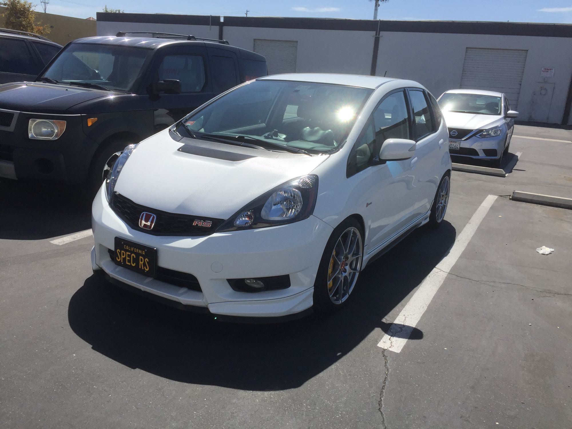

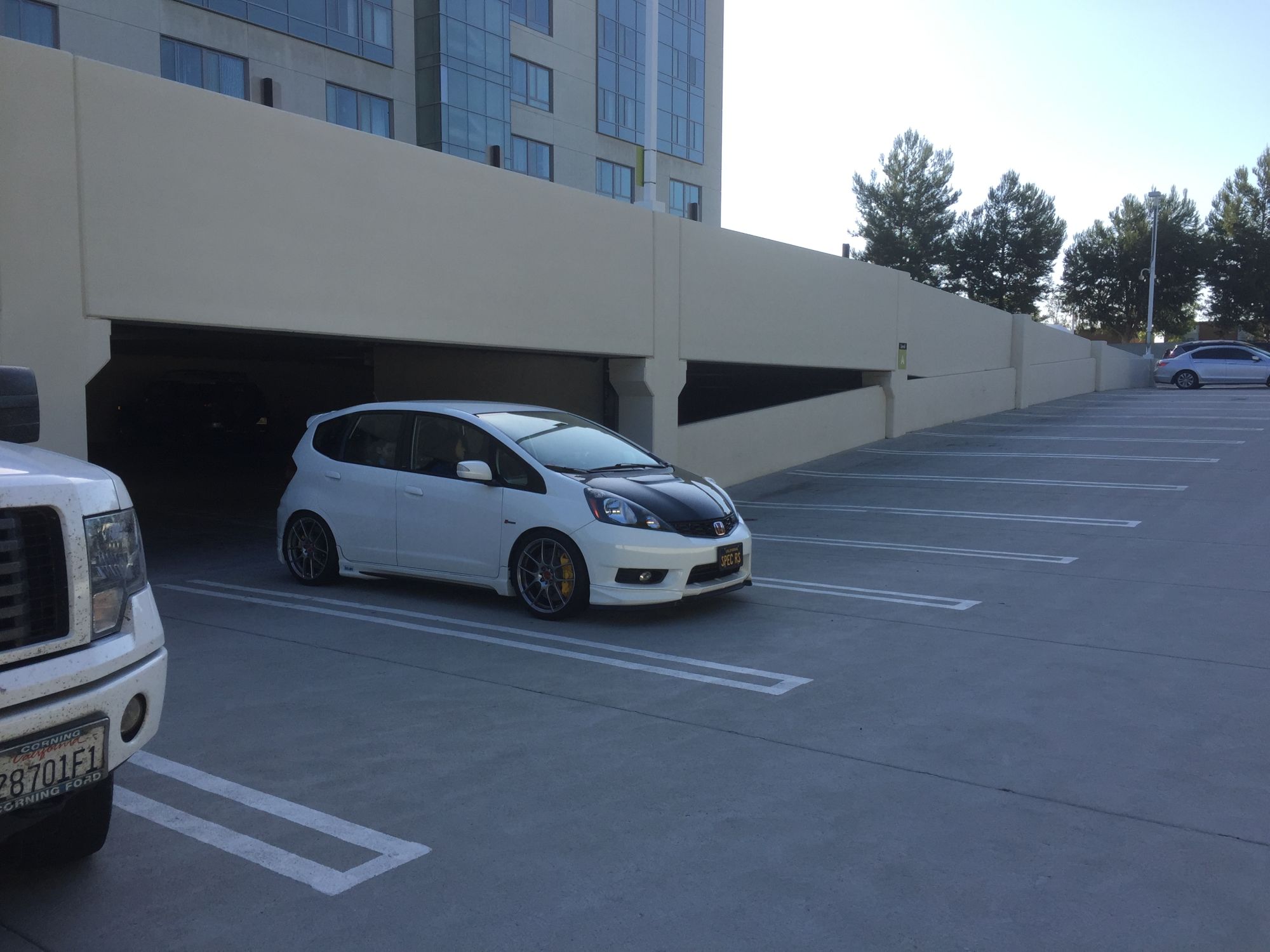

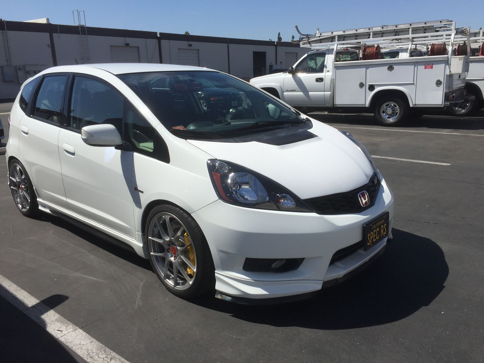

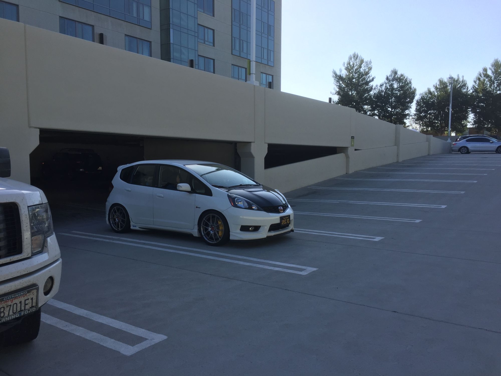

by the way, I test drive the car on freeway today,
and I pay attention to my Defi Water Temp gauge...
This is what I notice:
the water temp gauge stay at around 72 to 74 Celsius most of the time which is just 1 or 2 degree better than before,
but the main difference is how fast the engine cool down...
so when I accelerate hard, the Defi show my temp shoot up fast to either 80 Celsius or in some case above that...
but once I coast back, the temp goes down back to 72 to 74 Celsius much faster than before...
so this Vented Carbon Fiber Hood do NOT prevent the engine temp from spiking up when the boost kick in,
but it do help cool it down much faster...
once Park, I hold the hood area in front of the ventilation and the hood feel cold, but the area behind the ventilation is warm, plus the ventilation itself emit a warm flow of heat so it does work even when park with engine off...
The fender also feel cooler to touch...
Overall, it is NOT perfect but I don't expect perfection for that price
I am happy with the hood, now just need to save money for painting it white
Here is another picture that I took today after the test drive on Freeway:

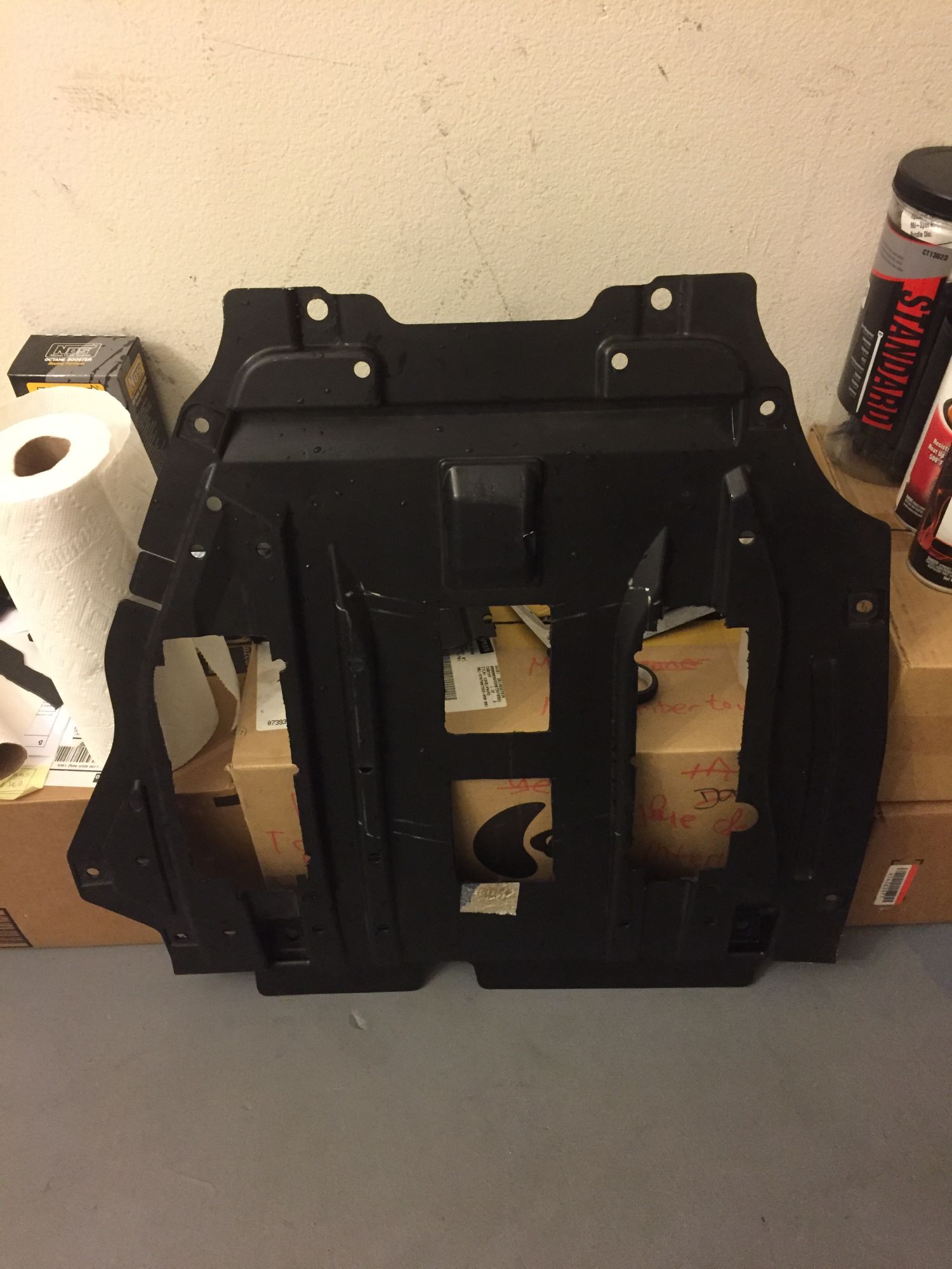

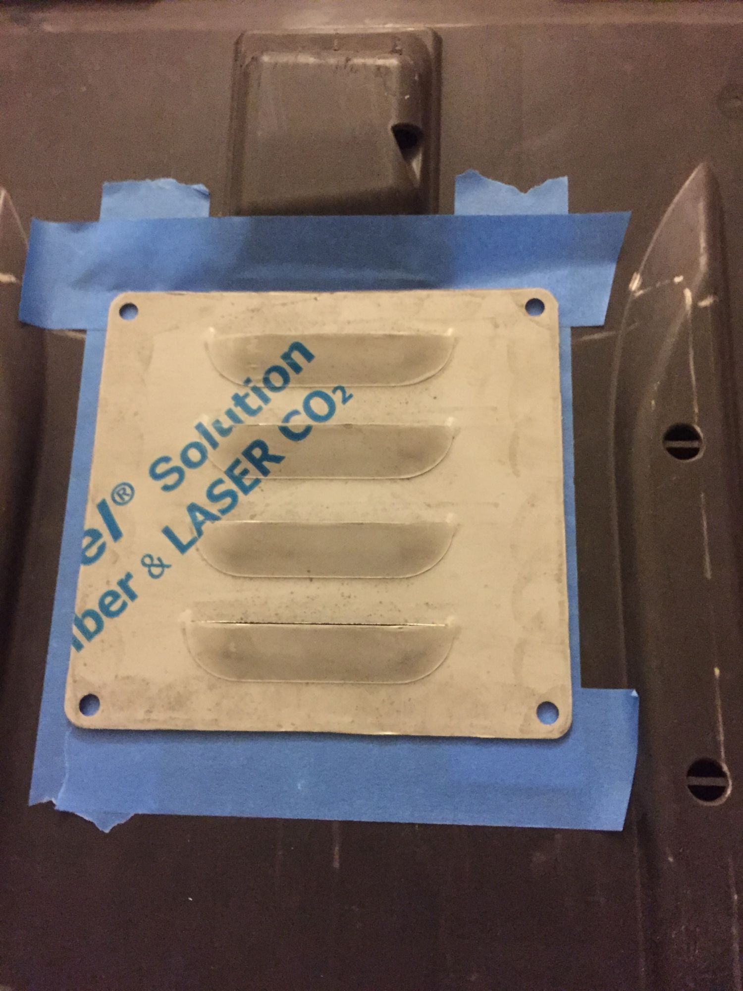

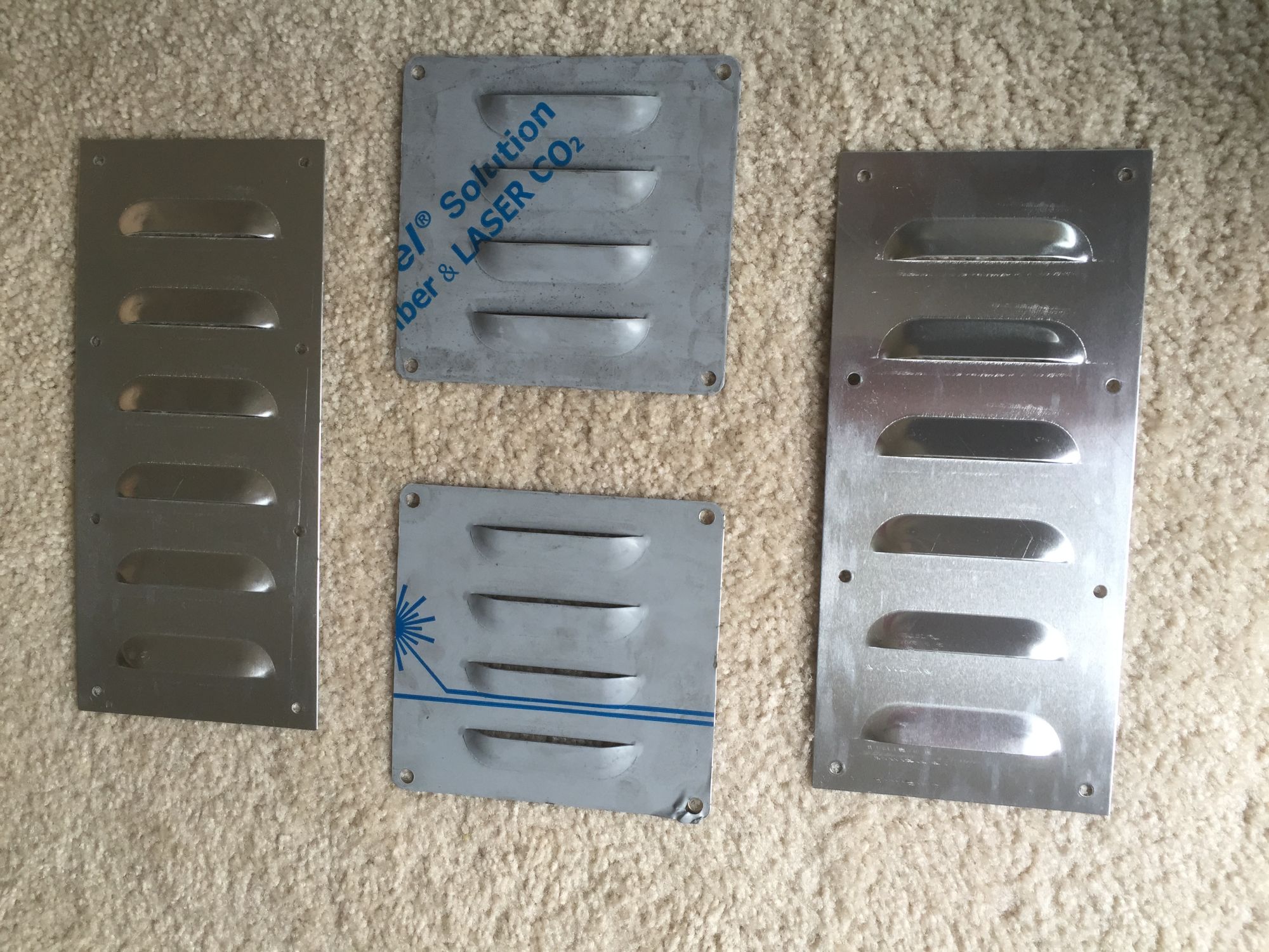

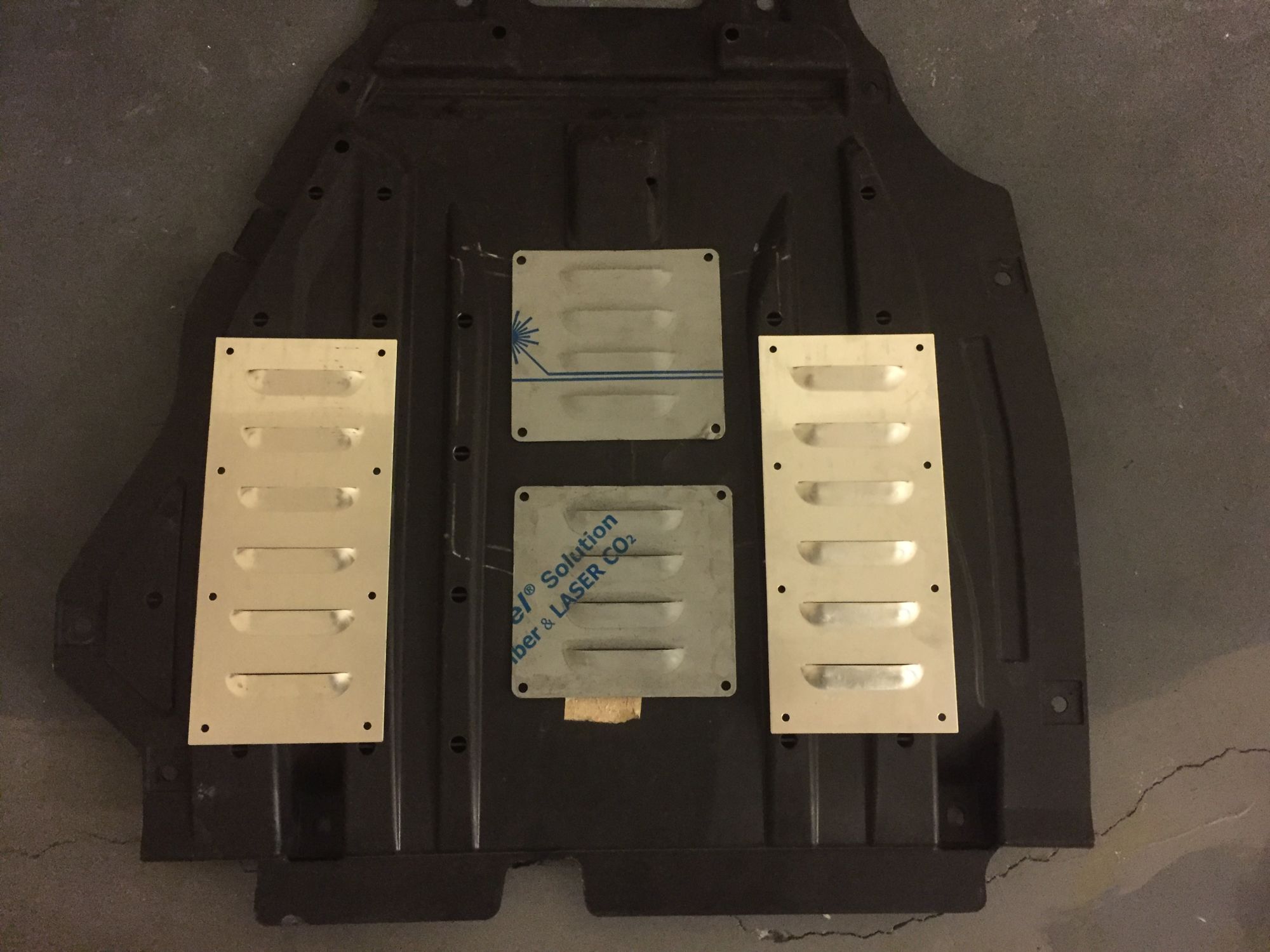

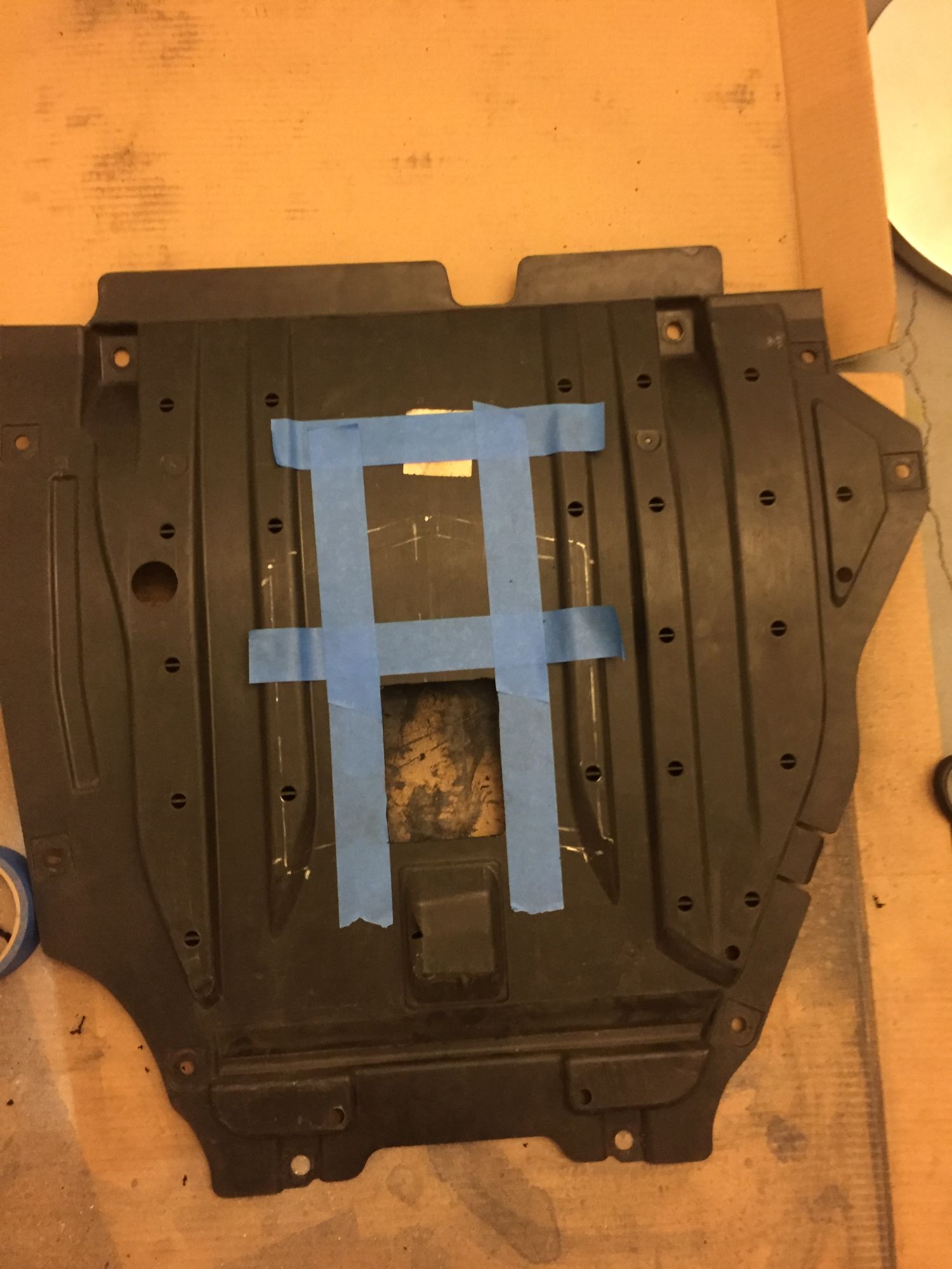

Project Air Flow continue today with the arrival of the Aluminum and Stainless Steel Louvers
I am going to modified my CR-Z lower engine cover to have this Louvers
integrated into it (aka cut, make a hole and epoxy plus some bolt/nut)
I will post DIY by this weekend

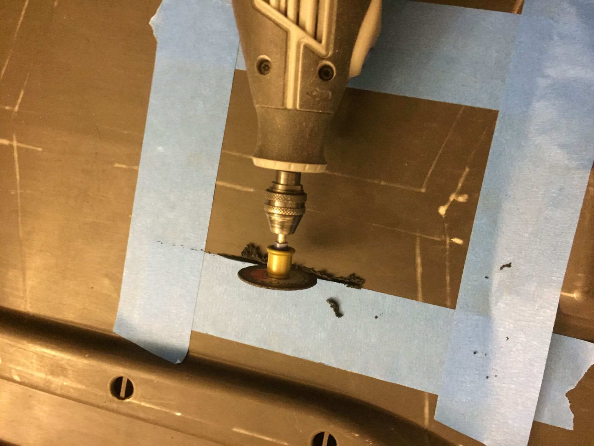

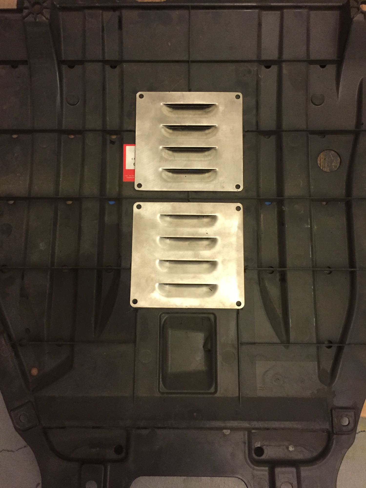

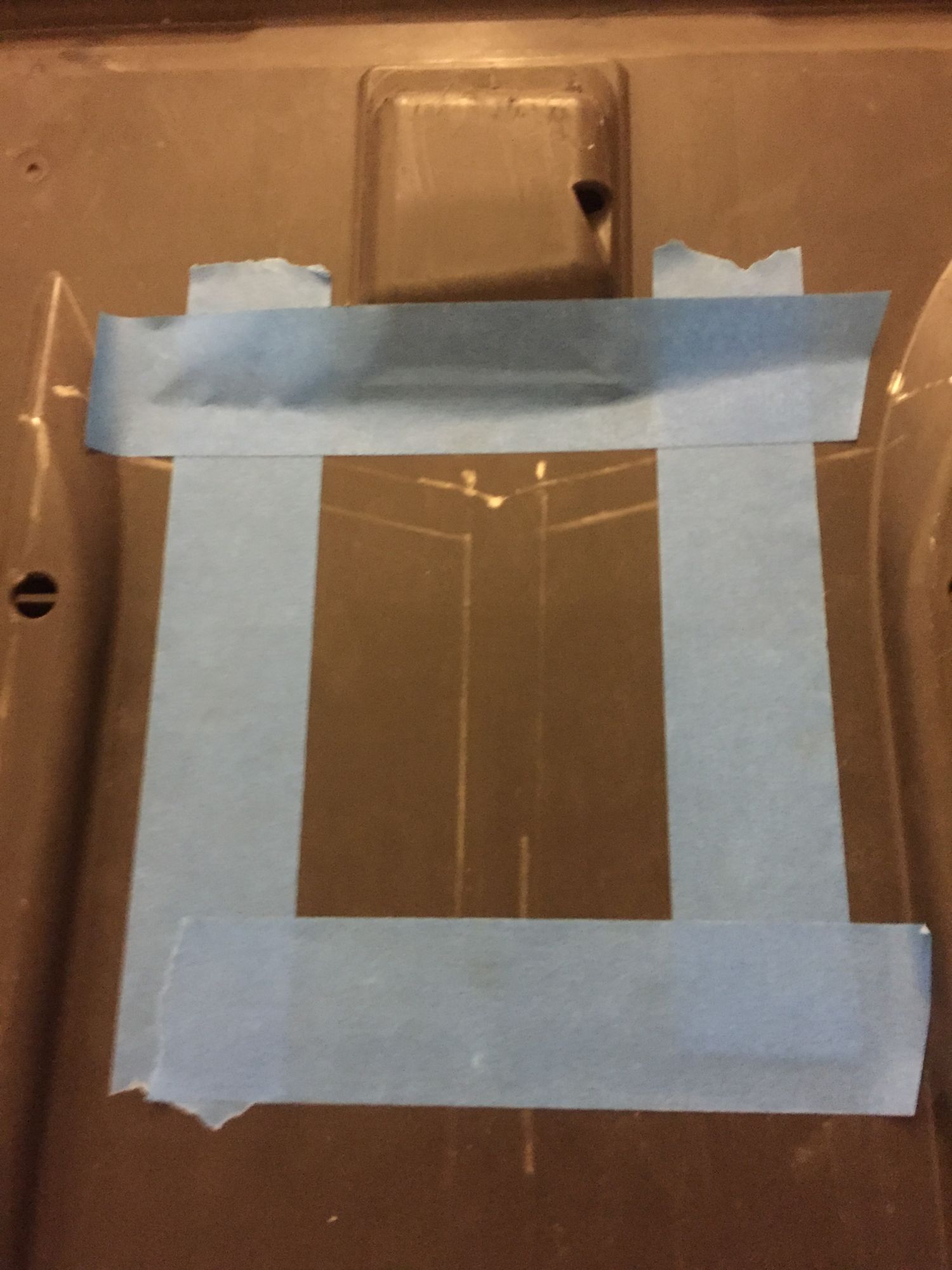

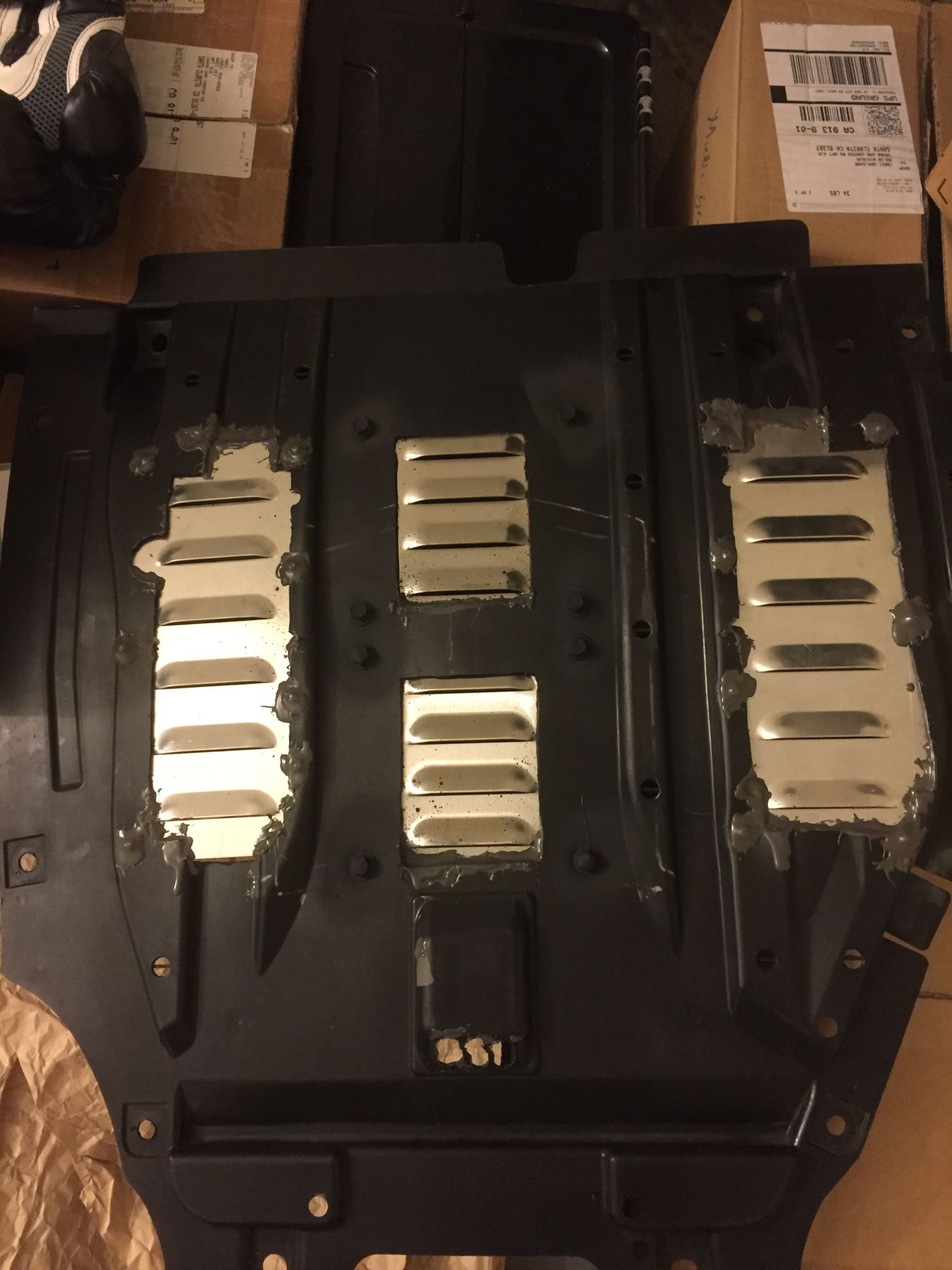

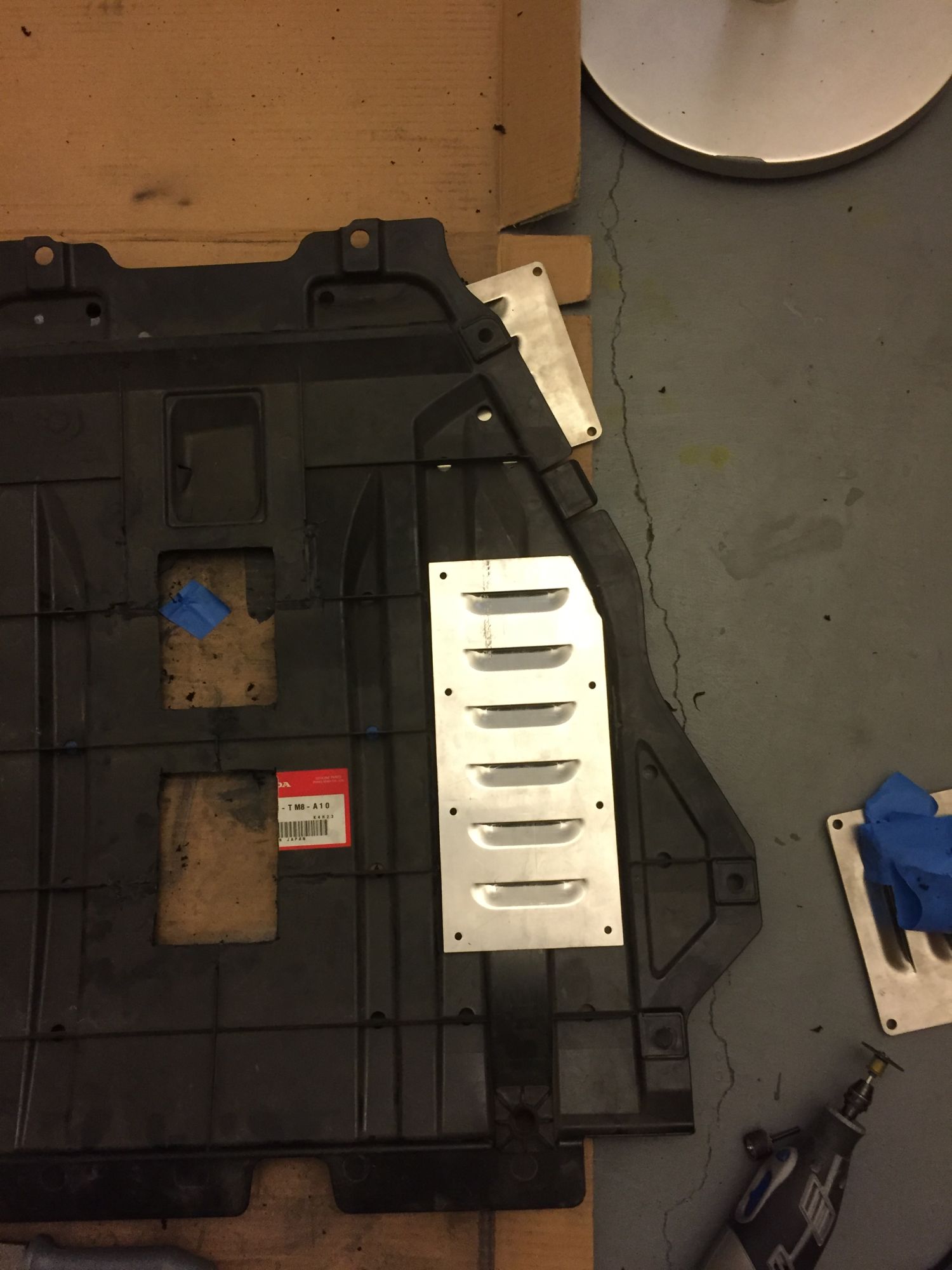

Project Air Flow moving a bit today
I make holes for all louvers to be flush with the CR-Z lower engine cover using Dremel:
Too tired today,
will bolt the louvers with bolt/nut tomorrow then use Epoxy to SEAL and SECURE them...
well, hopefully I have a little free time tomorrow to do this...
not in a hurry to install this back,
I still want my Setrab oil cooler and SPAL radiator fan to be fully operational before putting this cover back...
Attached Thumbnails Project Air Flow (including JDP Carbon Fiber Vented Hood)-80-img_2044_f379f022db64237358948a9fb83ceabdcf2cb552.jpg   Project Air Flow (including JDP Carbon Fiber Vented Hood)-80-img_2045_bc0c4d5b1cde638c87d7dd263dfb852ef15219e3.jpg   Project Air Flow (including JDP Carbon Fiber Vented Hood)-80-img_2047_2d881d828d54ffac85873a79da419563474ea4ea.jpg   Project Air Flow (including JDP Carbon Fiber Vented Hood)-80-img_2048_93a5f2e218bbe7255eaf8f8741d1acb3588fb368.jpg   Project Air Flow (including JDP Carbon Fiber Vented Hood)-80-img_2049_2a2fc081fd386f547af0e197483003853d28fa97.jpg
Project Air Flow (including JDP Carbon Fiber Vented Hood)-80-img_2050_49f77d63edff2714087c35dd566b7bc904b02dea.jpg   Project Air Flow (including JDP Carbon Fiber Vented Hood)-80-img_2051_a507b7b2d5eb2142575c70d8833c759dee2bcbf4.jpg   Project Air Flow (including JDP Carbon Fiber Vented Hood)-80-img_2052_626dd231fcbf4b36d5677a003a892e5ca45815fb.jpg

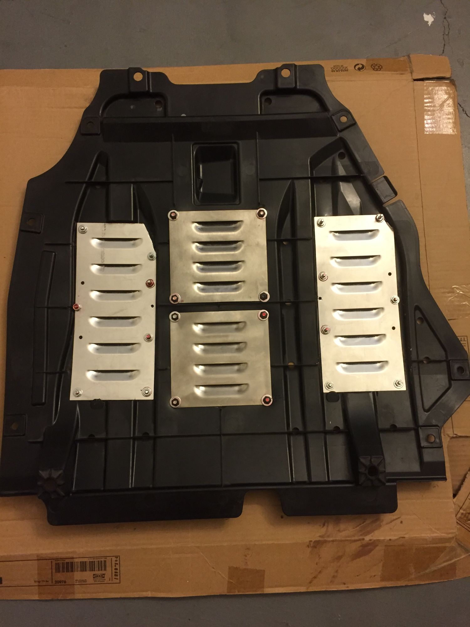

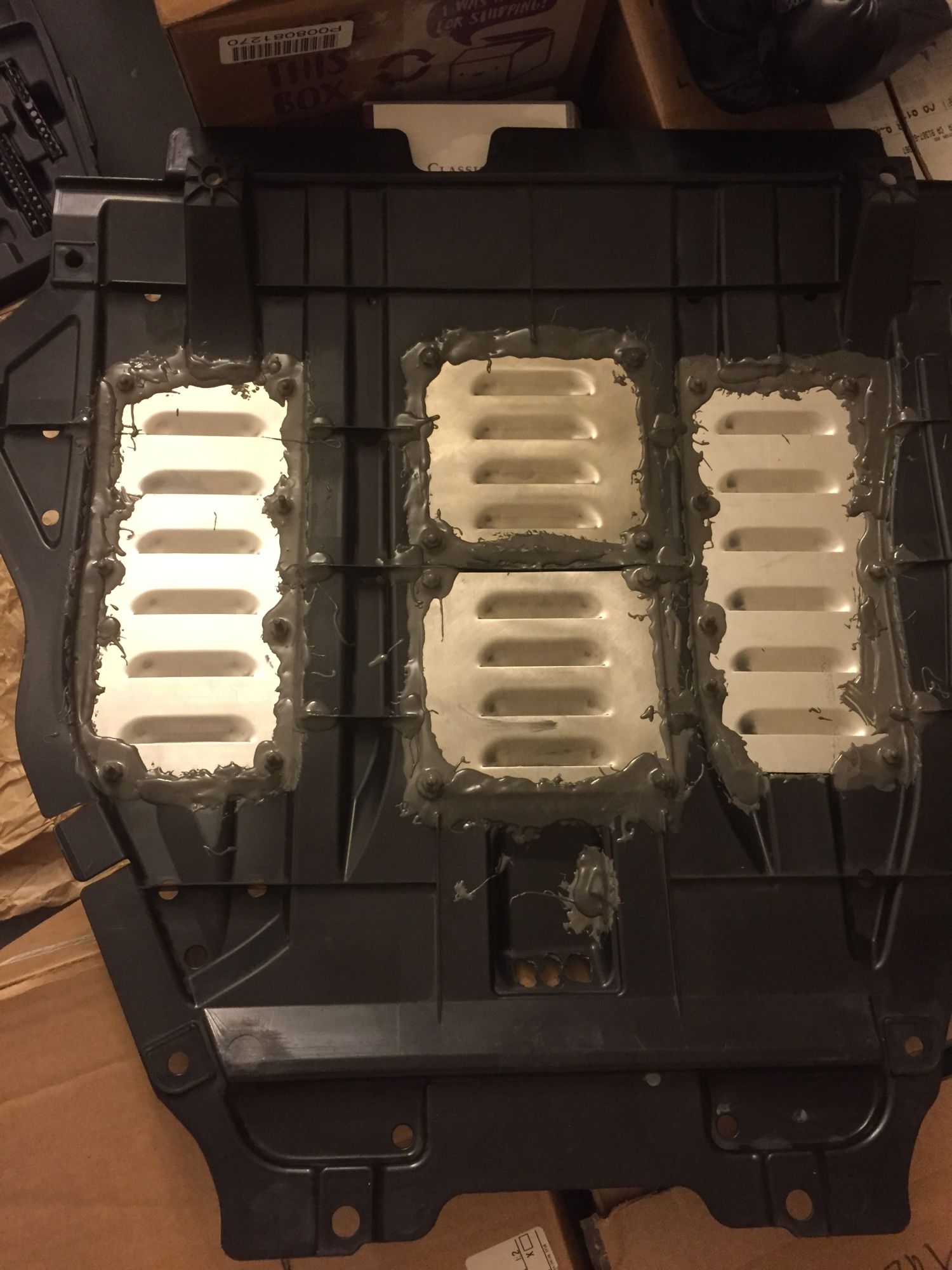

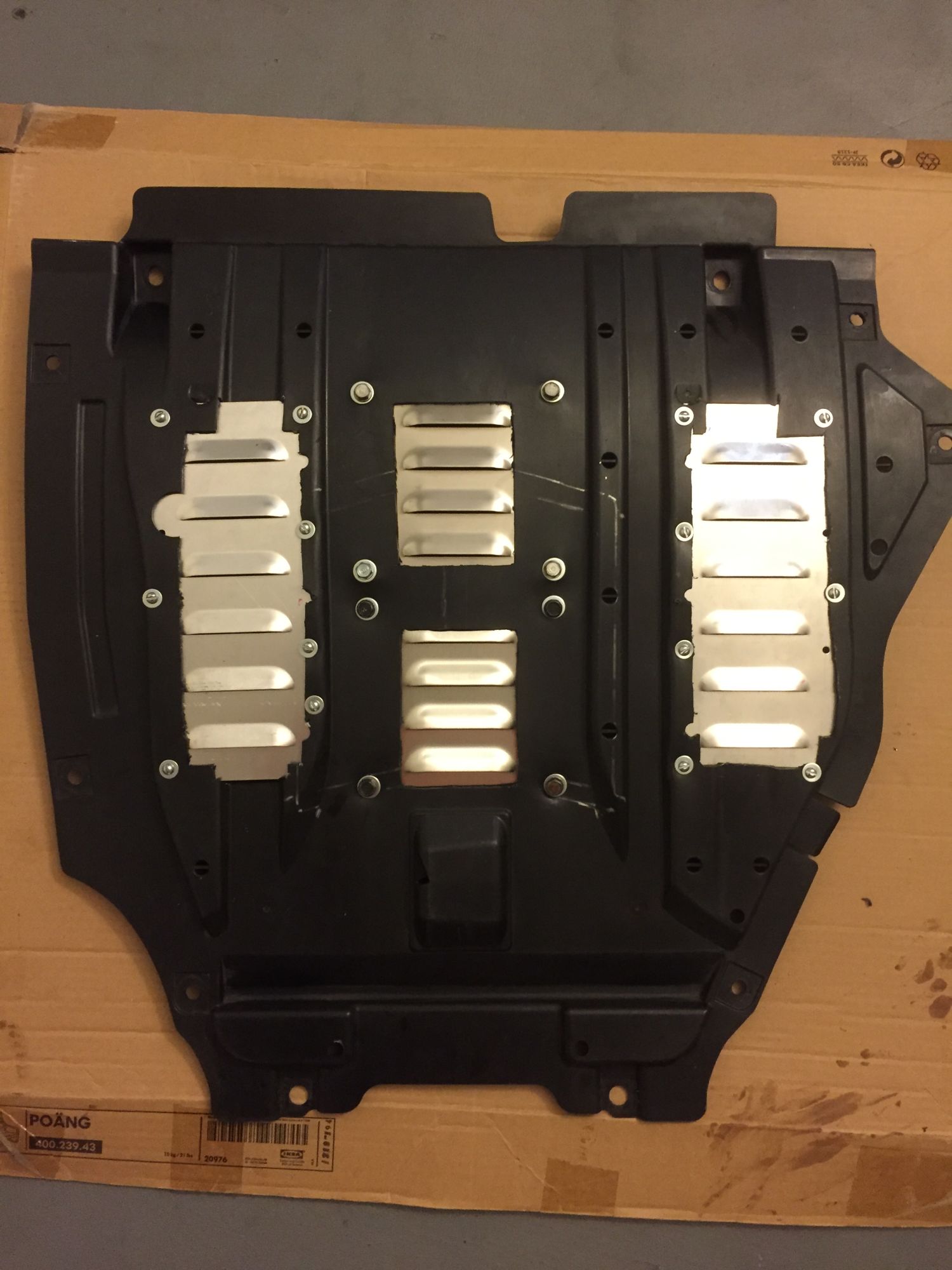

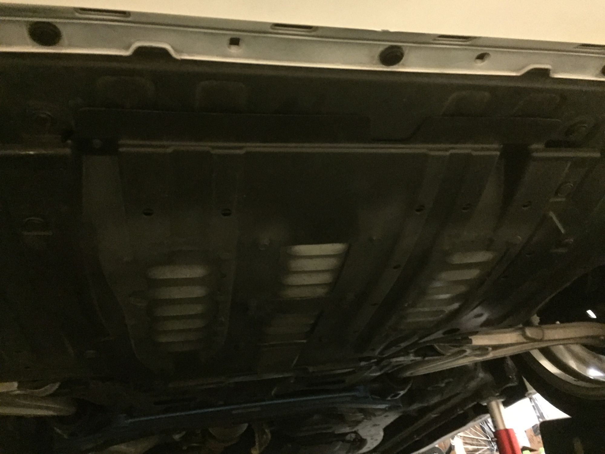

I can't rest until at least I attached the louvers with bolt and nut...
so I drill all the holes, secure almost every holes available with bolt and nut, use permanent loctite on the bolts and nuts, then I can take a rest
Tomorrow, if I have free time, I am going to use Epoxy to fill all the holes that is against the flow and to secure the louvers even better...
Attached Thumbnails Project Air Flow (including JDP Carbon Fiber Vented Hood)-80-img_2057_6e2bbeab363051e876dd921c9fd6d643606c9999.jpg   Project Air Flow (including JDP Carbon Fiber Vented Hood)-80-img_2058_8bcb911a1d1340af7f4f229dc4b3e28937b9ca82.jpg   Project Air Flow (including JDP Carbon Fiber Vented Hood)-80-img_2060_7b2c61503b741b47a9ba17fcd9e747259a866061.jpg

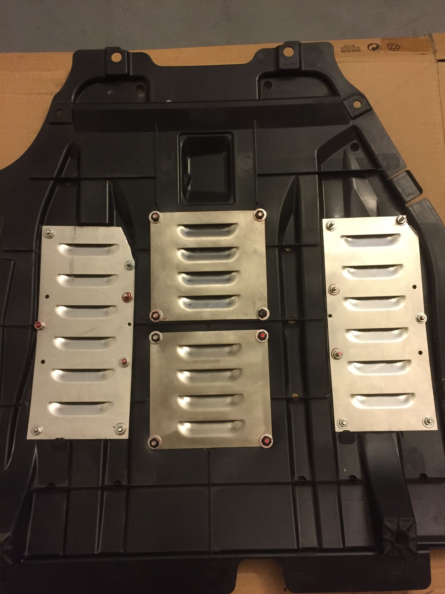

I finally finish with adding Louvers to the Honda CR-Z lower engine cover and secure it using bolt/nut plus further reinforcement and seals with epoxy. This should further help with both aerodynamic (down force) and effective cooling since now the air is forced to go through radiator and being suck by the louvers.
Attached Thumbnails Project Air Flow (including JDP Carbon Fiber Vented Hood)-80-img_2082_3cba3190f560998cebe99fee953d316c0defee85.jpg   Project Air Flow (including JDP Carbon Fiber Vented Hood)-80-img_2083_352c625c53e20126d09a0d73ce07a5f5ef6701d1.jpg

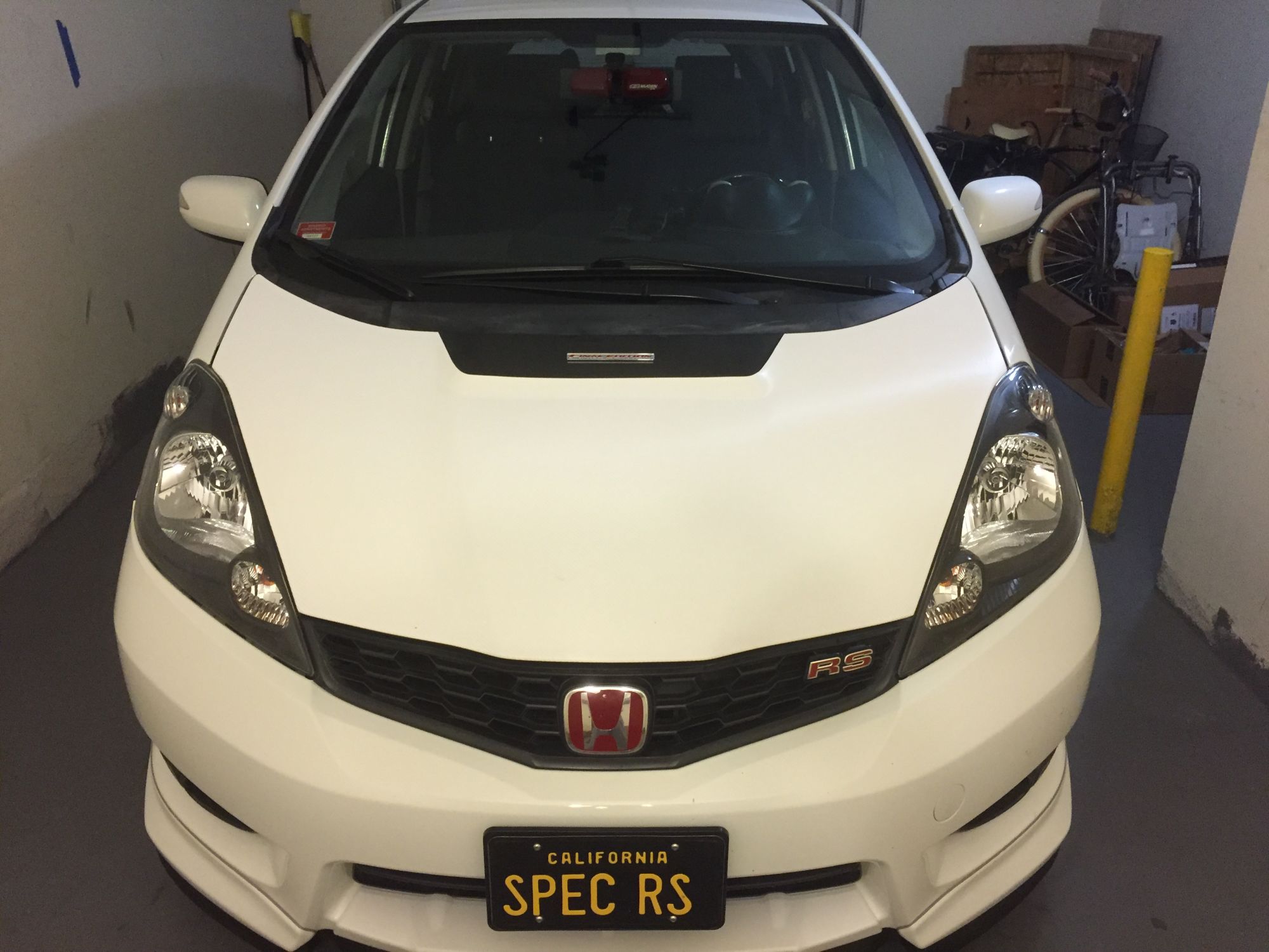

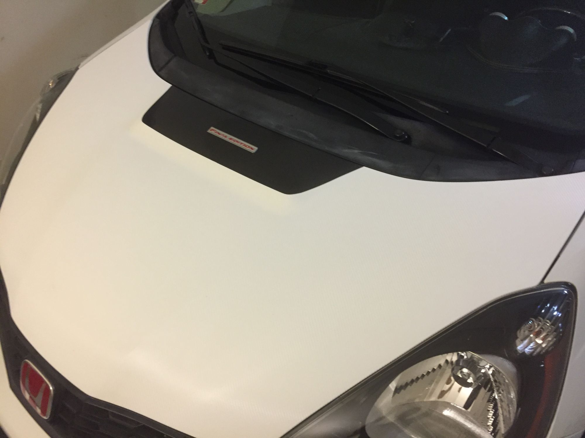

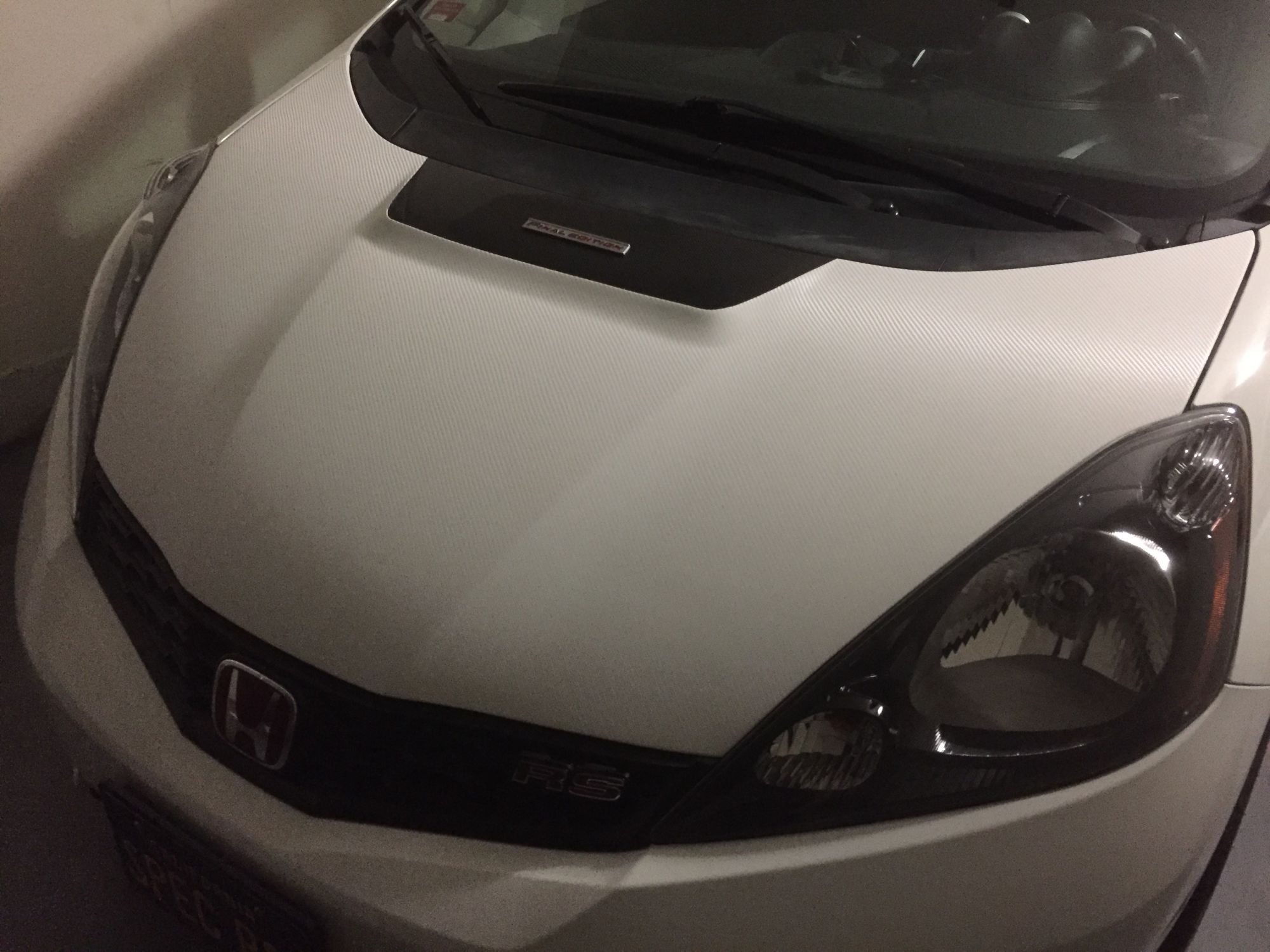

and, I also WRAP the JDP Vented Carbon Fiber Hood in 3M 1080 Carbon Fiber White Wrap today
Before:
AFTER:
Attached Thumbnails Project Air Flow (including JDP Carbon Fiber Vented Hood)-80-img_1934_467e5eb9e2e1af0597cefb0a1c11a46f4dd23cc1.jpg   Project Air Flow (including JDP Carbon Fiber Vented Hood)-80-img_2108_fbccfcaeb856ee3270b755846848985163a34a90.jpg   Project Air Flow (including JDP Carbon Fiber Vented Hood)-80-img_2110_0aa6dda3c328d638755fd995df54840b4ca75896.jpg

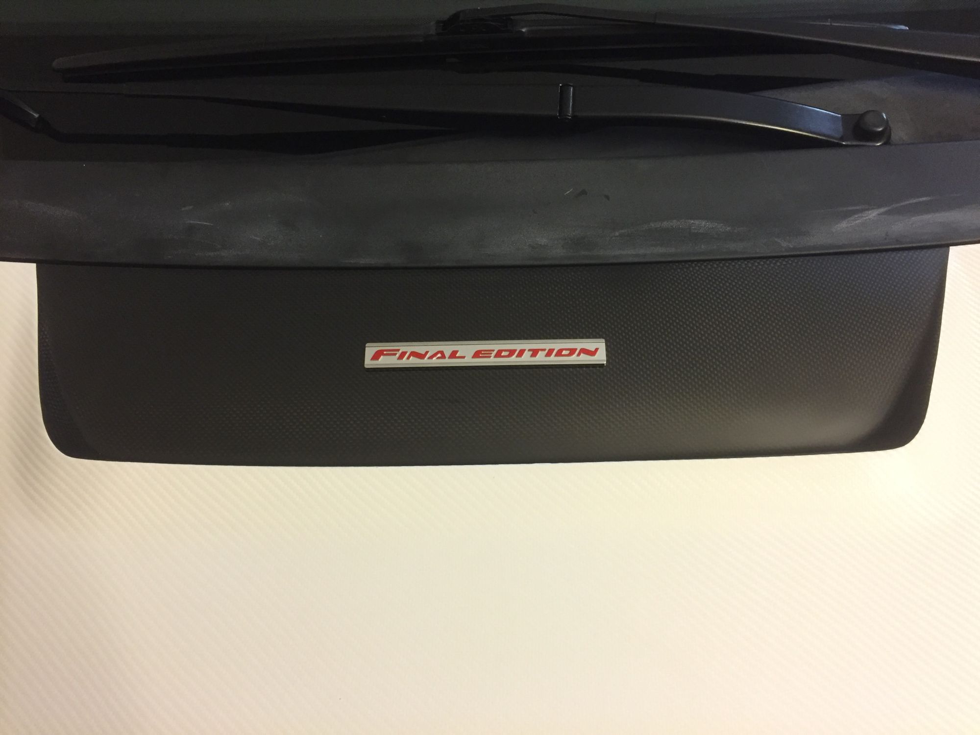

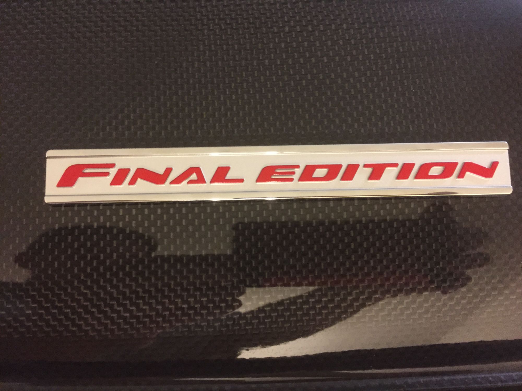

Add "FINAL EDITION" emblem
Attached Thumbnails Project Air Flow (including JDP Carbon Fiber Vented Hood)-80-img_2122_377206d0a0e627f3e9bc8763a4c3bf5f75c86511.jpg   Project Air Flow (including JDP Carbon Fiber Vented Hood)-80-img_2121_65011aebd553909cdc2898a0e89b331c71b4b2ce.jpg   Project Air Flow (including JDP Carbon Fiber Vented Hood)-80-img_2123_c0afc1684ff4d2922e69af562fcc4dce8ee8aec0.jpg   Project Air Flow (including JDP Carbon Fiber Vented Hood)-80-img_2129_ca25cf83656c56d67736f61a685675362fd3cd12.jpg   Project Air Flow (including JDP Carbon Fiber Vented Hood)-80-img_2130_a2ee3ef216c49a075257047bd84a0b4952626e6d.jpg

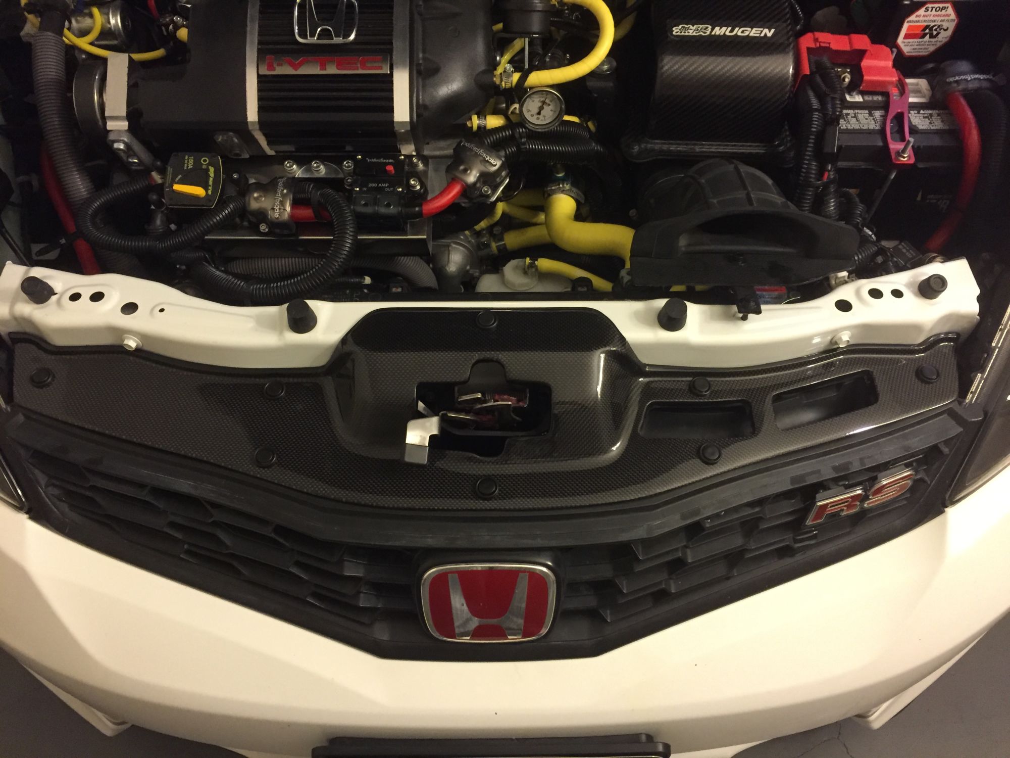

Today I finished my Setrab Oil Cooler Project,
so it's time to install the CR-Z lower underengine panel cover back,
I do notice than when idling/driving slow, the engine temperature is higher now...
but it cooled down at freeway speed...
so my plan is during fall/winter, I will use this CR-Z lower under panel so I get better aerodynamic, but during hot summer, it is still better to not have any under engine cover at all for ultimate engine cooling performance...

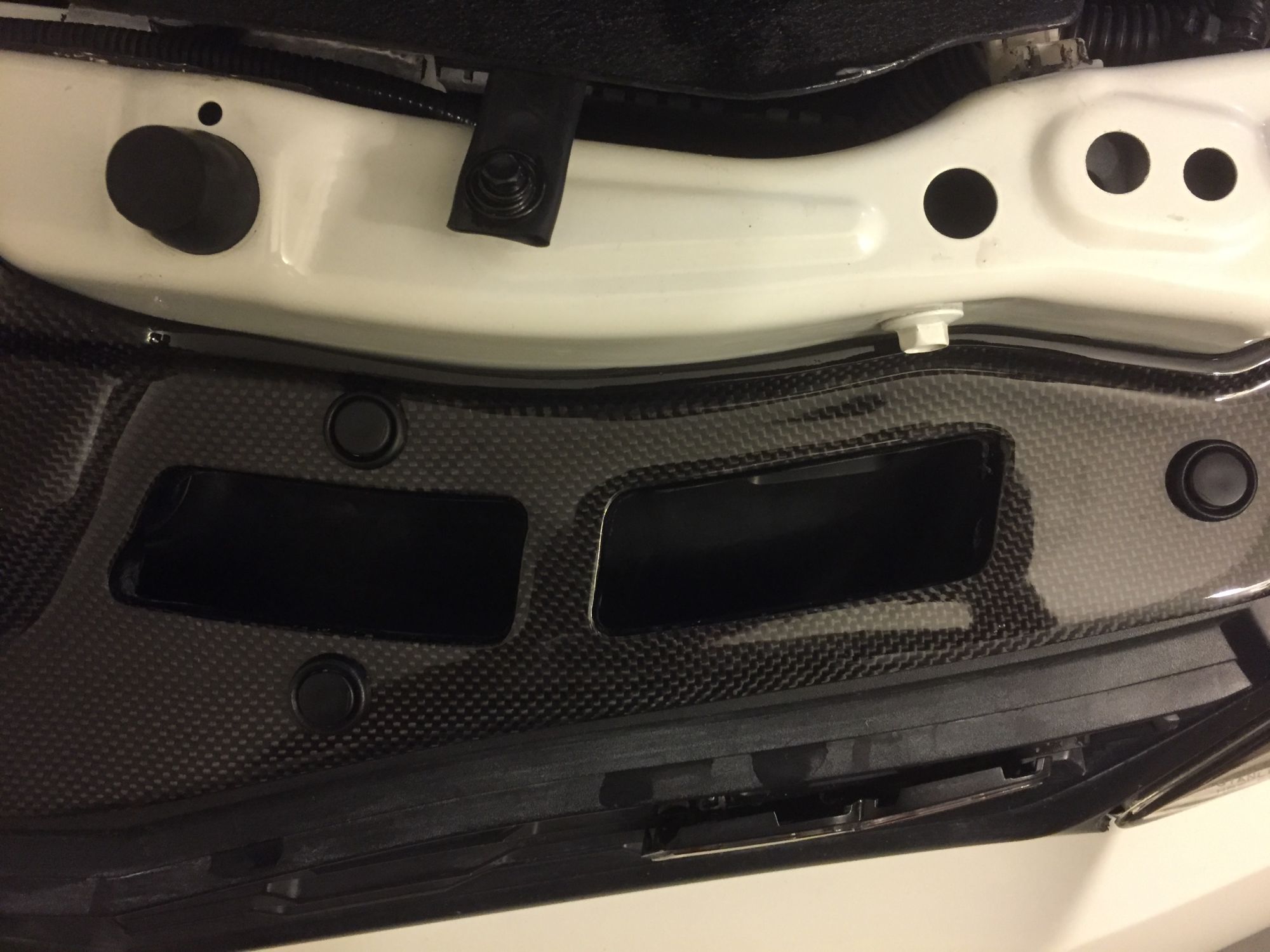

Oh, I also install JDP engineering Carbon Fiber Radiator Plate cover,
notice the larger outlet for the intake:
Attached Thumbnails Project Air Flow (including JDP Carbon Fiber Vented Hood)-80-img_2335_da06654ea7ca9067c48bd653386de8dc0ee912d0.jpg   Project Air Flow (including JDP Carbon Fiber Vented Hood)-80-img_2336_32f0b745d49f1e6a9c1e16f1469553f8c96c9943.jpg   Project Air Flow (including JDP Carbon Fiber Vented Hood)-80-img_2338_3c0ac760bef681d33194be805d626307a964b0d4.jpg

I remove the CR-Z lower engine cover because despite the louver vent, the temperature is still not as cool as if I don't use any cover at all, so I just want the most efficient cooling air flow as possible, little less aerodynamics is ok
