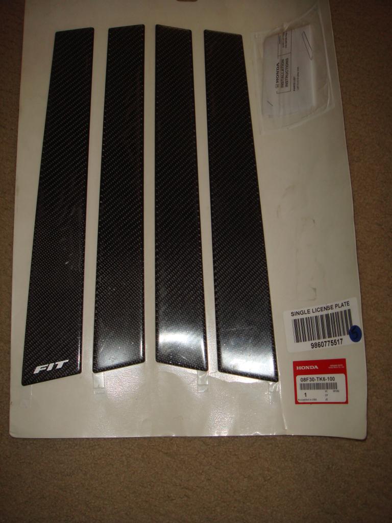

I install my Carbon Fiber B Pillar Trim (OEM Honda) today,
Turn out it is NOT real carbon fiber, but only sticker/decal look like Carbon Fiber.
It do look nice though...

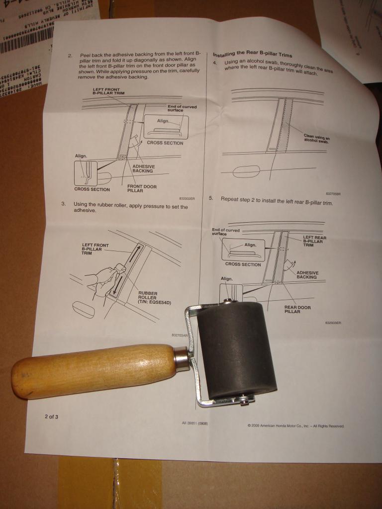

Installation Manual:

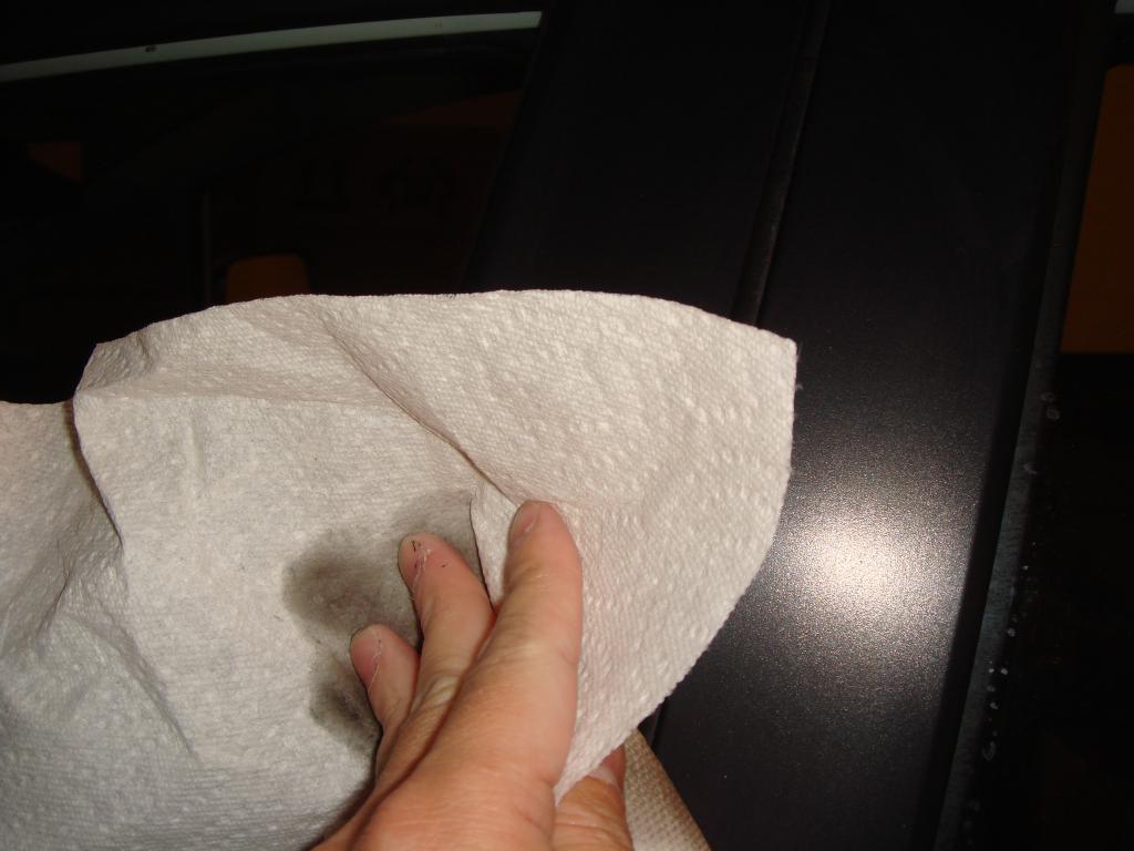

Use Alcohol to clean the surface:

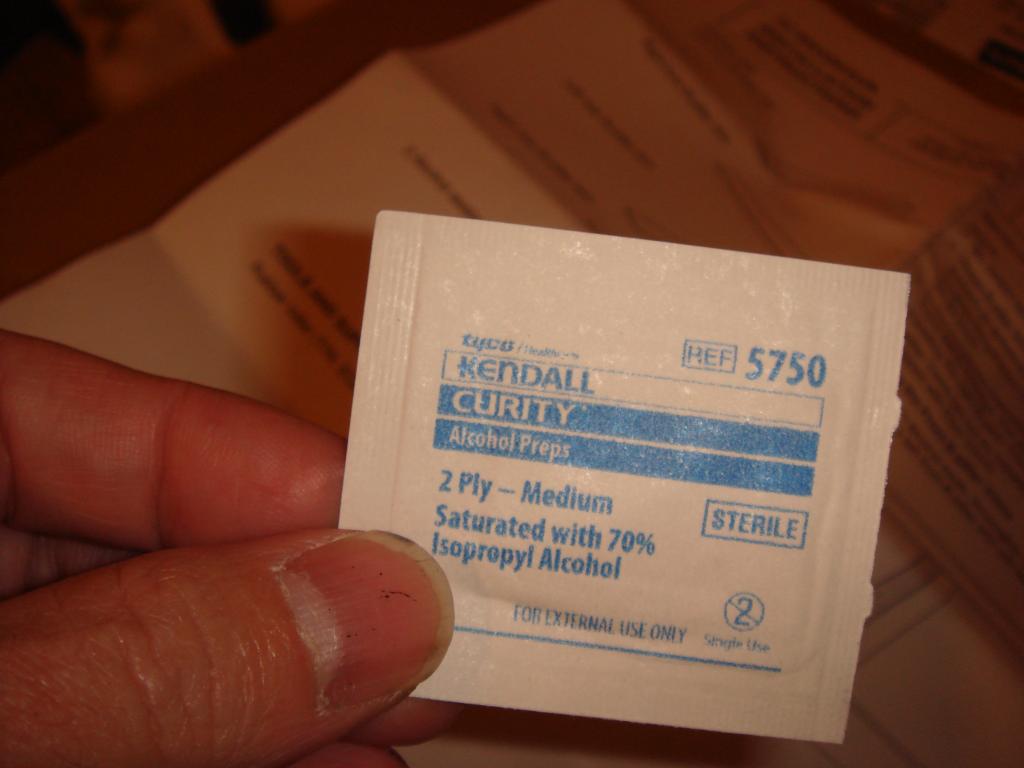

Alcohol swab that came with the package:

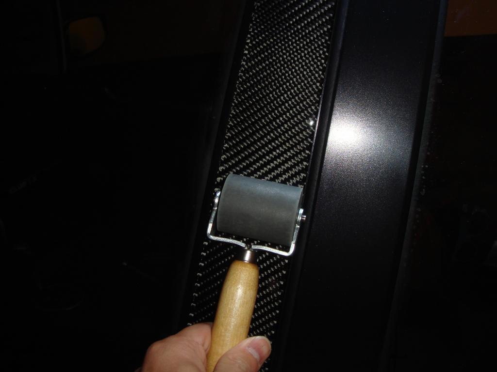

Put one side on and The manual show we need rubber roller, luckily I had one from my
sound deadening days:

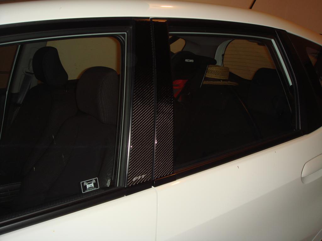

Installed:

In the photos it looks like real carbon...but maybe this way you won't have to worry about it yellowing or clear coat oxidation.
I love CF, but its a lot of work to maintain in sunny states.

Yes, you are correct Sir,
You can NOT install this if you have window visors.
It was specified on the installation manual.
