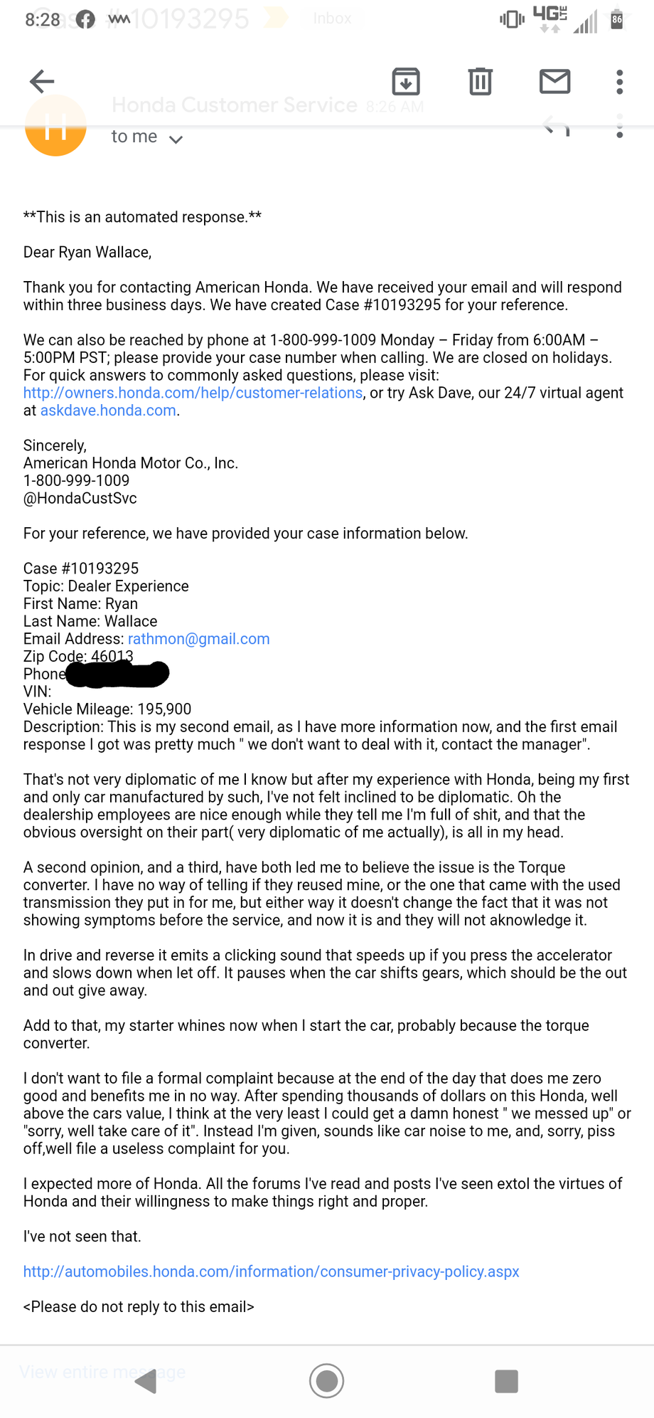

I think you have given Honda ample opportunity to repair the problem. I would not continue to pay them to fiddle with the car if the results are unsatisfactory. Sounds like good money after bad. Bring it to a local mechanic for evaluation and see what he has to say. Best of luck, Clay Colvin
Did so this morning. He did manage to convince me the sound is actually coming from the opposite side of the motor. He also said it sounds like exhaust in the engine.
What I struggle with, is that it wasn't there before, but is now. Ah well. Pretty well over it at this point. Perhaps the fit just isn't a good fit for me.
