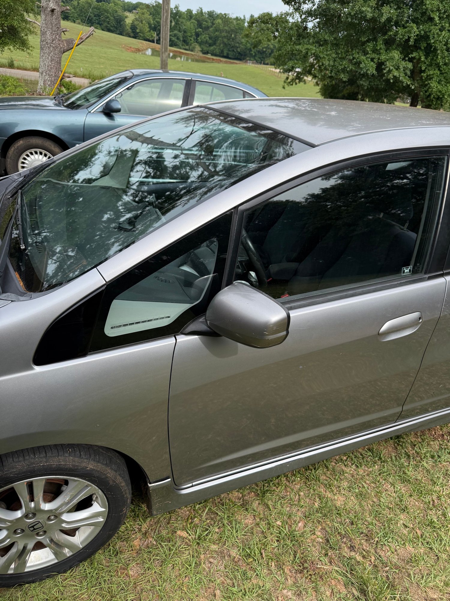

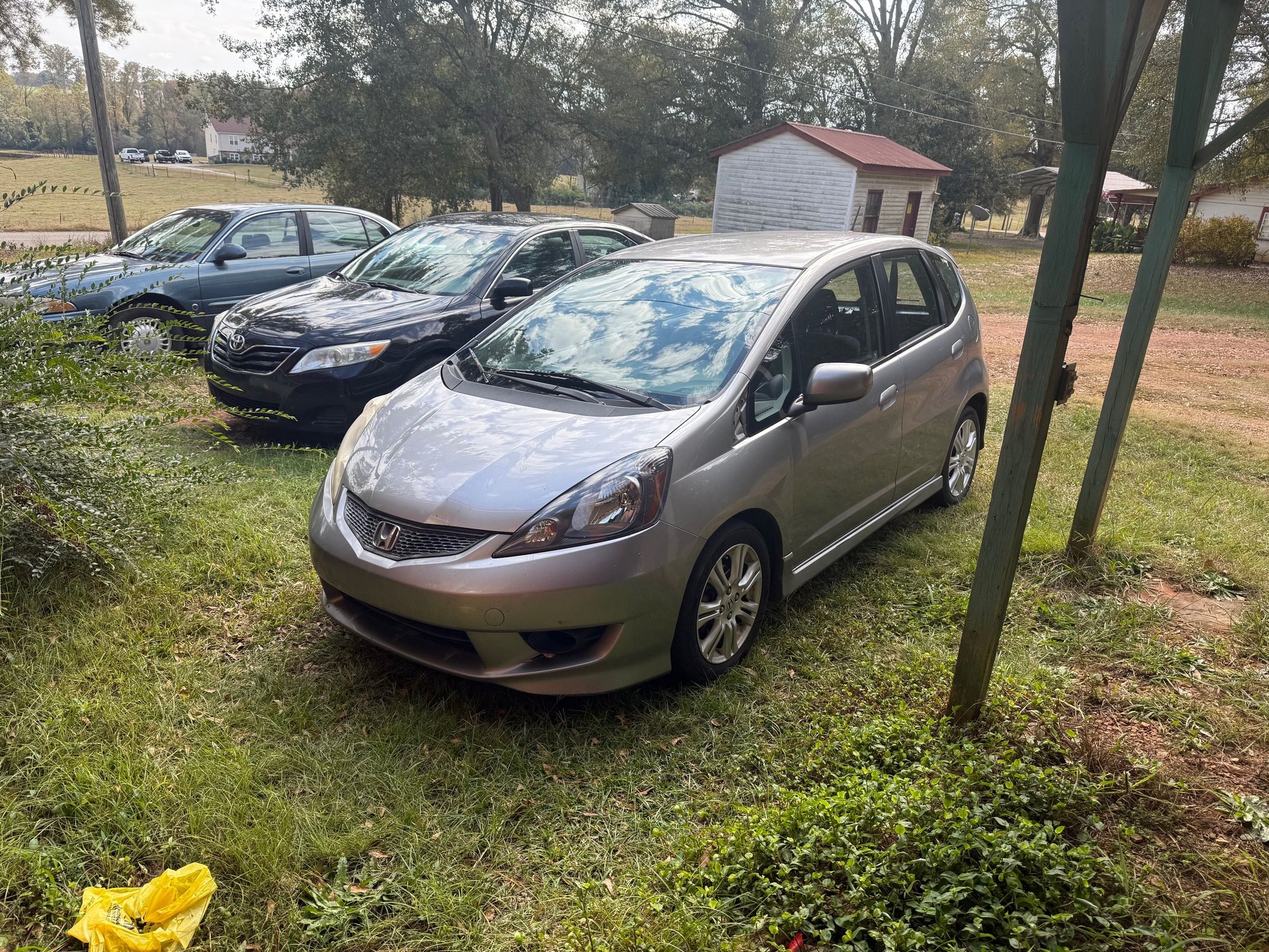

Was in rough shape, still needs more TLC, but I stitched up her mouth, put 2.5 quarts of oil in it (that's how low it was ) and a tank of gas. Been driving it to work the last week and back with 272,xxx miles on the clock, it's got a few issues but my brother gave it to me for $1 so, how can I complain? Haven't mashed on it yet as with it's mileage on it, I'm not sure that's a good idea, it's far from a sports car, though it is VERY light and nimble feeling and that alone quickly has me liking it a lot! The seats are fairly good for their age and in what they're in. And it's according to the dash getting 44.5mpg, though when I checked it you know using math at the pump it was 40.44mpg. Has a CEL on but my $7 ebay scanner shows a P0420 code best I recall that's just the second O2 senor, the post CAT one so, I couldn't care much less other than the lights on, that a TPMS light so the sensors probably gone bad in at least one tire.
So I like I said I stiched up her mouth with what felt like 20 zip ties after he had hit a small animal (I forget what it was) on the road... found the fog lights knocked back into the bumper cover so gonna fix those, needs a new tail light and the other mismatched headlight swapped out... eventually the dented hatch Vacuumed it all out today, took the spare tire, jack and tools out. folded the rear seats forward, thought about taking them out for about 30 seconds but I have kids and though it's unlikely I'd need to use the car to transport more than myself, eh for now they will stay in. been trying to dig up information on this platform and the L15A7 and what is available for it parts wise.
Seen a couple cool Kswap builds, that's not gonna happen anytime soon for myself as I'm about to transition from TIG welding to driving full time soon as I get my CDL.And then even though money may improve, I wont have near as much free time. But eventually maybe, I find the cars after actually driving one facinating in that they embody several things of a gone by era in cars I loved.... light, simple, functional without gimicky BS and actually affordable.... These things IMO are the modern replacement for the, well not japanese sports cars of the 90's in the well heck they're getting old even now LOL. but of the at least not boring cars that can be fun even if not "fast" in the conventional sense. Sort of a FWD miata if you will?
So with the milage of this thing, what should I check first far as maintenance? I'll post of some pictures later. I should have taken more before pictures...

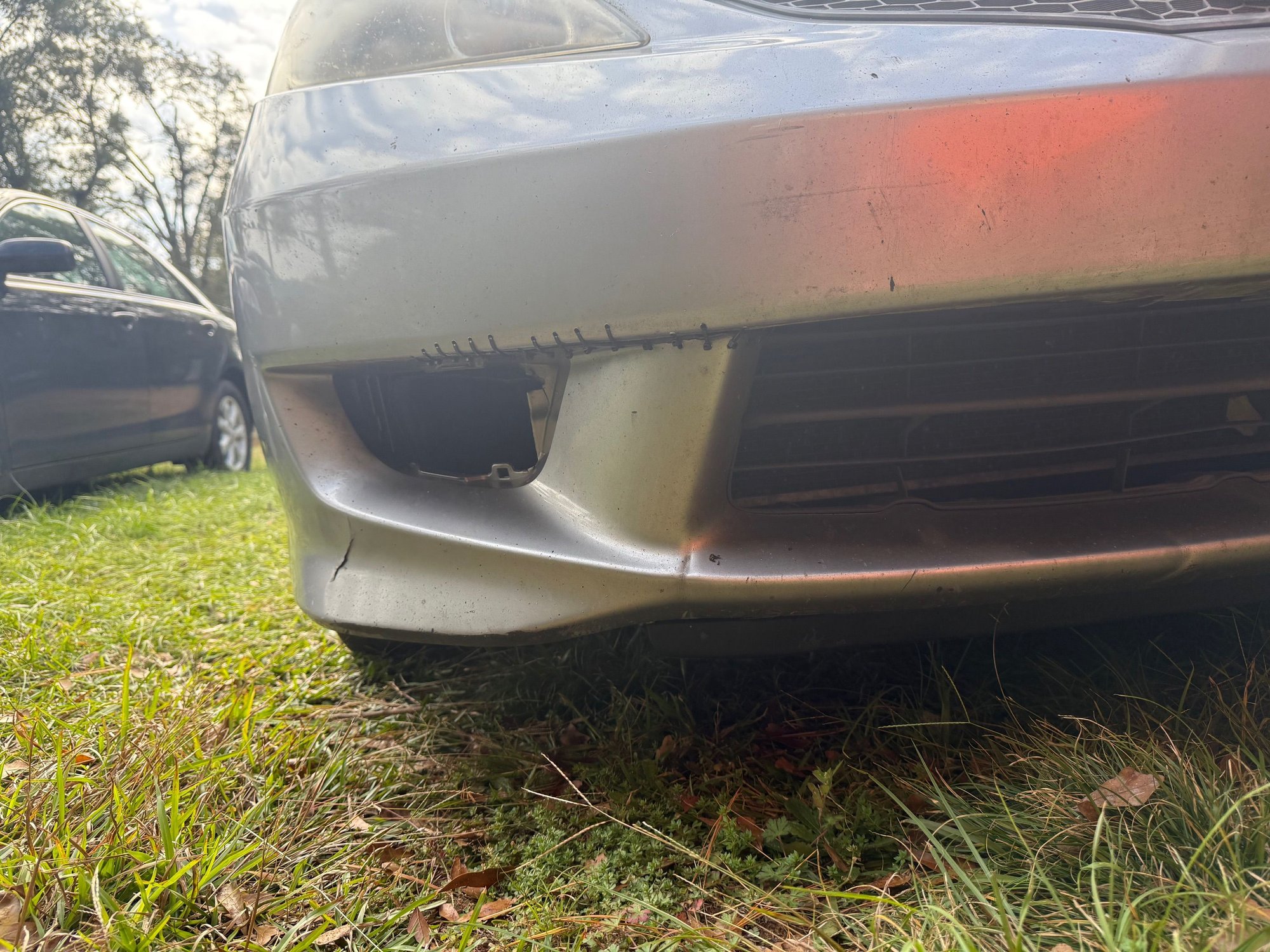

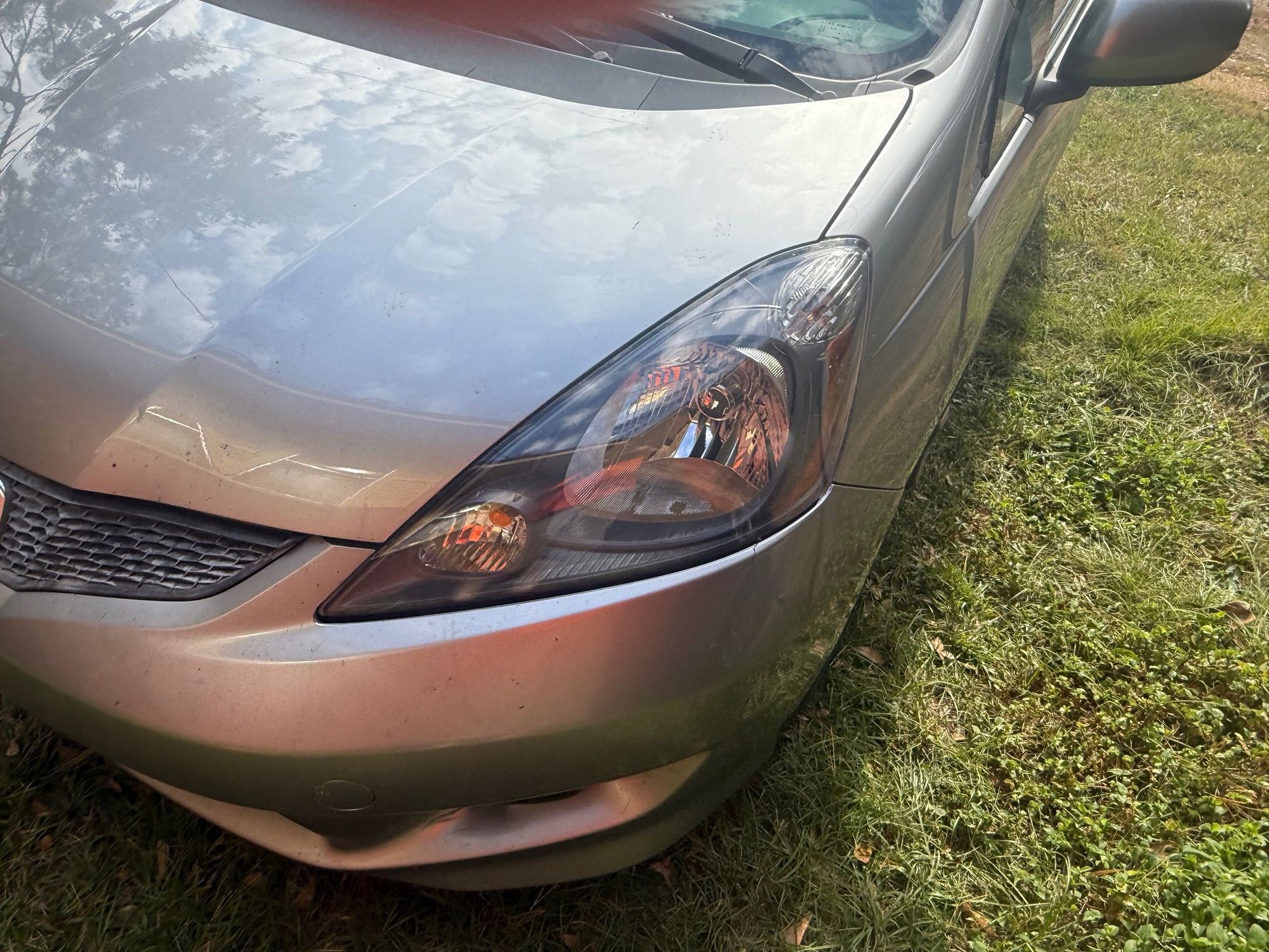

Top picture you can see my ziptie job... Which headlight is factory? the Chrome or black? Also which do y'all think looks better? I kind of like the black a hair more I think...And I'm not sure a polish will help the chrome one much and it would still be mismatched even if it did...

Both headlights are factory for the GE8, just for different years. The passenger side is correct for a 2009, the driver side light was one of the changes when the GE8 was refreshed a couple years into production.

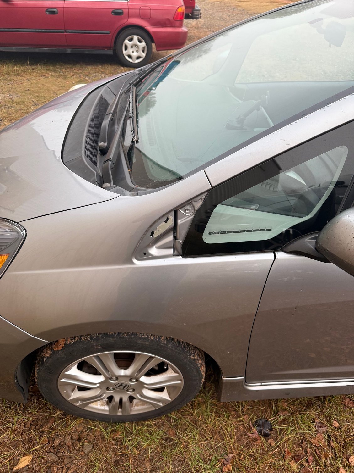

Can someone tell me what this part that's missing is called?

Filler panel maybe? There are some sites which show drawings with part numbers and I'm am sure someone will post a link.

Check on dreamshop. You'll be able to browse all exploded views and parts lists.

Duno if it's item 7 or 12, but it's $274 either way... https://dreamshop.honda.com/s/catego...g0000004HolGAE may have to see if there's a way to get one from a junk yard.

Looks to me like 75495-TK6-A00, $58+shipping from HondaPartsNow

Sweet! Thank you VERY MUCH!

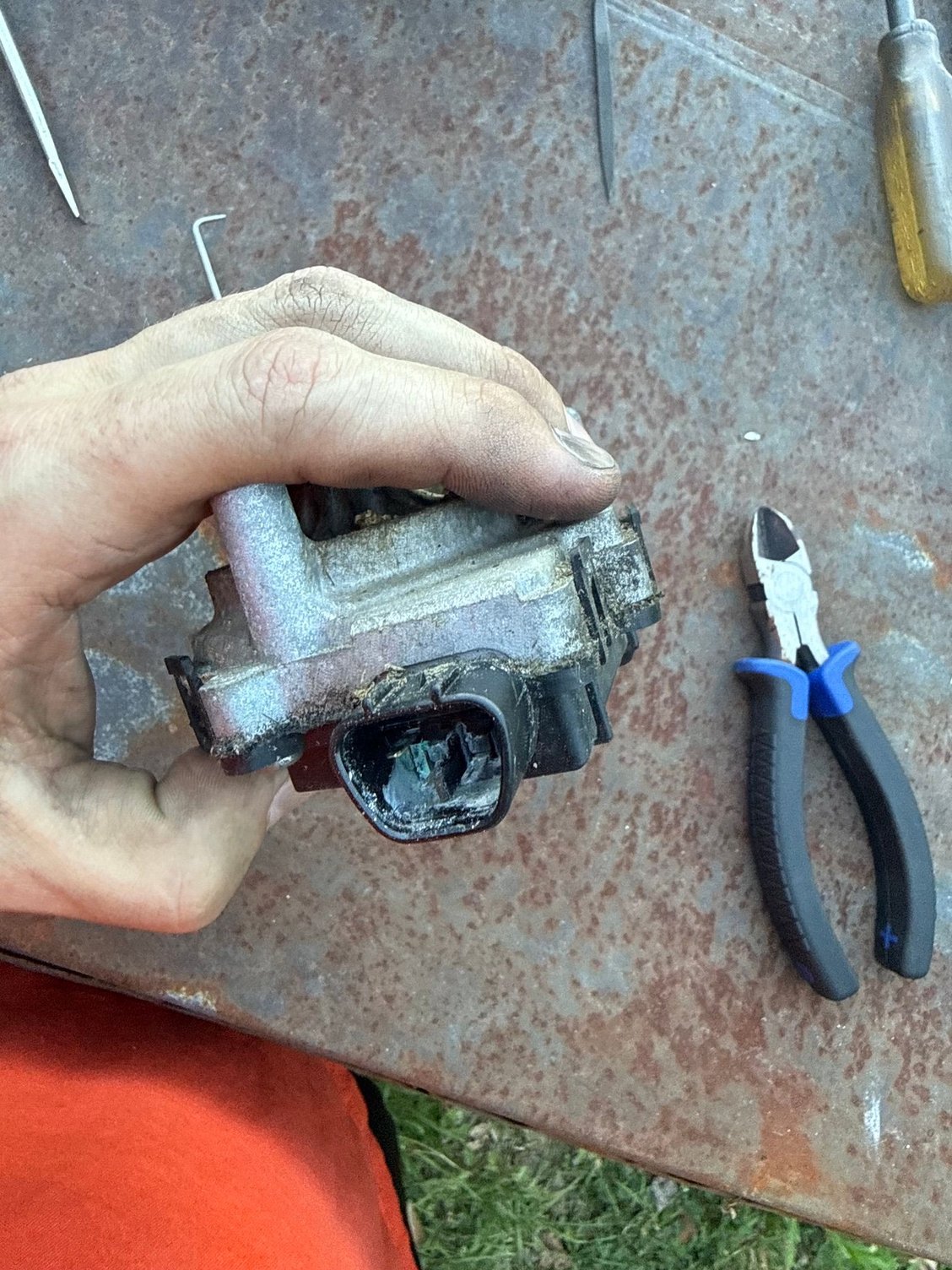

Turns out, if that pin corrodes, your wipers don't work correctly, I didn't know what the issue was directly with the unit so I had ordered a re-manufactured one. Cleaned off the contact best I could, but just packaged it up in the box the other came and installed the replacement.
Turns out if you don't put the connecting arm EXACTLY back where it was, when connected to the motor, you find that out real quick....That was a pain, but 4th try got it.
