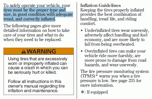

Old Sep 24, 2008 | 09:06 PM
OrangeRevolution's Avatar
Posts: 138
Originally Posted by vintagesierra
It's not over inflation. Over inflation would be going over max sidewall which is 51 I believe. 46 is still well below that.
WTF?
The maximum inflation pressure is 51 psi per the tire manufacturer. That is the maximum inflation pressure under any conditions where the tire manufacture will warrant it against failure. Where does it say that anything under 51 psi is not over-inflation and therefore safe?
Under-/over-inflation is specified by the car manufacturer. Anything over the recommended 32 psi or 33 psi is considered over-inflated per the car manufacturer.
What parts of the owner's manual are not clear: "Using tires that are excessively worn or improperly inflated can cause a crash in which you can be seriously hurt or killed." "Overinflated tires can make your vehicle ride more harshly, are more prone to damage from road hazards, and wear unevenly."
Furthermore, the maximum inflation pressures are that. Maximum. They are not maximum cold when you check them. Per the manual on page 274: "If you check air pressures when the tires are hot [driven for several miles (kilometers)], you will see readings 4 to 6 psi (30 to 40 kPa, 0.3 to 0.4 kgf/cm2) higher than the cold readings. This is normal." So, inflating to 46 psi is not "well below" and quite likely at or above the tire manufacturer's maximum permissible inflation pressures when hot.
Some of you guys are really funny. Think about how well you'd do trying to make a claim on tire wear with Honda or any tire dealer. Likewise, if you're in an accident, you'd be treading on thin ice if the cause of the accident can be attributed at all to your knowingly under- or over-inflating your tires.
