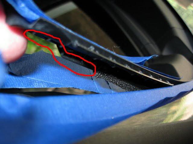

I bought some Duck Brand weather stripping with foam. (the thinnest width I could find--about 3/8")--I adhered that to the area where the foam stops on the trim piece and then continued up to the top of the trim. It fits snug, and no rattle. It has been raining all day, so I haven't had a chance to try it yet. I'll let you guys know.
It's not a rainy day in GA; put the Fit in improbability drive and drove up I75 again. At relativistic speeds there was no crackle-rattle with the silicone fix. The true test will be the daily drive at 40-65MPH this week; the rattle was intermittent before, it may have just gone into hiding. I think not. I hope not.

Steve and Virtual did the silicon I believe.
I used 3/8" weather stripping (foam on one side, sticky on the other)...I stuck it underneath the trim piece, where the other weather stripping ended, and let it also go up into the blank spot that goes higher. It has worked so far. I tried to get the noise to make itself show--but it didn't.

The official fix is going to the Honda service dept, pointing at the offending chunk of plastic, and asking them to fix it. I think it's a design issue that should be corrected. Next time I'm in for something I'll ask if they have a TSB on it.
If Btrthnezr3's method of adding weather stripping works, this would be prefered as it doesn't involve using adhesive to secure a piece that's meant to be removed.
Here's a pic of the plastic pulled away from the windshield so you can see the back and how this might contribute to noise:

I put the foam weather stripping...similar to what you can see in this picture....here:
It seems to be working so far.
I appreciate everyone's help and input.
I can take pictures of the packaging if need be. It is Duck Brand and it is in the weatherstripping aisle in Walmart. Most packages were thicker, but this one was thinner...but looked thick due to the packaging--it was 2 rolls together that were about the same width of the other choices. I think it was around $3.00.

mmmm check your PMs if you haven't already. I sent you a link to the slideshow "how I did it." You don't need to completely remove the piece of plastic, just pull it away from the windshield and body frame. It flexes enough to access underneath and either add weatherstripping or pure silicone as an adhesive. Recommend the weatherstripping if that solves the problem (you can always pull it off and try silicone later).
Or pull into the Honda service dept. and point at the part and tell them it's noisy at highway speeds. Actually I'd encourage you to do this first if you have the time for such a "minor" thing. (I know it's not minor when it's making the noise; it was driving me to drink.)
