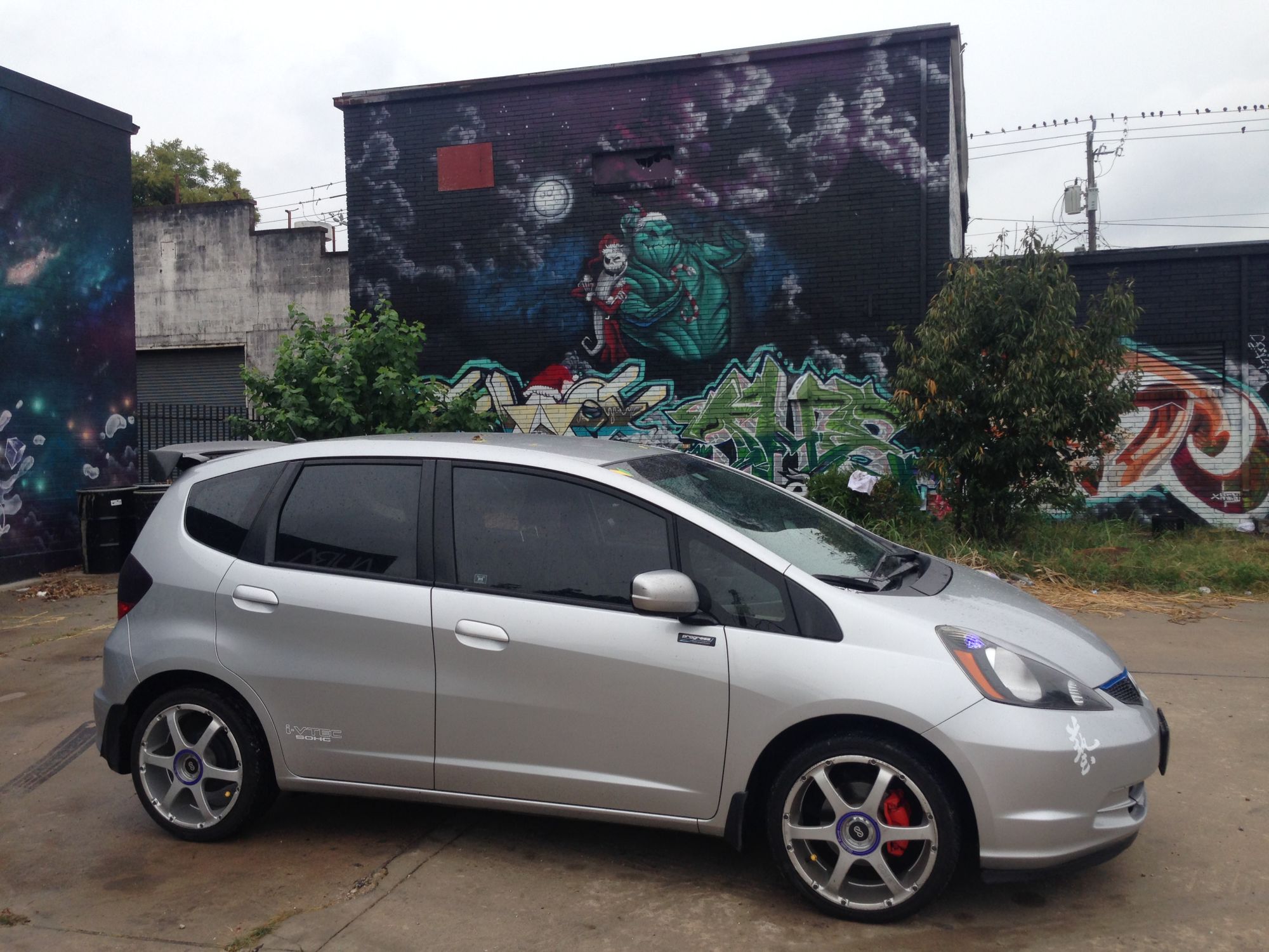

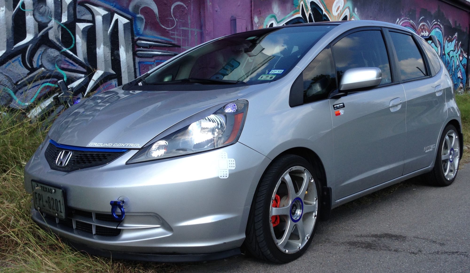

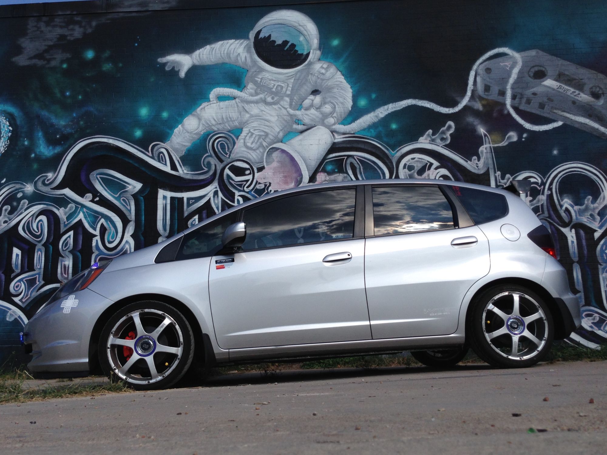

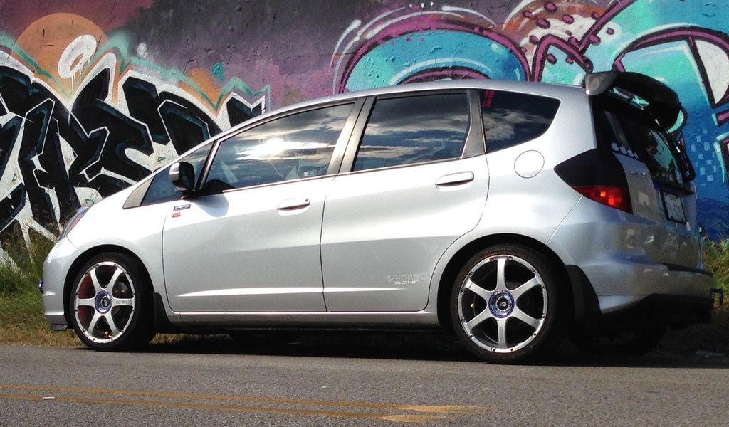

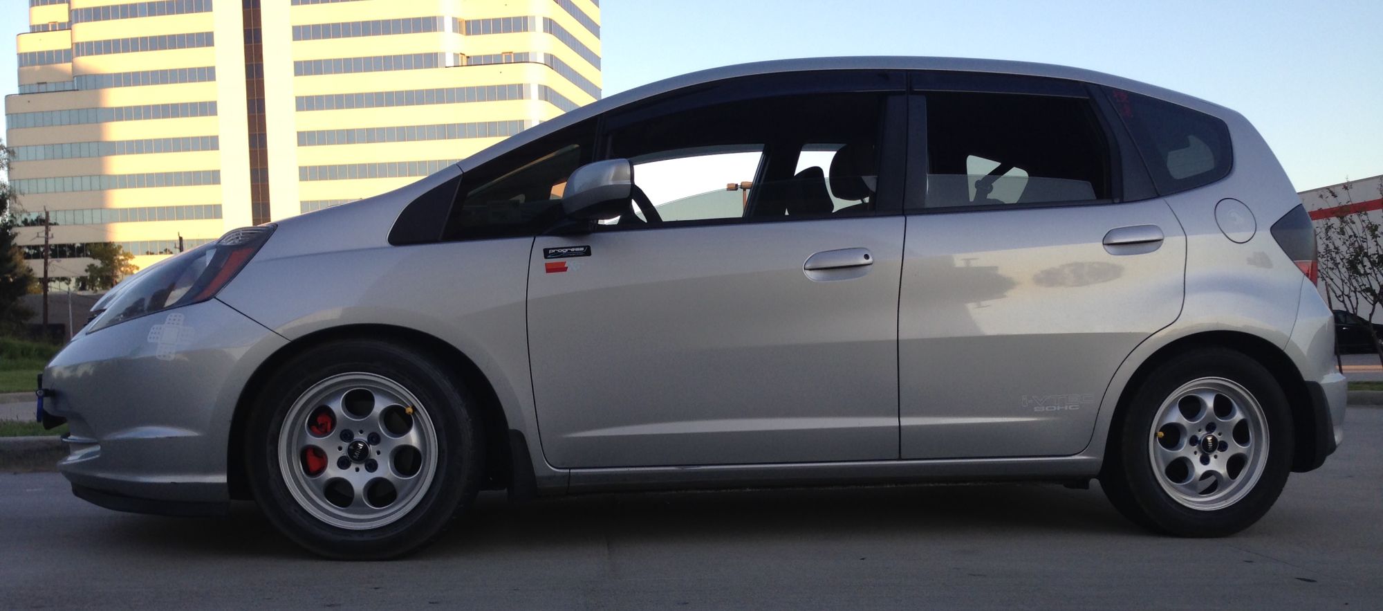

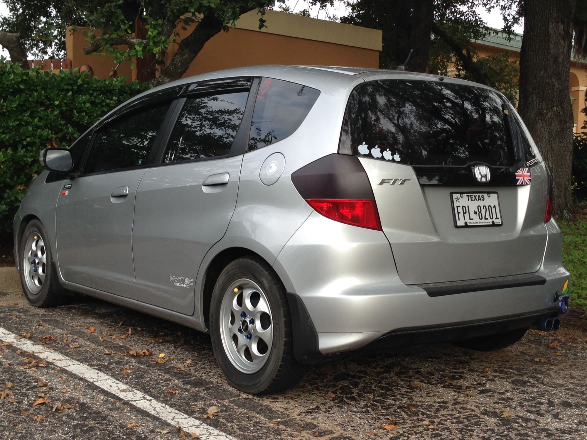

new wheels. these tires in the top photo are too big 185/65/15 increase over stock diameter by 1/2" too big, too heavy. I have since replaced them with kuhmo sense 185/60/15 these are great tires, ill probably keep them for a long long time. also reinstalled my TPMS which will help with autocross if i ever make it back out there.
grafitti excuse for pix - lowered
stock height
stock height
Space Egg

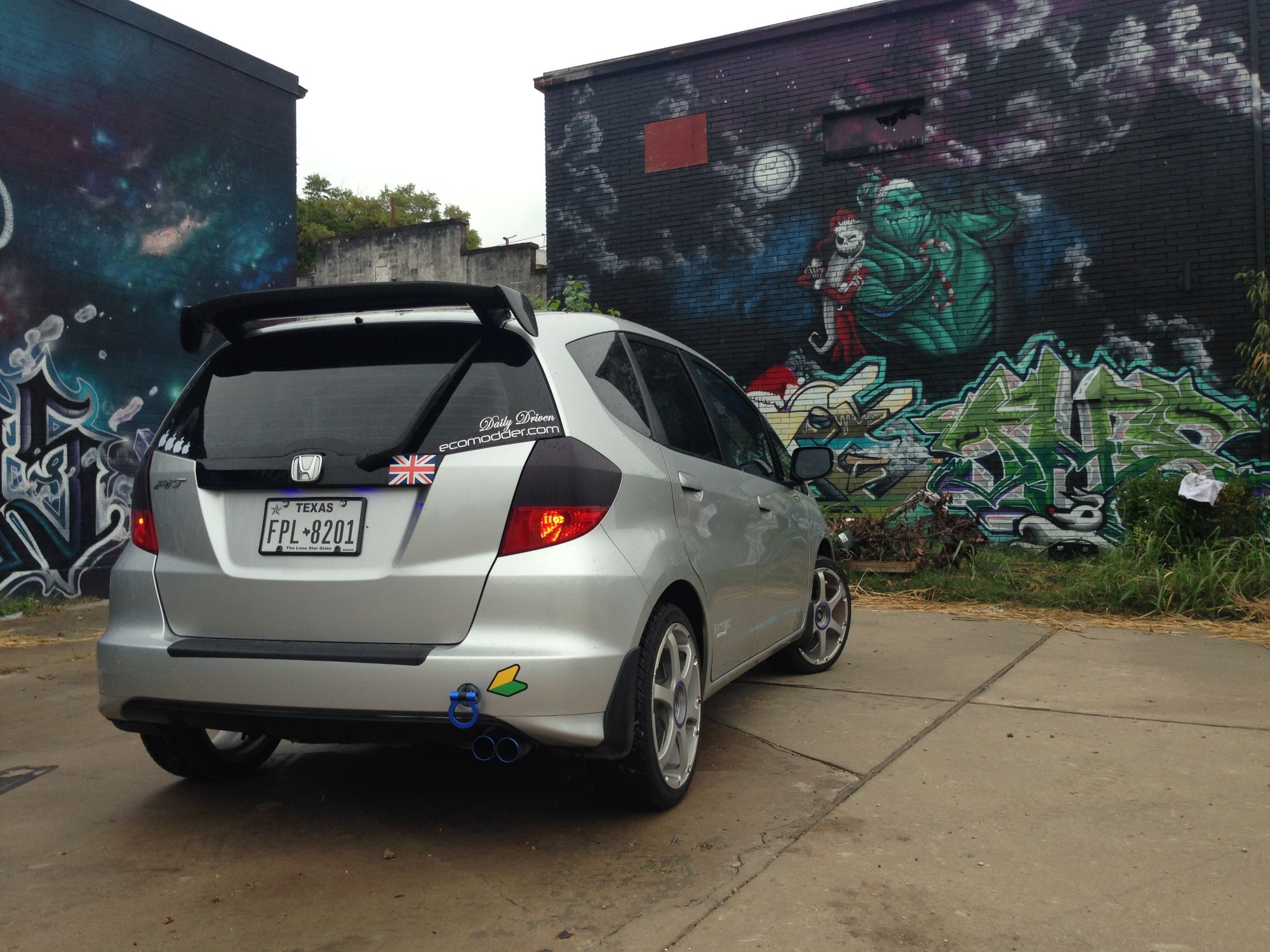

Talking
Originally Posted by Codger01
Liking the Union Jack on the back.
i used it to cover a gigantic scratch on that rear panel you can just barely see it in the top image when i first bought the car.. it looks like shiny reflection but it was in fact an enormous scratch from a previous owner removing a sticker with a razor blade.
Good old union flag to the rescue! ...oh and we're british.
