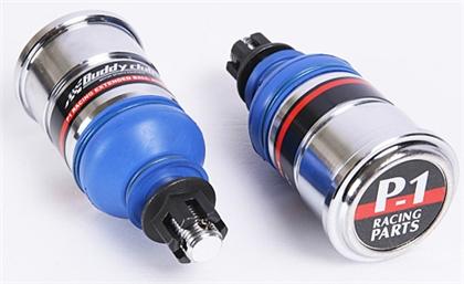

Buddy Club Extended Ball Joint Install
Buddy Club P1 Racing Extended Front Lower Control Arm Ball Joint GE8 Install.
Part Number: BC02-BJP1-H005
$144 @THM Buddy Club P1 Racing Extended B Joint HONDA FIT 2009 - 2013 BC02-BJP1-H005
What's the point of this mod?
After cars are lowered the control arm becomes horizontal (bottom image). This mod puts the control arm back at the OEM angle restoring suspension geometry (upper image). This moves the roll center up, and closer to the center of gravity of the car, which increases steering responds and decreases front body roll.

This is what you get in the kit: Two Ball Joints w/nuts, Two Cotter Pins, Two C-Clamps
Difficulty level: 3
Time: 2 hours, I was able to do it in less than an hour due to experience.
Additional: You will need an alignment afterwards, I suggest using camber bolts, at this time, to get more camber.
Ball Joint Length: 15mm~.5" longer

On the BC P1 ball joint you will need to carefully remove the lower clip and boot to fit the boot through the hole of the control arm.

This is a side by side comparison:
Driving Impression:
Right away I could tell the steering was more responsive (most obvious). The front body roll lessened, but it took taking a few familiar turns to feel how much. I feel a bit of bump steer, but nothing to complain about.
Was it worth it:
Yes, It brought back the steering responds from when the car was lowered. I am a bit disappointed that Buddy Club only made them in a .5" length. I have 17" wheels that could accommodate longer ball joints. I would do this mod again, definite improvement.
