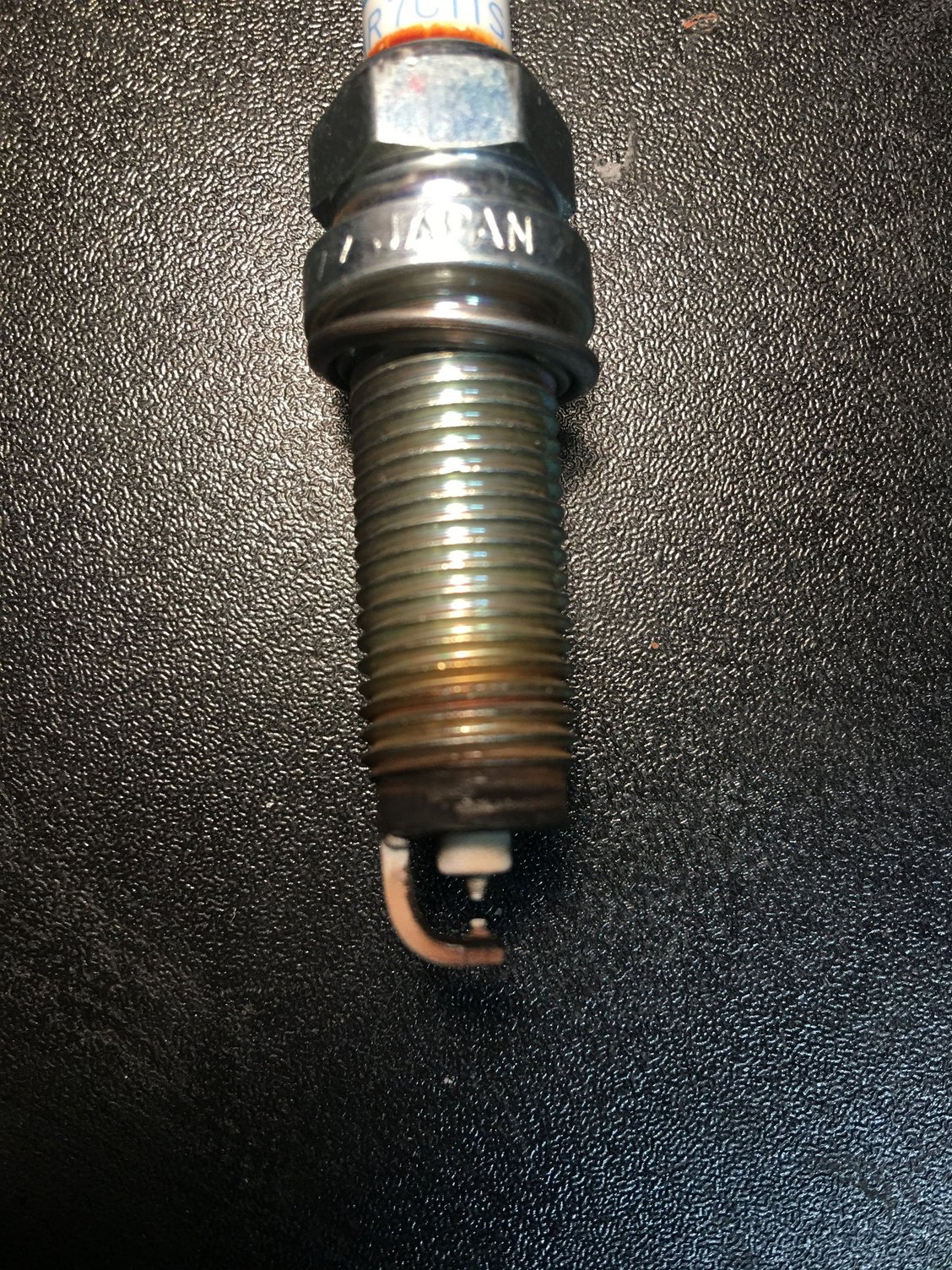

Been reading on this forum and other places for several months that I'm not the only one having this spark plug issue with a Fit. Here's my story: We bought this 2008 Sport when it was 2 years old and had about 10,000 miles on it. Late last winter we decided we would go on a road trip in late April that ended up being over 5,000 miles. In planning for it I figured I'd replace the timing belt since the car had about 80,000 miles on it. What a joy when I was looking for a belt kit online to find out it had a chain! That made me so happy that I had the Fit, since that meant someone engineered a quality car into it. So, I decided to give it a new set of plugs and other regular maintenance stuff. On the trip most of the time it got really good gas economy except for a couple of tankfuls where it got below 30mpg and had a slight miss. I figured it to be bad gas since everything improved with the next tankful. After we got home 5 weeks later it seemed to run just fine until about 2 weeks later when it developed a real miss. Well I've been working on my own vehicles for over 50 years and the first thing I do to chase down a miss is pull a plug. I don't remember which one I pulled but it was likely #1 since it is the easiest to get to. BTW I have never had to pull off any cowl parts to get at the plugs. To my surprise it was finger tight. So, on to #2. same thing. #3 was really loose. 4 was somewhat loose too. So I snugged them up just like I have done on plugs before (yes even on aluminum heads) and although mystified I figured it was fixed.
Next trip into town (about an hour away) my CEL comes on. Checked it and it had a #3 misfire code. I finished my business and limped home. Ever since then, whenever I travel more than a 50 mile round trip, at least one plug is loose. Because of info on this forum i started to use a torque wrench, but became wary of going over 15 pounds. I've tried putting blue lock tight on the threads first, then tried putting it on the crush washer. Eventually tried a whole lot of it, like mabey 20 drops. Ya know the stuff is only good for 450 degrees so I'm not surprised that it didn't do much good. All in all I've been dealing with this 2 or 3 times a week. Last time I torqued them to 20. I have several pro mechanic friends and they all said they have experienced loose plugs on different kinds of vehicles, but usually just tightening them without a torque wrench fixes the problem and none come loose again. One suggested using one of those flat lock washers. Haven't tried that yet. Wondered it it would keep things from sealing right.
Since there is an Army of us having this same basic problem, it's obvious that this is an engineering flaw and Honda needs to step up to the plate. I'm not a sue happy person but someone posted on the forum the idea of a class action lawsuit. I applied for one at: https://topclassactions.com/ a few weeks ago but haven't heard back. Maybe you all should do so and help get some attention.
I hesitate to do a heli coil because of loose metal getting in the combustion chamber. I'm trying to read more and think things through before I do something I'll regret later. I still like the car and the idea it has a timing chain. I've maintained it well and want to keep it for about a million miles. It still has it's original tires and they look good.
Just my 2 cents for now. I'll write more when I think of it.

I have two Fits with high kms, 239,000 and 309,000. I have posted before and still highly recommend to rechecking torque on plugs at least by first 50,000 and I replace mine at 100,000 instead recommended 168,000.
I have owned Honda’s since 1980 and years past this has never been an issue with copper core plugs but they were replaced every 24,000 and then 48,000 as per Honda. Copper core center electrodes wear much faster than platinum and iridium, thus the frequent replacement, but they are 1/4 the cost.
Note HONDA is not the only manufacturer having this problem. I spoke to a fellow who worked at Ford and they have same issue, with most just blowing out of the cylinder head and costing big bucks.
2015 spark plug
I think the manufacturer is trying to resolve these precious metal plugs from coming loose starting on the 2015 Fits. Check out the price!! and they have been redesigned as the plug combines both precious metals by adding one to the ground electrode. Also the reach is substantially longer than past plugs...I think to create about 25% more surface contact area to cylinder head. Another note it requires a 14mm deep socket.
This is a educated guess on my part. I know this because I was changing plugs on my daughters Fit
