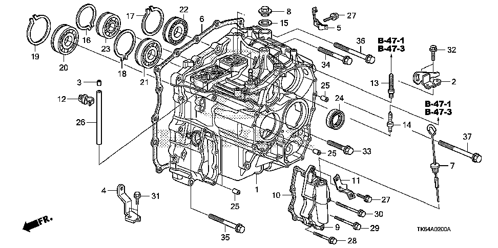

Originally Posted by Sparky1967
My 09 fit makes a noise constantly I've 20 mph have 120,000 miles on it . Am going to try to change the fluid and see if it quiets down or goes away.
If this is the first ATF replacement that you know of on your car, best practice is to drain & fill three times. This will result in more than 90% new fluid.
Despite that, the others have said that no impending failure results from the noise...so you could continue to drive it without worry.
Just as an aside, some AT CR-Vs have developed a whining noise that (similarly) is annoying but doesn't cause a problem. In that car (5sp auto) the source is a bearing that is part of the outer transmission case.
Just throwing that out there in case someone has replaced one of those bearings on the Fit and resolved the issue.
here's an image of all the bearings in the Fit Automatic.
