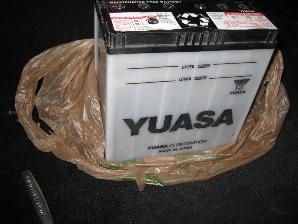

Well, my 2009 Fit needed a jump on Friday morning so I went to the dealership to the dealership and bought a new OE Honda 151R battery.
The original has been in the car since I bought it new in Nov. of 2008. I've been very happy with its life span.
The new one I bought from Honda is marked Honda on the front, but is made in Mexico and not Japan like the original. Not sure if it will last as long as the one made in Japan.
Does anyone know who builds the batteries for Honda in Mexico? Is it Johnson Controls?
I focused on cleaning the battery tray and terminals for the new battery and didn't inspect the new battery's label for clues concerning the factory.
Original Japan Made Battery: If you notice, the liquid is at the lower marking. It almost appears like I could have just added some distilled water and she would have been good to go?

Its a localized battery (cheaper made) from Interstate battery private labeled for Honda. Who knows, it might be better quality then the OEM Fujikawa or Yuasa battery....
You could NOT have counted on that. A lead-acid battery's plates could become sulfated, and lose effectiveness on one or more cells. Keeping the battery electrolyte over the plates will definitely extend the new battery's life.
The condition of the cell plates inside the battery determines whether or not a battery is still serviceable. Current is produced when sulfuric acid in the battery reacts with lead in the cell plates. As the battery discharges, sulfate accumulates on the plates and reduces the battery's ability to make current. The sulfate is returned to solution when the alternator recharges the battery by forcing current to flow in the opposite direction.
Over time, some of the sulfate becomes permanently attached to the plates. The sulfate forms a barrier that diminishes the battery's ability to produce and store electricity. This process can be accelerated if the battery is run down frequently or is allowed to remain in a discharged state for more than a few days. If the plates have become sulfated, therefore, the battery won't accept a charge and will have to be replaced.
Thanks, so I guess it was the battery's time to go. Almost 5 years so good by me.
