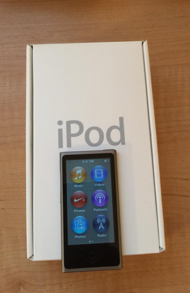

Bluetooth audio allows you to stream your audio files but I am now just using a dedicated Ipod for everything since I have noticed it is a better quality audio
