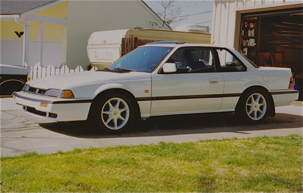

1987 Prelude Si (First Car!)
1993 Prelude Vtec

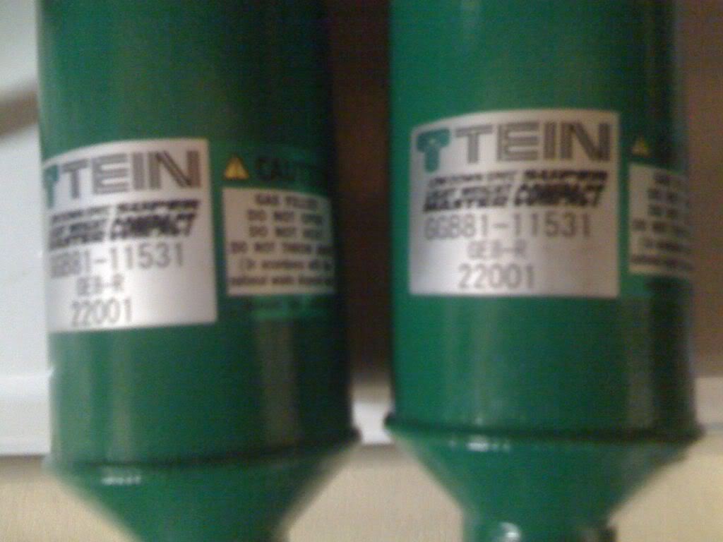

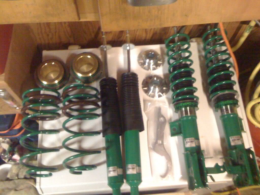

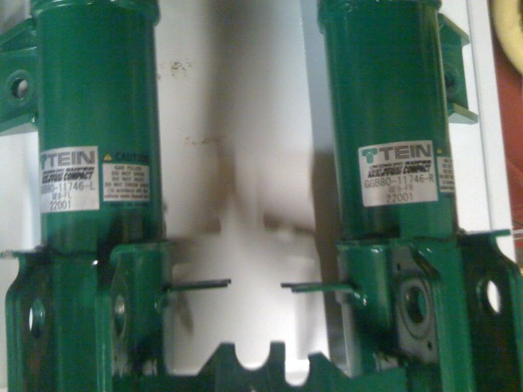

....Tein Super Compact Coilovers! WooooooooooT

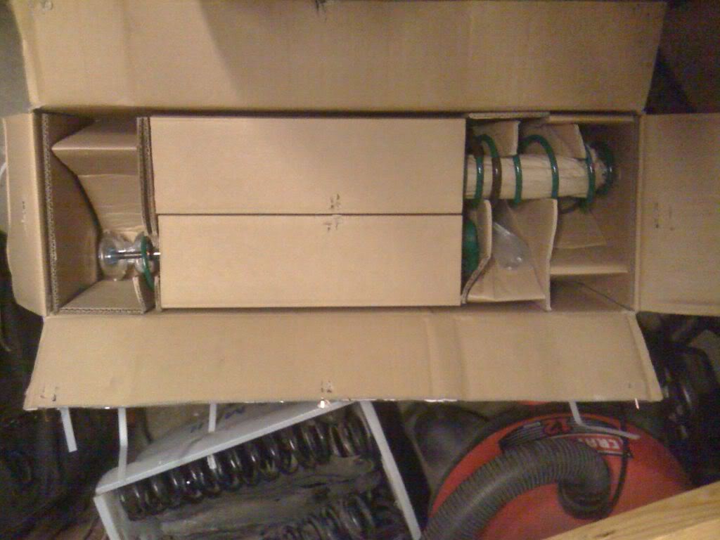

Came in earlier this week...
I got these off of ebay from the Tein offices in Southern California. According to them, they were used on a demo car that just sat around, so very little miles on them. They look that way too...only slight scratches around the bolt holes from mounting...very clean and shiny for being used!

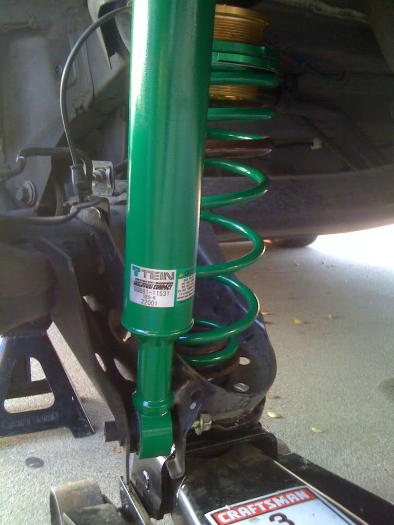

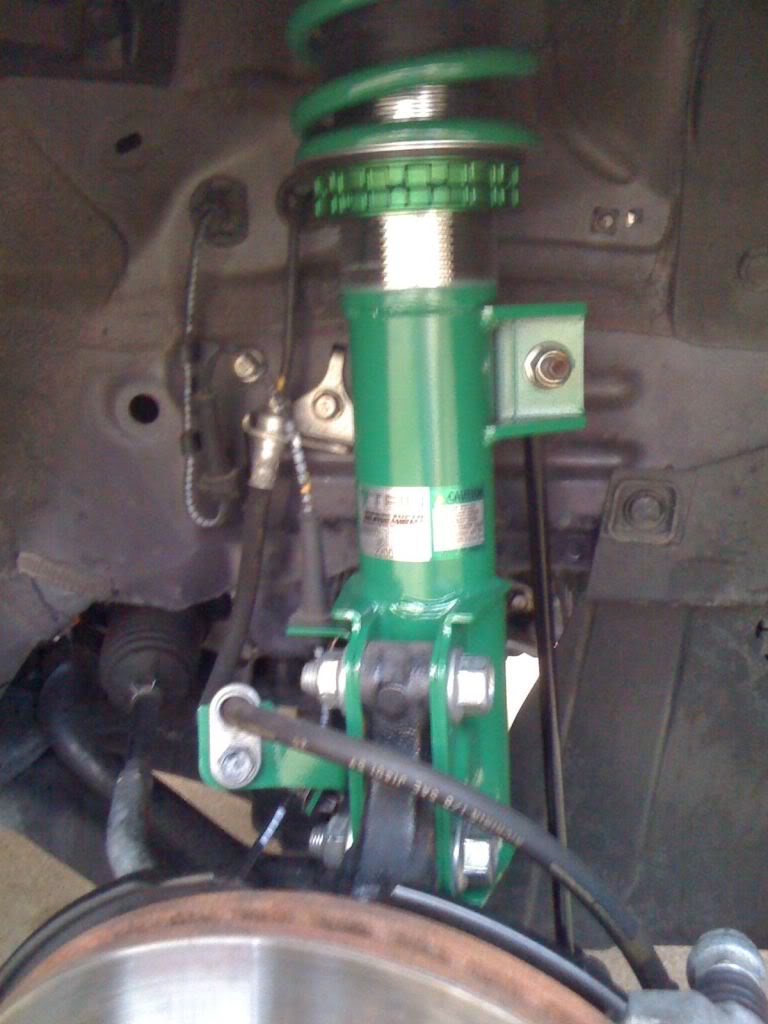

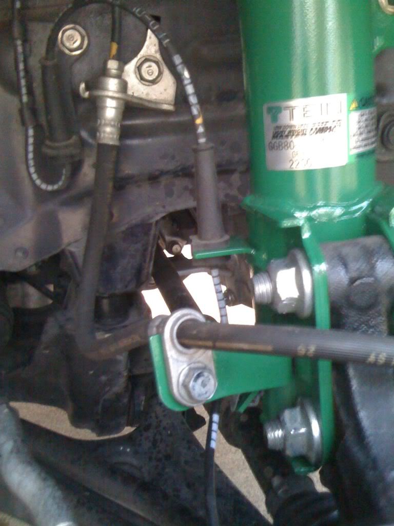

Install was pretty straight forward. Tried to do the front w/out taking the plastic garnish off...didn't happen. I have long fingers, but not that long! Also was SUPER scared of dropping an axle, so I used a jack AND bungee cord to hold the axle in place! (that and a lot of prayer!) Praise God, axles stayed!
I reused all the OEM rubber mountings both front and rear and there is ZERO noise. Looks like you can run the rear w/out the rubber mountings, but I made it fit.
Notice OEM rubber on top of the gold threaded rear spring perch...not sure if you are SUPPOSED to do this, but I did and there is no noise. (Read too many threads on noisy coilovers!)

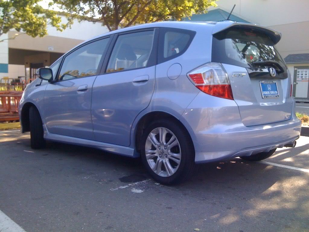

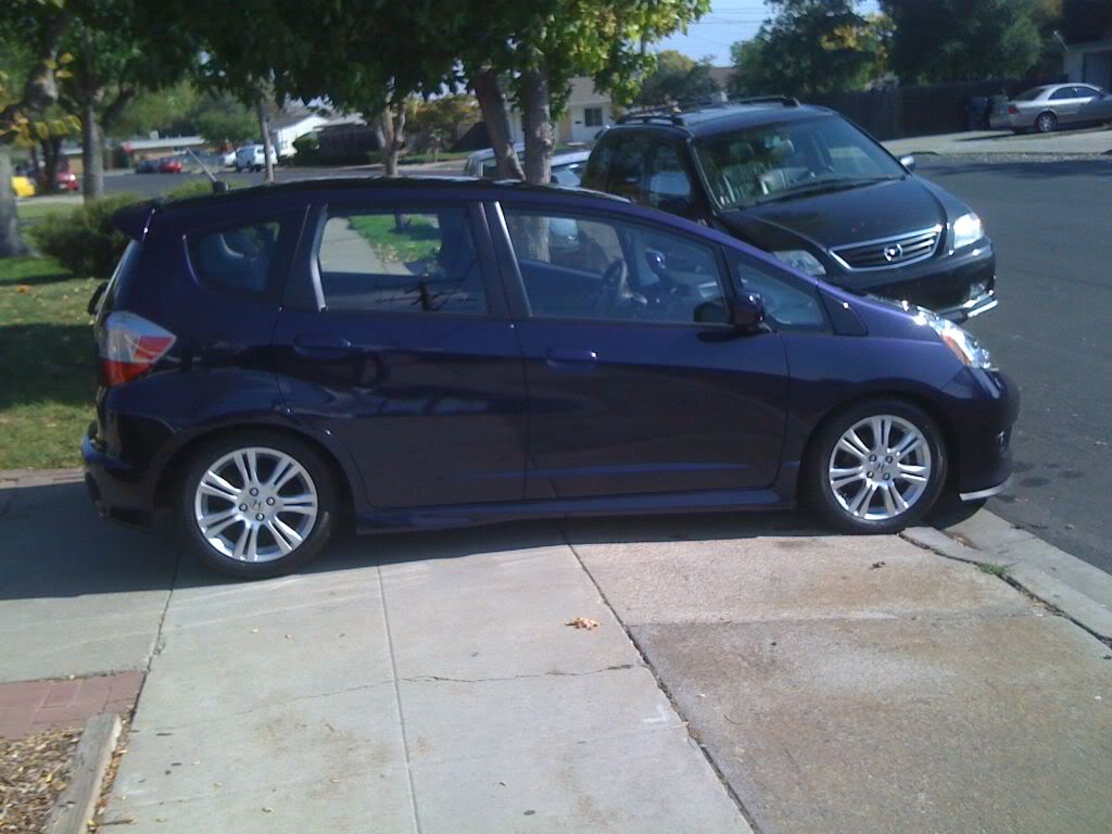

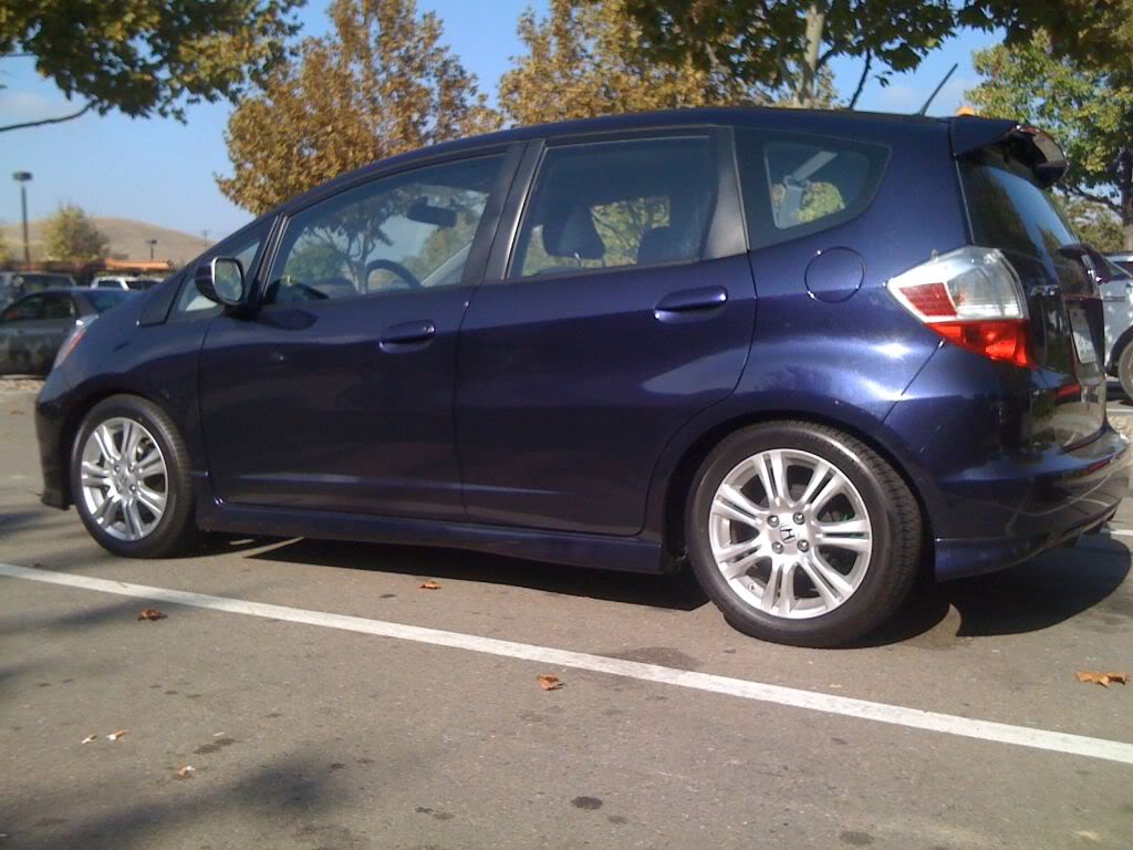

What is this!? A stock height fit two parking stalls away. Made me notice how significant the drop was!

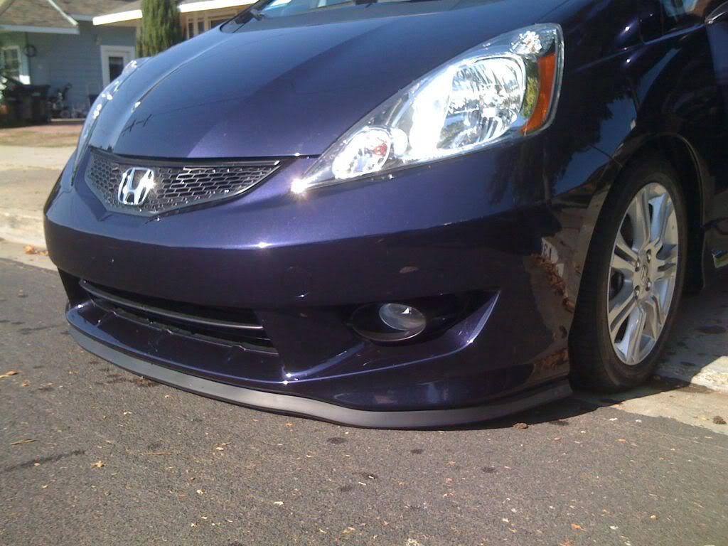

DIY Lip!
Cleaned!

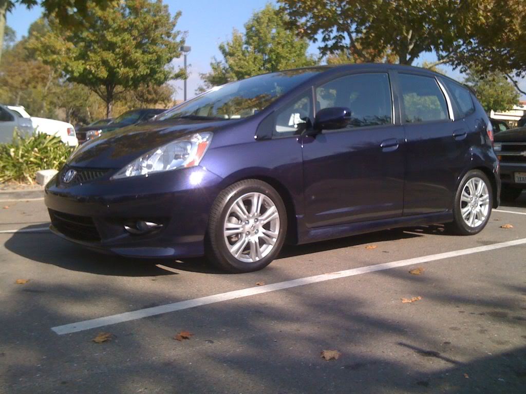

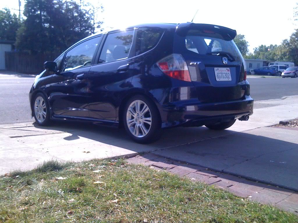

Impressions: Didn't move the spring perches at all, and they were spot on 1.5" drop all around. Looks good and balanced to me. Have the dampers on full soft now and it rides like it should: a smooth, planted and controlled ride. I love it. Ride quality is good...this is great since at stock height, the ride quality is good, not great. I may have lost a little on some bumpiness, but the dampers are so controlled, it is smoother too.

Thanks Perrenoud! Yeah, it isn't really that low, but I was checking clearance for my driveway...Can't lower the front any more if I don't wanna scrape!
@Choro-Q - These are the equivalent of Super Street, so I believe the rates are F 3kg (168lbs)/ R 2K (112lbs) The ride is surprisingly good. More firm but very compliant. Of course, I only have it lowered a little over 1.5" so I have some good travel still. If I lower it more, I know I will lose some ride quality (softer springs + low = bumpstop city!)
On a side note, I had a highway test this afternoon and the rear was bottoming out really hard on big dips. I was going to raise it up, but I decided to change out the Tein bumpstops (super stiff...if not poly, they are VERY hard rubber) to some shorter Eibach foam ones. Bam, no more running out of shock travel. I gained about 3/4" from the bumpstop, and probably another 1/4" of movement since the foam compresses a little easier.
Still on full soft, may try going up some clicks, but it is nice now.
