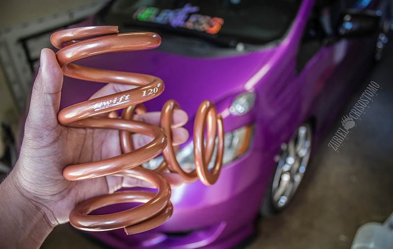

Replacing my front springs with these tomorrow.

Nice looking swifts!
Question time! So why replace the coilover springs with the swift springs? Stiffer ride? Also are coilover springs and lowering springs interchangeable? Sorry for the noob questions bro lol.
Thanks!
Ah well yea-- you have the freedom to choose your spring rate so most aim for a higher rate especially if you're coilovers are maxed out. Because they're stiffer there is a chance you won't rub/scrape if your wheels are really close to the fenders and all that. The funny thing about Swifts metric springs is that the ride quality doesn't feel the same as they are rated for whatever reason it is(material, linear rate, magic..). Even if you get swifts with the same rate as your coilover's stock springs, it's said that they ride better and handle even better. I've ridden on a couple cars now with swifts with higher spring rates and they feel amazing(at least compared to my car) even if the car is slammed haha.
Another reason is the option to choose spring length-- I can now probably lower the car a half inch more(should be able to go even lower but my coilover's front shocks are too long that they would hit the axle if I go any lower).
As for coilover springs and lowering springs-- they're different. If you notice in the pic, the coilover/metric springs are too small to fit on stock shocks and the top & bottom of it are flat. You could, however, use a coilover spring in the rear but you would need the rubber perches/pieces for it to sit on and a longer spring or shorter aftermarket shocks for it to work.
Hope that answered your questions

Thanks that did, I didn't even know you could swap out springs on coils. I don't foresee myself changing my set up anytime soon, but its nice to there is a wide level of adjustment if I do change.
Looking forward to seeing your ride even more slammed!

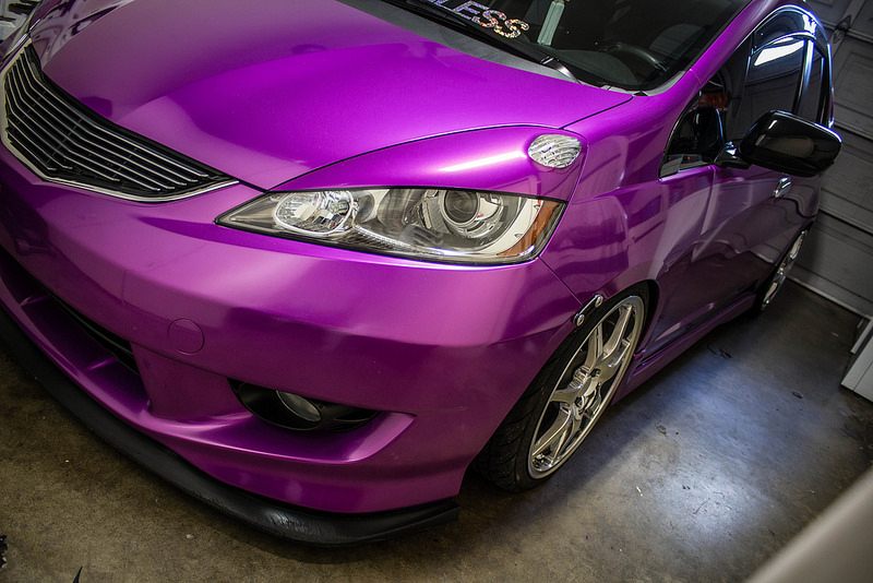

Attached Thumbnails Zeebrah's Fit Sport: Eleanor.-25626001776_9de602da61_c.jpg

So fresh and so clean! =)

Thanks! I had just wiped it down before taking the shot haha.

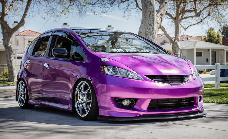

Did some more spacing. 25mm in the front and 15mm in the rear-- offset is now at +17f/+27r. Sortaflush now
