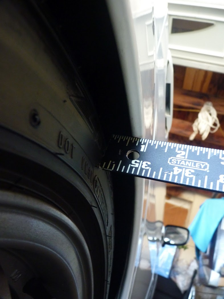

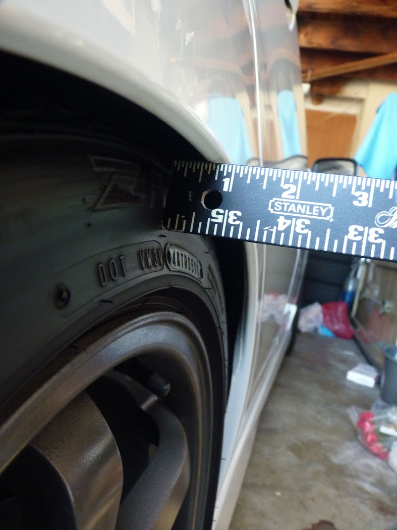

I got my rears rolled due to rubbing with 5 people in the car. Now the rear has some minor pull that comes with rolling the rear
here i have the rear passenger side tire sitting on a few blocks of wood to get it to compress a bit. you can see from the scrub marks where it did rub at full compression pre fender roll
its about half an inch clearance so i'm thinking 15mm coupled with something like this Suspension fixes. Rear too low. Rubber spring spacers. - AudiWorld Forums might help with the low rear spring rate. (2.5k vs 2.0k stock)
10mm spacers are also an option but would require extended studs and open ended lugs or oem 96 3.2 tl studs in order for me to use my current lug nuts.
Ideally i would get buddy club n+ and set everything at about 1-2 finger gaps but I haven't seen any used ones for sale in a while
