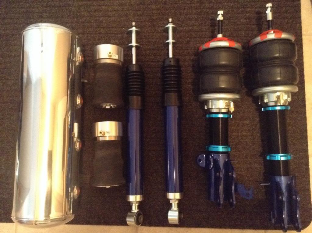

Right now I'm just setting my damping and height preferences, it seems that the rears actually aren't adjustable in terms of length though.
Here's all my gear as of now. The rest of it is at the shop.

Connor can you explain by what you mean by the rears not being adjustable in length?
I would think that the bag which replaces the spring would then allow you to go lower?
Old Apr 28, 2014 | 07:57 PM
Well you can see the fronts have threads on them and in the pic above, I lengthened the one on the right just to show this. So it's kinda like coil overs with bags on them. But the rears don't have them. so in terms of shock length, they aren't adjustable. But of course the bag will allow it to lower or raise. Problem is if I adjust the threads on the front, it might not quite match what the back is doing.
As far as my objectives go, I need to be at or very close to stock height on my highest setting. I just can't afford to not have that option when it gets snowy and crap here. But 90% of the time I'll be at my ride height, and then I'll have a fully aired out/parking height.
I called airrex and told them this, and they said the rears might not be able to go that high, but if it's close enough I'll be happy with that. If max height is like an inch or so below stock then they are gunna send me adjustable rear shocks.

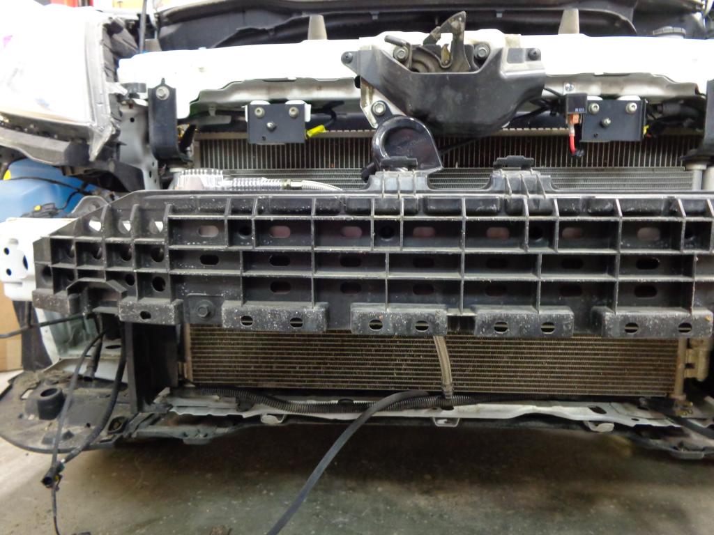

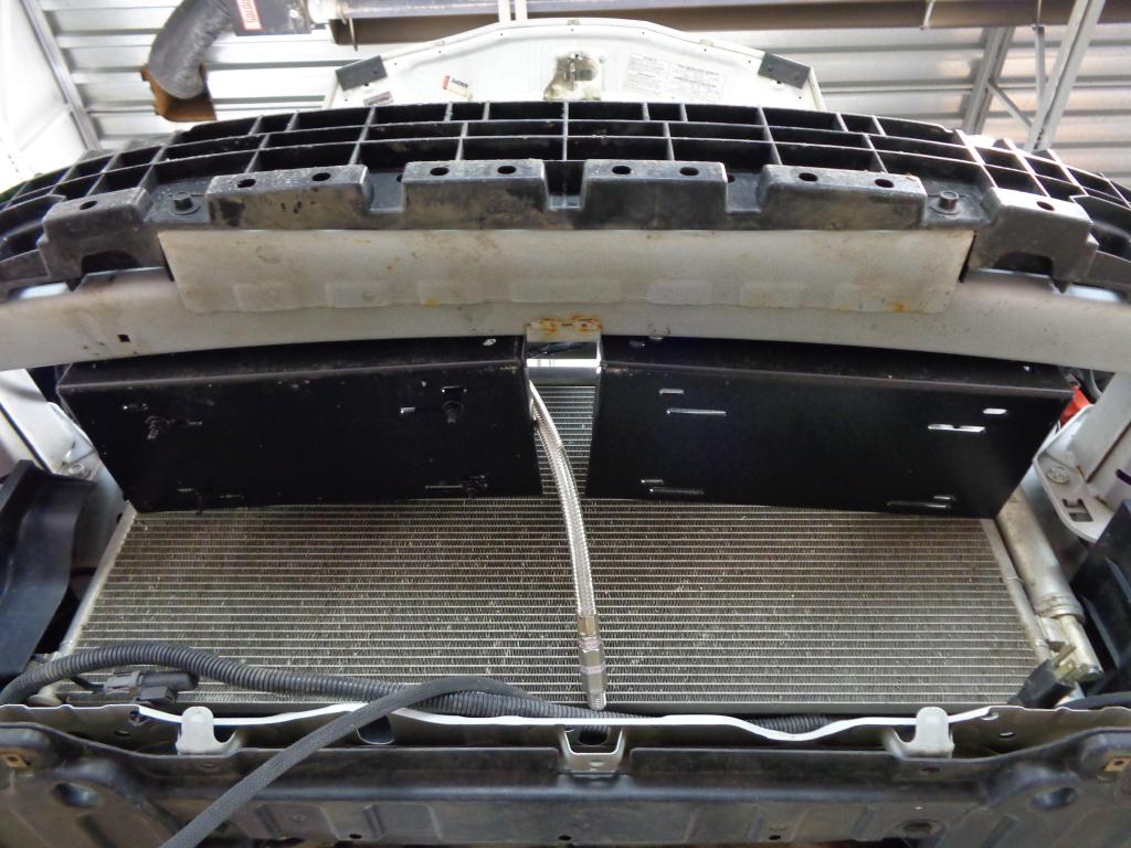

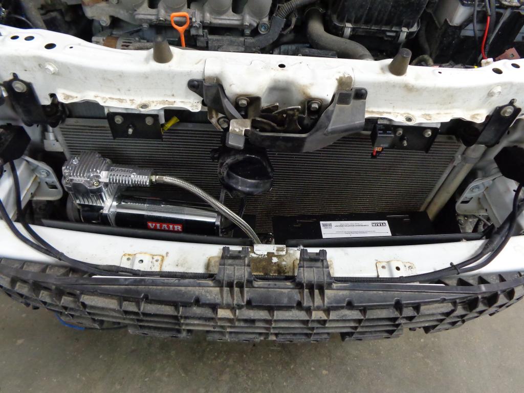

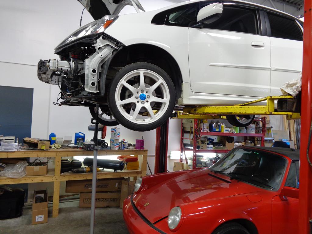

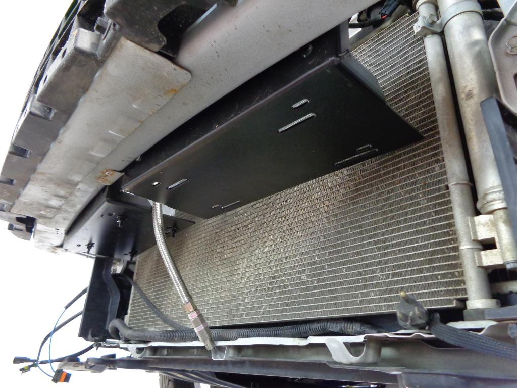

Alright, so today we got the 444 compressor mounted up behind the front rebar. Fitment is perfect, blocks almost 0 airflow. Second mount installed too for future dual compressor setup.
Sadly well have to build a false floor but itll be flush with the back seats when down so not a big deal.

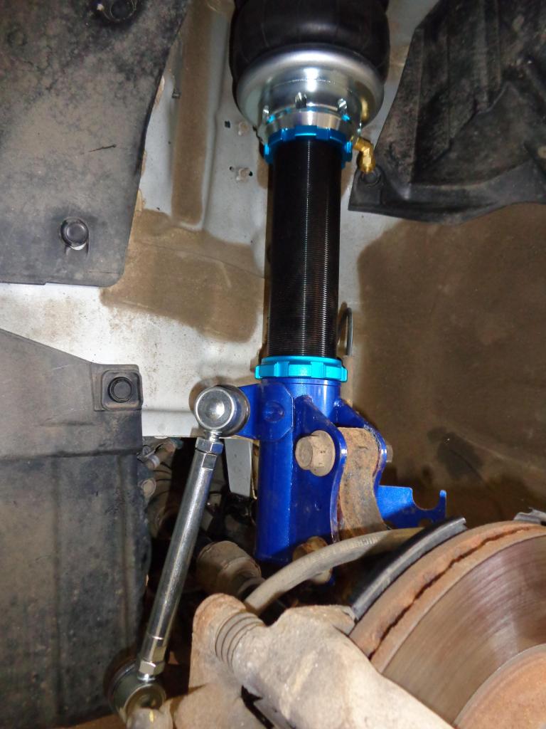

suspension in. lines, rocker switch, height sensors, and plumbing tomorrow.

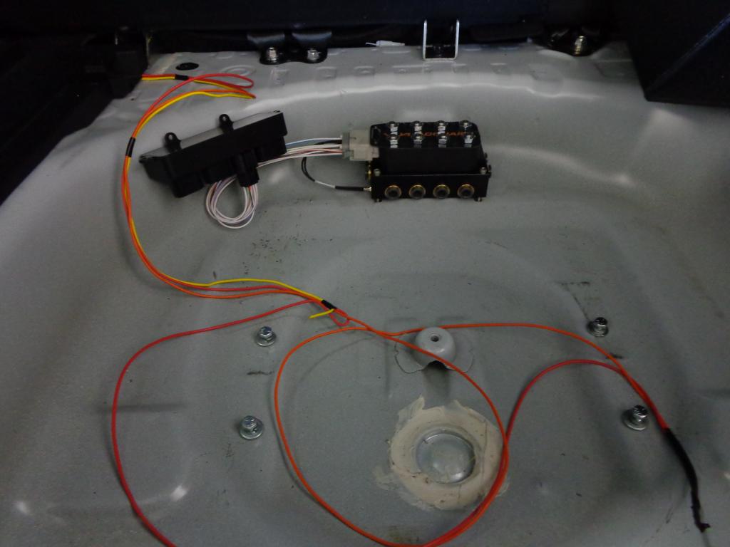

VU4 Manifold and ECU and tank mounts
Front struts

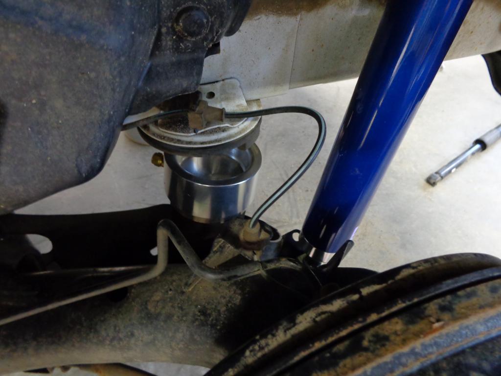

Rears

Did those sway bar links come with this new setup?
Old May 1, 2014 | 12:17 AM
  #140
connor55's Avatar
Joined: Apr 2012
Posts: 1,779
From: edmonton, canada
Yep, it came with all the suspension components you'd need and it's direct bolt on.
The rear shocks are pretty damn short compared to the stock ones lol. Rear wheel hangs at 2.5 ish finger gap, even less than stock sitting on the ground. Might actually end up exchanging for adjustable rear shocks... Cause that'll be brutal in the winter.
