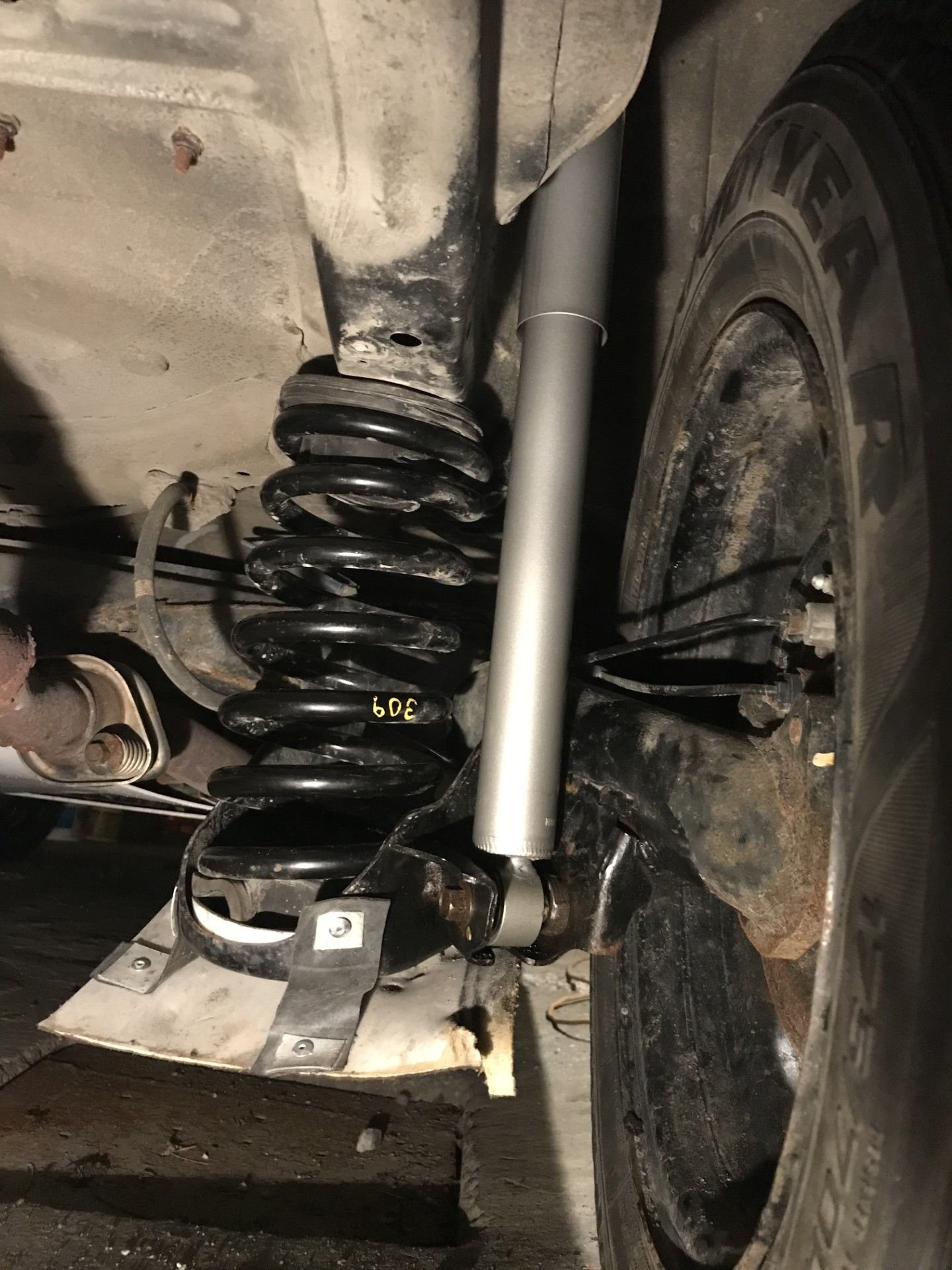

Now i run KYB KG4741 with 309 psi Moog spring (can't find the number) cut at 12 inch . It's pretty stiff and not bouncy at all . It give 2.5 inch lift . I run this setup for stage rally but it's streetable . KYB KG4741 are stiffer than Bilstein 24-025386. The shock valving and spring have to fit together in order to have a great ride . If the car is bouncy le shock valving is to weak for the spring rate .

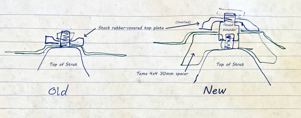

Snapped front right strut twice with Tema 4x4 spacers! Any ideas?
October of 2023 lifted the front and rear of my 2012 Fit, but since then I've snapped two front right struts. I posted about it (in the GD thread by mistake) last September.
In the rear, I did the progress rear sway bar and 2010 Insight springs. I wasn't sure if the stock Honda dampers had enough travel, so I modified some truck shock extender brackets. These eventually started to rattle, and I removed them.
In the front, I used the 30mm Tema 4x4 spacers above the struts. I did not have to disassemble the strut, but, when tightening everything back up, when I installed the stock rubber-covered top plate, I wasn't able to get it to clamp tightly (as I learned later). The top nut tightened onto the included strut-top-thread-extenders clamped the top plate to the strut-top-thread-extender only, because it ran out of threads and bottomed out before drawing the strut with the Tema 4x4 tight and upwards into its mounting position. Thus, everything felt tight, but when hitting bumps, there was some side-to-side movement of the strut top spacer (and strut), making a sound I wasn't able to reproduce when stationary, even with a pry bar. This only was a problem on the front right (passenger) side. About six months later, the top threads of the strut snapped either when I went over a speed bump or made a tight turn in the driveway.
I replaced both struts (March 2024) with KYB SR4431 & SR4430, but to solve the clamping problem, I removed the rubber from the rubber-covered top plate, flipped the plate over, and put the rubber back on it. Then, I was able to install the strut with the spacer, with the top plate clamping the strut, strut top spacer, and car strut mount as one big sandwich, before the threads bottomed out on the top nut. I did this on both the left and right sides, and then got an alignment. I've been driving fine since then with no problems.
I've attached some pictures and a diagram showing what I did.
With the new strut installed this way, it did not rattle, but it still snapped this week when I turned into a gas station entrance with a bumpy apron. (May 2025)
Any ideas what I'm doing wrong here with the Tema 4x4 spacers and struts? Anyone else break a strut while running spacers?
Thanks!
