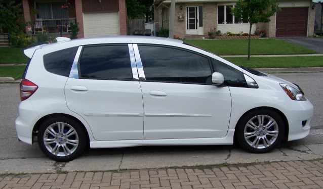

AFAIK there is only one Swift spring for the Fit for full length application and it drops 1.2". Swift also makes coilover springs but they are short and are smaller diameter, not to be used on OEM style perches.
Photo credit to Black3sr
There are may other manufacturers with slightly different heights and spring rates. There is a thread on here that goes over them all.
