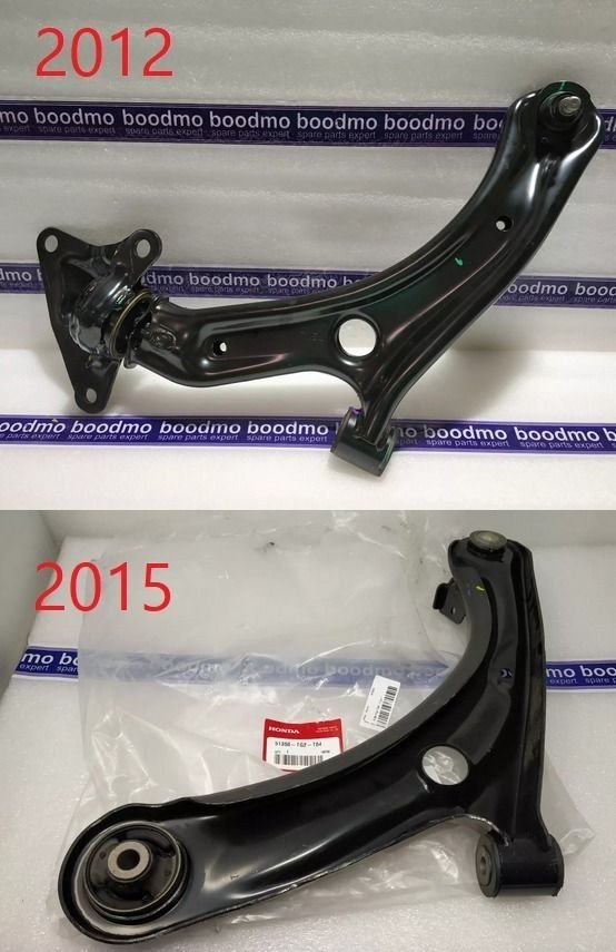

The design of LCA of previous gen Fit is different compared to new gen. I see that by design, the older LCA probably allows more free travel.
Is one of them better than the other?
Old Jul 29, 2021 | 09:32 PM
MasterKwan's Avatar
Joined: Dec 2020
Posts: 53
From: Reston,Virginia
The new ones use a compliance bushing instead of the linear bushing that bolts to the frame. The designs probably have comparable movement. The control arm pivots on the compliance bushing whereas the GE's move up and down in their rear bushing.
I don't like compliance bushings. They tend to be weaker and more crack prone than the linear bushings. The whole arm looks weaker than the GE arm.
Looks like another reason to prefer the GE.
