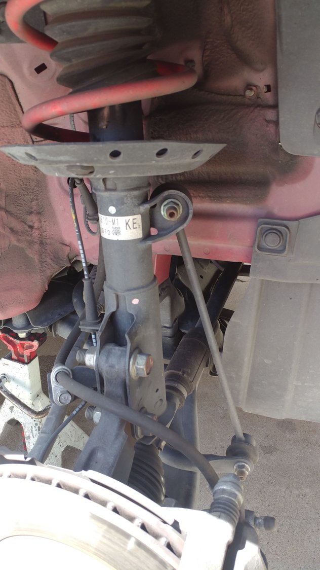

Front:
Jack car up
Support vehicle
Remove wheels (loosed lugs before lifting)
Remove cover panels for top strut access. Use 6mm hex to lock and 17mm to LOOSEN nut.
Remove sensor wire from strut
Remove Sway bar link from strut
Remove brake line from strut
SUPPORT the knuckle to avoid CV axle from coming out
Remove (2) 19mm bolts holding strut to knuckle
Remove the top nut while supporting the strut assembly so it doesnt just DROP out.
Use bungees to hold knuckle in place.
Install is reversed.
Many of you might be going "wait you didn't remove the cowl or wiper assembly." This is true. I did NOT have to or choose to not remove it. The Honda Service manual does not mention needing to remove the cowl so I figured I'd give it a go. If you have only allen wrenches then you will probably HAVE to remove the panel as they are typically too short to clear the wiper assembly on the driver side. Passenger side has room for days. You also have to swing the wipers a certain position to get access to the top of the bolt. I had this 6mm hex that worked with my socket wrench (used on my motorcycle somewhere I'm sure). Perfect match with a ratcheting wrench to remove the driver side and no risk of broken clips.

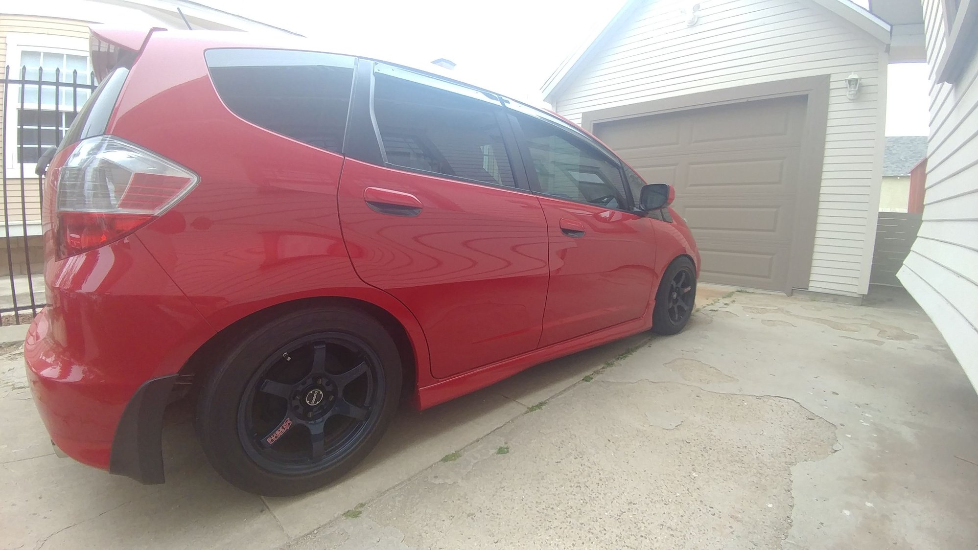

Installed camber bolts in the lower slot up front and the top hole is slottted so you can get some decent camber I think. Time to get an alignment. Tires tucked nicely to boot!
Initially the drop looked great but it was so low that it rub even on slight turns.
Ultimately loved the look but hated the rubbing so I raised it an inch or so.
Rear will rub slightly on the hwy when I hit a dip fast. Down to 1.5-2 finger gap up front and 1-1.5ish in the rear.
Initial driving setup is right in the middle. 15 clicks from full soft or hard.
Also the ride SEEMS improved especially inin the rear. Only have 5-10 miles on it. Will report back. So far, extremely happy with the result!

Update. Suspension still rides great. I ended up rolling the rear fenders as having passengers in the rear would cause it to rub on anything that wasn't a smooth surface. This is due to my wheel setup. If I were on 15x7's +35 I probably would've cleared easily as it was BARELY rubbing.
The front is still fine and will only rub under at highway speeds taking a turn and hitting a dip simultaneously. Under normal driving conditions no issues.
Haven't messed with the damping settings and plan to leave it where its at.
