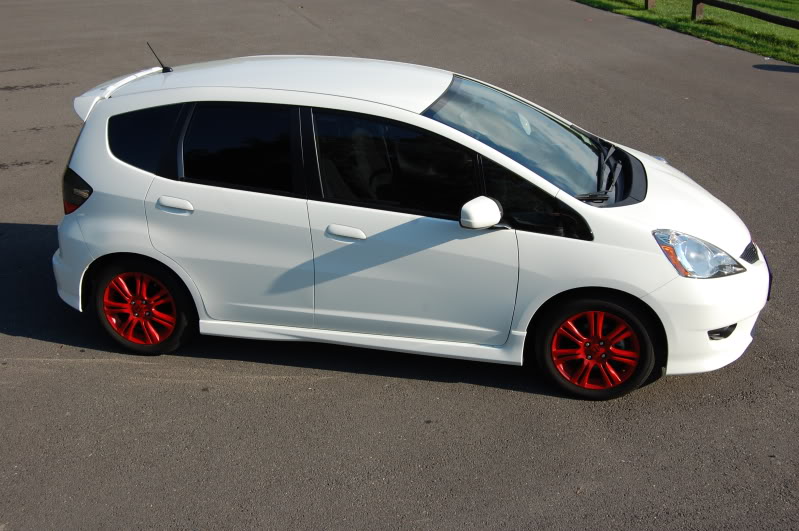

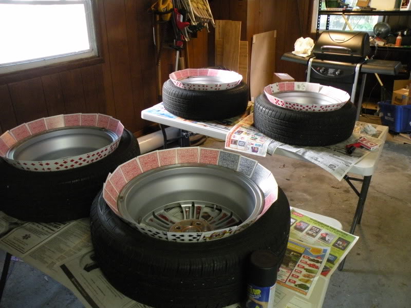

Last year did this with just straight Red Plasti Dip and really liked the look, tore it off over the winter and going for what I hope to be a long lasting and removable bronze finish + clear.

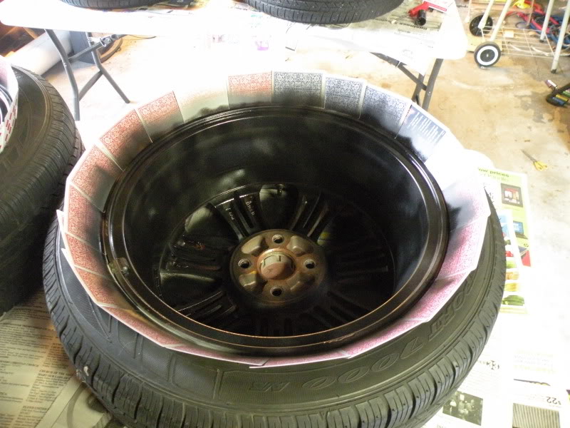

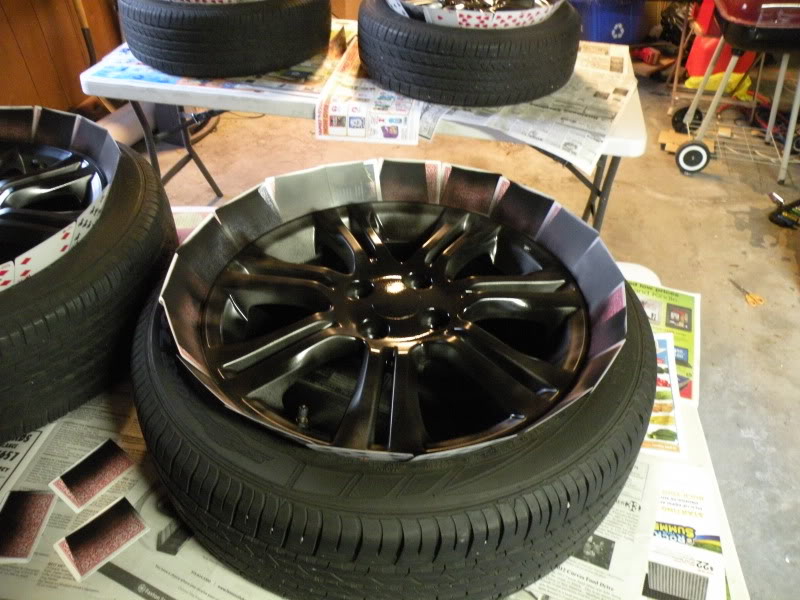

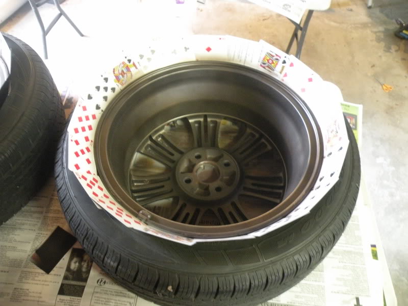

Here is progress so far, just put on 3 layers of Black Plasti dip on the backside of each wheel. Hopefully will get 4-5 layers on the front tonight after the back dries. After that, i will be using Bronze Wheel paint 4 coats front and back, and then clearing it. Last year the Red got very dusty and dirty and slightly worn down at the end of summer, so I'm hoping the paint + clear will help protect it and give me that long lasting removable finish.

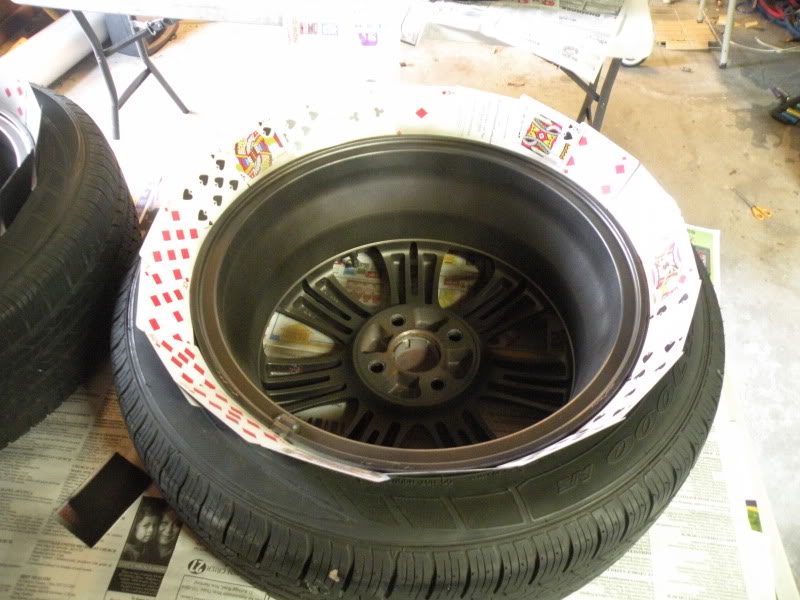

Coats on the front now
1st very light coat - the Fit Wheels are not the best for PD'ing, due to the very small opening in the spokes at places, but it still gets in there and comes off fairly easily with a pressure washer, some elbow grease and a few hours of your time

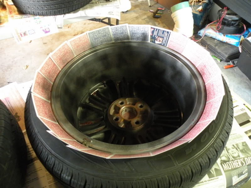

2nd coat - Going to do 4 coats on the front

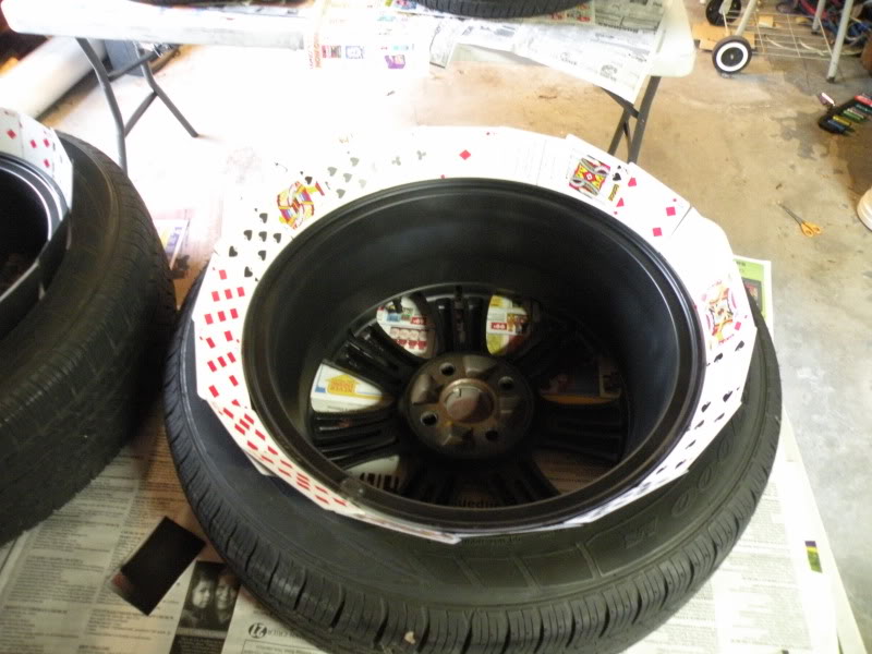

5 coats on the front, drying overnight, Paint tommorow!
Much better job on these this time, then last year IMO, Really looking forward to the final product

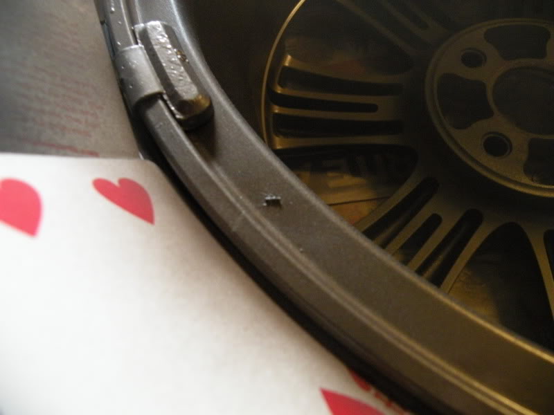

Pro tip - Don't forgot to exacto knife the the very small contact area where the lugs hit the rim when done, otherwise when the wheels get tightened, you could easily rip the PD and have to start all over
