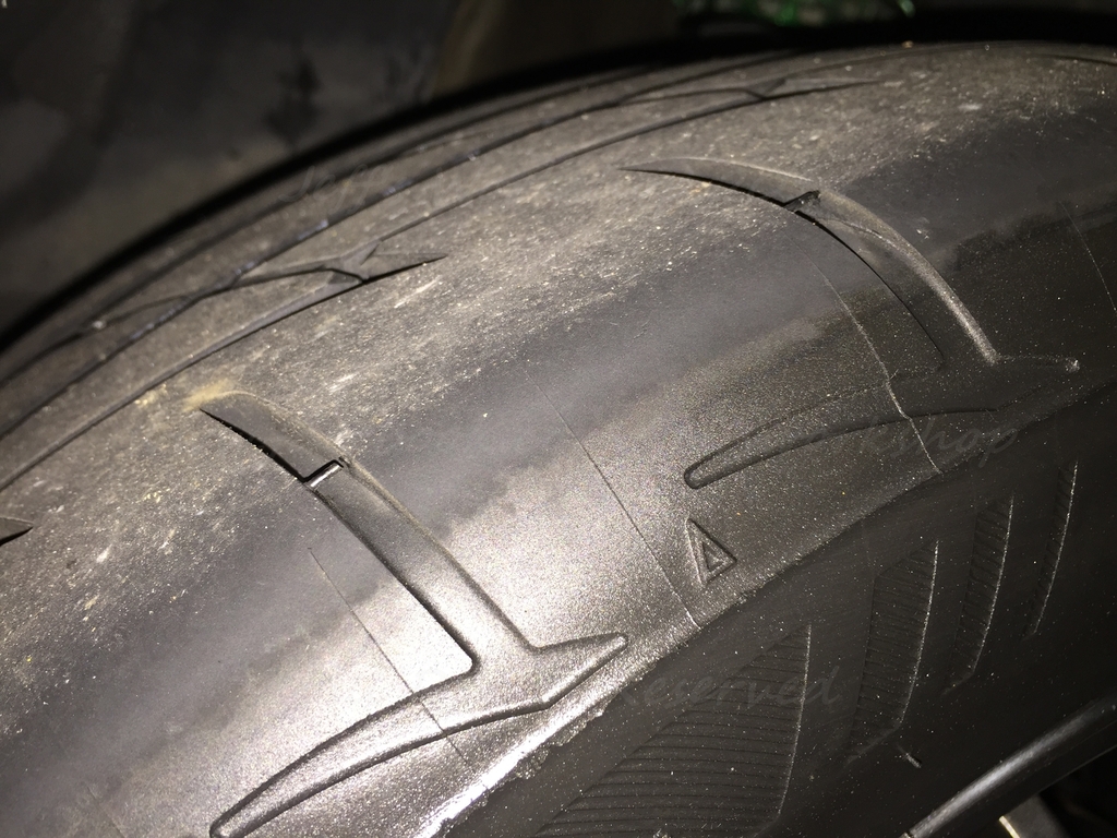

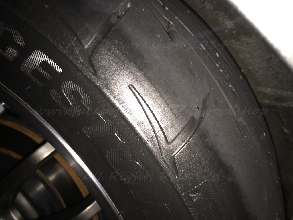

Update with new tire ground contact area
Front left tire, 38psi cold pressure:
Rear Right tire, 26psi cold pressure:
As you can clearly see, with pressure at 26psi and aggressive mountain road driving, the rear tire shoulders barely touched the road.

I've made this type of allowance in F-R pressures for years. Remember, inflation values on the doorjam sticker are for FULL RATED LOAD, not typical driver-only use.
If you were truly anal about inflation pressures,
you could always buy an inexpensive non contact thermometer to test temperatures across the tread after your drives. ~$20 USD in this country.
Infrared Thermometer - Non-contact, Digital Thermometer
A uniform HOT temperature across the tread would pinpoint the correct PSI to use.
you could always buy an inexpensive non contact thermometer to test temperatures across the tread after your drives. ~$20 USD in this country.Infrared Thermometer - Non-contact, Digital Thermometer
