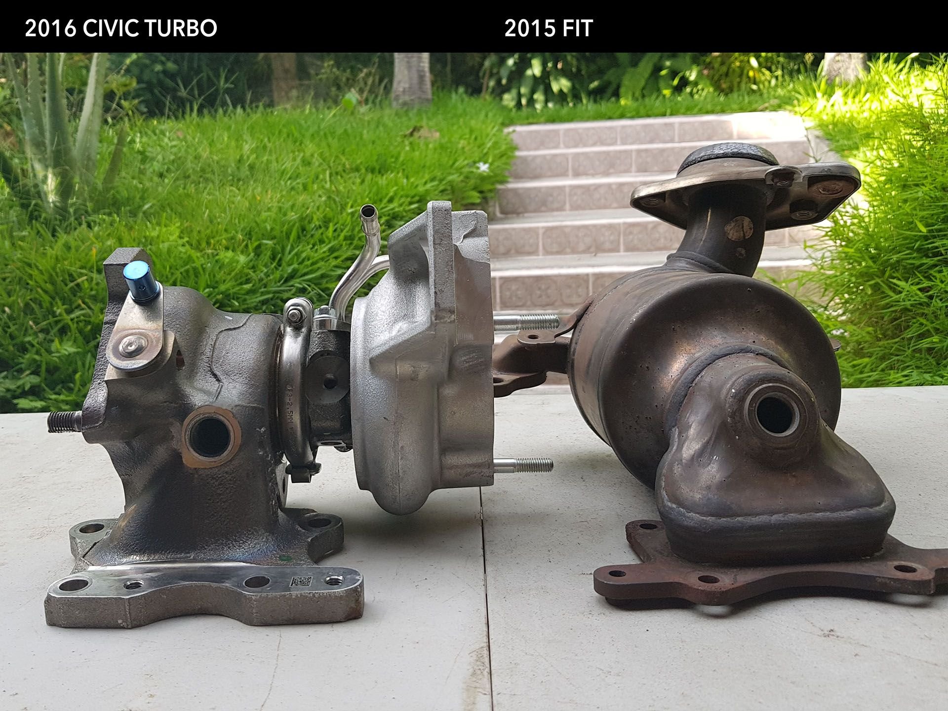

Since I knew of the civic turbo with the L15 engine name as our fit I figure swapping parts would be a good way of making turbo our car, problem is that nobody seems to be willing to take hands on doing it...
So I decided to take up the matter and venture on this path, not without involving all who have that same concern, and perhaps with your help we can discover the best way to make it possible.

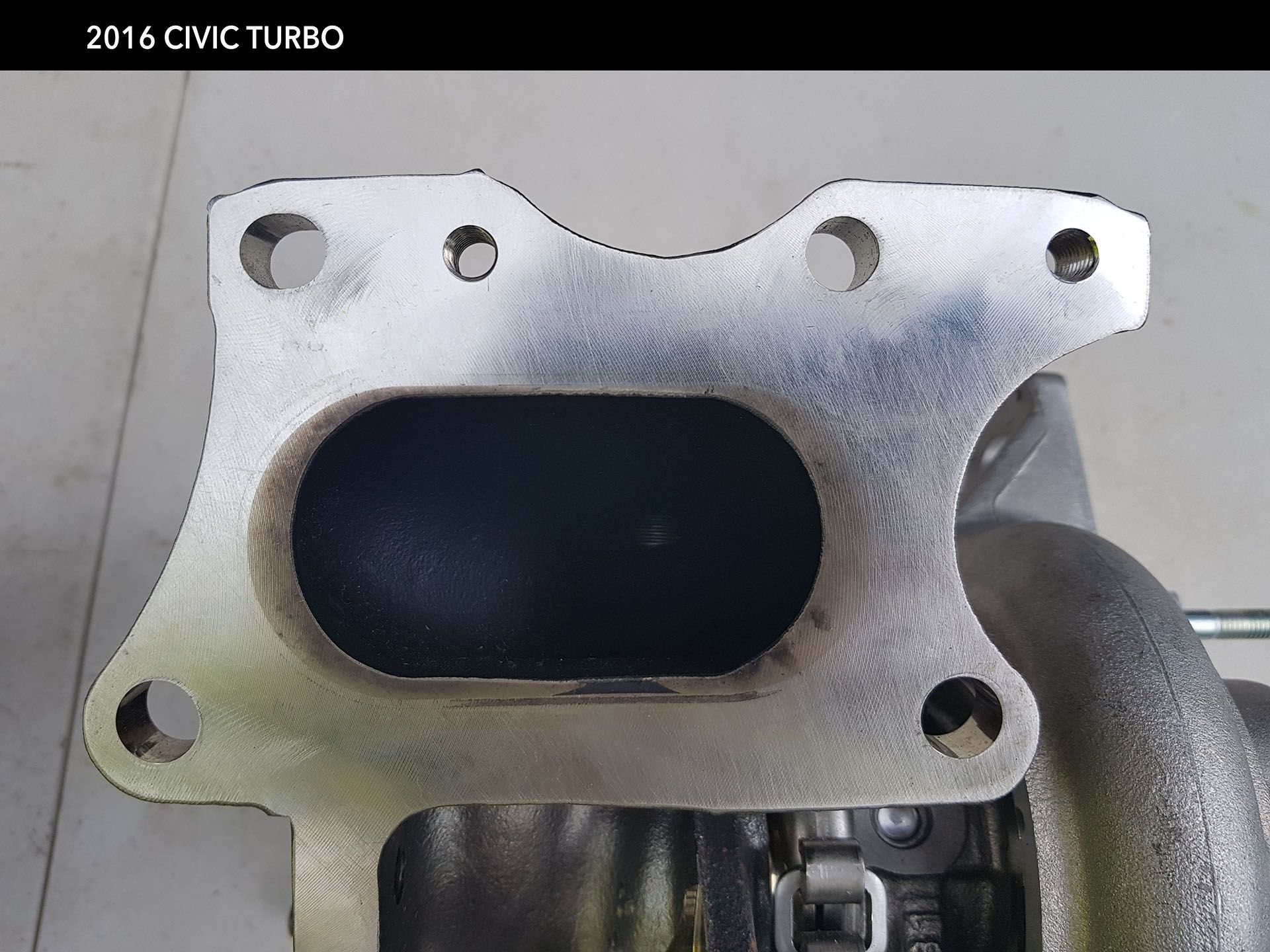

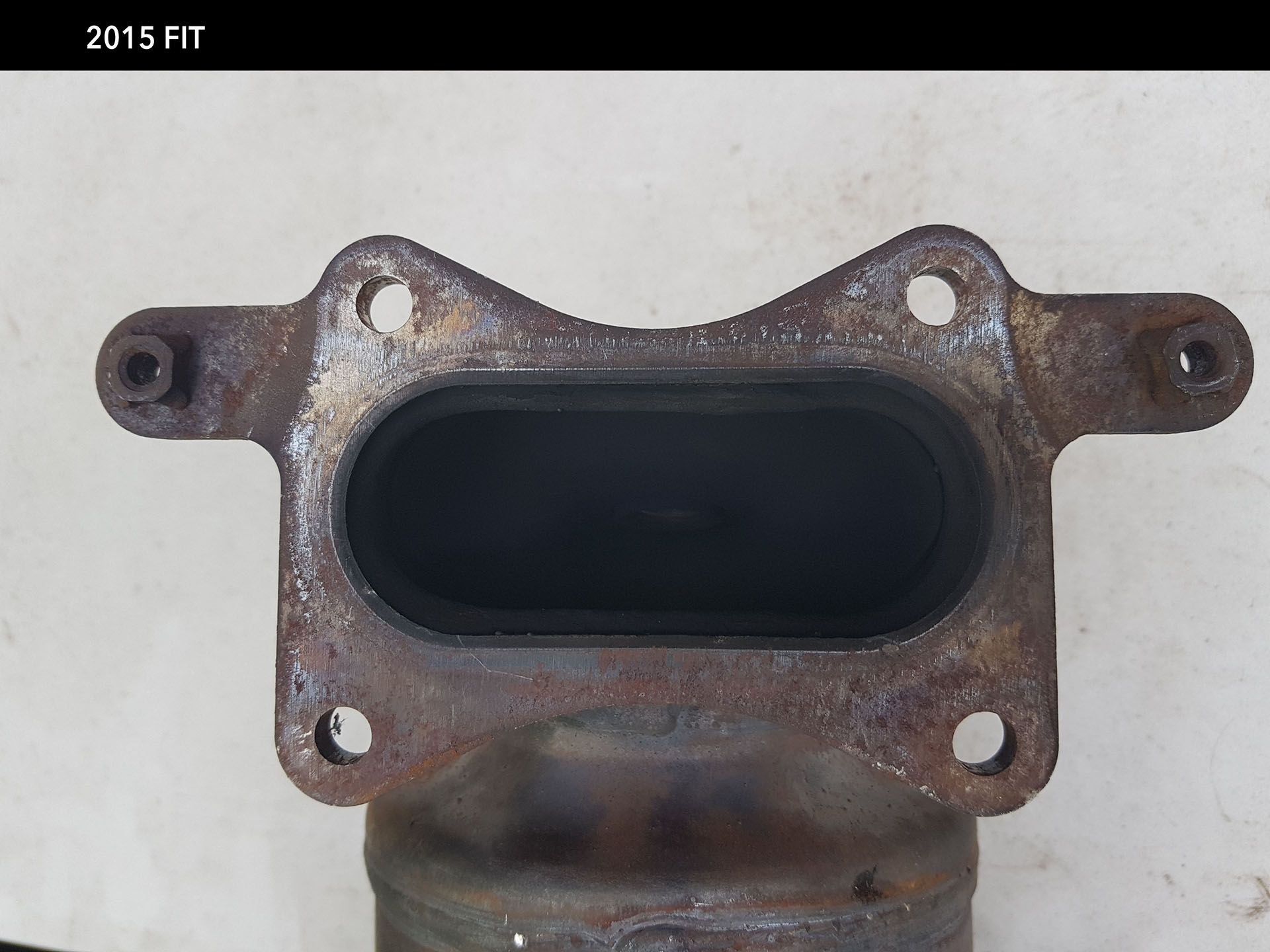

With that on the table as a first step I leave here a couple of pics comparing exhaust outlets from the stock downpipe with catalytic converter vs civic turbo and sizes on both of them to figure out if it would fit.

Here are a couple pics comparing stock fit downpipe vs civic turbo.

Oviyo,
Here are the pics you wanted me to post up. You wanted to share some some info about them?
Honda Fit exhaust Manifold Inlet
Turbo Inlet
Turbo Inlet and Honda Fit Exhaust Manifold Inlet
