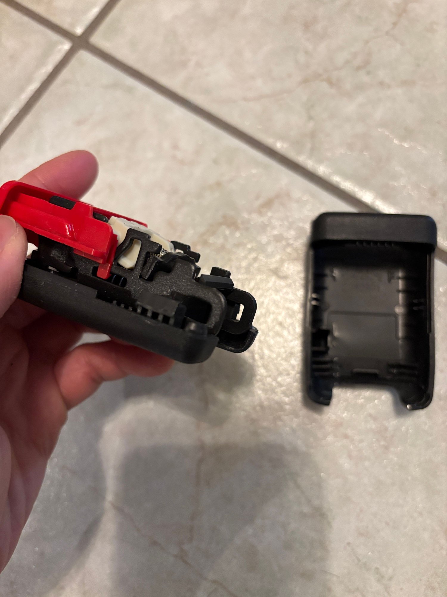

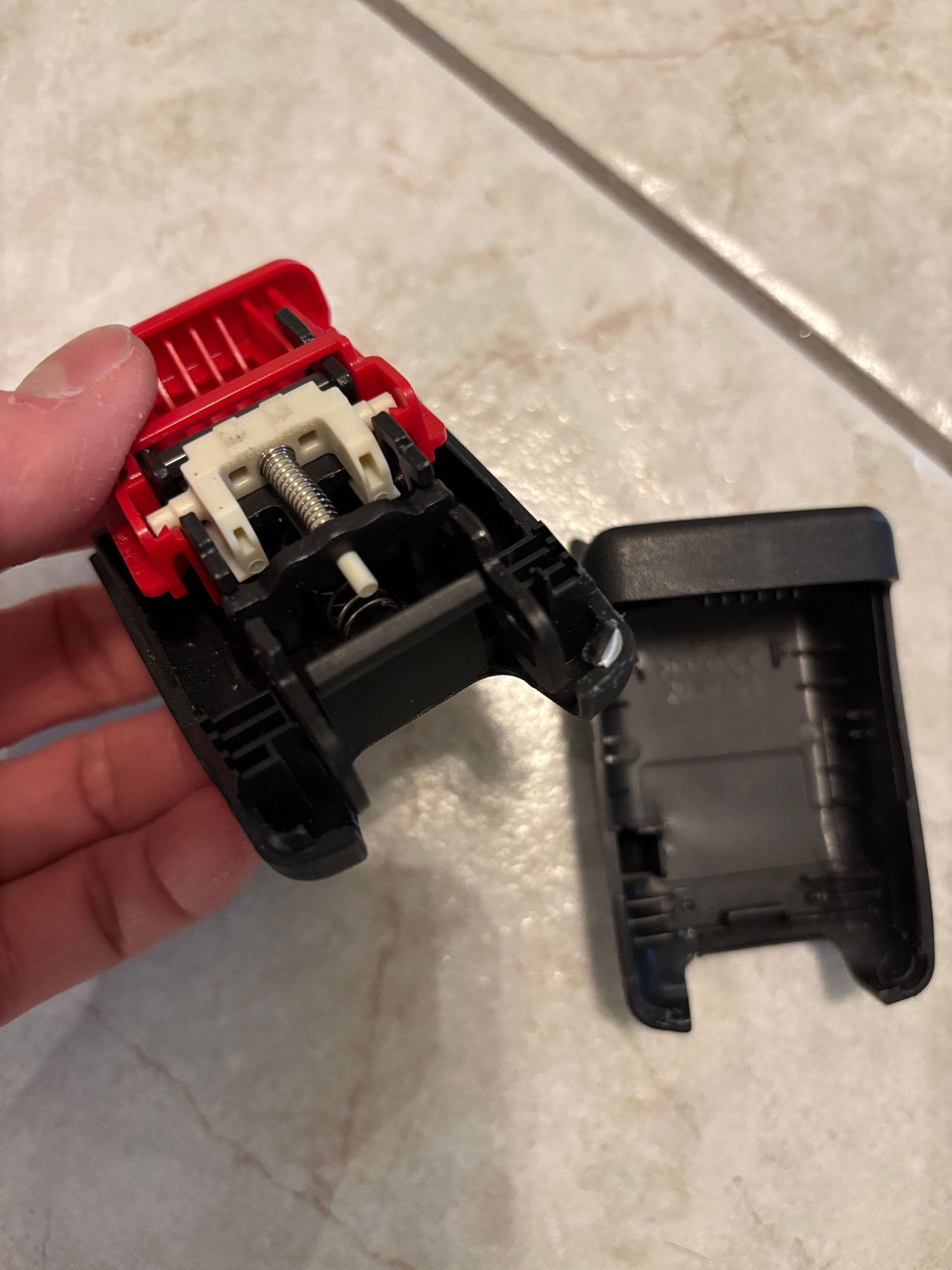

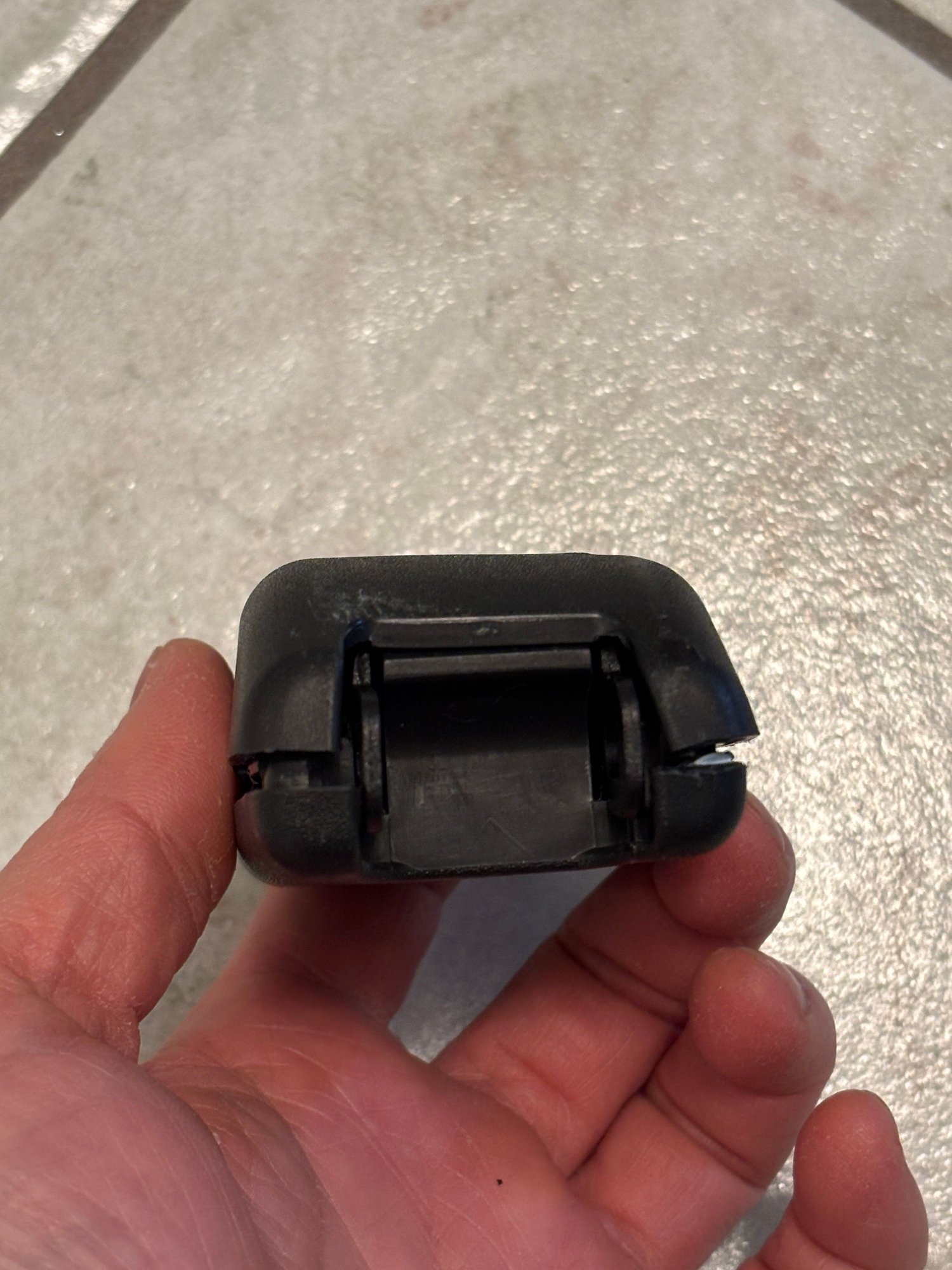

PARENTS: please check yours!! Same thing happened to me.
I was relocating a child seat from my 2016 Fit with 85,000 km and had the same experience of finding a seat belt buckle that fell apart. Initially, it looked like the red button was pressed down and jammed, and the casing was already detached. The red button wouldn’t push any further when I tried. After some effort, I unlocked the seat belt and the receptacle casing separated into two pieces. What’s more, the little rod that connects the receptacle to the strap that’s bolted to the frame detached and fell off.
Like the OP, I’m pretty disappointed but also grateful that I didn’t find this out in a crash. I believe that if I had an accident, the force of the child seat tugging on the receptacle would have just yanked it loose…don’t want to imagine the consequences for my child or other occupants in the car that could be hit by a loose 50lb convertible car seat.
Here are some photos. You can see that one side of the plastic bottom had warped, likely due to the weight of the child seat tugging on it constantly. It then broke off one of the clips within.
I will contact the dealership to see if it could be covered by goodwill, since there isn’t the same lifetime warranty on seat belt components in Canada as there is the US (go figure). I will also contact Honda Canada as this is a safety hazard.
