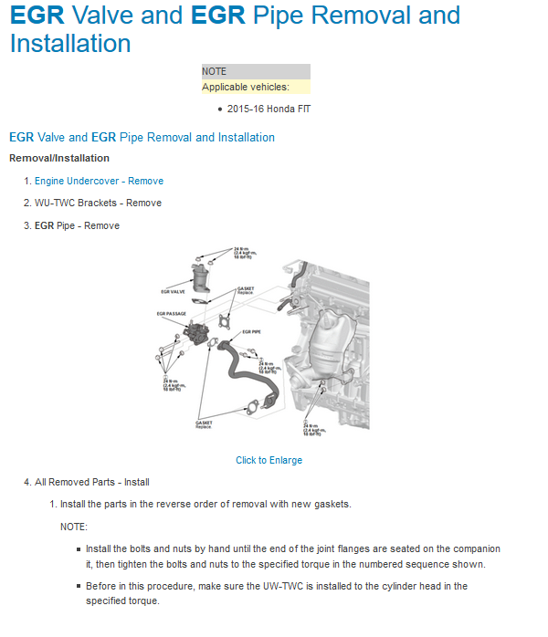

lastly, someone on here posted a way to access the Chilton Library / Manual ... once you locate that ... you can pull up a guide on how its done, and you can then gauge how difficult it may or may not be yourself

They gave it to me in writing and tested with an HDS system and snapshots/freeze frames. As well as vacuum apparently. It does not look too difficult to do myself. I’m not sure how the errors relate, the p0171 is system too lean, thought it could be the o2 sensor but read a few threads about fuel injectors issues so decided to give the dealership diagnostic a go. It is an autonation Honda where I bought the vehicle and they have seemed pretty decent to me so far...anyway I found some used ones from newer wrecked fits online for about $70/100 with shipping. Thanks for suggestions and help all
