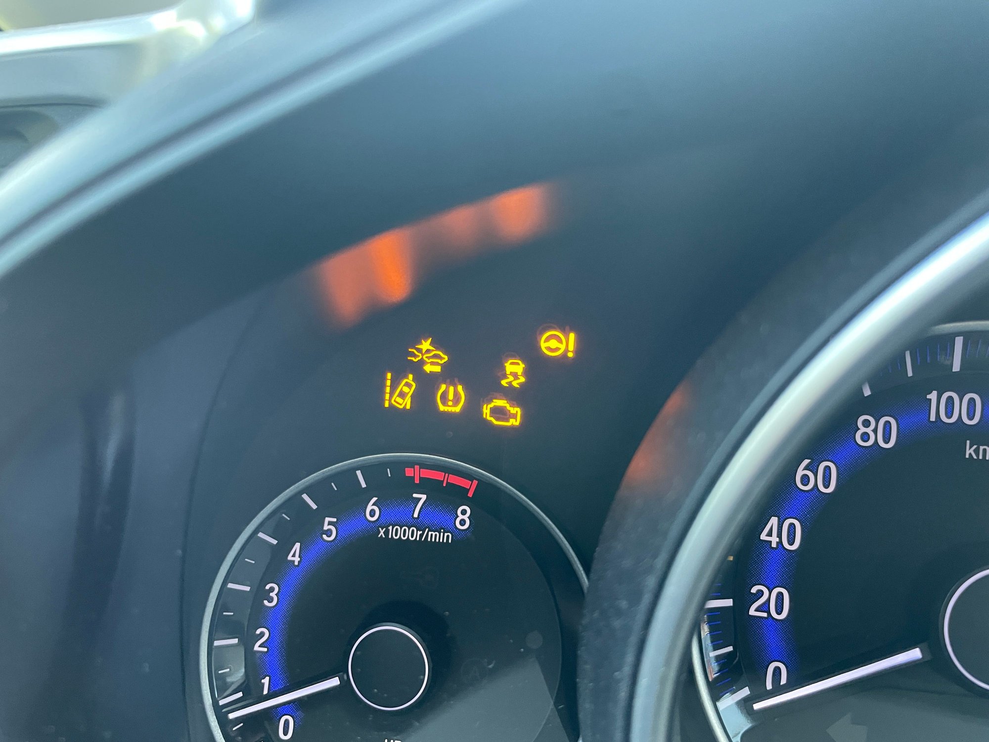

Couple of weeks ago I got this infamous multiple warning lights phenomena while starting the hot engine. I was of course worried, because I've red so many threads about faulty fuel injectors and other costly problems. However, it appears that I was lucky, and it was just a loose battery terminal connection. Propably untightened in the last annual service. I'll defenitely let the workshop know what they forgot.

It seems it was too early to make a conclusion. After a longish highway drive in a hot day I stopped to fill the tank. The engine started fine, but after couple of seconds stopped abd showed all the same warnings. And didn't start anymore. We took a taxi to home and prepared to tow the Jazz to a dealer workshop, but when we were back after an hour or so, it started fine. Anyhow I drove it straigth to the dealer, and it's now there waiting for diagnose.

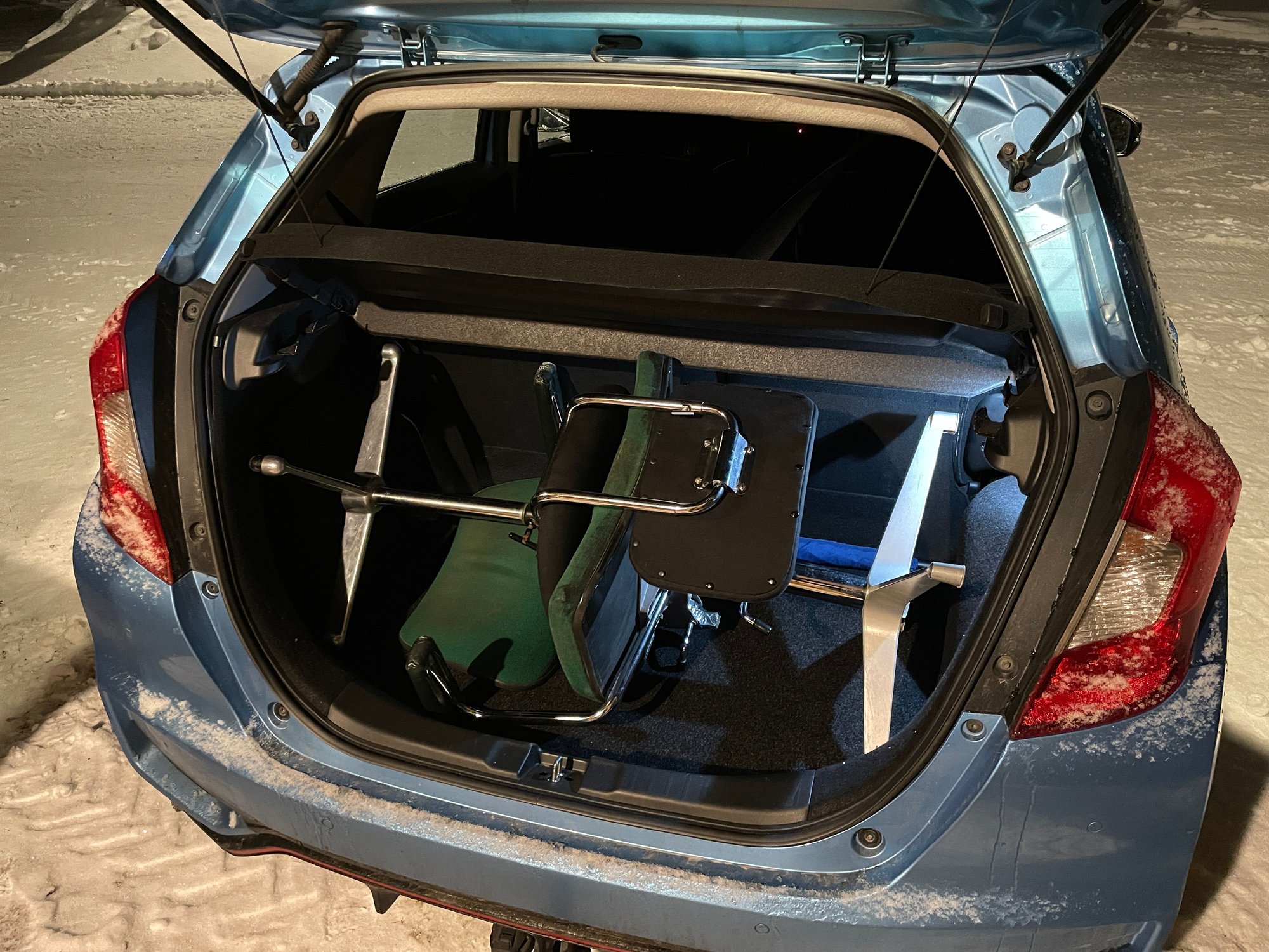

Two old office chairs just fit in the boot.

I have forgotten to update the issue with warning lights and starting problem. In early September the problem occured again, and it didn't start even after cooling down. When the fault was active, the dealer could diagnoze the problem to the low pressure fuel pump in the tank. Good thing was that there was a campaign meaning all the costs were covered by Honda. Bad thing was that the new pump was not readily available. I had to wait for three months for the pump to arrive and get mounted. Luckily I have other (older) cars, which could be used while my Honda was standing in the dealer's backyard.

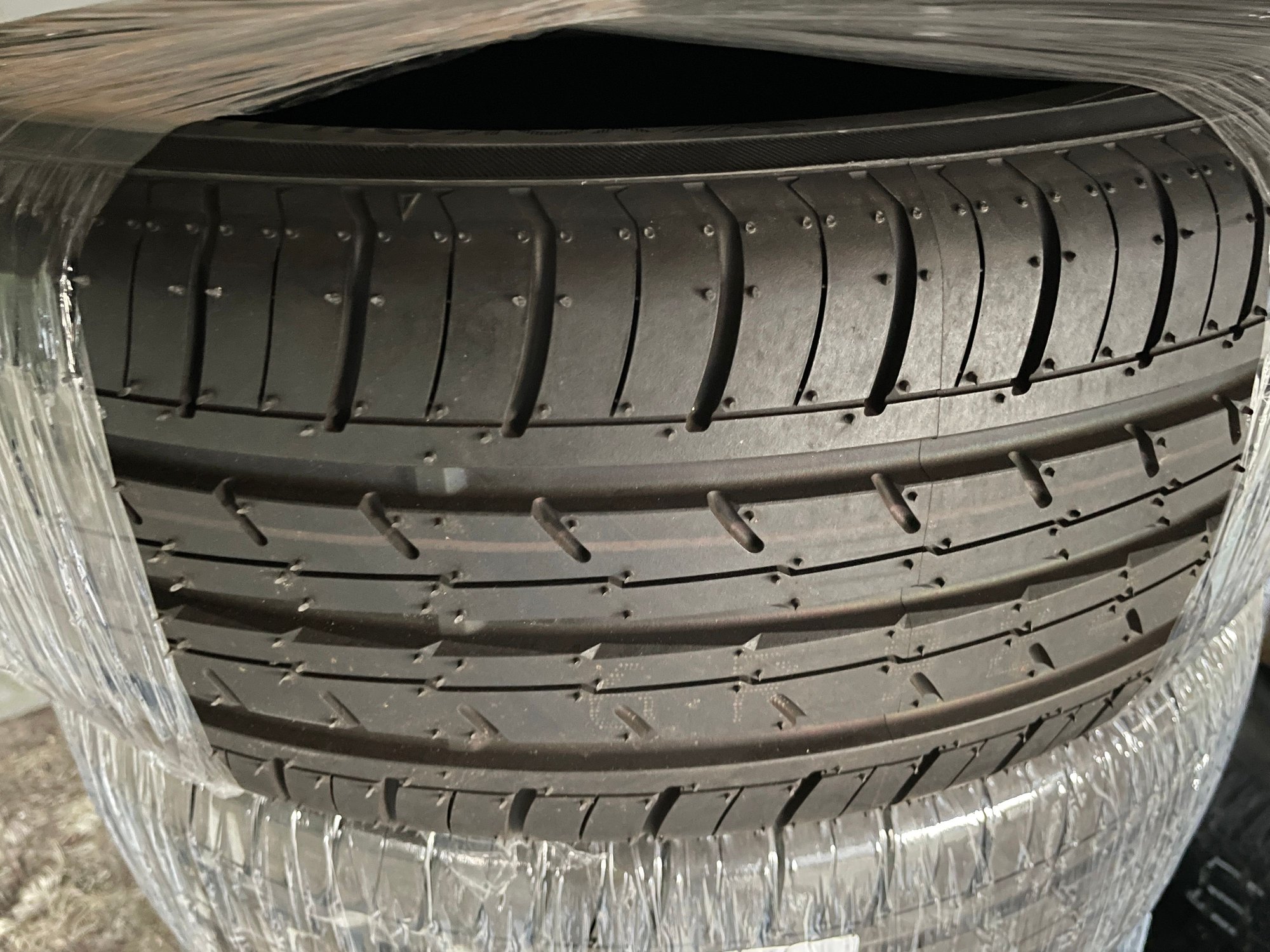

Original summer tires are now worn close to legal limit, and I decided to try Yokohama ES32D tires next. But before that I'll keep my winter tires as long as they last next summer.

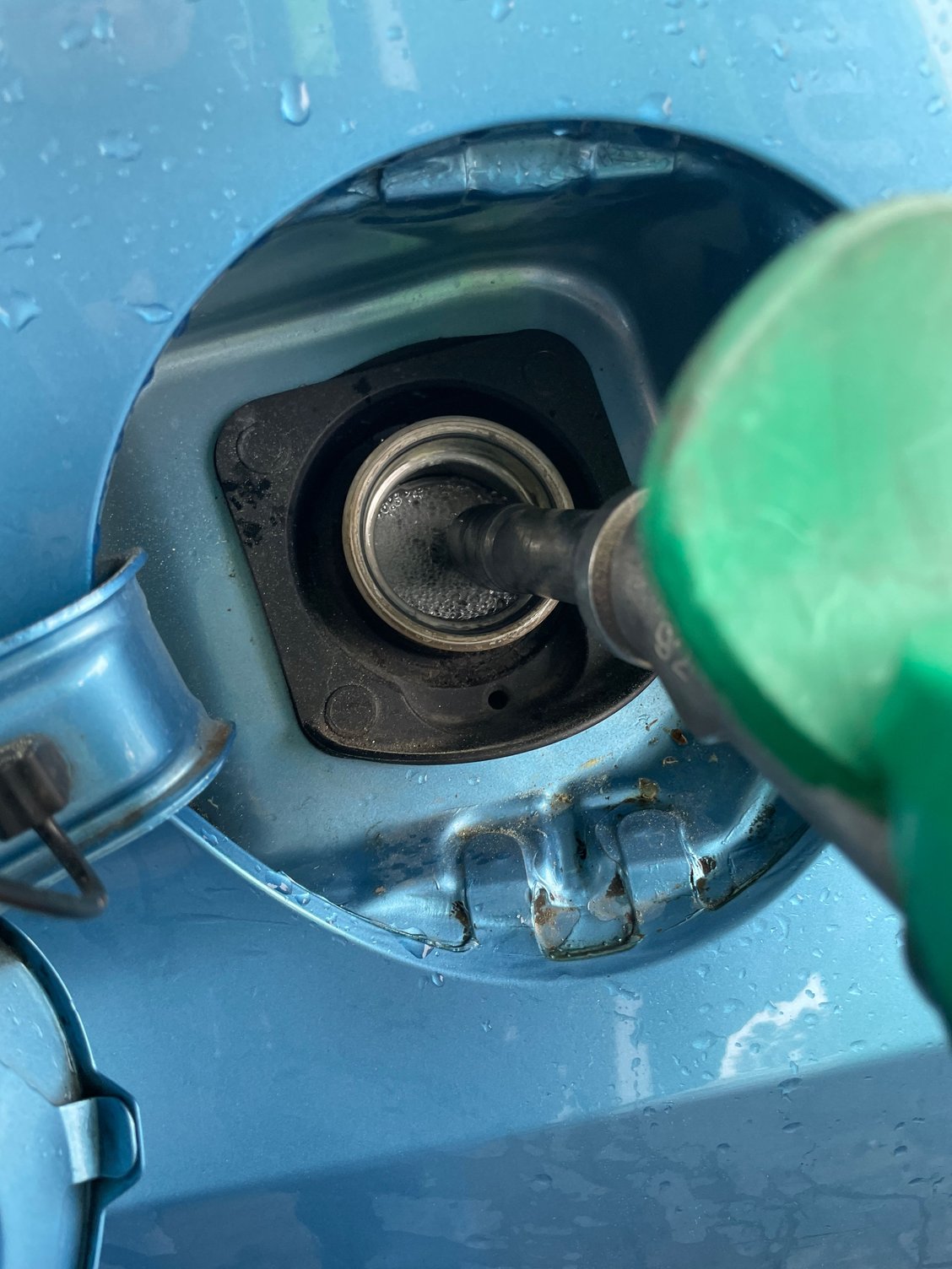

Nowadays warnigs against filling the tank until filler opening can be red in many places. Based on my experience, I would say it is probably depending on the specific design of the tank breather system, and most likely the risk is exaggerated. I have had my GK5 for five years and I always fill it until the fuel surface is visible. And no problem whatsoever.
Of course I have done the same way already for decades, but GK5 is the first one with closed tank breather system.

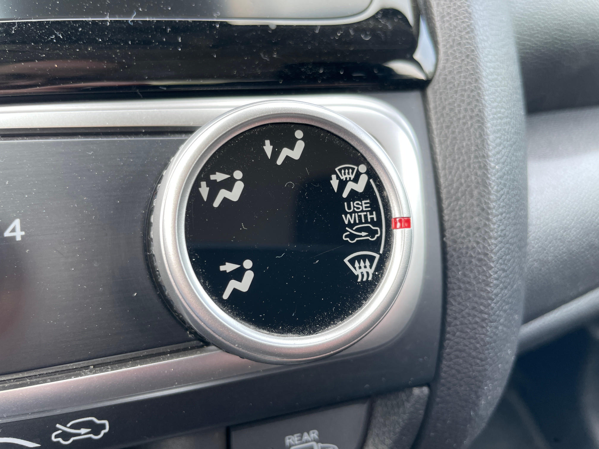

I want to share my preferences for ventilation settings based on my experience.
Most of the time I want airflow both to the windshield and to feet. Turning the knob from the detent slightly more to clockwise as shown in the first picture is least noisy in higher fan speeds.

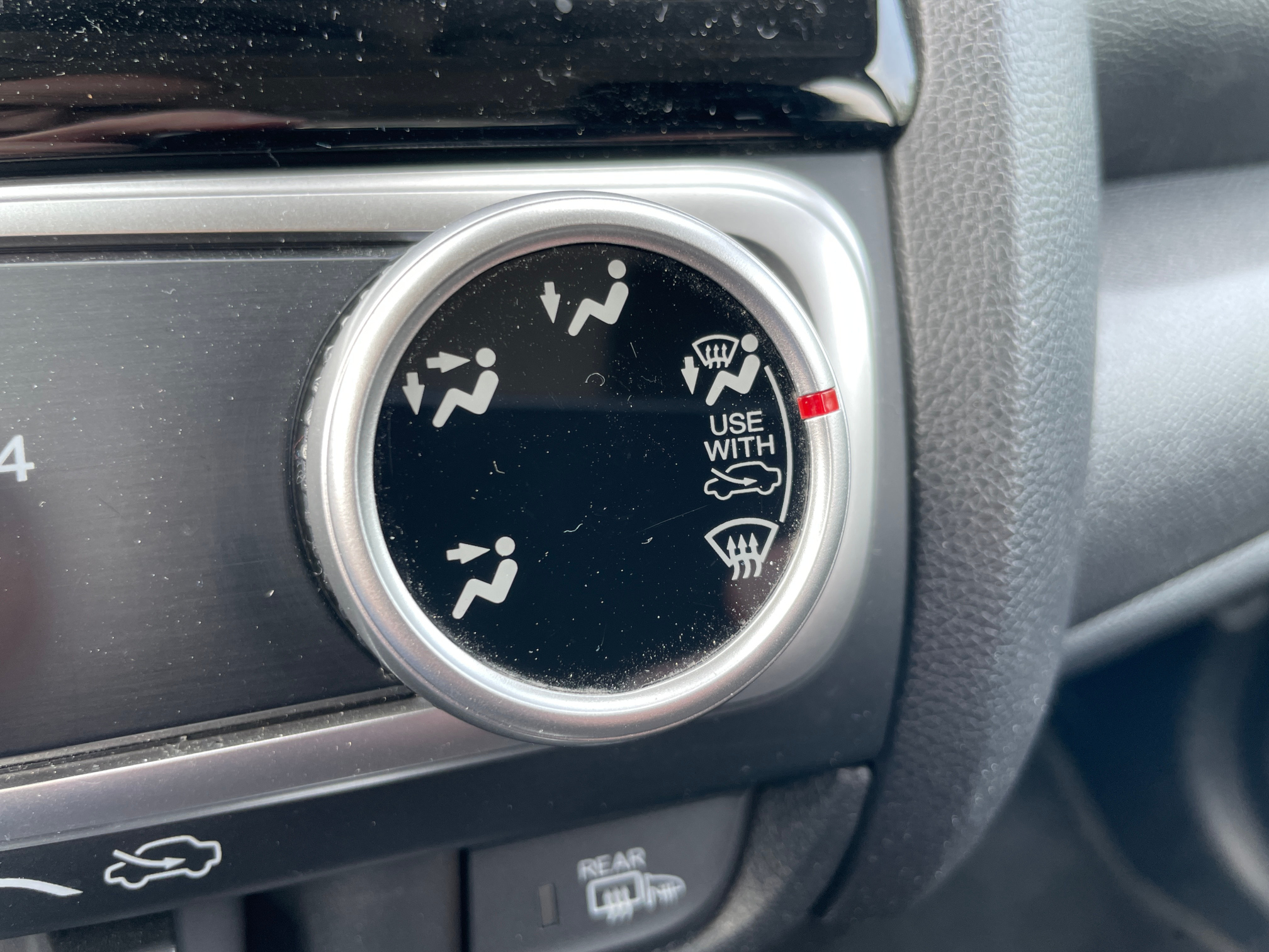

Turning a bit more clockwise as shown in the second picture, you can hear the sound of a microswitch, which disables the auto start-stop system. And you still get some air to feet.
