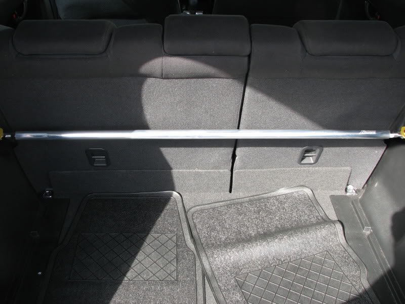

J's Racing Rear Strut Bar:
Driver Side Mount:
Passenger Side Mount:
Bar Installed:

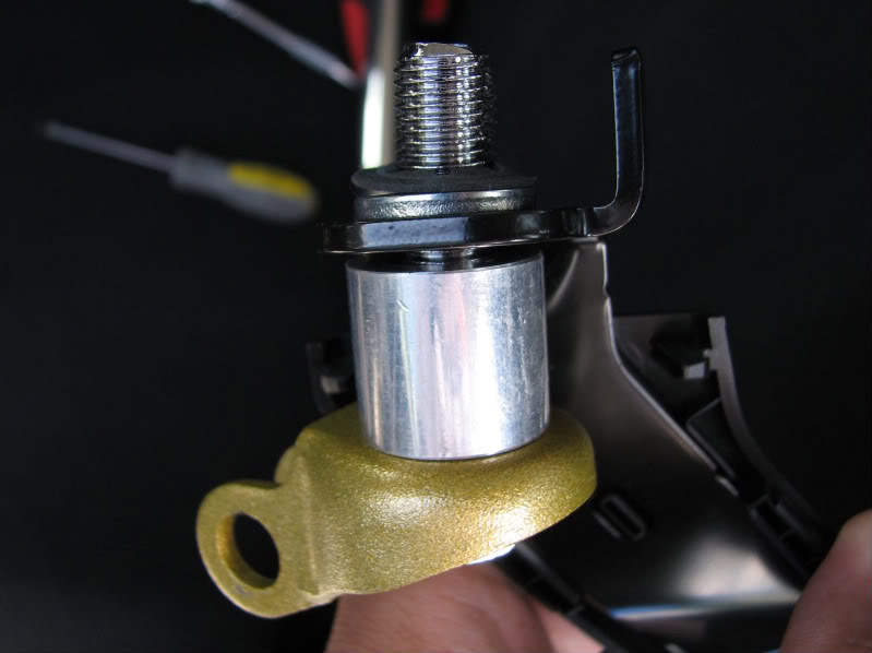

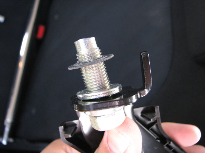

Remove the cover of the rear seat belt on each side to expose this bolt (14mm):
Unbolt the seatbelt and remove bolt. You will reuse the 2 washers(black & sliver) which are the top side of the seatbelt bracket:

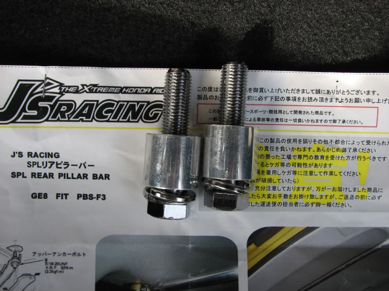

The C-Pillar Bar will come w/ 2 new bolts (16mm) which you will now use in conjuction w/ the black & silver washers from the orginal (14mm) bolt:

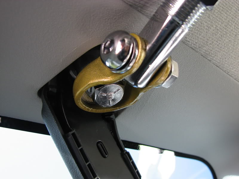

Unbolt the C-Pillar Bar Brackets from the bar and install w/ seatbelt bracket & new the bolts (16mm) from J's:

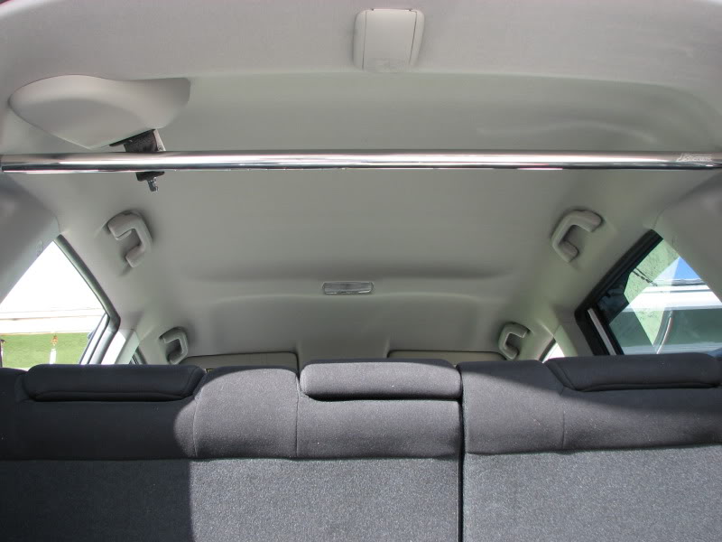

Mount & lightly bolt down the brackets and install the bar like so:
Driver Side:
Passenger Side:
Once bar is installed tighten down all bolts (16mm for seatbelt, 9mm allen wrench & 14mm for the bolts on the bar):
