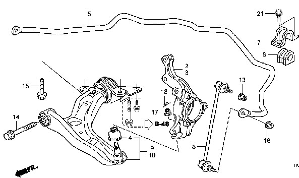

First I would like to comment that the CRZ and GE8 suspension is nearly identical. The only difference I have found is the aluminum front LCAs and front knuckle have different part #s on the CRZ. The front subframe is identical, so the CRZ aluminum LCA will bolt up to the Fit, the only unkown variable is if the knuckle bushing is a different size where it mounts to the LCA. (This would mean that a 5-lug swap would be necessary to run the CRZ LCAs negating any weight savings.)
FIT Knuckle:
CRZ Knuckle and LCAs.
Notice that the traditional orientation of the compliance bushing (red circle below) has been changed on the GE8/CRZ front LCA:

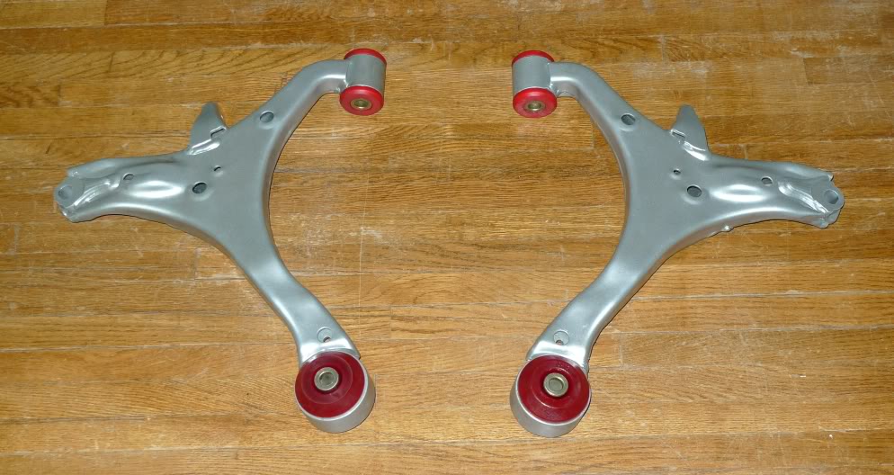

And a better pic showing the RSX LCAs and polyurethane Energy Suspension bushings.

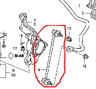

I also want to comment on the dramatic difference in the tie rod end links on the CRZ/GE8:
Notice the dramatic increase in length. I would assume this is because Honda raised the location of the power steering gear box, my Fit is in storage so I can't confirm this suspcion.
