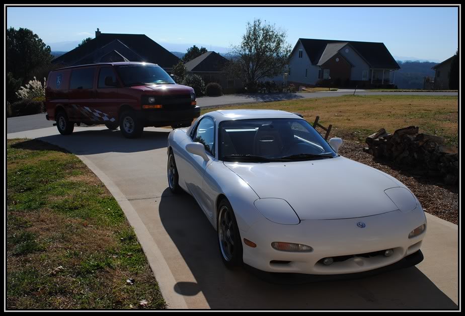

I arrived at the house and began my routine walk around to see what I was dealing with.

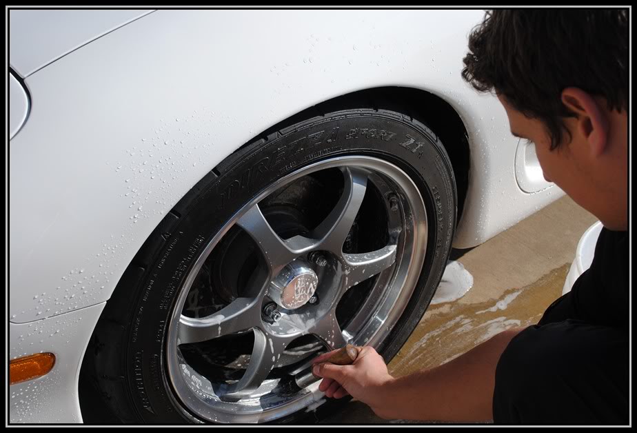

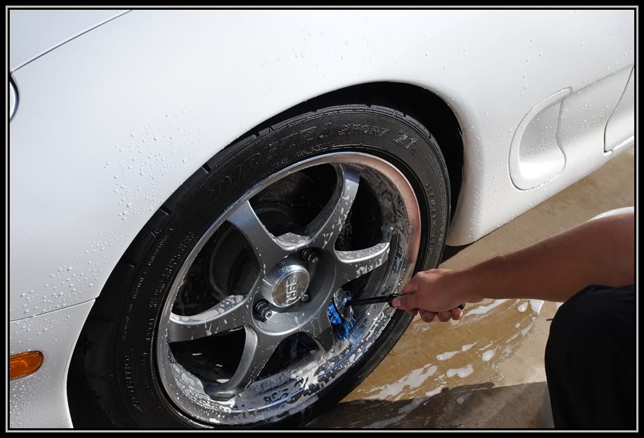

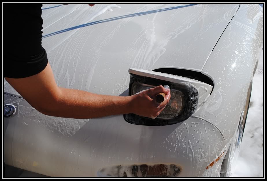

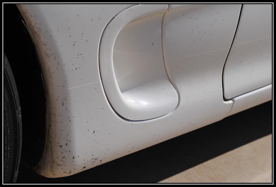

For the wash process I used
Foam Dawn Wash with sheep skin washmitt
P21s Wheel Gel
EZ-Detail Brush
Red Medium grade Clay bar
Nasty gas lid area

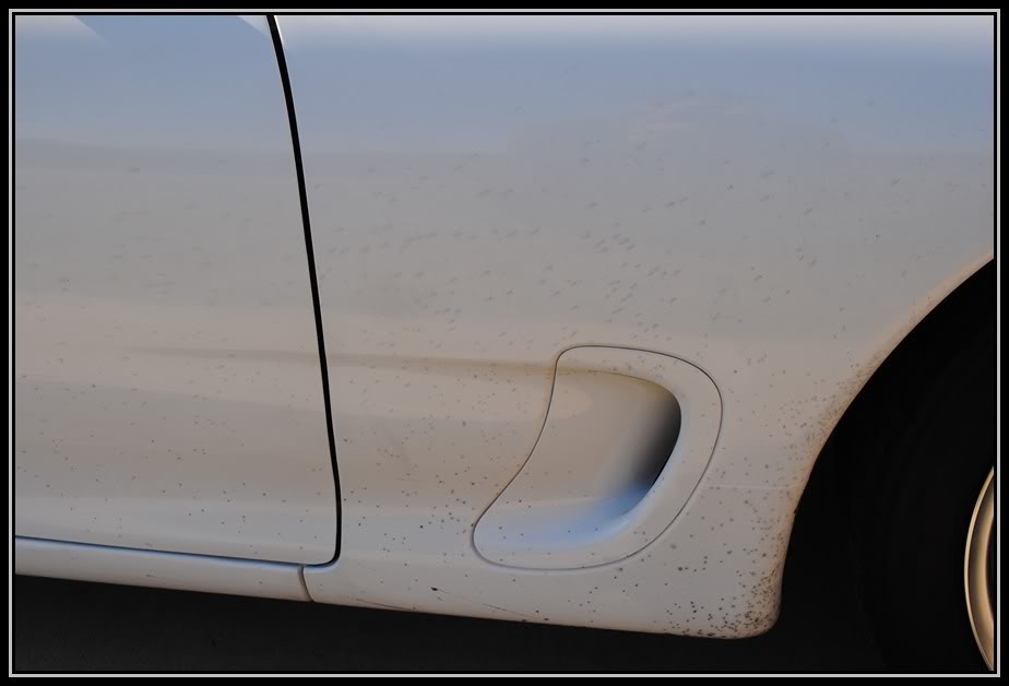

After claying with a Red claybar.....it turned white....

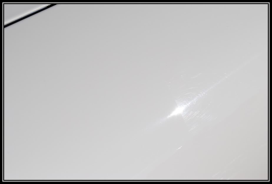

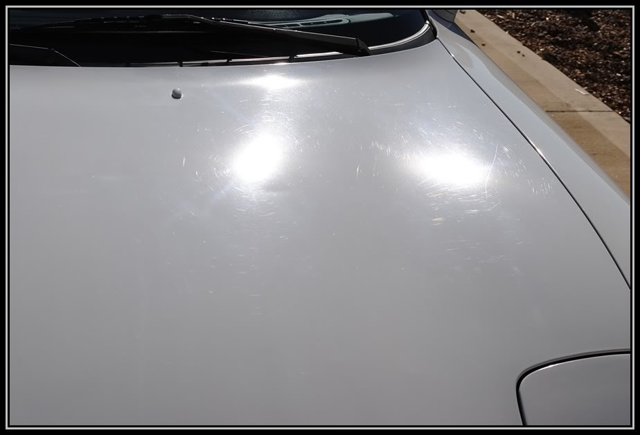

Then before bringing the car inside for the correction, I did a couple of 50/50 test panels out in the sunlight. Sometimes it is very hard to capture these defects with the camera on white paint.

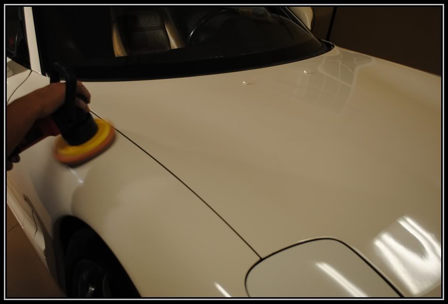

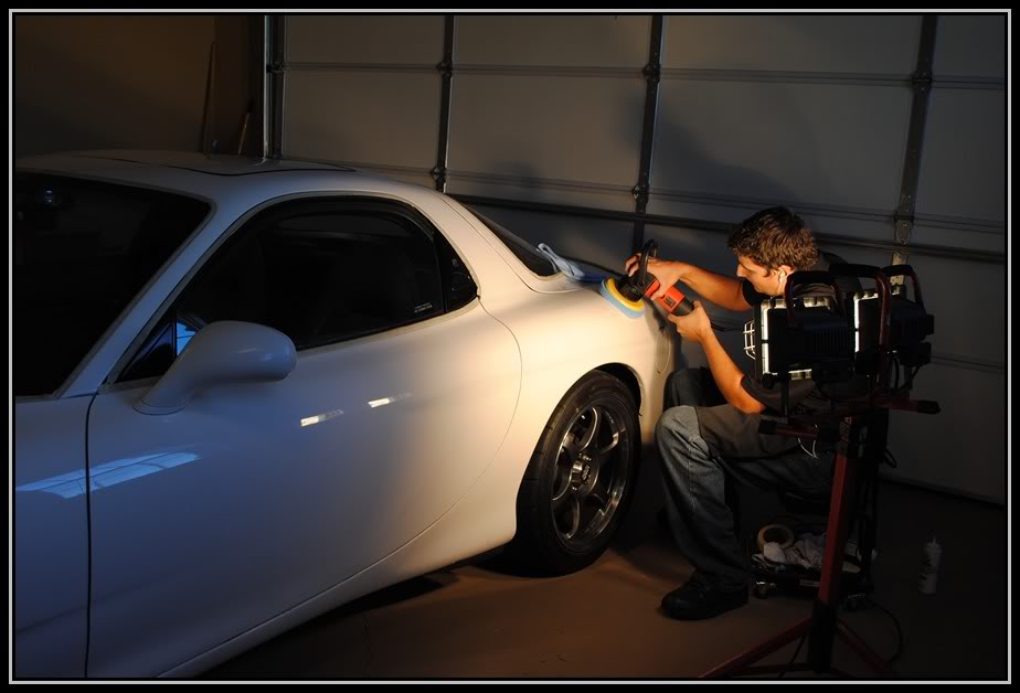

After pulling the car inside I made my way down the Driver Side and using the Lake Country Cyan Hydrotech pad using M105 compound.

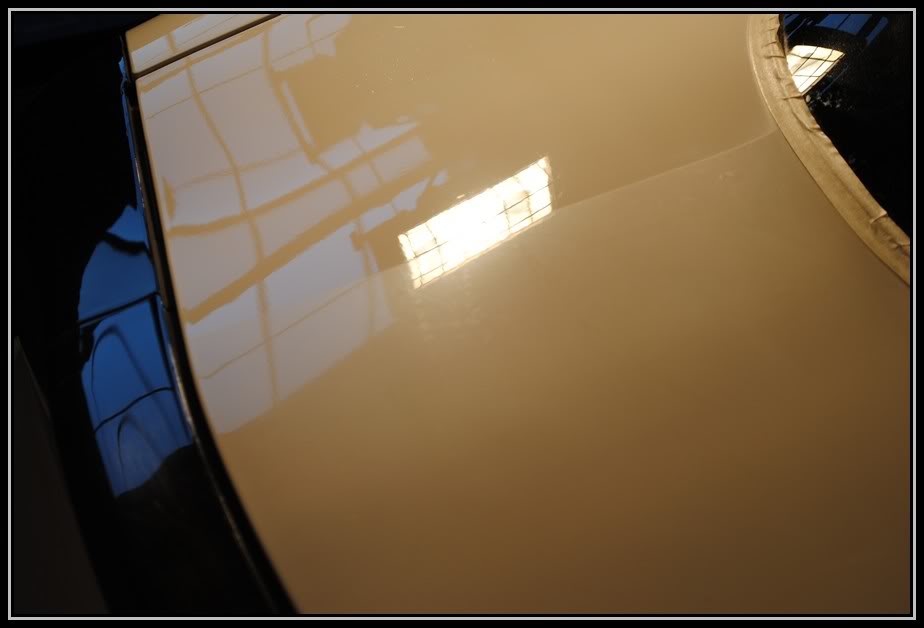

Here is how the Rear Deck Lid looked before During and After

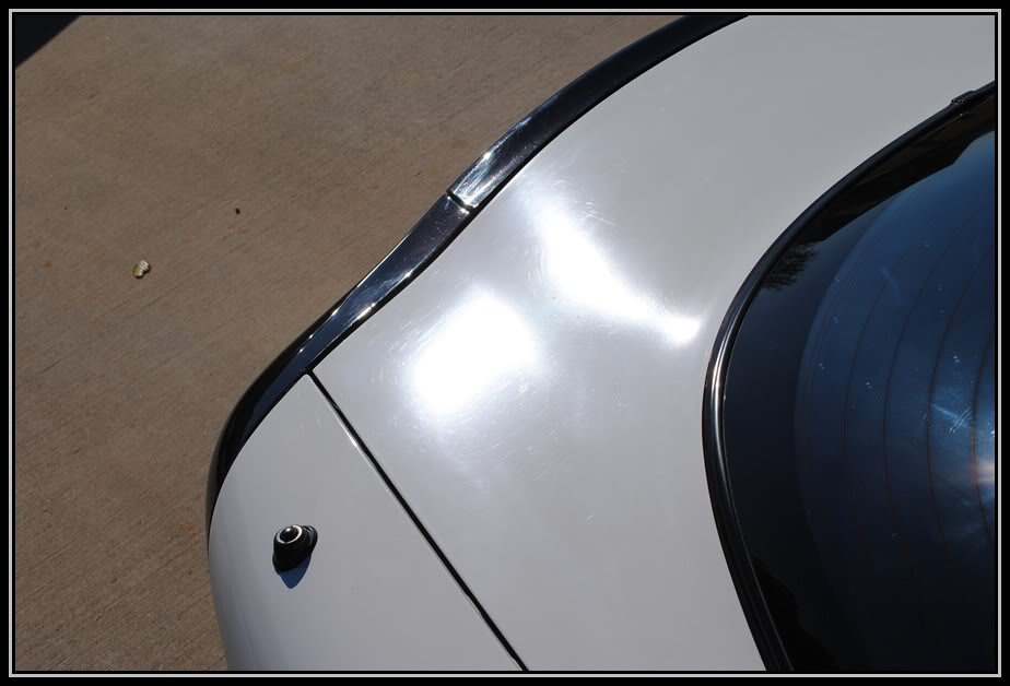

Here is an angle where you can see by removing a layer of that Dead & Faded Clear coat, that the paint is a whole different shade of White!

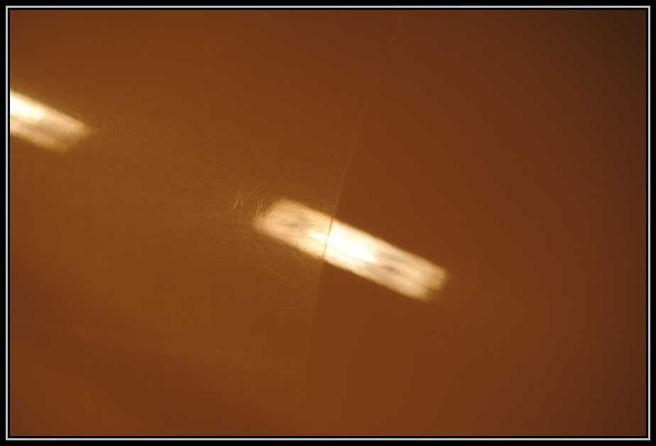

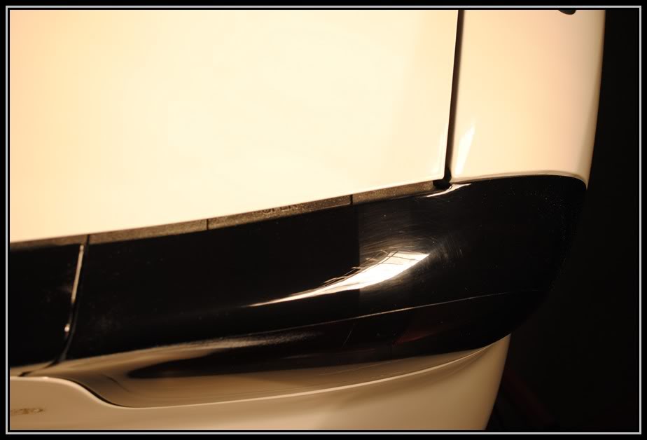

Next is the Taillights, they were severely swirled. here are some nice 50/50's

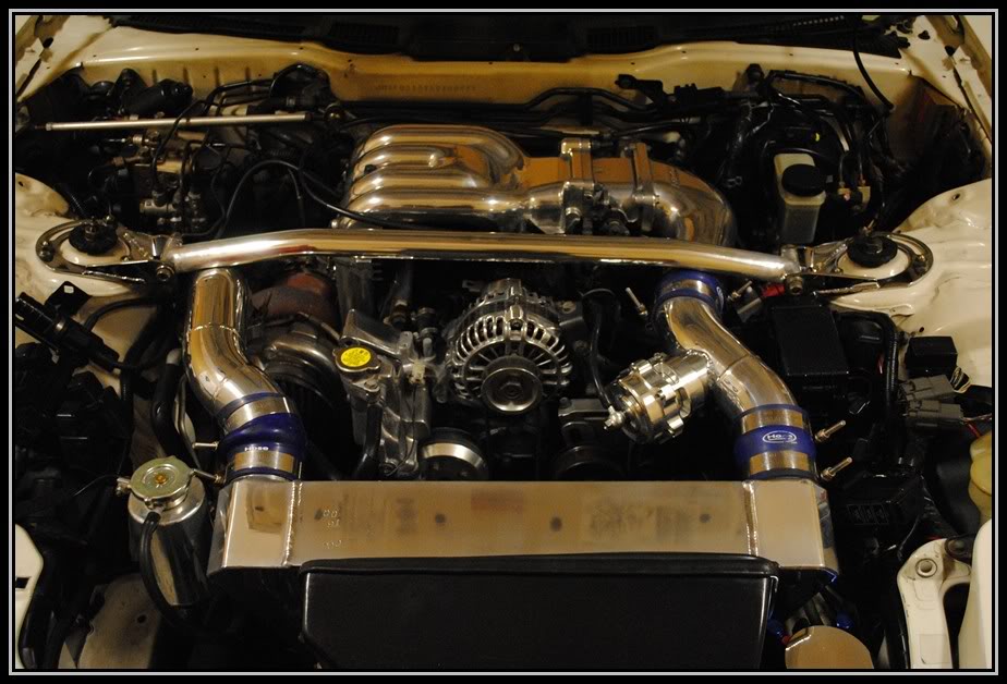

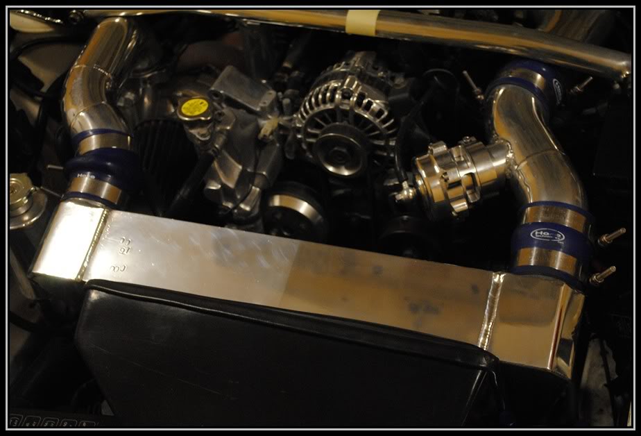

The customer asked me to polish out the 13B and all of the intercooler components, and pipes.
I taped off a section of the intercooler to see what kind of difference was actually being made. It's kind of hard to see but here are some 50/50 shots.
It brought back the depth and the shine in the aluminum
Not the best lighting but it looked a lot better.

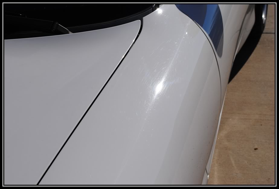

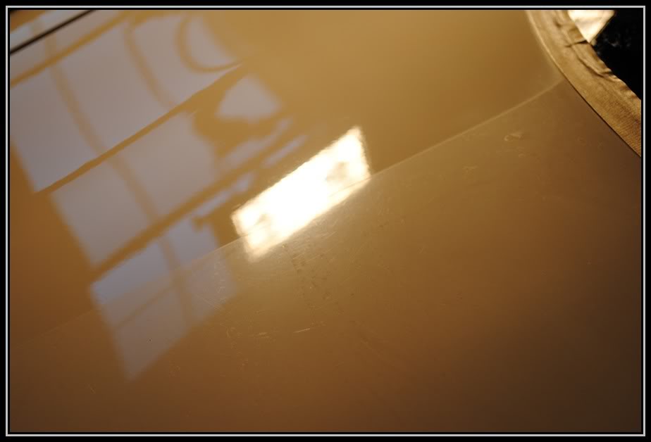

So now I just had a little bit of correction left of the paint. here is the front passenger fender 50/50

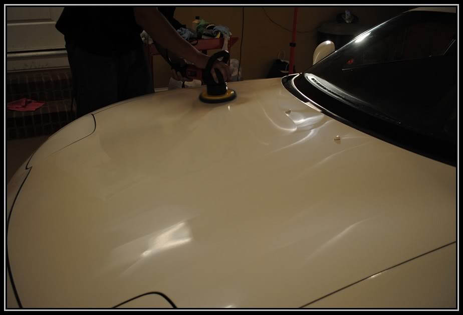

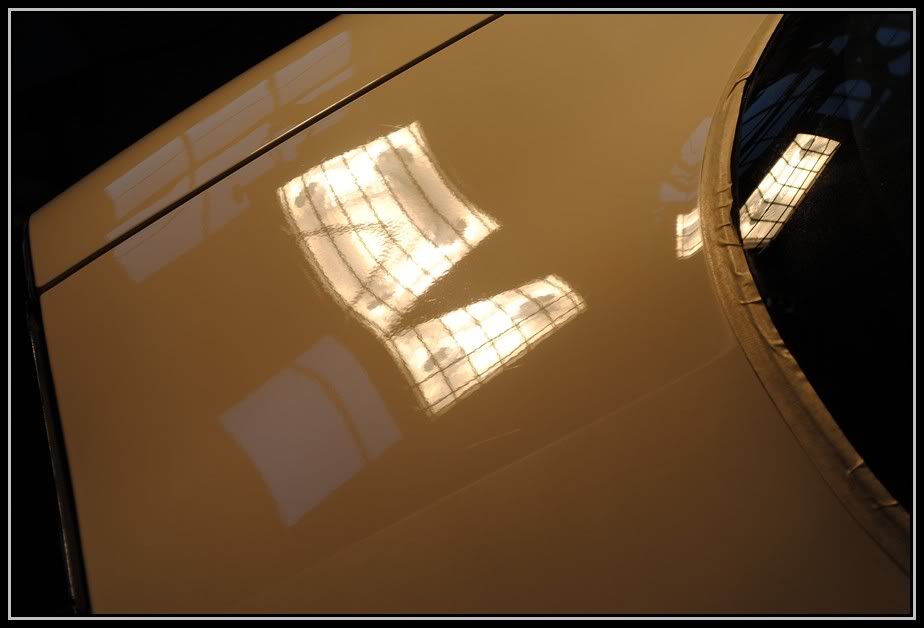

After that, The car was polished out with M205 and a LC tangerine pad
Then Black Fire Wet Diamond was applied with a Lake country Blue Finishing pad

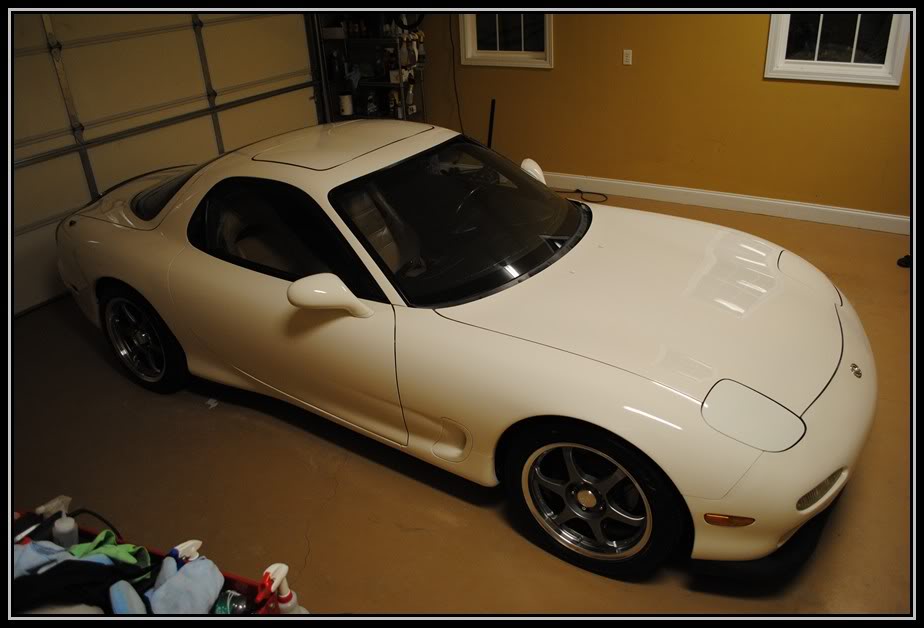

Sorry that I didn't get any out side shots, the car was finished really late and it was dark outside. but here are a few from inside the garage.
