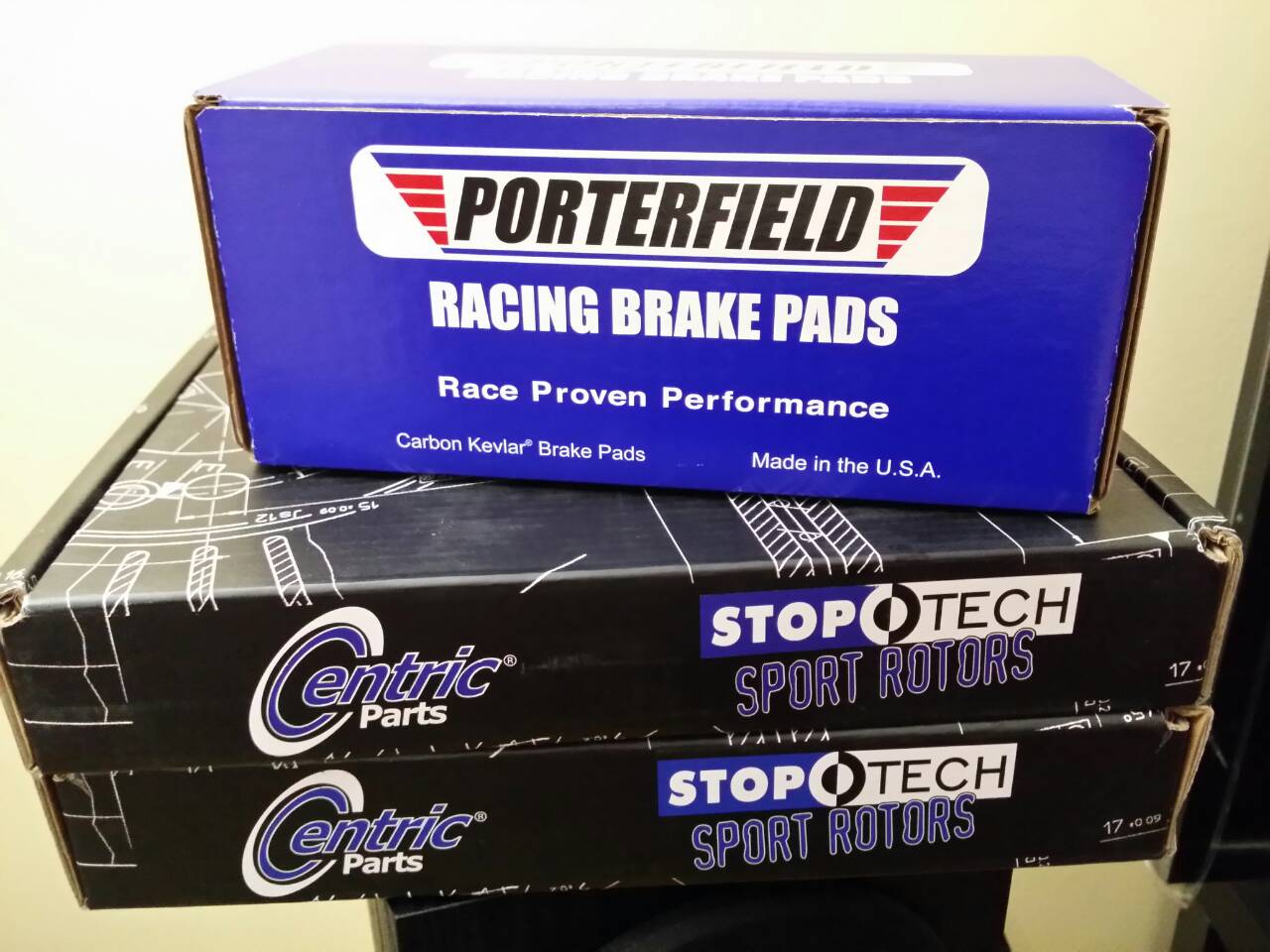

I went with porterfields!
I'll probably install them this week, and I'll give another update with how I like them.

Thank for the reminder!
It's been a few months and about 2000 miles since I've installed the pads and rotors. When I took out the stock pads, it looked like I still had some more meat left for another year or two, and the rotors wore very evenly. I think I'm either a very light braker, or this car doesn't seem to wear out brakes very fast.
I did a break-in procedure consisting of ten 35 MPH to 5 MPH hard slow downs, this was my first time having to break-in brakes and it was quite scary. I started getting fade fast and smelled a ton of smoke coming from the brakes. When I got out of the car, I saw smoke coming from the front brakes! I read that this was normal and expected during break-in. I left to get some dinner and to let the brakes cool down, then finally bringing it out to do a series of ten 60 MPH to 5 MPH braking. Afterwards, I inspected the rotors and found that the color had changed from the original metallic color to a slightly blue-ish color. No issues so far!
The next day, now knowing they're probably broken in now, I went around town to run some errands. The very first thing I noticed was how much more initial bite I got. Coming from the stock pads, this was a HUGE different in the amount of effort I have to put into the brake pedal. Also to note, I did NOT change the brake fluid as it still seemed very clear.
They make ZERO noise and I don't seem to notice ANY brake dust on my front wheels. I've been lazy about washing my car, (as well as being conscious about the California drought), so I typically wash my car every month or so these days. I have not notice any significant dust build up at all. This is definitely a plus for me. Compared to my mother's Volvo V70 wagon, which turns the wheels BLACK 3 days after washing them, these pads are amazing for very low dust.
I haven't had the chance to take the car out for HPDE, I've just started school and work every other day. But, I really like how I don't have to put much effort into the brake pedal to get the car to stop now. There have been a few instances where I've had to stomp really hard on the brakes and I think the ABS seems to come on a little sooner than what I was use to before. Overall, I think these are some fantastic street pads, I can't wait to push them on the track some day.
Thanks for the suggestion guys!
