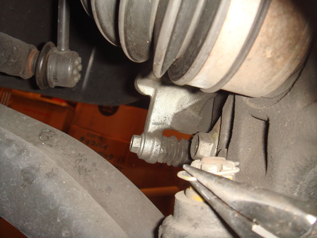

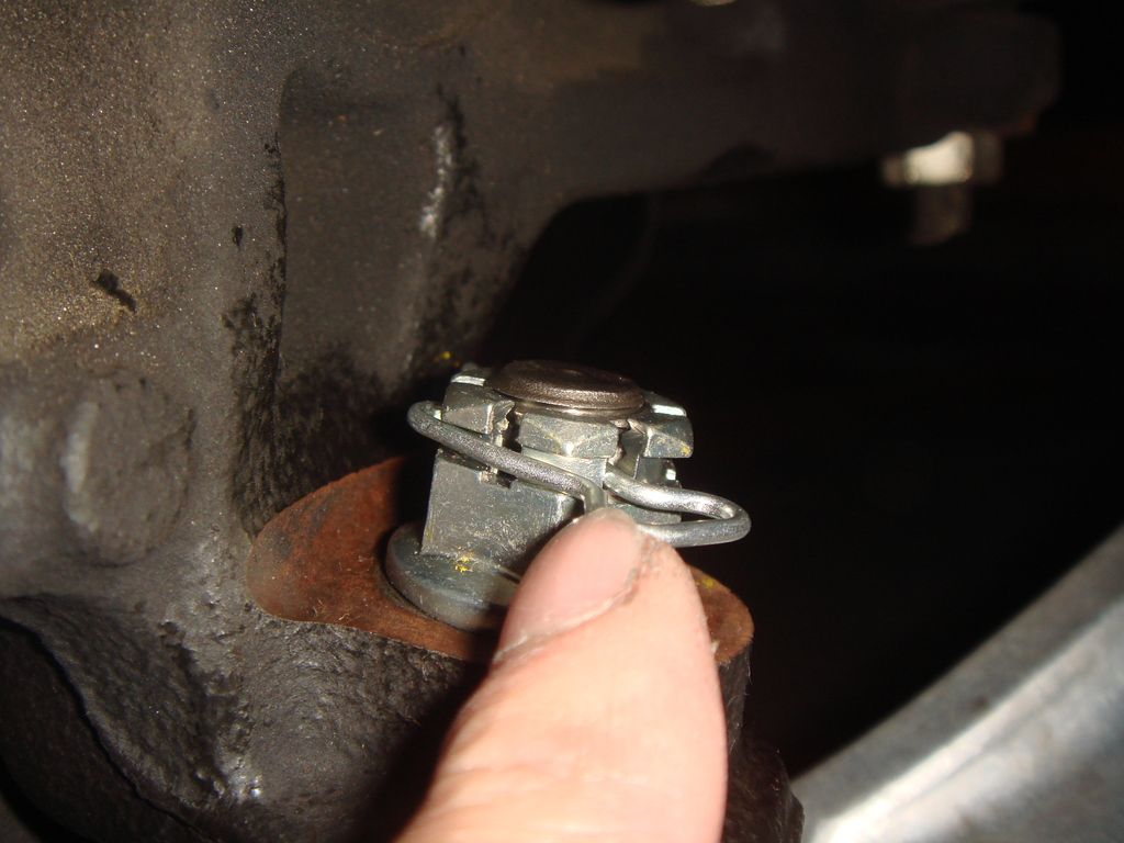

Take out The Safety Pin from the Castle Nut
that lock the Lower Control Arm to the Knuckle:
Remove the Castle Nut, I had to use a special Crowfoot Wrench
because a Socket Tool would not fit there:

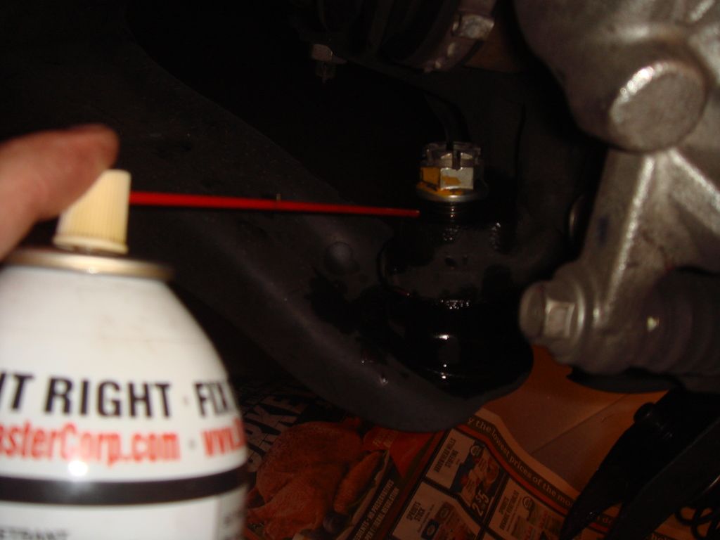

Spray with some PB Blaster to Joint to help loosen it up,
then use the Honda Special Tool to remove Ball Joint:

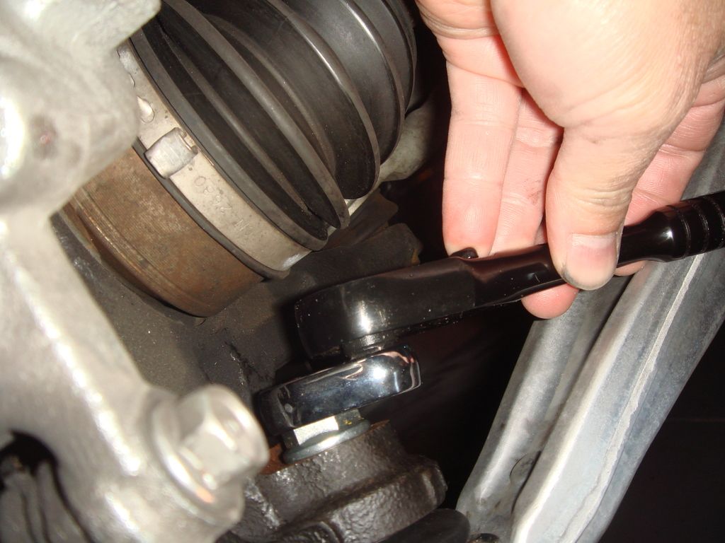

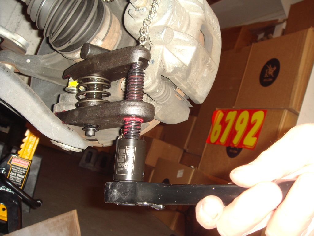

Actually it work again,
so Spray with PB Blaster:
then use the Honda Special Tool to remove Ball Joint,
warning when it finally loose, it will sound like an explosion !!!

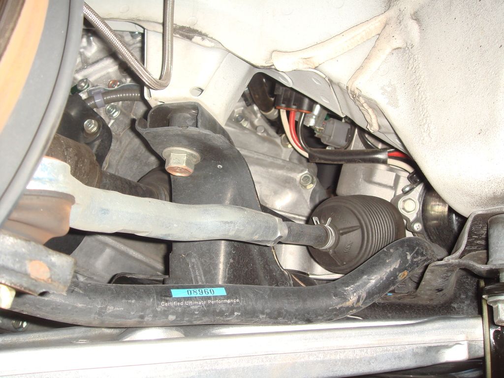

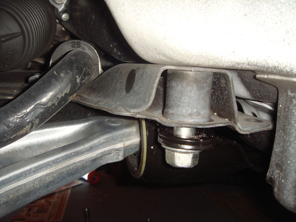

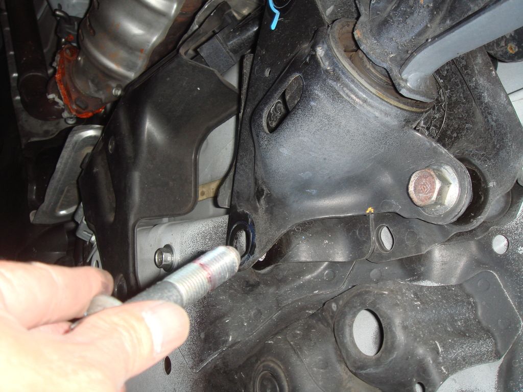

The 3 bolt that facing down:

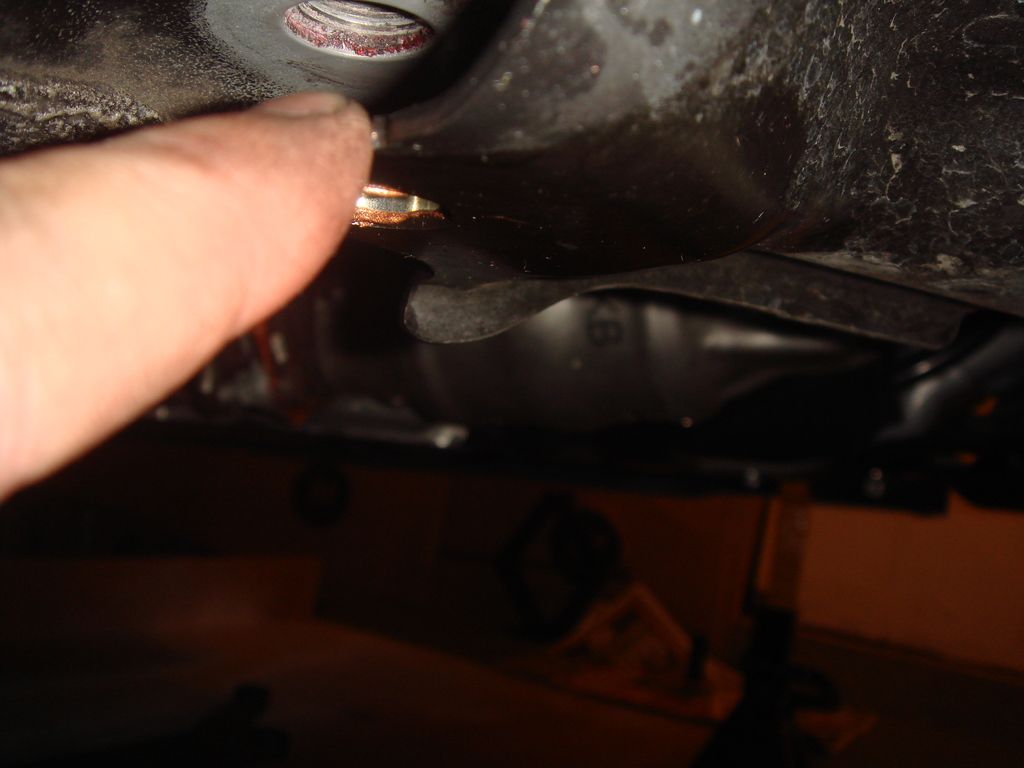

The 1 bolt that facing front, oh to access this bolt, you need to unclip several plastic clip
and pair of screw per side to release the plastic splash guard inside the wheel well:

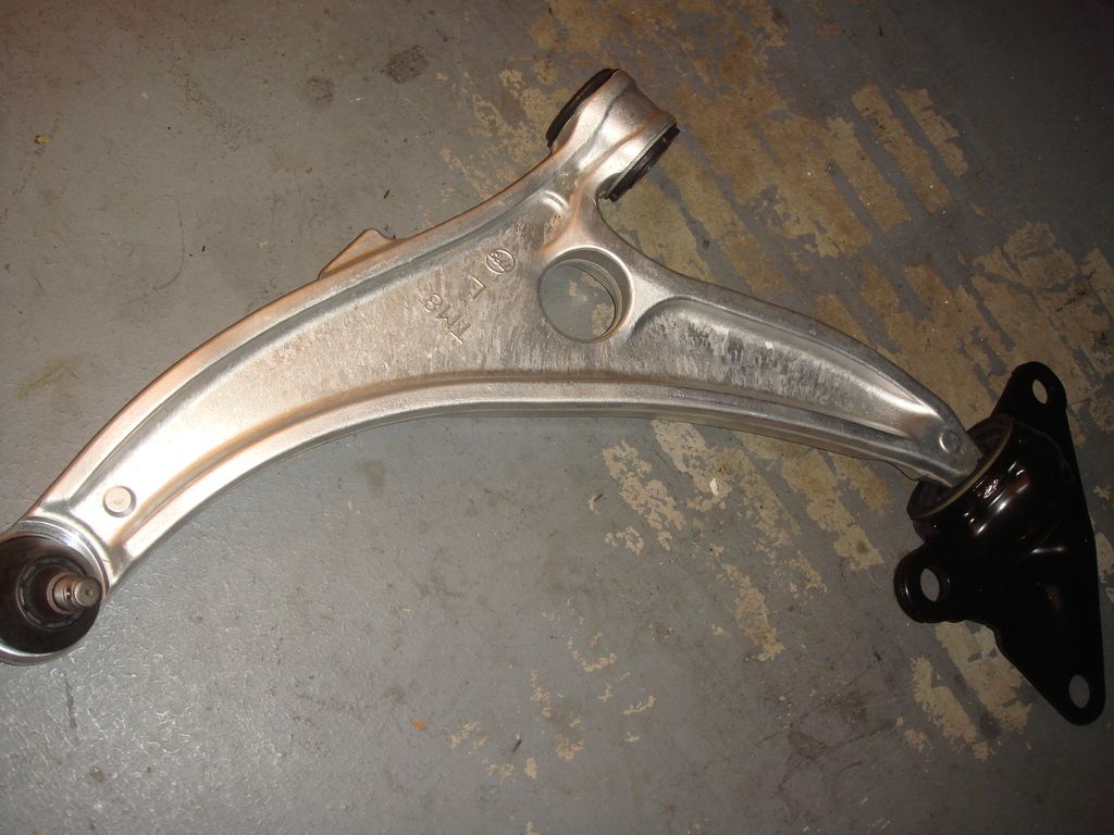

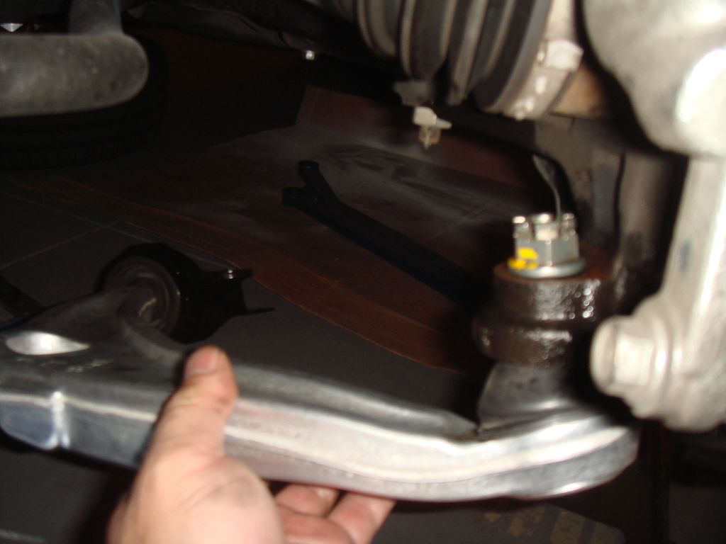

Now Take out the Honda Fit LCA and install the Honda Insight Aluminum LCA in reverse order,
but since we are going to install the Spoon Rigid Collar,
this mean when you install the LCA, do NOT tighten the 3 bolt that face the bottom all the way in,
but leave some space so the subframe can be lowered...
the first step to install the Honda Insight is to screw the Castle Nut:
Then the Front Facing Nut (notice the hydraulic jack on the back ground holding
the subframe and the front jack point):

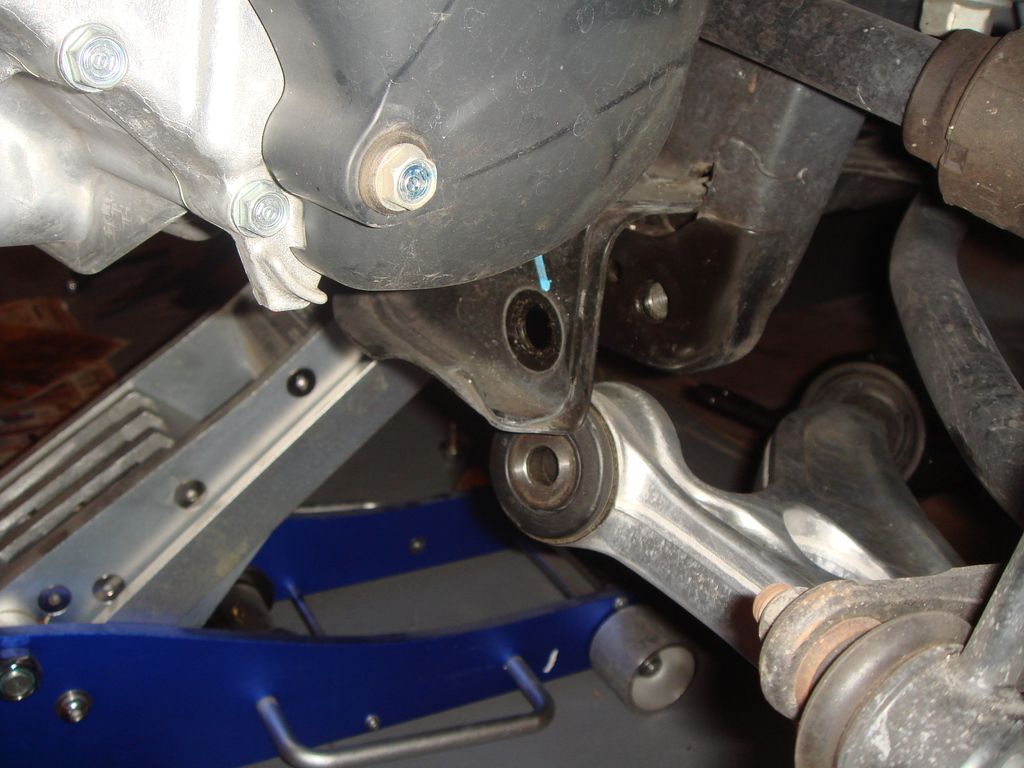

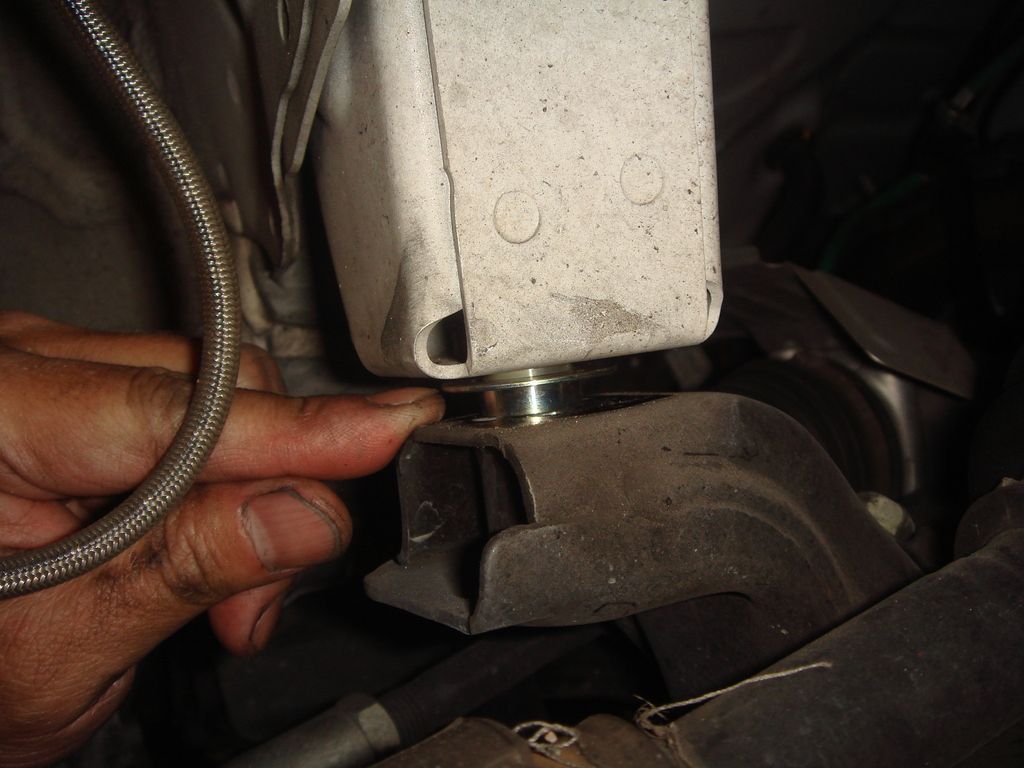

Now loosen the last subframe bolt that had nothing to do with the LCA,
loosen mean not take it out completely but just so there is gap between the subframe
and the chassis so we can insert the Spoon Rigid Collar like this:
After that you let the hydraulic jack lowered just a few mili meters...

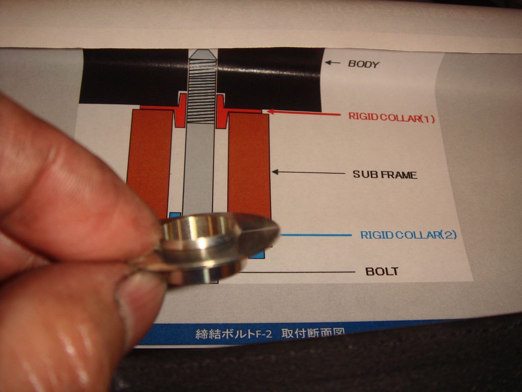

Spoon provide with 2 pages of instruction complete with clear pictures,
so you will now which collar shape goes where...
Like this one for example,
this will go to between subframe and chassis at the mounting point that had nothing
to do with the LCA (behind it you can see the illustration provided by Spoon):

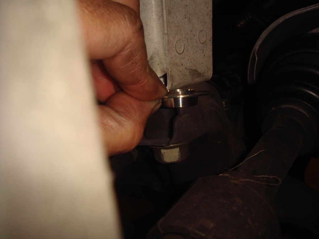

I am inserting the rigid collar to the first mounting point between subframe and chassis at the point where it had nothing to do with the LCA,

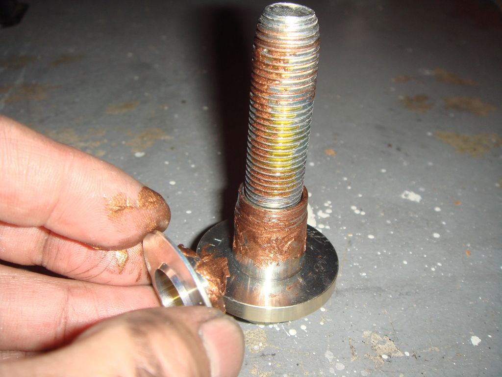

Ups, I forget to that we need to coat the spoon rigid collar and all the bolt
with grease that is provided by Spoon so I have to take it out again
and coat it with grease, notice on the bolt, I already put the other rigid collar
that suppose to go between the bolt and the the subframe:
Now insert it back:
and screw in the bolt:
Now insert it back:

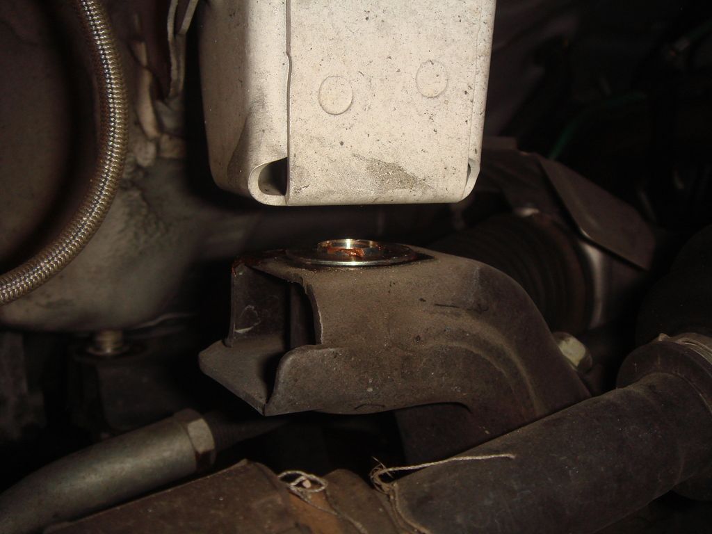

Repeat all the step above for the second mounting point,
this time it is also one of the mounting point of the LCA:
after that, another pair of rigid collar goes between the subframe and the chassis,
but on this last mounting point, it do not have any collar between the bolt and the LCA.

Hmm perhaps the Lighter Aluminum Lower Control Arm (LCA) from Honda Insight
also play important role here...
it is 3 pounds lighter per side (6 pounds total)
The stock Honda Fit steel one weight 11lbs and the Insight Aluminum one weight 8lbs per side.
I also think the design of the Insight LCA allow it to be more rigid
making the suspension geometry flex less and track true.
whatever it is, I am satisfied with the result.

When car is assembled in production line,
Honda (or any car manufacturer) would make the holes on some parts slightly bigger then they are suppose to just so worker can insert the
bolt faster, I am talking about 1mm or 2mm larger here,
this rigid collar will center those holes and also create a better matting area
between 2 surfaces since those 2 surfaces might not perfectly flat,
and this rigid collar make of softer material will fill those gaps.
this create better contact area and centered position on the two mating surfaces.
I was skeptical too
but since it is not expensive and I had to unbolt most of the
subframe bolt to change the LCA, so I give it a try ...
and apparently it work...
perhaps because our Honda use thin and not stiff enough metal
so there is still flex and this rigid collar help reduce that flex.

this is the Parts number for the Honda Insight Aluminum Lower Control Arm:
51350-TM8-A01 (Right Side)
51360-TM8-A01 (Left Side)
Don't forget to buy the bolts too,
Honda Service manual say that if you took out those bolts that hold
the subframe/lower control arm,
you need to replace them with new bolts.
I guess because they had experience very high torque of 93nm...,
so they might be weaken after that and that is why those bolts
are one time use only...
Check Bernardi Honda Website and select your GK5 Fit to find the bolts needed,
and you will find the parts diagram there.
