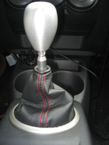

Heres mine...
Old 09-06-2008, 04:58 PM
Evotech8's Avatar
Join Date: Jun 2007
Location: NorCal
Posts: 197
^ Is there a reason the boot is sagging below the knob??
