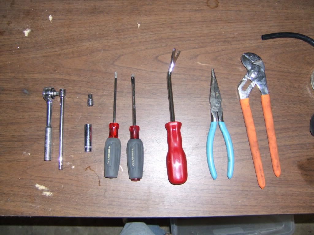

These are the tools I used to complete the install

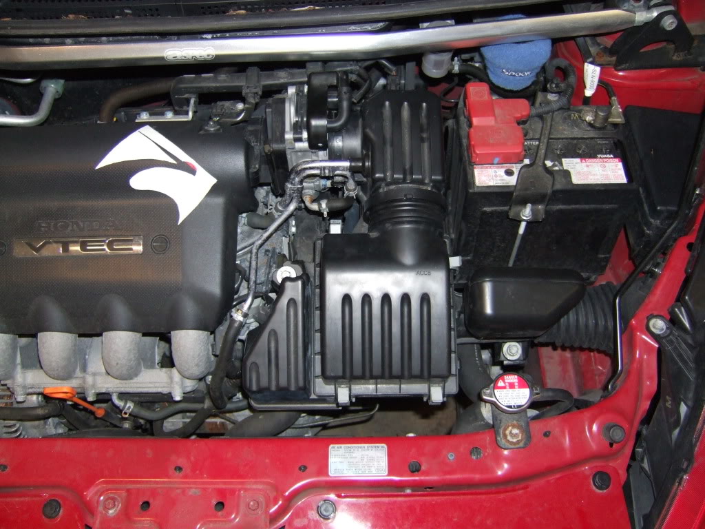

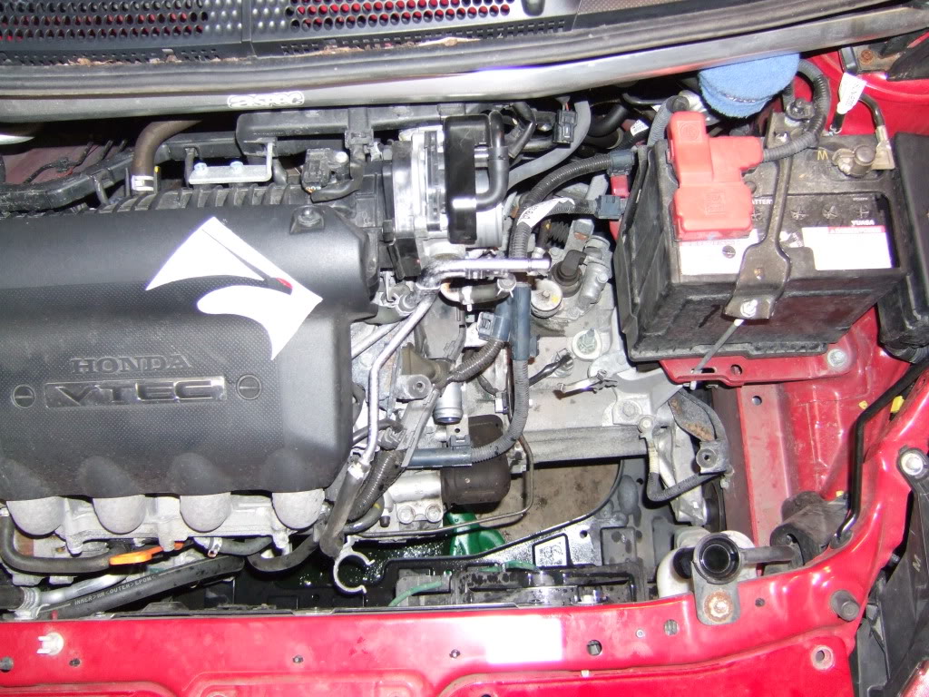

First I started by removing the air box

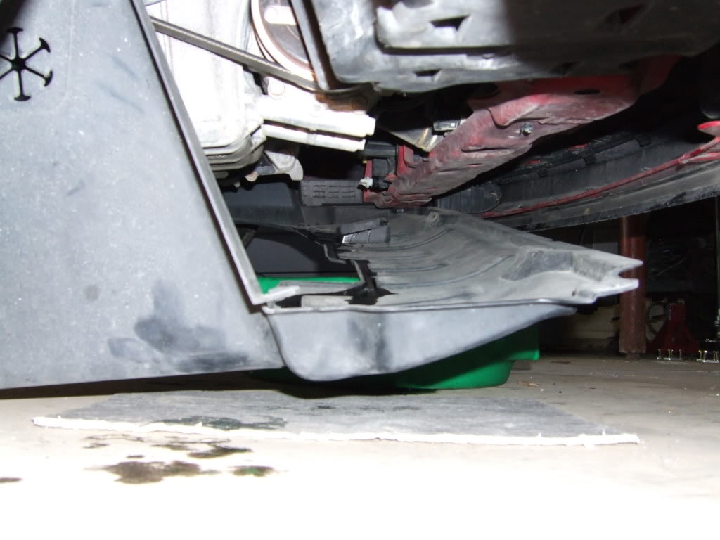

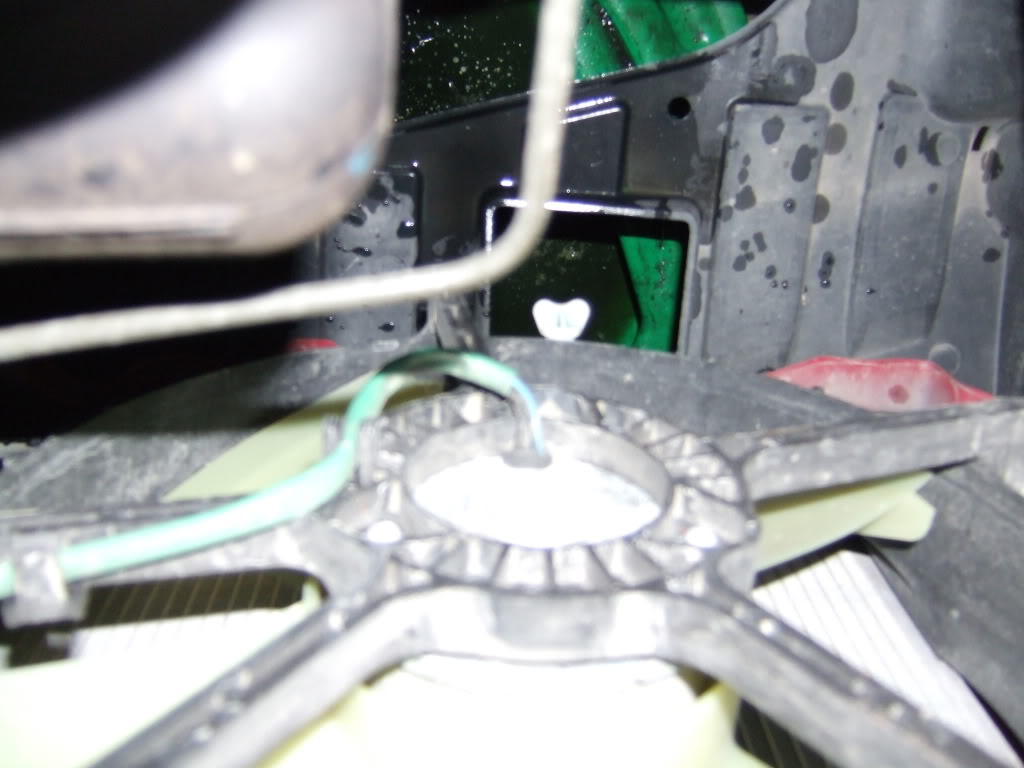

Second I put the front driverside up on a jackstand, and opened the drain plug on the radiator. While that was draining I removed the plastic undertray to access the lower hose clamp.

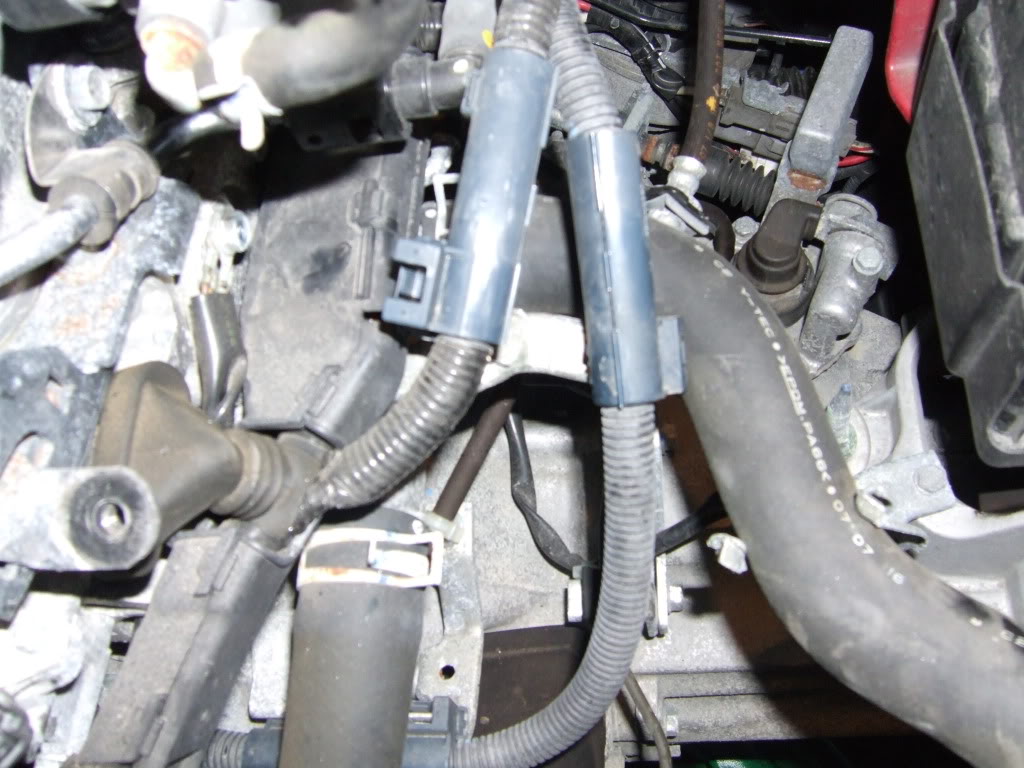

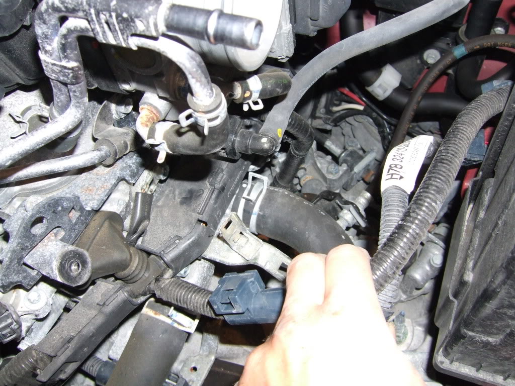

I found it easier to un-clip the wire harness that ran just above the upper hose rather than work around it. The clips are super easy just be gentle and they'll slide right off giving you about 2"-3" of slack.

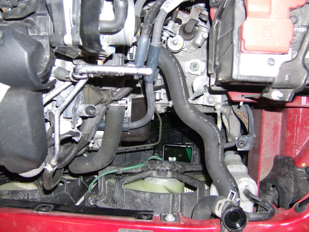

Remove the hose clamps and then remove the hoses, it may take some elbow greece and persuation.

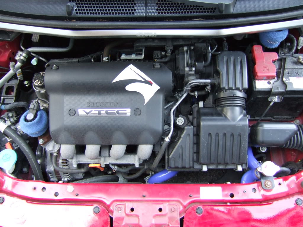

Instal new hoses with original hose clamps, I'm sure you could use something newer I didn't have any

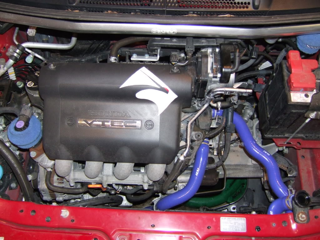

Install air box, fill with coolant. I ran the car for two cycles: fans on then off. I also threw a check engine light so I had to disconect the battery for about 20 minutes, reconnected the battery everything was fine.
