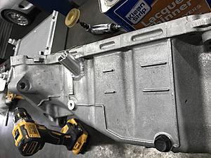

Probably going to change some things up like the oil drain setup. Hks has it going to the oil drain bolt below the oil level. Ill look into installing a fitting above the oil level.

Nice job on the oil return. Wish I had a TIG setup.

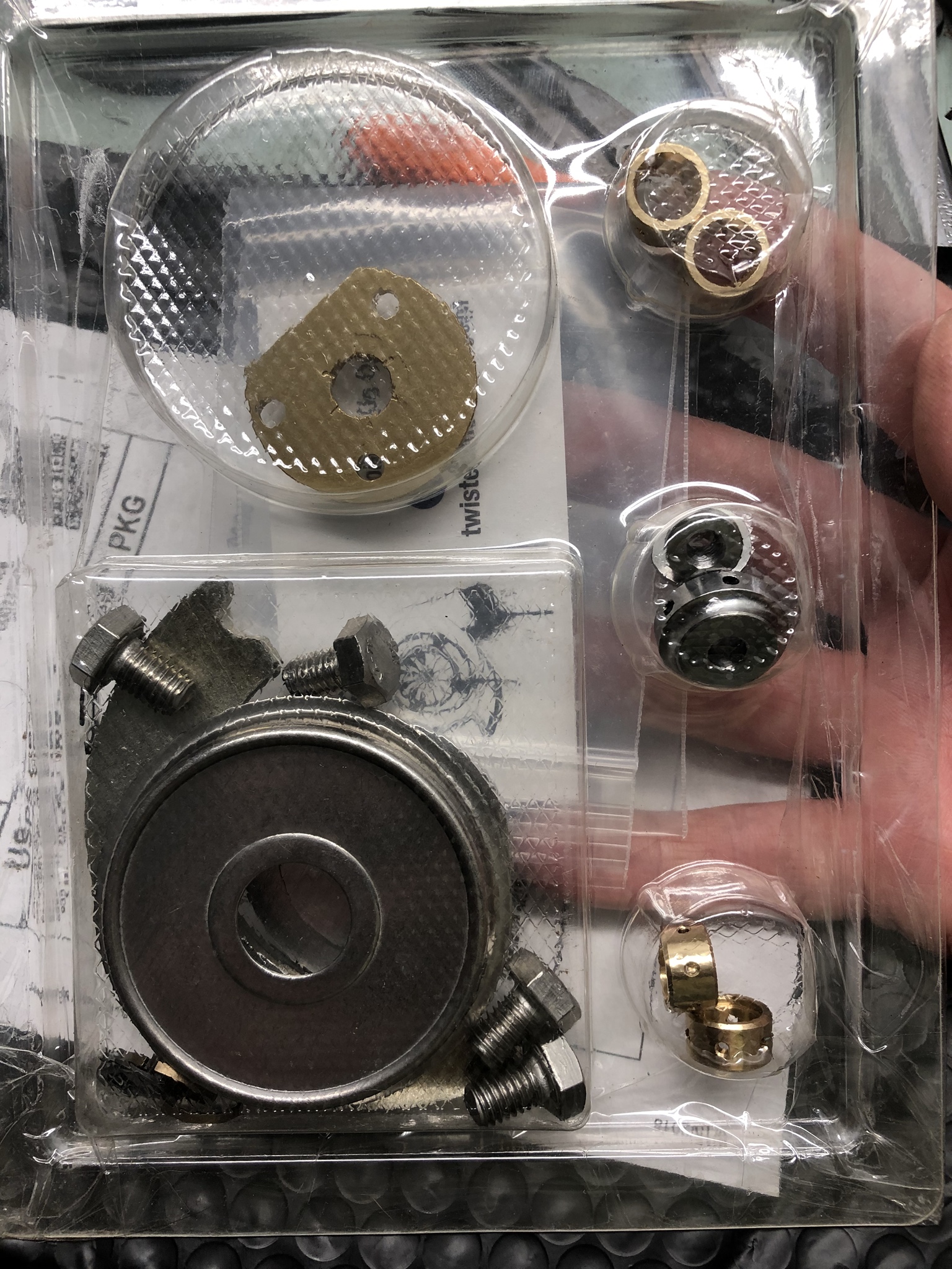

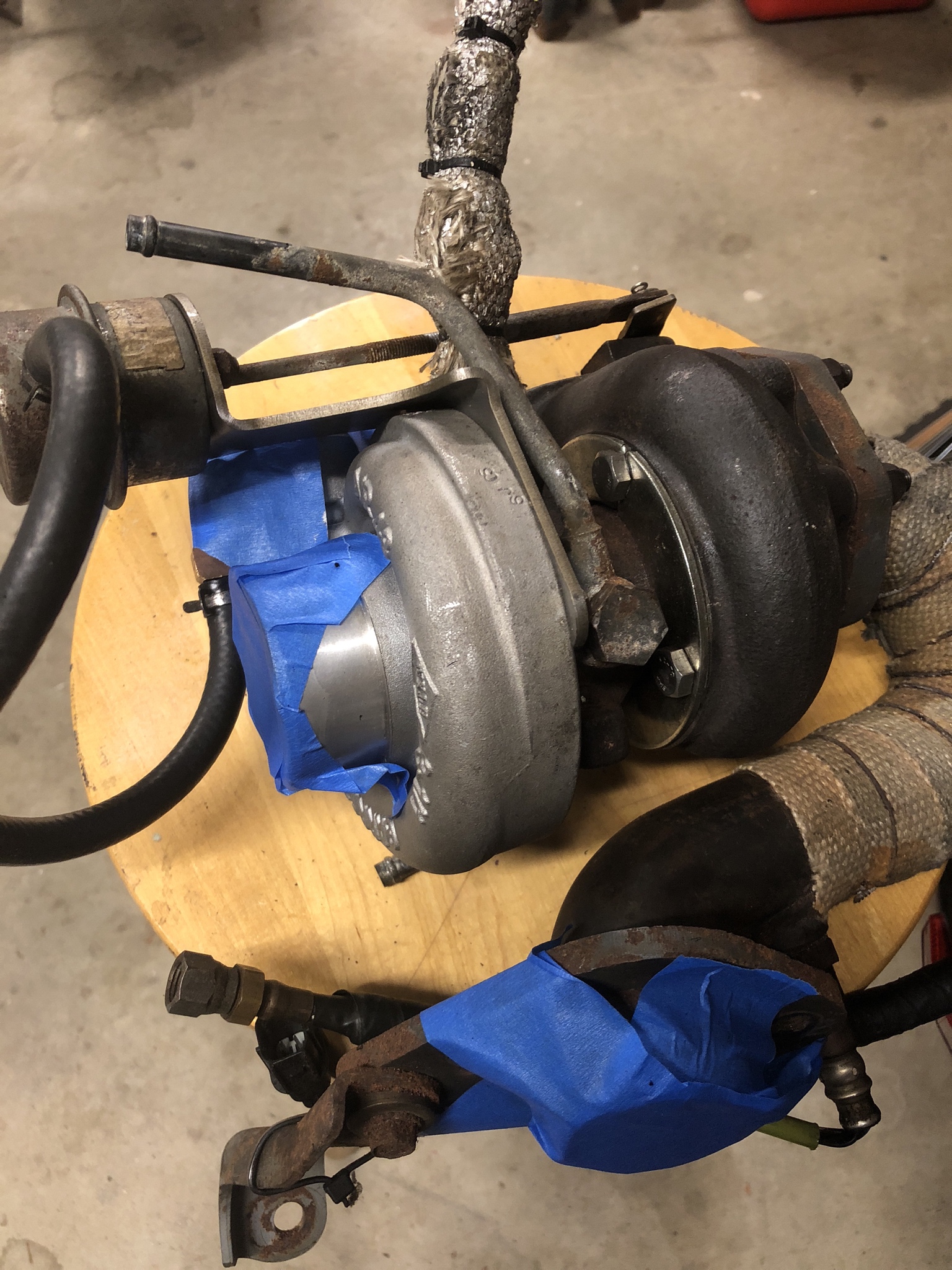

Car is on the road but still just NA. Turbo has a little more shaft play than I like but I might just throw it on anyway.

The added convenience of having the motor out of the car while I install the turbo and modify the oil pan with a proper return further reinforces this thought process to me. I'll take the time to replace anything leaking on the newer motor and give it a once over while I'm at it.
