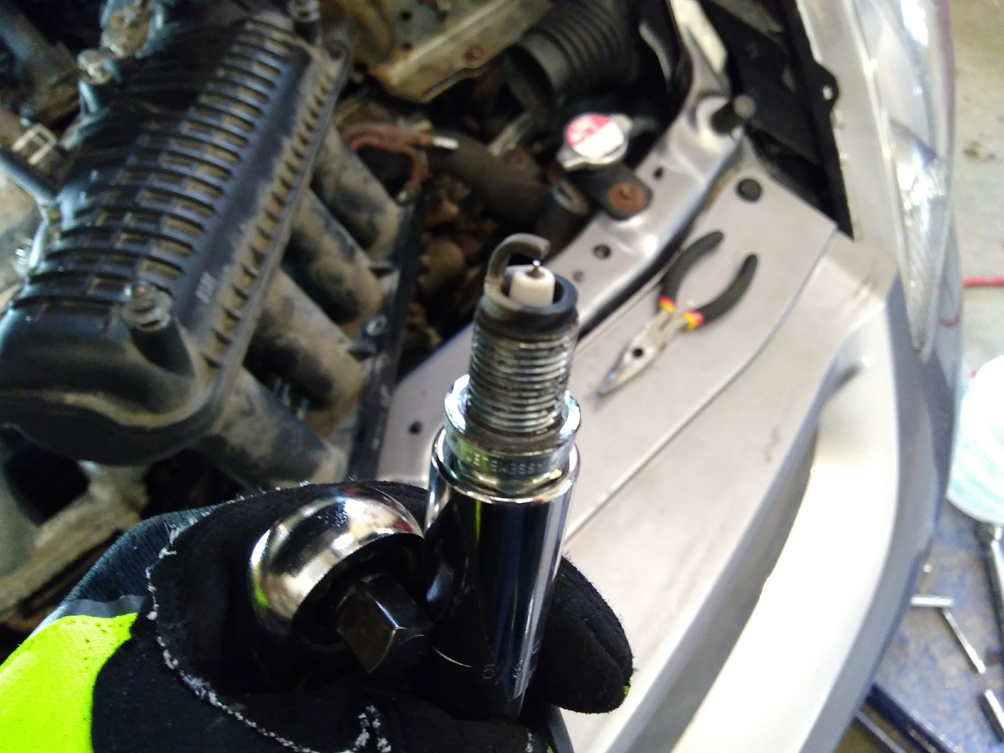

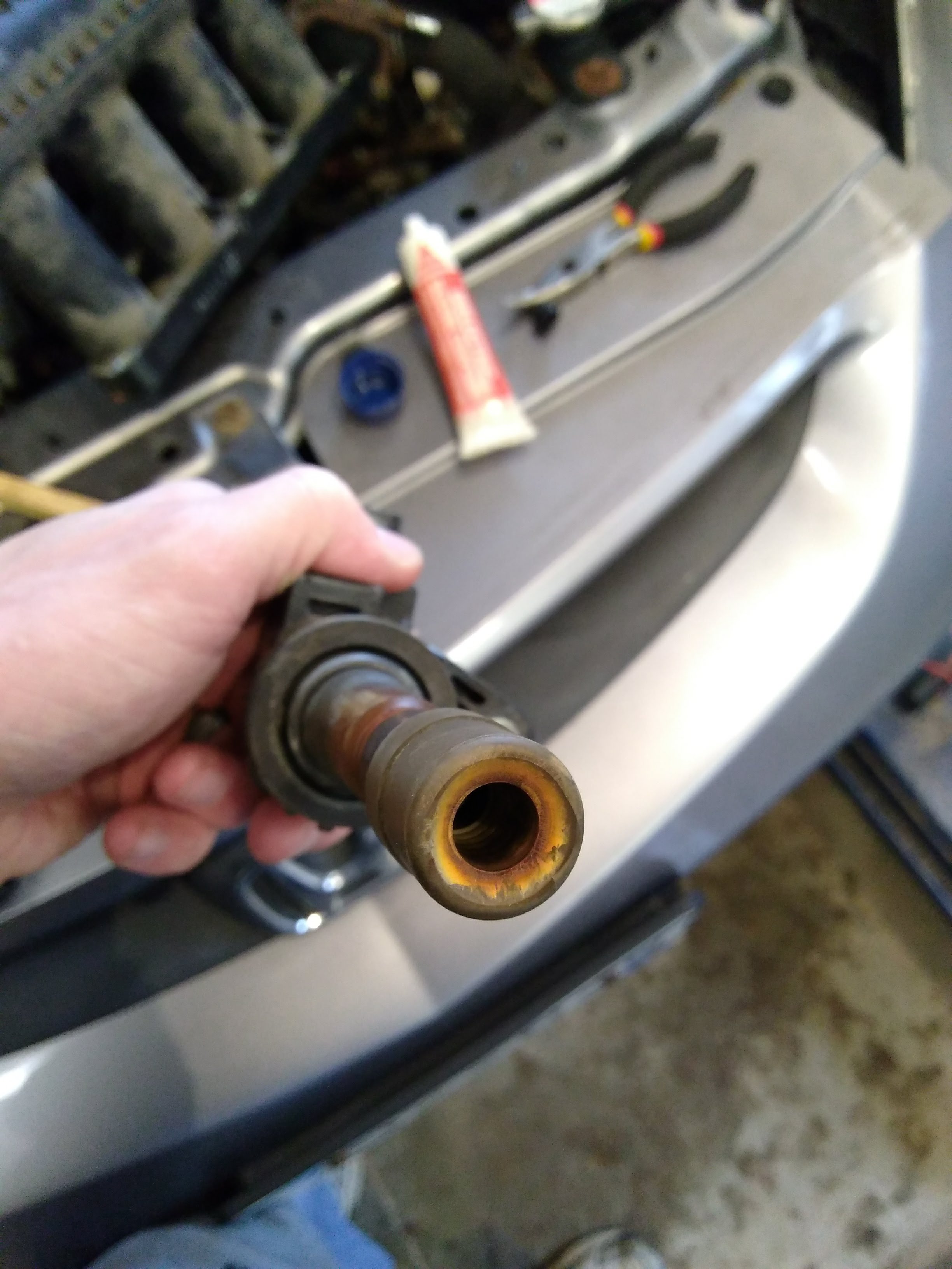

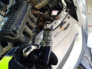

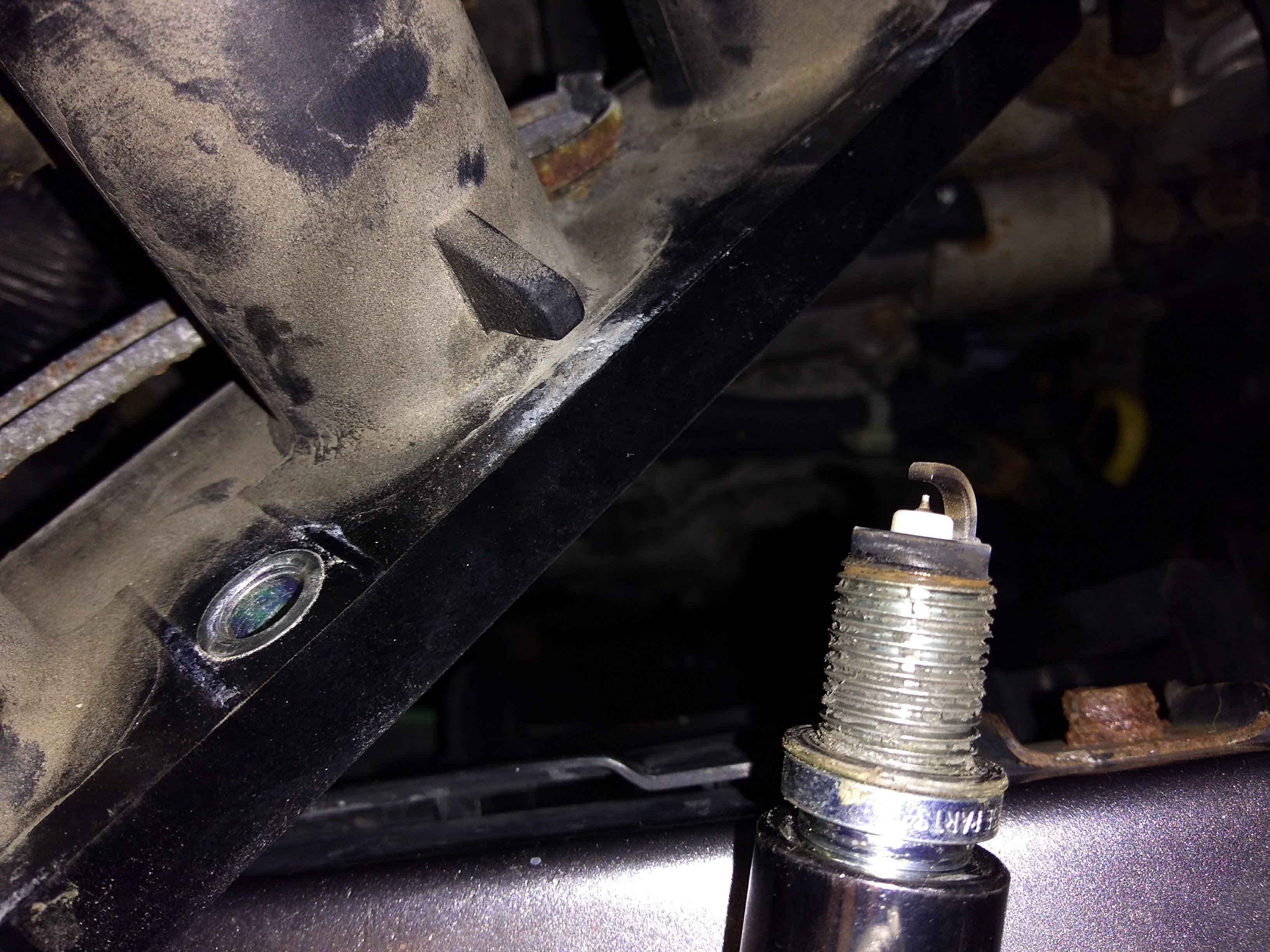

I also checked the plugs and coil packs. I attached pictures of what one coil pack looked like (the rest were clean) All of the plugs looked similar. Do you think the plugs and coils are fine? The orange/brown residue on the coil concerns me.

First, congrats on doing your own work. You should be very proud of that.
Next, my opinion means nuts. Its facts that rule the day. Plugs, ignition coils and valve adjustments are simply routine maintenance that Fit owners have to perform. Carfax is as reliable as single ply toilet paper. The owner, if he/she is like 99% of humans, is horrible at lying, which is why you should always take full advantage of your smart decision to buy from a private seller and ask them all the tough questions to include if/when ignition coils were replaced, etc. By the way, the other 1% of humans which ARE excellent liars are dealership salesmen and politicians. Given that buying a first/second gen Fit has factually proven to be a no brainer, I think you've made a great decision.
Definitely check out that spare tire wheel well before you drive another mile. Check for water stains, make sure all the tire changing tools are present, and fill the tire to 60psi for piece of mind. And in my opinion, discoloration on the base and shaft of an ignition coil is often a sign that gases are getting past an improperly torqued (loosely tightened) spark plug.

On ours, I re-tighten the plug every 30k or so and been lucky. He didn't check his and it blew out of the head and took the threads with it.
Keep an eye on it. Oh...and welcome to FF! Hope you enjoy the new to you Fit. We love ours. Quirks and all.
