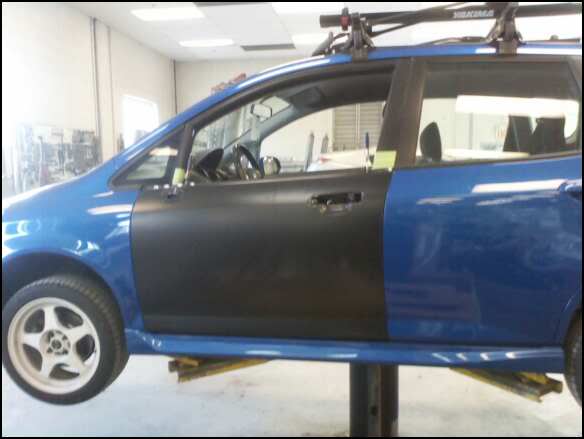

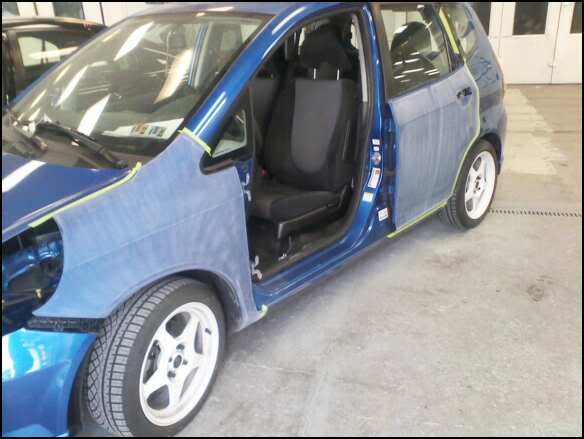

i wrote about it in the "wtf happened to apexanimals fit" thread...
it was broken into something fierce while being serviced at piazza honda in limerick, pa... still pretty pissed about it really... mainly because my wife and i are most likely stuck with the 500 deductible...
