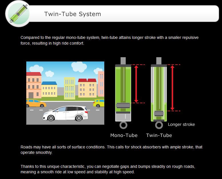

it sounds crazy, but, tein flex z or tein street basis z coilovers (TWIN TUBE) are indeed, more comfy than stock. ive tried koni orange paired with 3 sets of springs, and none of which compares (comfort wise) to my tein twin tube coilovers
https://www.tein.com/products/street...e_basis_z.html
this is not a blanket statement that says ALL coilovers are comfy ... fyi. we could easily point you towards coilovers that are even more harsh.... than your springs. I'll leave that up to you to research more into this

Ha, I had no idea. Being fairly reasonable too, and seeing that I could sell the h&r's... This is actually a good option for me.

A big part of your problem is that you put lowering springs on dampers that were potentially already blown and definitely on their way out.
I doubt cheap coilovers will be more comfortable. Just get OEM stuff and call it a day.
Coilovers don't have as long a service life as OEM stuff either.

I can offer personal experience on the TEIN Flex-Z and they are as comfy if not more then stock.I was running a finger gap and it felt stock.
Wife never complained so you know it was good lol
That being said if you are looking for hella flush fitment or slamming they are not stiff enough to prevent the tires from rubbing. I went low enough that I had to roll my front fenders to keep from scrapping on large bumps. If the springs were stiffer it probably wouldn't have rubbed but would have been a worse ride. They did improve handling as the center of gravity was lowered but not as much as a good set of "race" coilovers. .

u gotta try those tein's mike. you'd be amazed by how comfy they are.
its the total opposite of all things that make sense.... coilovers over oem for comfort .... I know.
