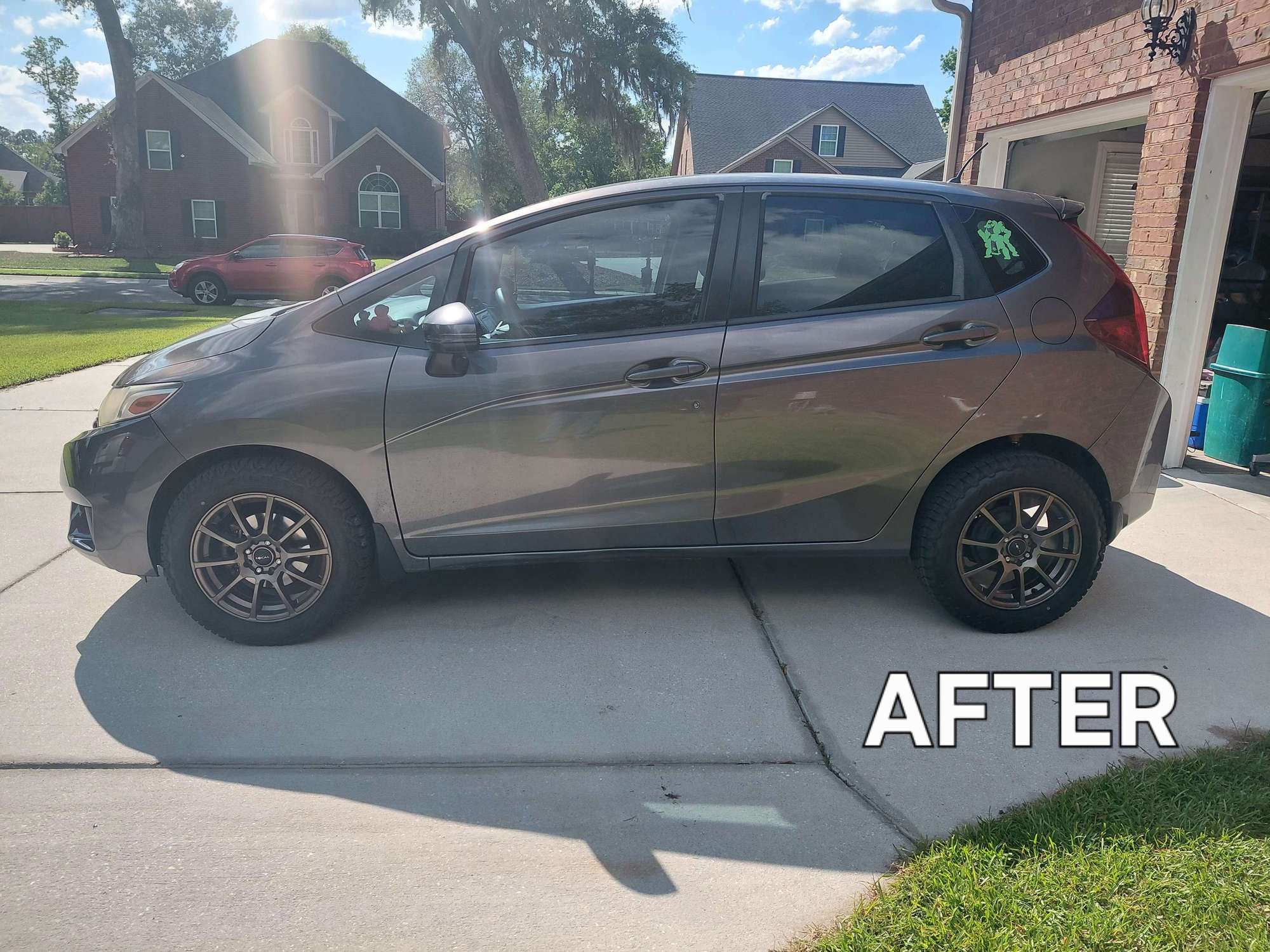

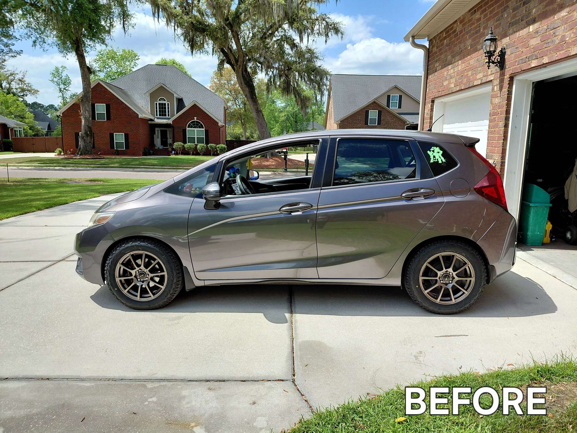

205/60R16 Wheels give about 1in lift alone but I was bottoming out in front.
With 205/60R16 wheels and YSR suspension
Also added 1in wheel spacer on the rear to make it more in line with the front. With the bigger size tires they poke out a little on each side of the car in the front, I liked the look and decided to do poke out the back as well. Might even go 1in spacers in the front and 1.5in spacers in the rear later.

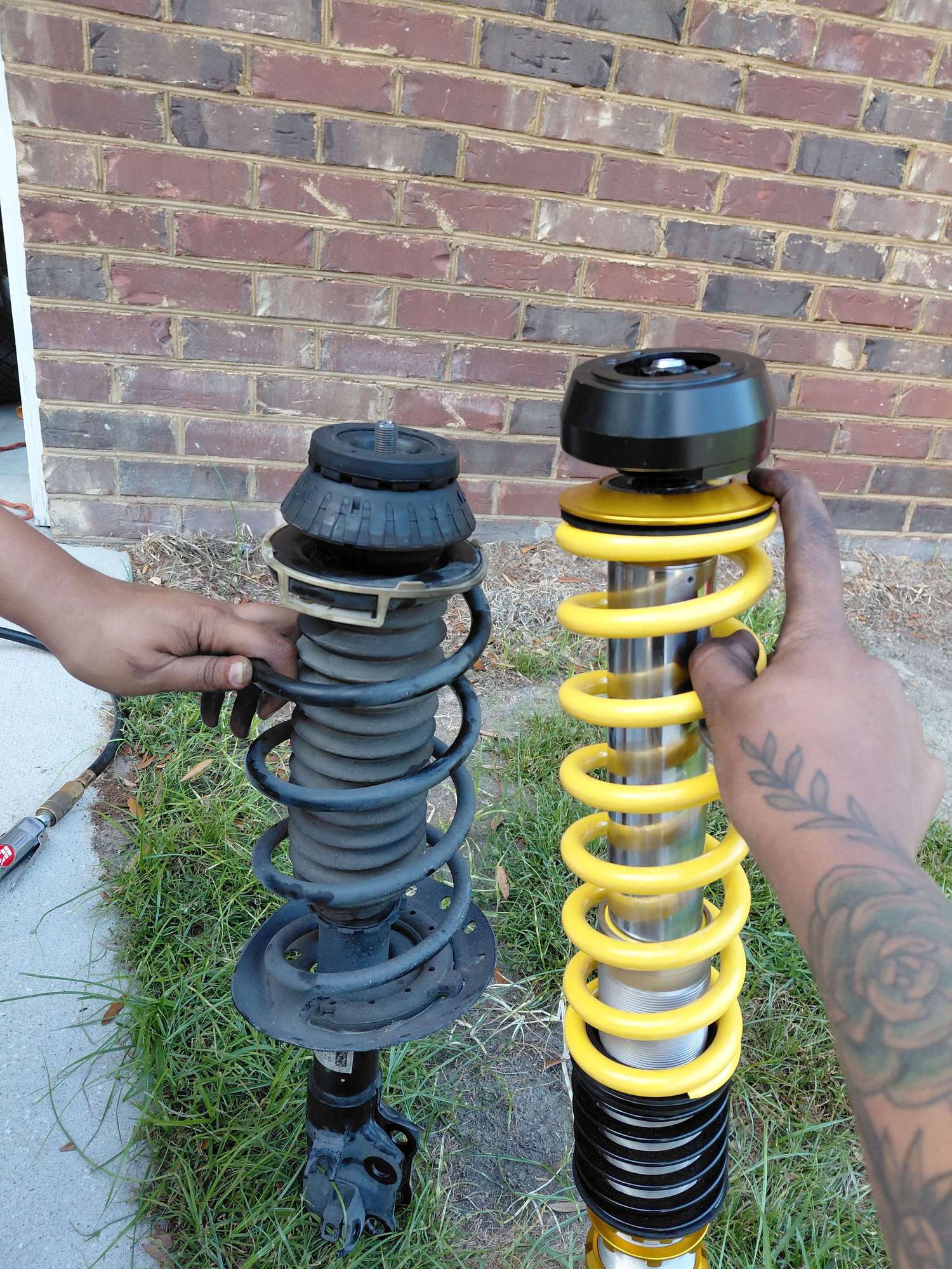

OEM spring compared to coil over included spring
