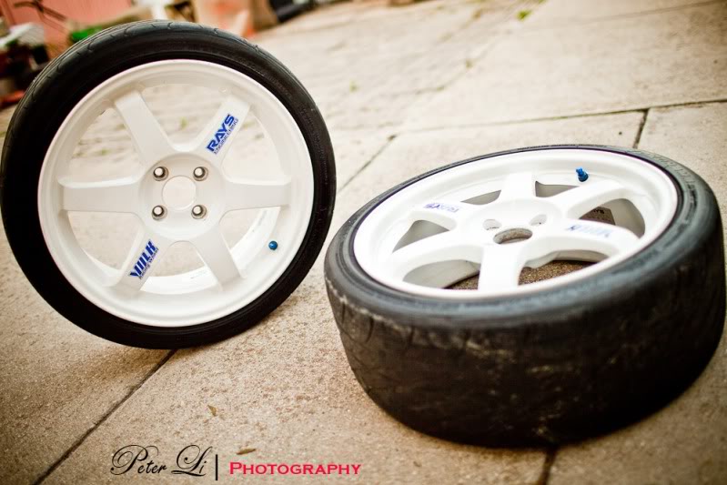

ill be getting my fit this coming week. i have these volks ready to go on. ill be ordering skunk2 pro-c coilovers and pretty much tuck tires.
will i have to mod my fenders in order to fit? or can i fit these without having to mod them?
i feel like they would fit the rears without mod? but fronts seem like it may need work. can someone confirm? thanks!

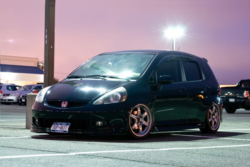

i did a quick photoshop drop tucked. looks so much sexier!
