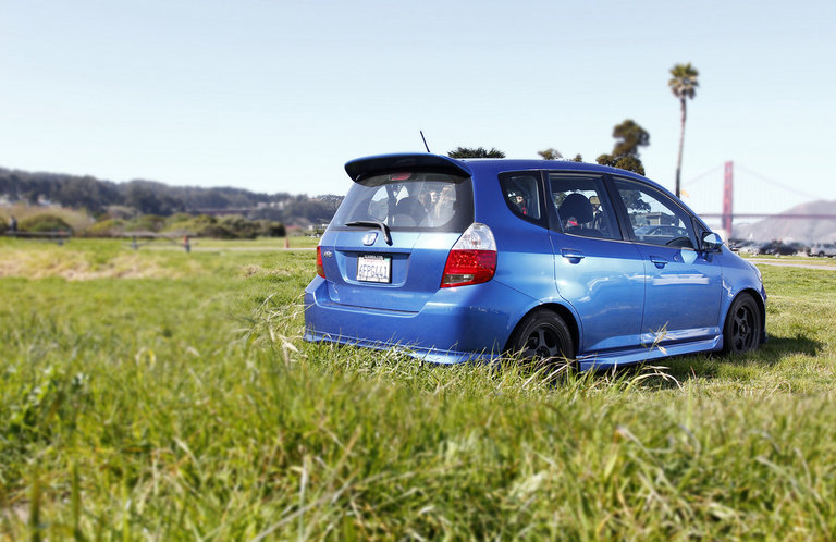

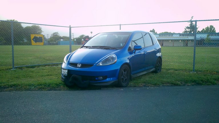

Any pics of that set-up? Any pics of the set-up I'm proposing? Just trying to get an idea of what the stance will look like too.

These would be examples of my 205 setup on the rotas on Swifts
