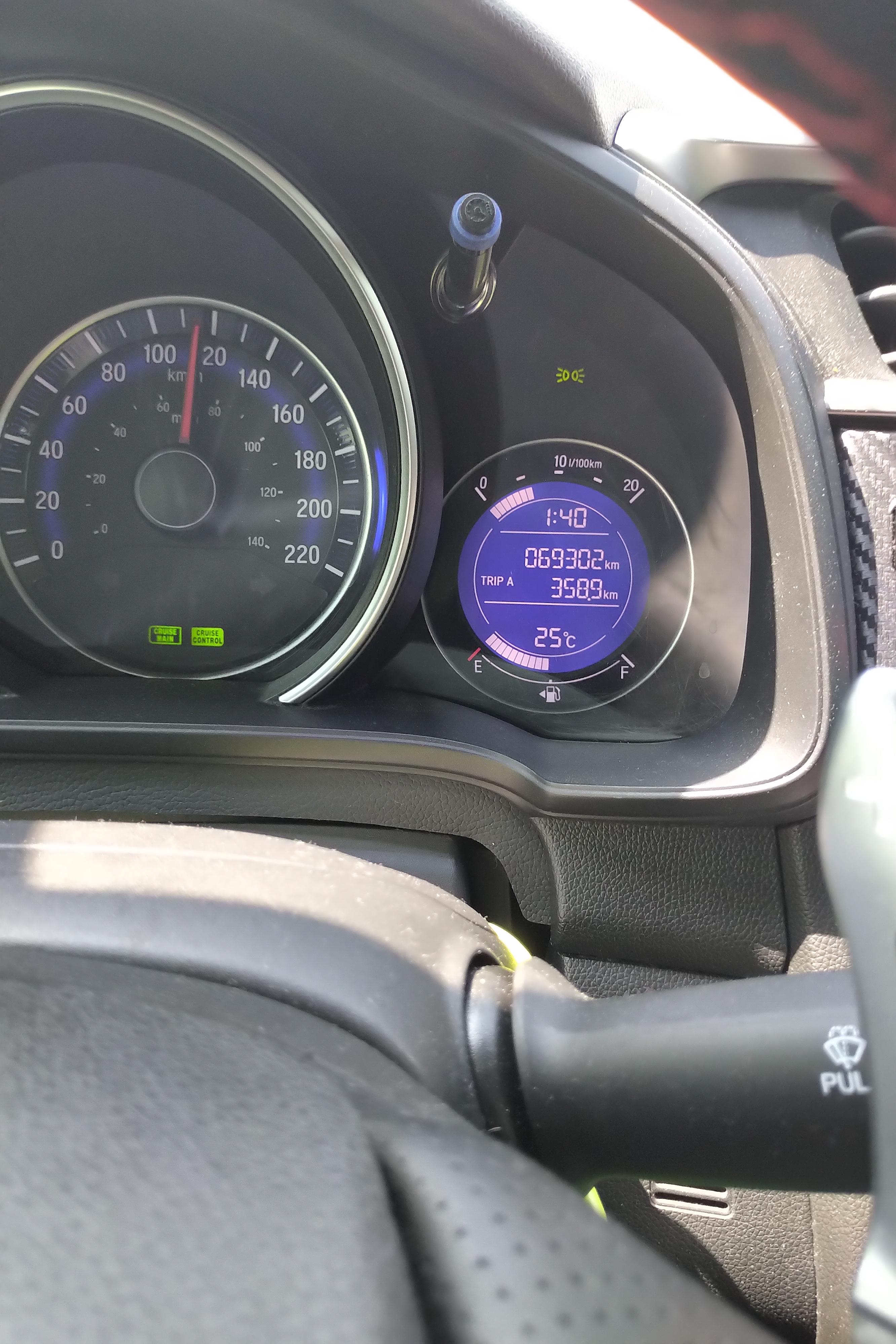

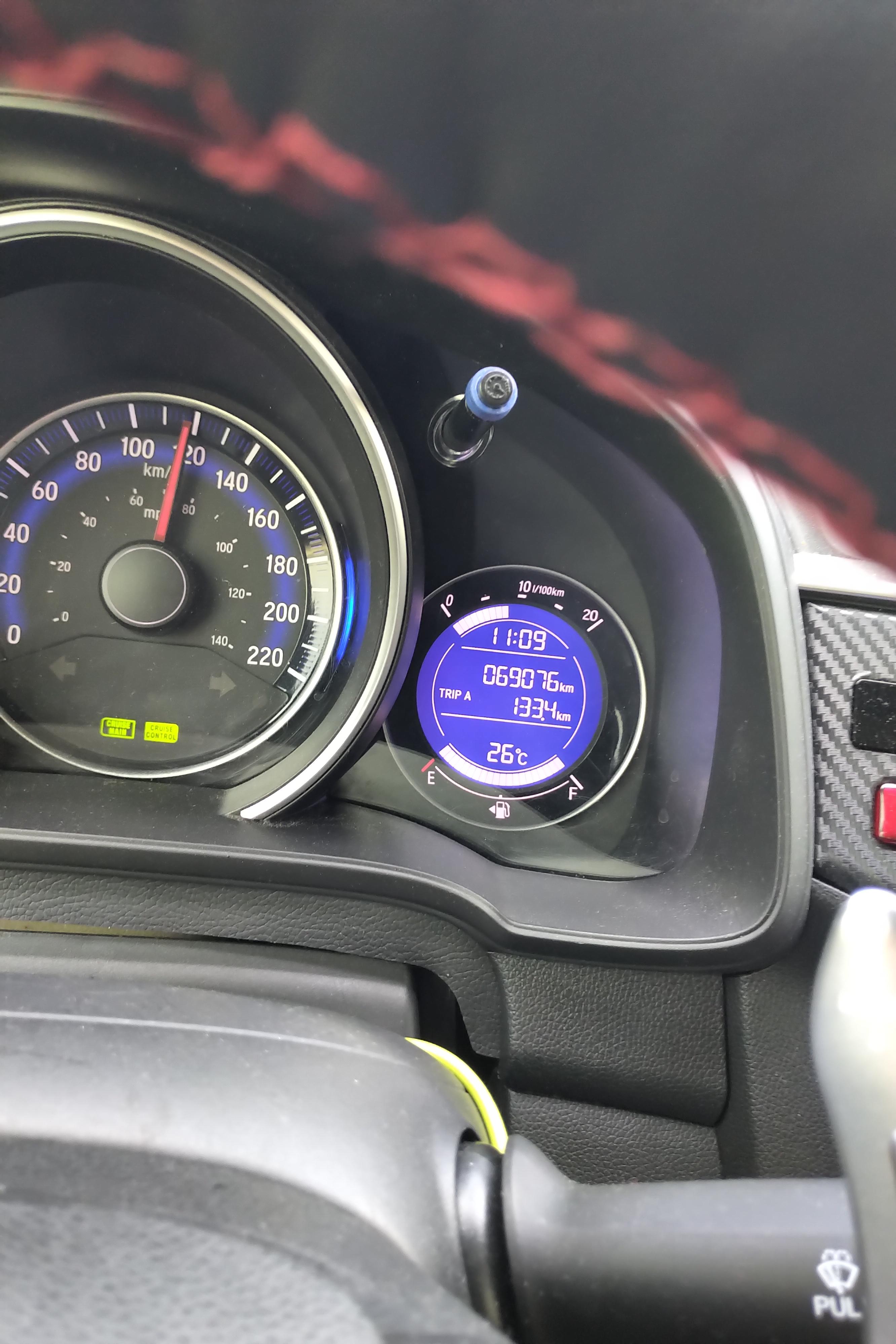

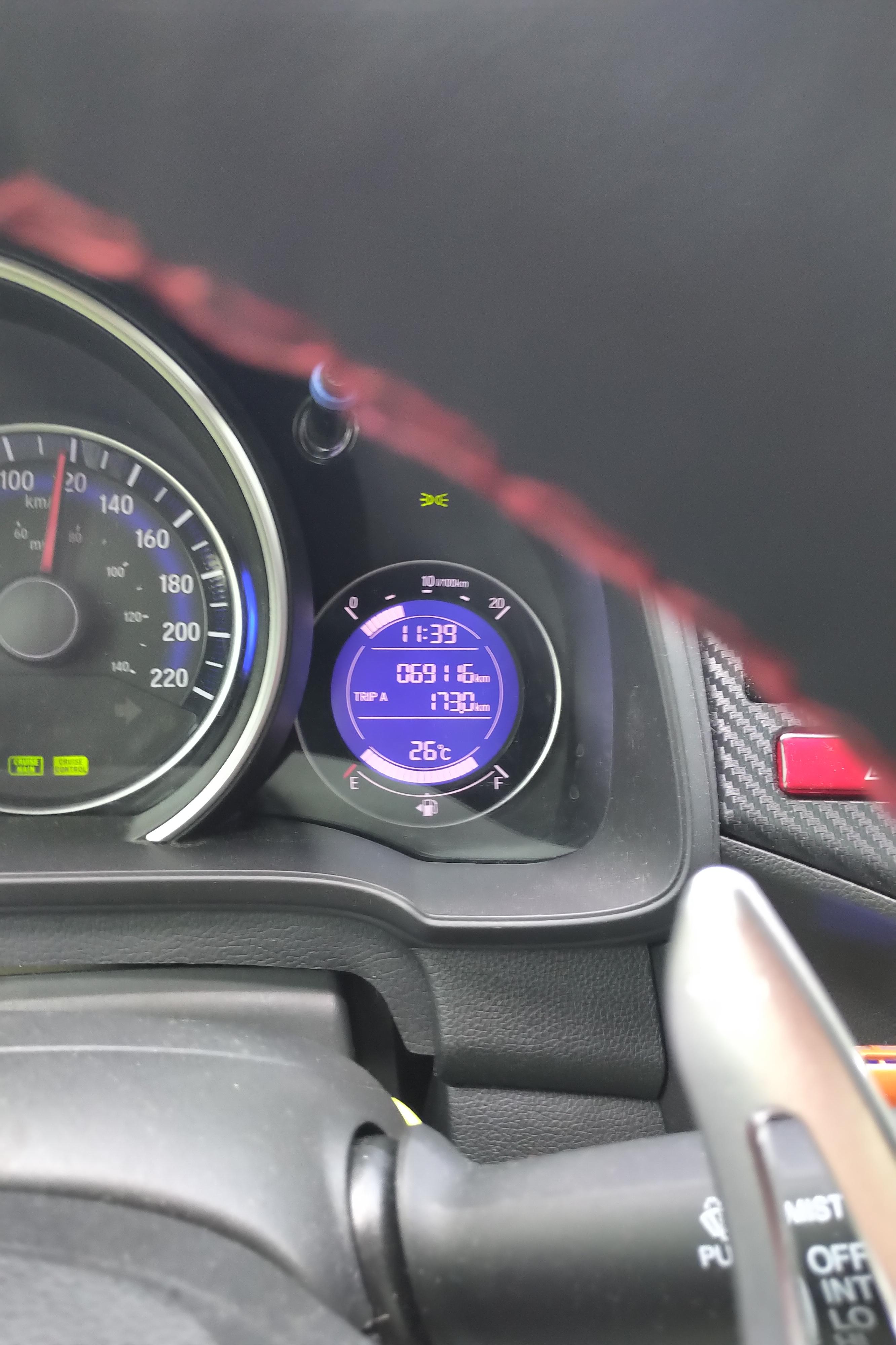

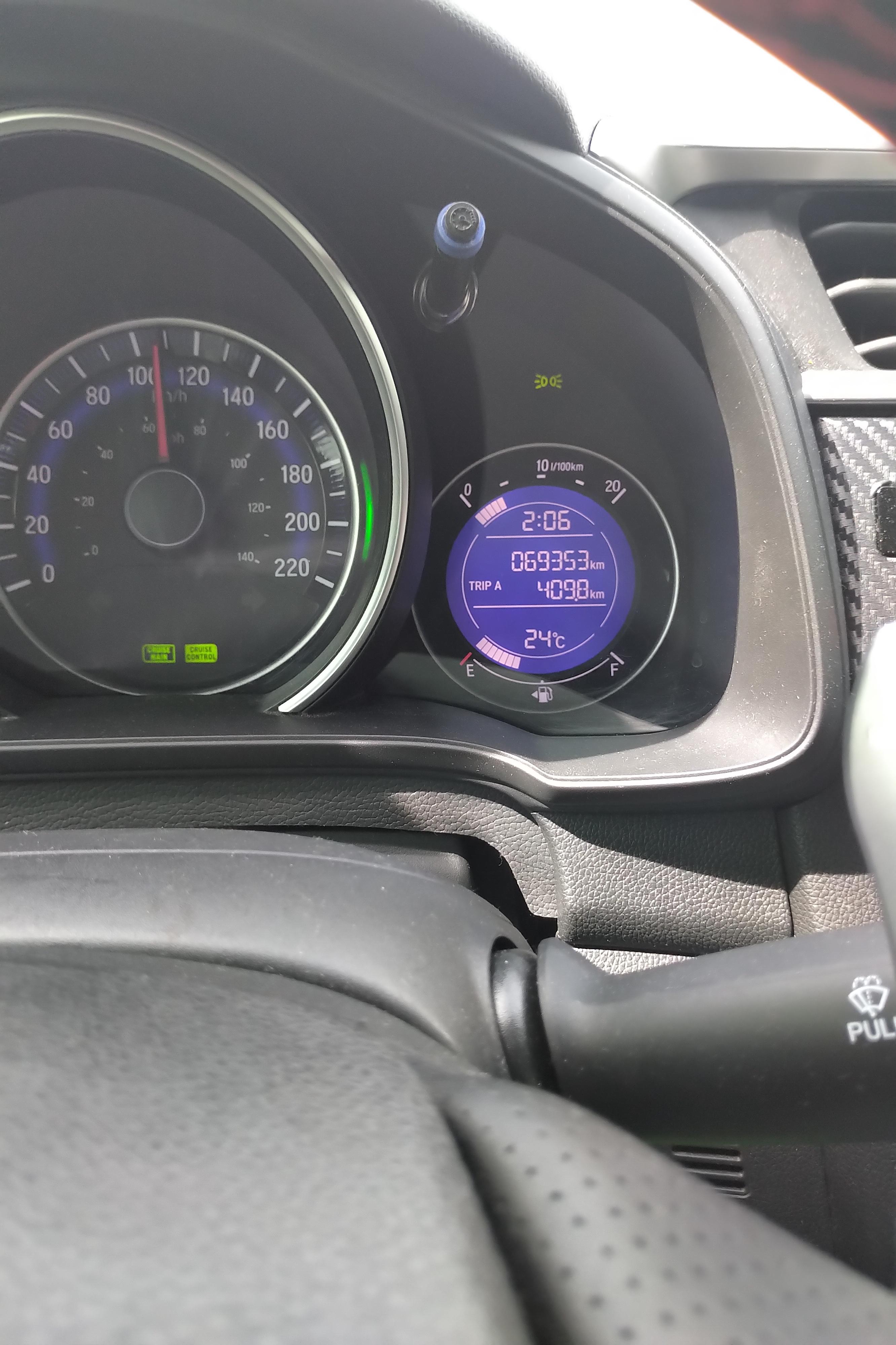

You can drive a very long distance before the fuel gauge will even move!
Some gas jockey decided to fill my car right way past the auto stop of the pump. I was driving on the highway and the gauge didn't budge for a long time and I knew what happened. I had to burn off the fuel as much as possible, so I took off ECO, put it in "S" and drove it at high revs.
I took photos. I managed to drive around 133km and it was still showing full. I drove almost 360km around half tank.
I was concerned that the overfill would damage the charcoal canister. I made a complaint to that gas station.
I believe the GK's charcoal canister is located in the engine bay and is designed to not be badly affected by overfilling, but I'm not 100% There was no smell of gas.
Lesson learned. Do not let anyone else fill your car.
