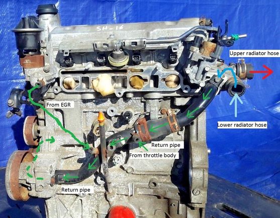

Side view shows circulation with engine hot. The coolant goes all way up from the radiator via lower hose, passes through main thermostat valve , and goes down via return pipe to the water pump.
