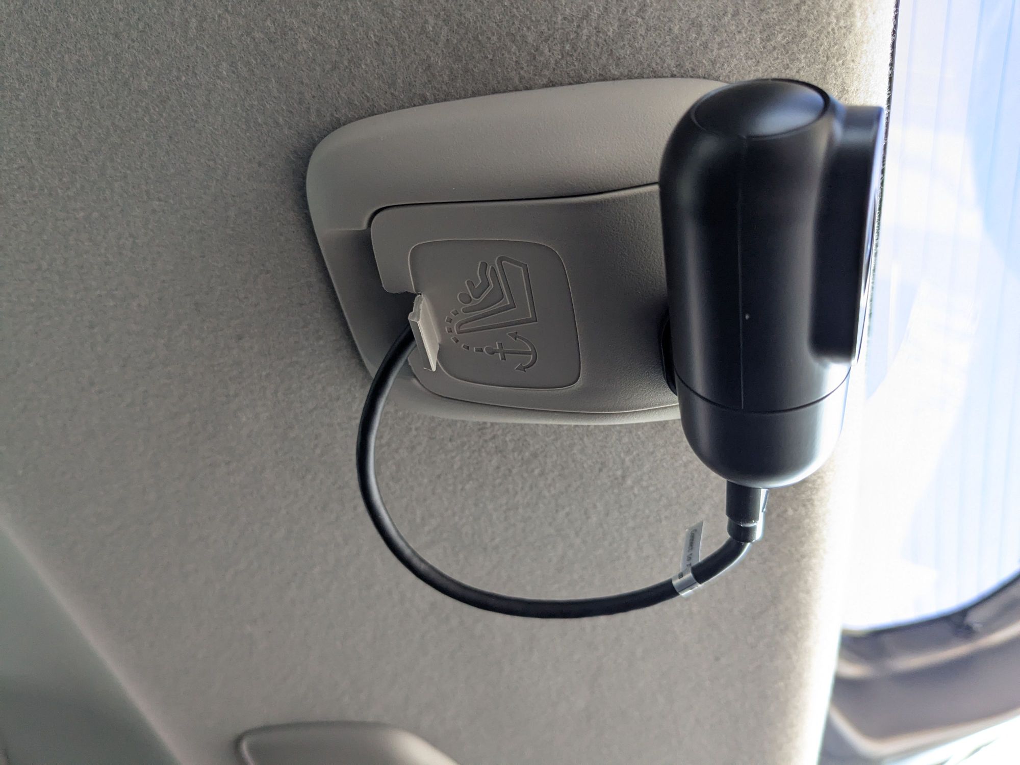

Figure 15 - I routed the excess cable inside the headliner, then routed through just enough slack for the cable to bend through the anchor point hole and into the camera. I used whatever adhesive the camera came with. If you notice, I also had to notch a bit of the plastic cover off the anchor point cover so the cable would be so stressed out. Up to you if you care about that kind of thing.
